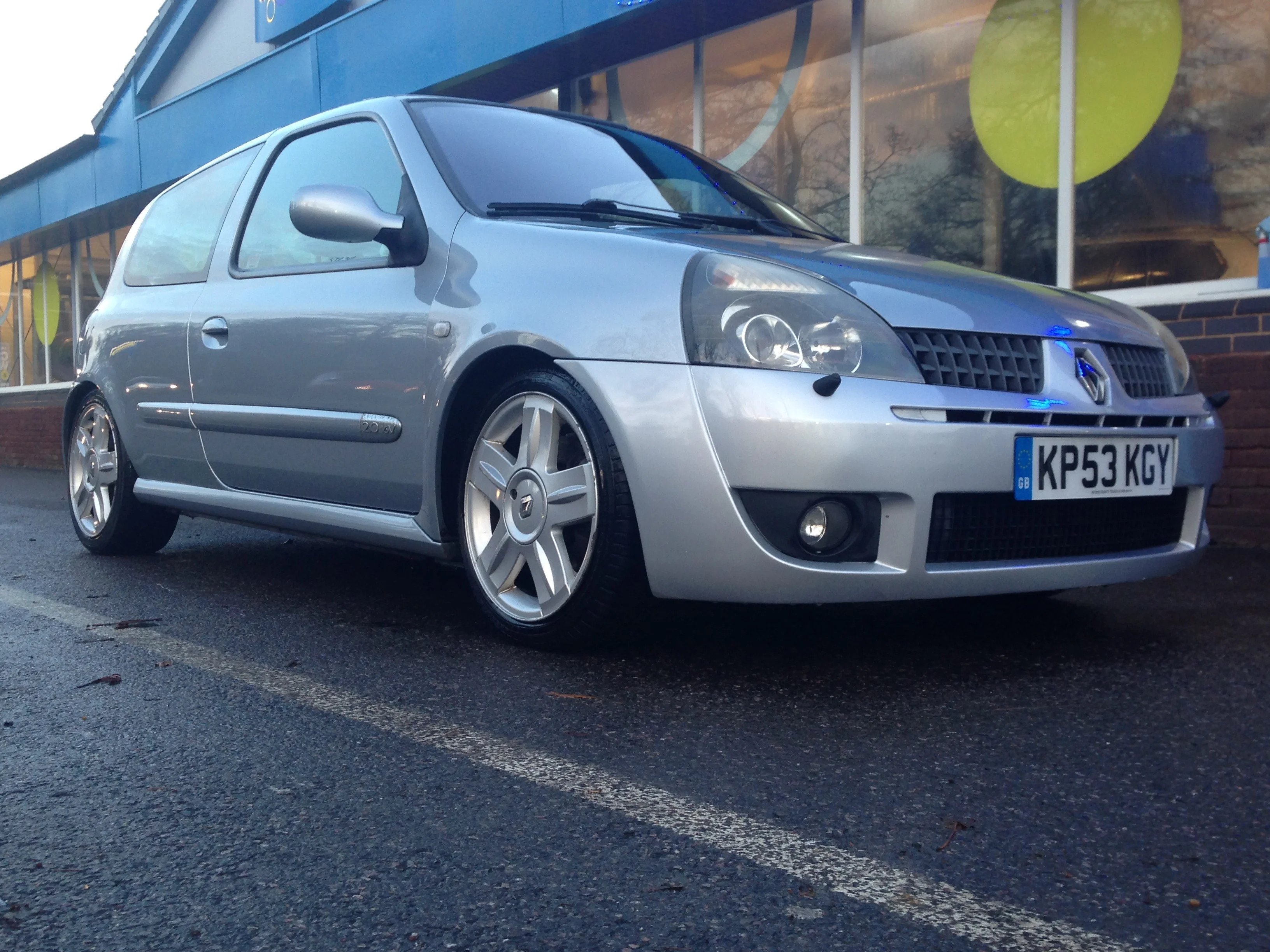

Joined up to the forum a year ago as basic member when I bought a silver 172 ph2 so I thought it was about time to pull my finger out and join properly.

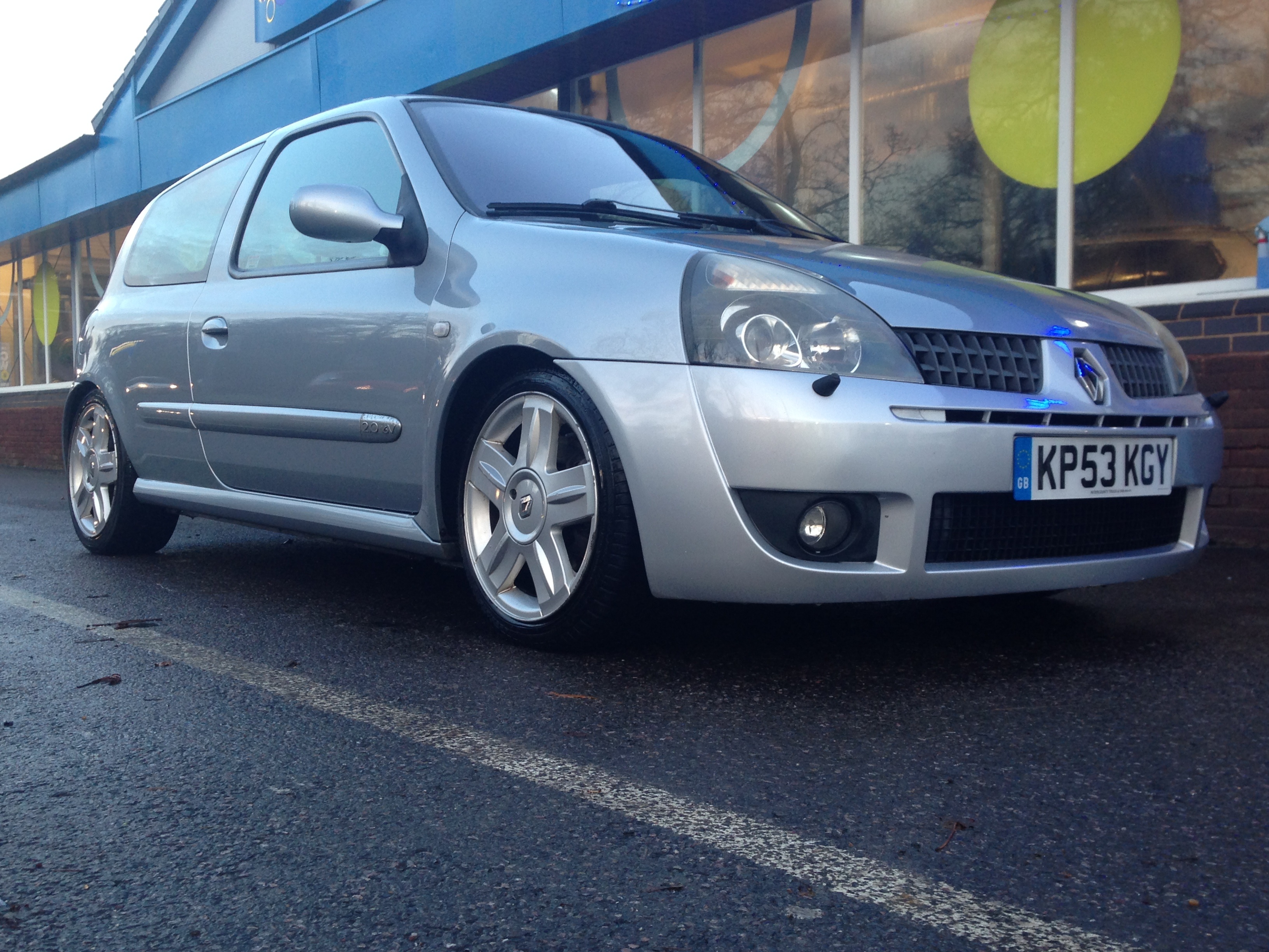

A friend of mine had one when they were a year old and raved on about how good these little clios are but it wasn't til another friend of my bought one as a cheap stop gap car. Had a go in it a week later I had mine sat on the drive :)

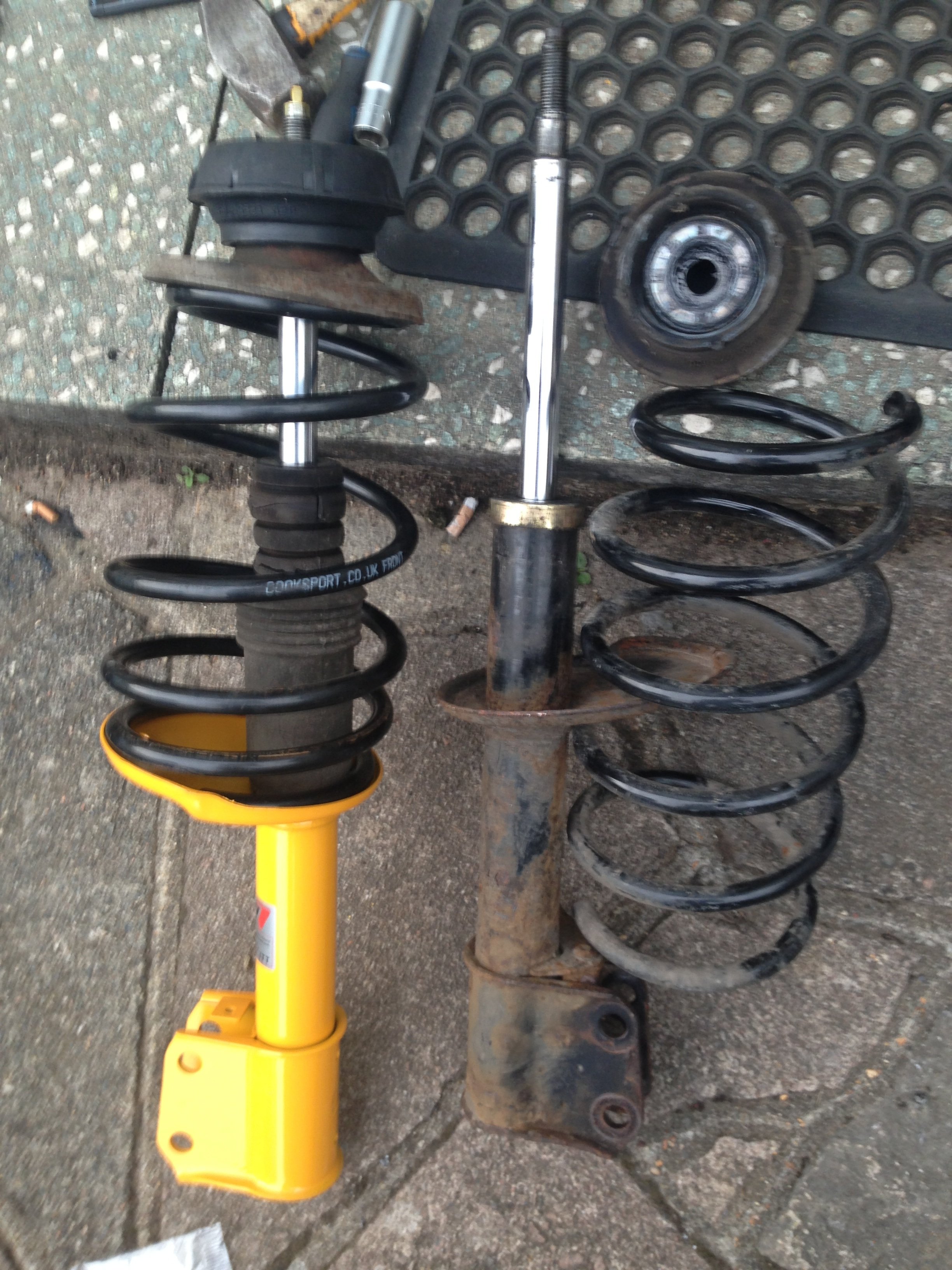

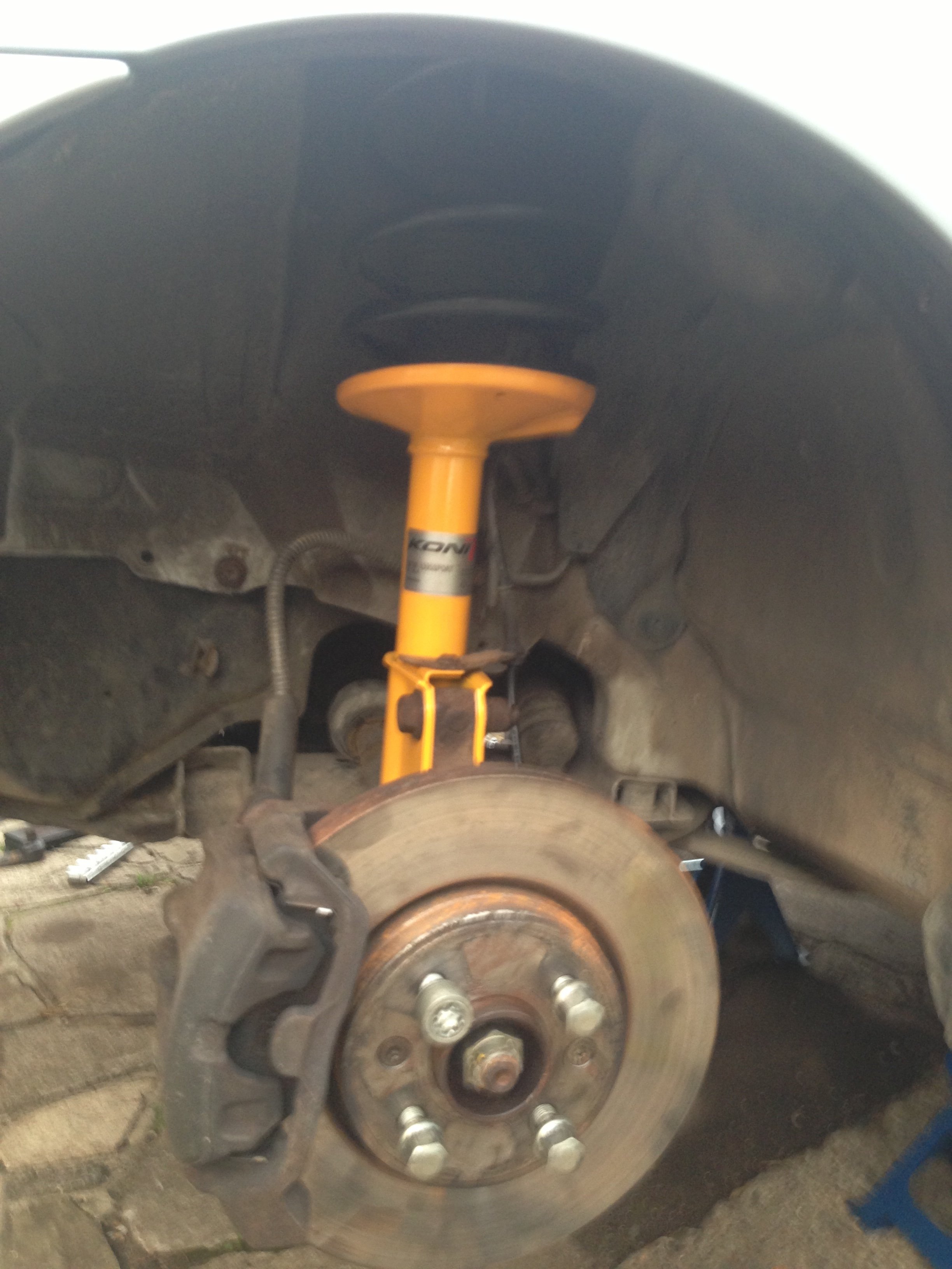

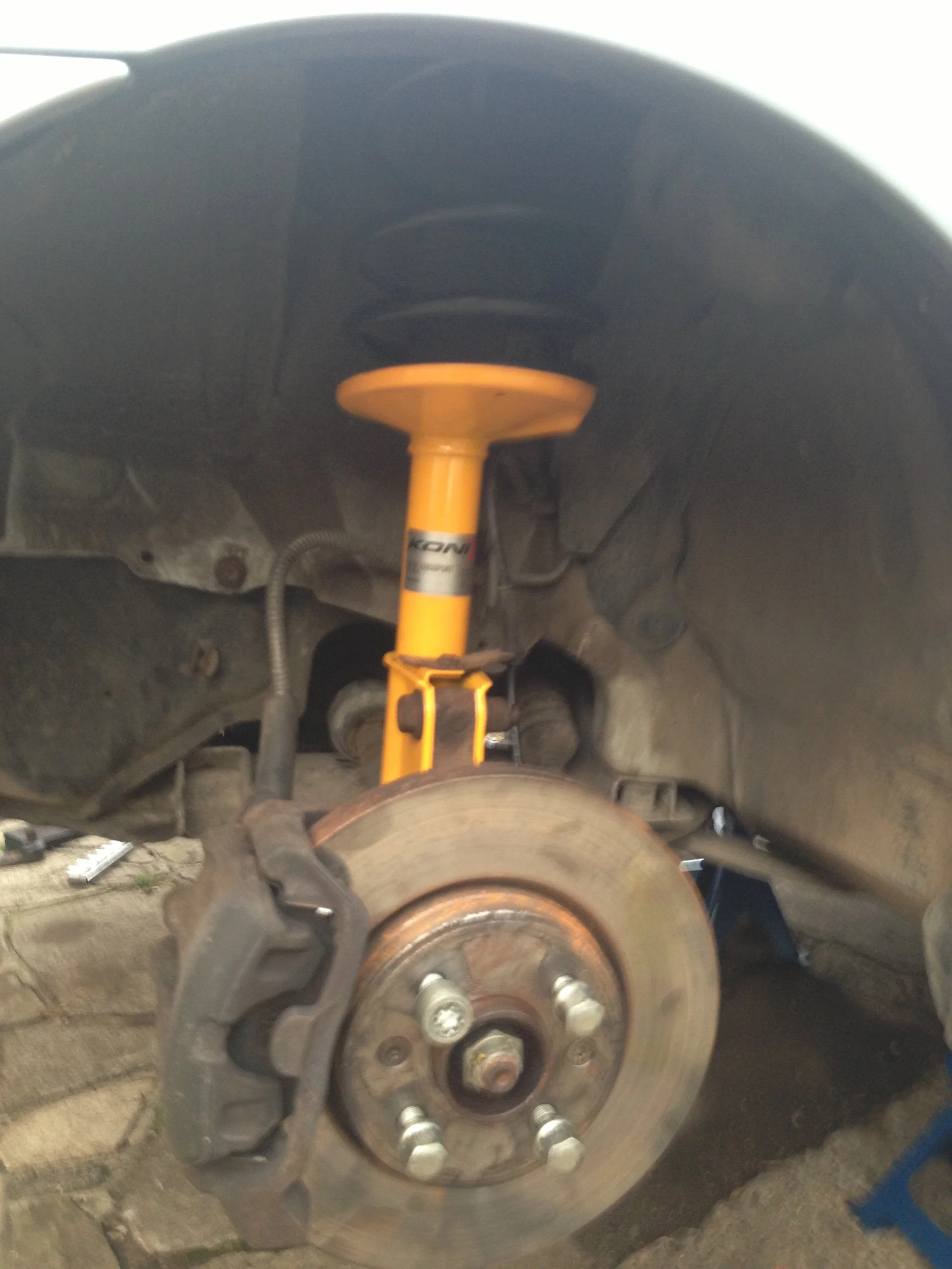

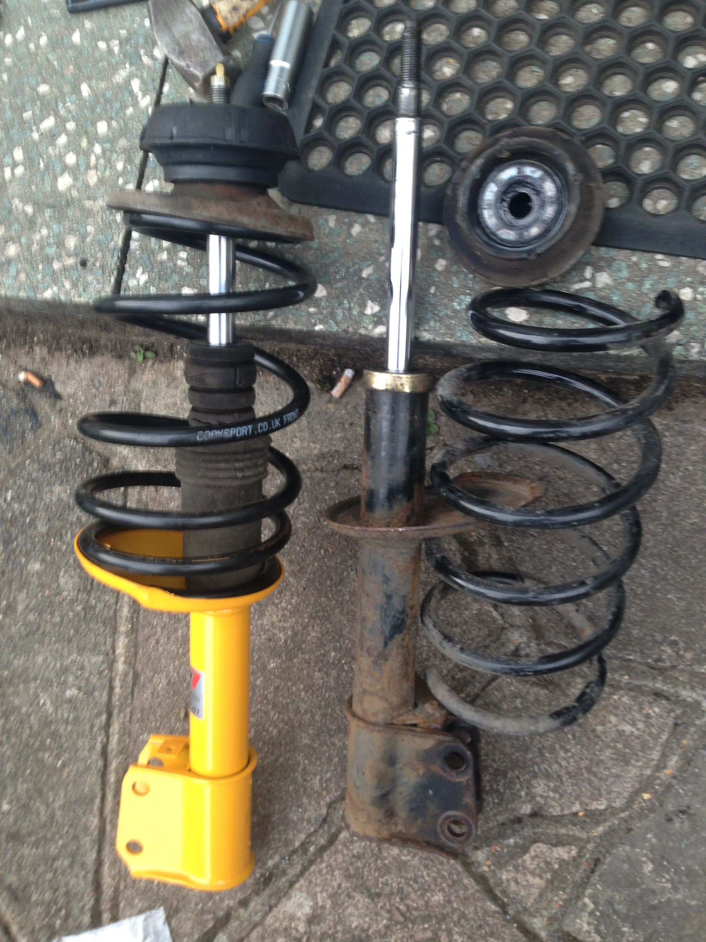

Then was time for a suspension change and refresh.
I went with Koni's and cooksport springs as I am not a fan of cheap coilovers.

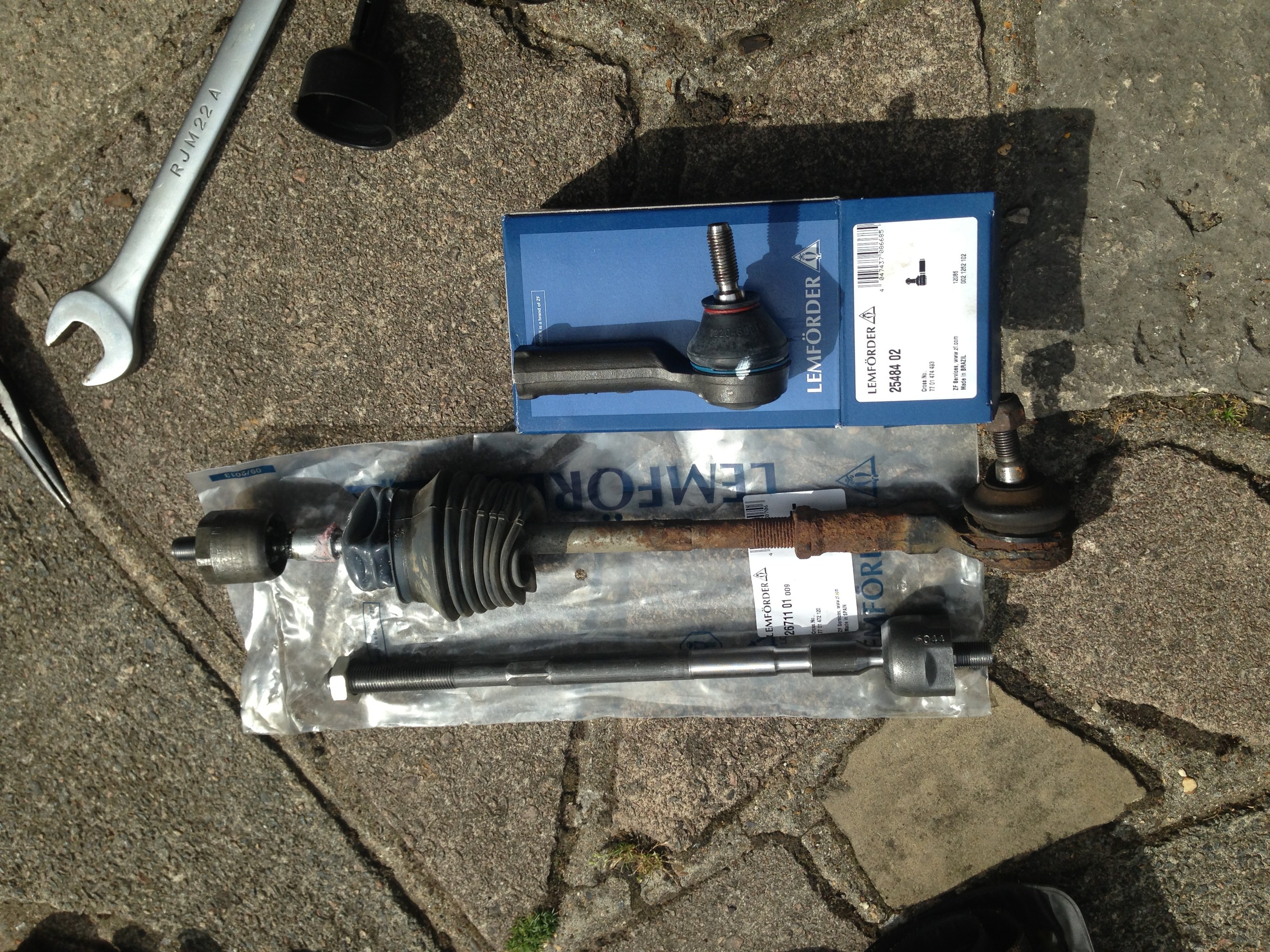

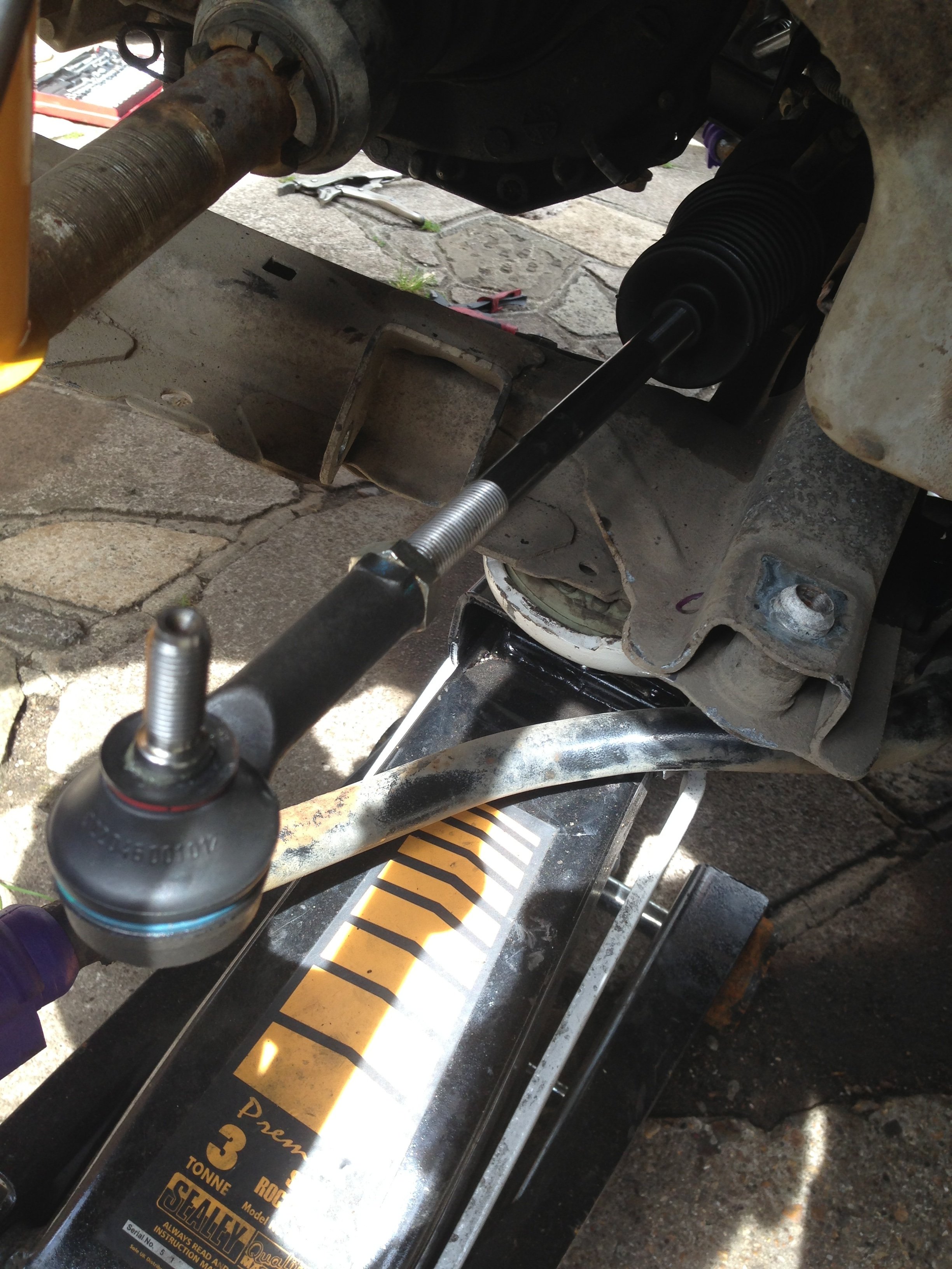

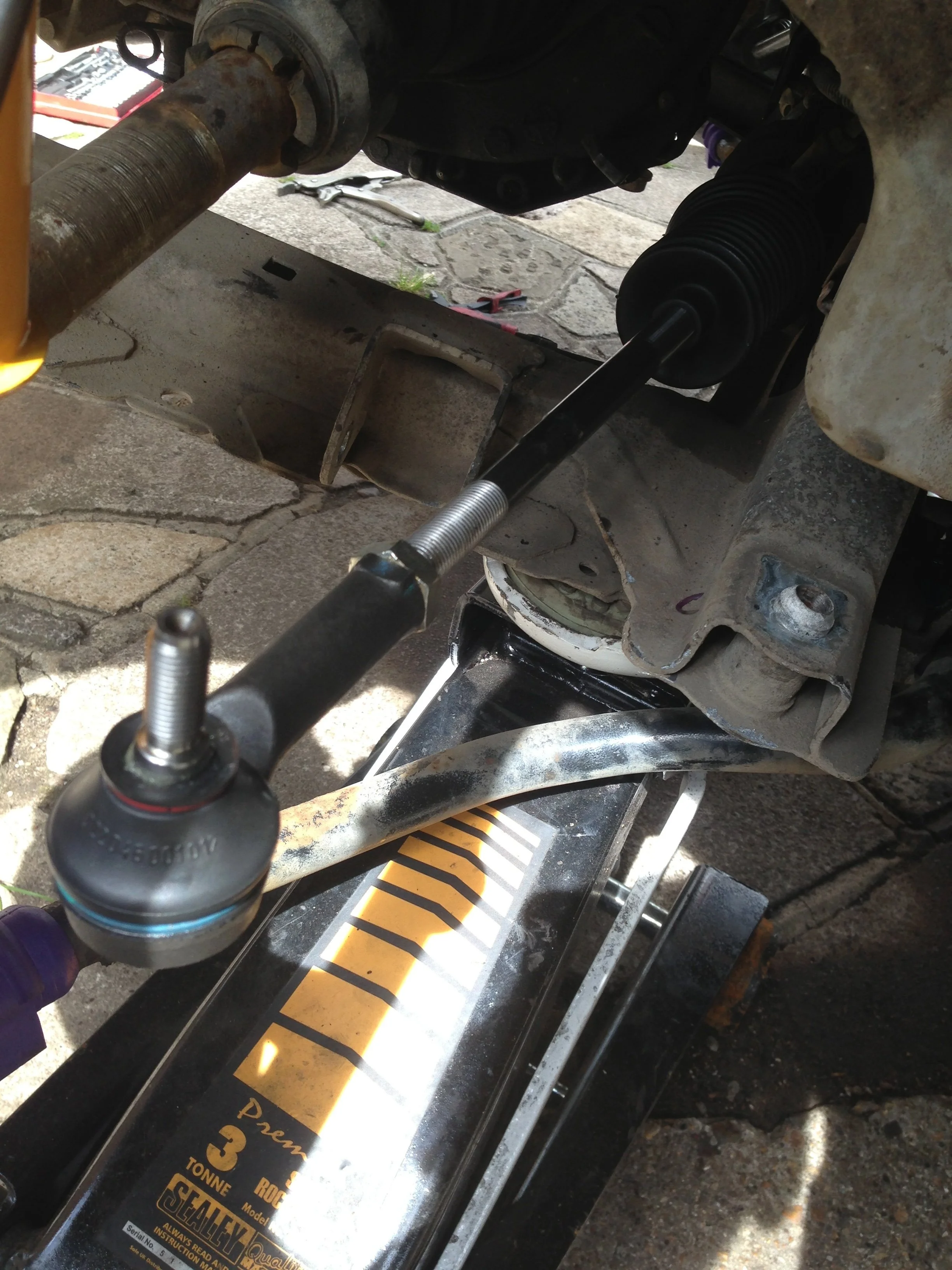

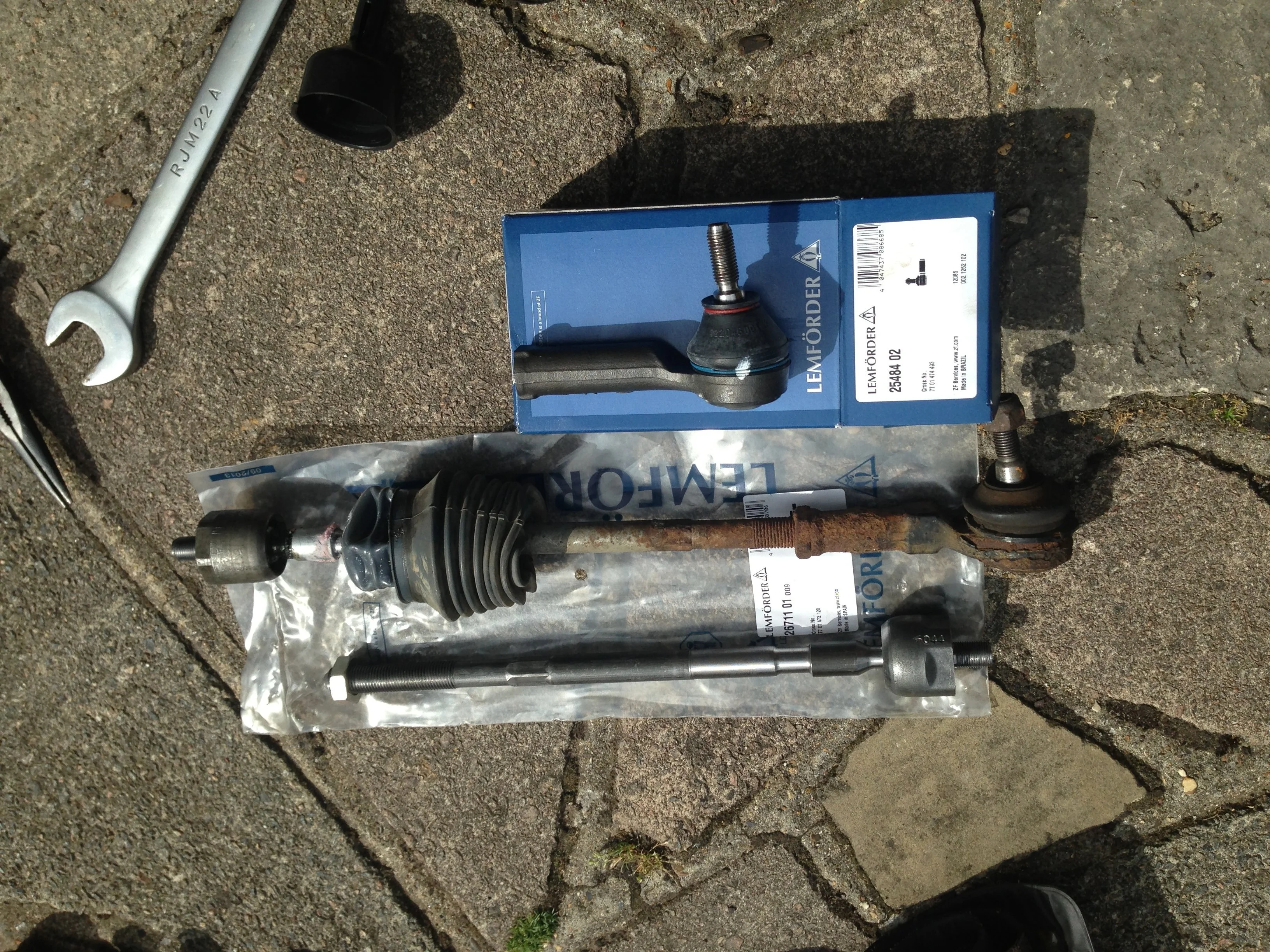

Also put new inner tie rods, track rod ends and lower ball joints all in lemforder none of that cheap shite!!
While I was there I polybushed the whole front end and dog bone.

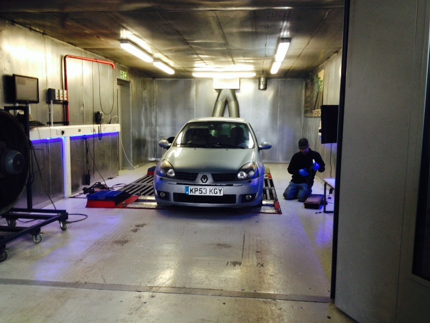

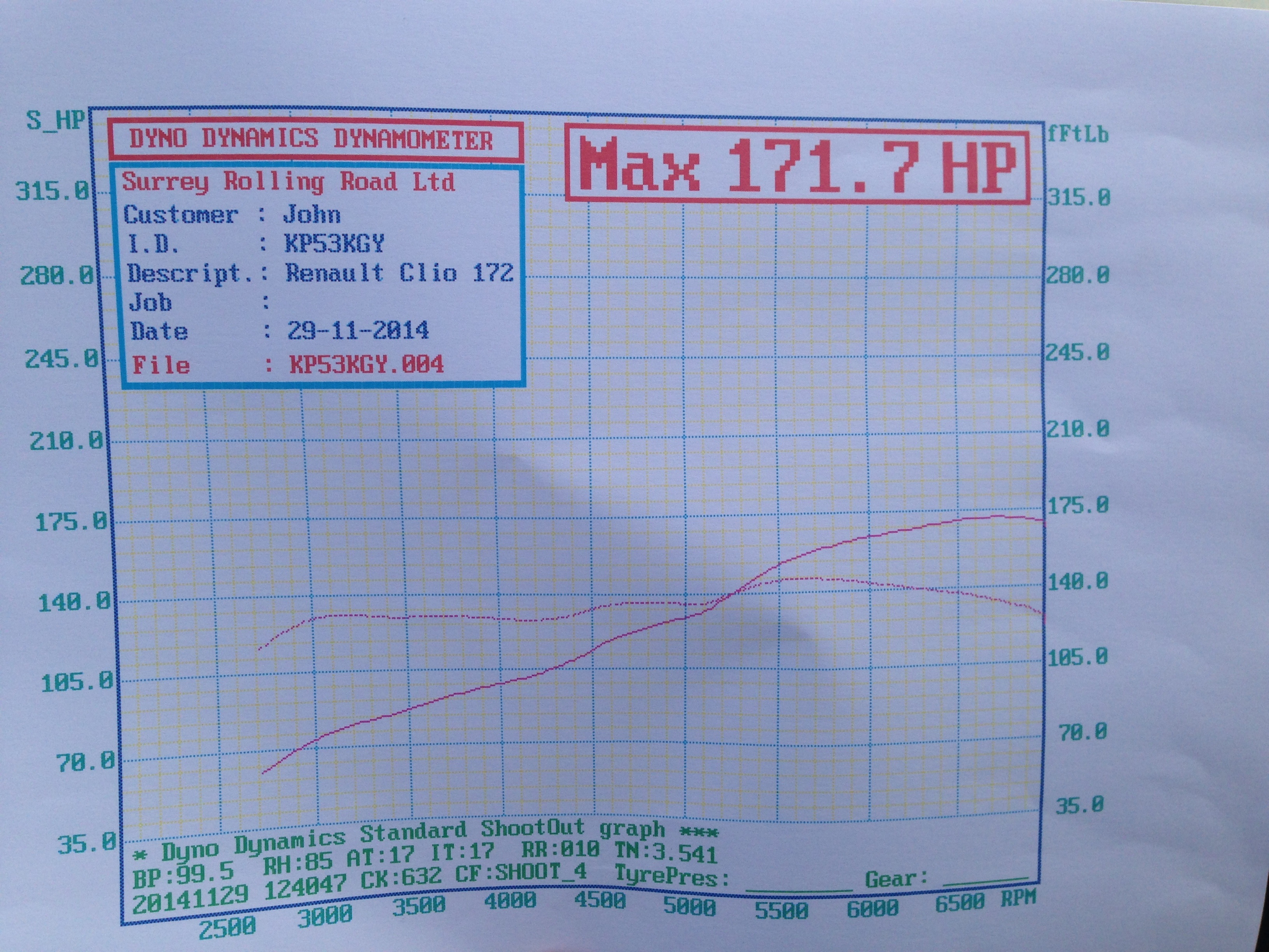

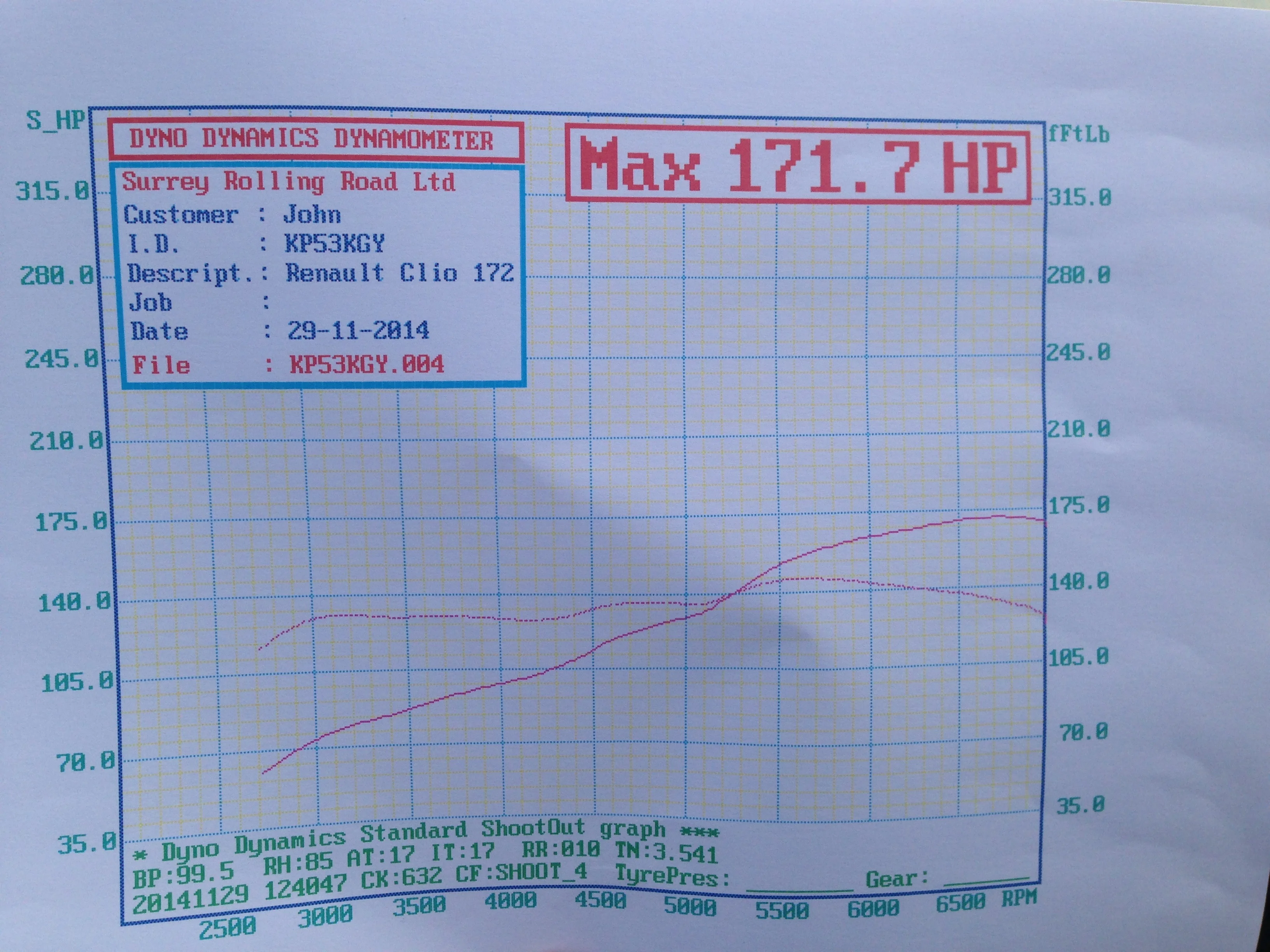

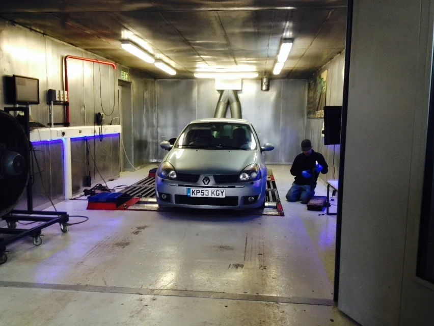

Then in November 2014 being new to the Clio seen I popped down to clio16valver's rolling road day at SRR.
Very happy with the result :)

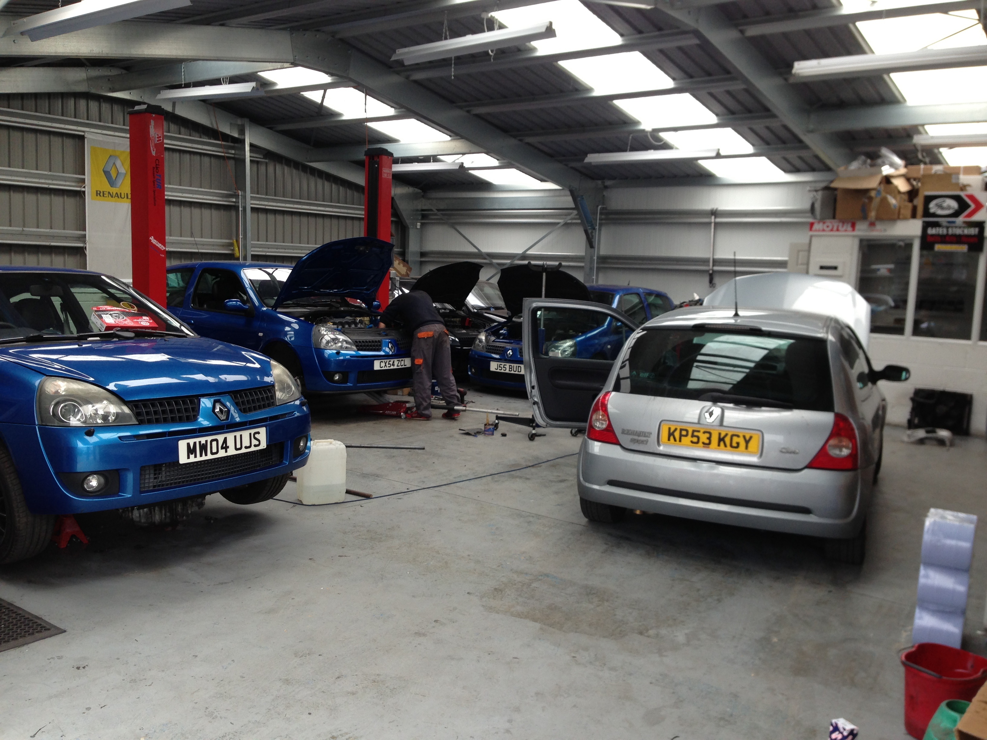

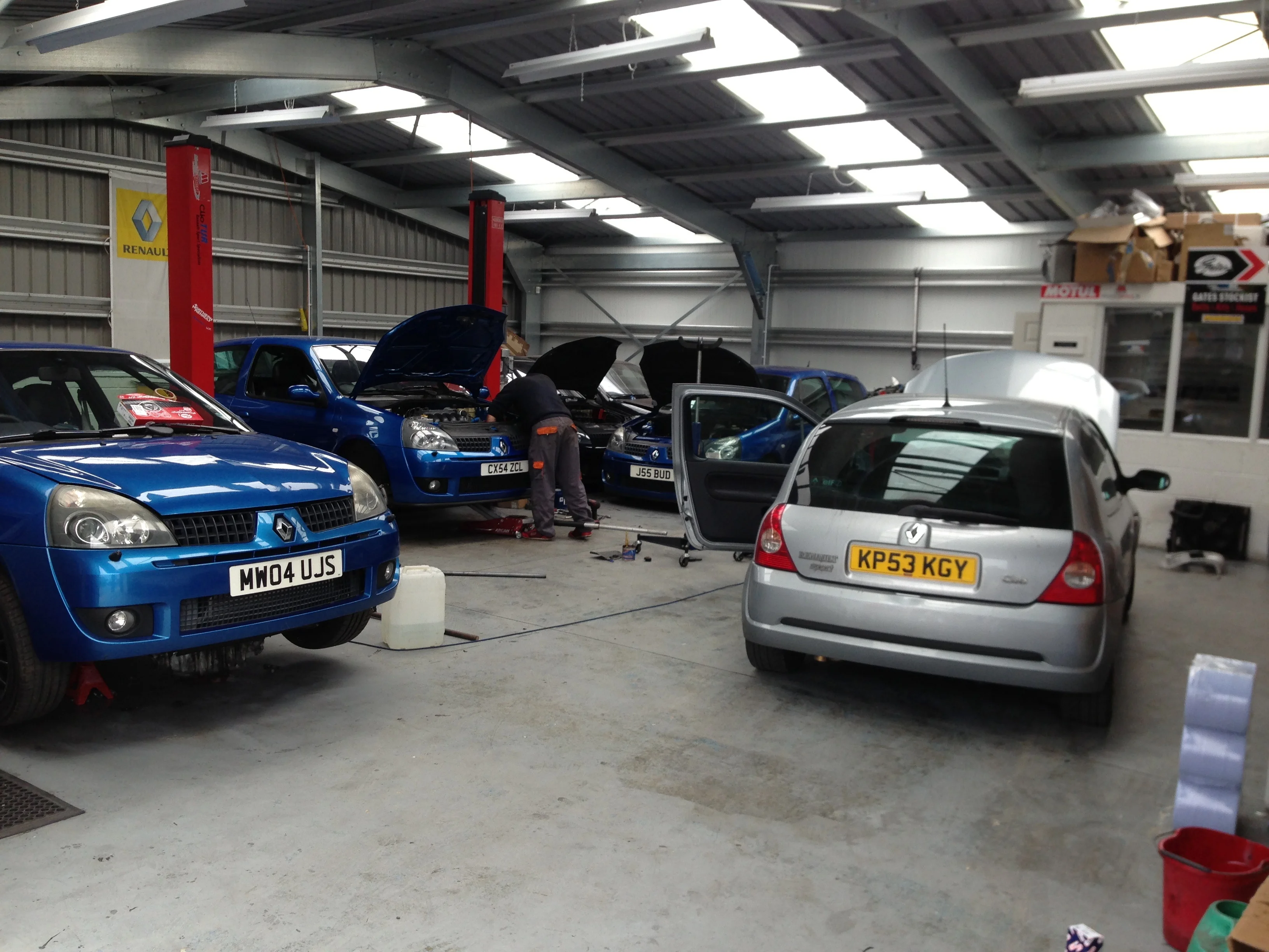

As I am doing the turbo conversion my self I spoke with Andy to see if he could fit the management to my car as it is a n/a 172 because I am 280 miles away from him and would cost a fortune to get it recovered there once I'd done the conversion. He said not a problem but it would only be on a base map to get me home. Booked a day with him so on wednesday 27 may booked the day off work and took the long drive up north for him to supply and fit the adaptronic Ecu.
Here she is in the workshop.
I would like to say a big thank you to Andy@clioturbo a very bloke who you can tell he doesn't treat your pride and joy as just another pay day. He really lives up to his reputation and well worth the 560 miles round trip.
