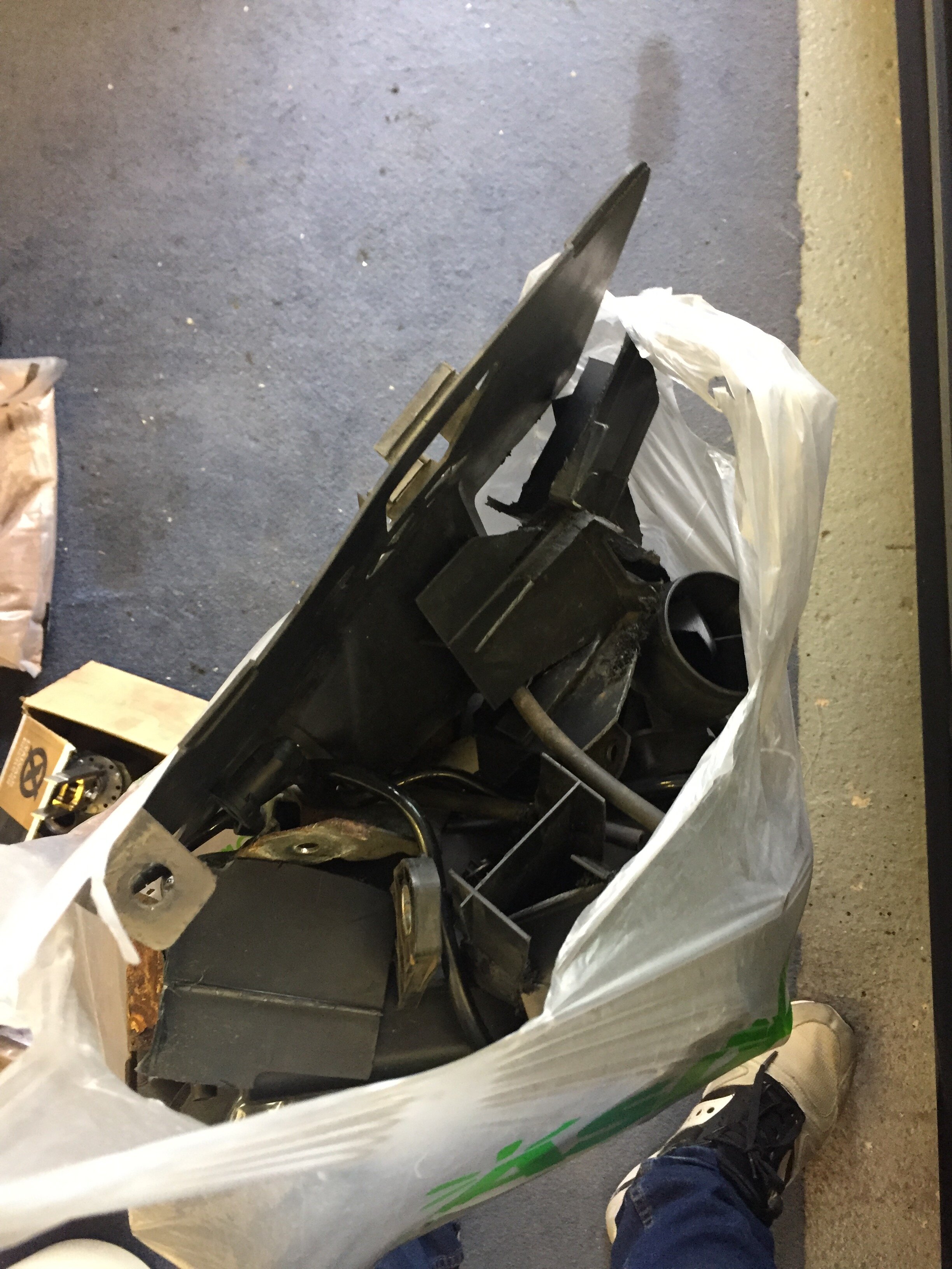

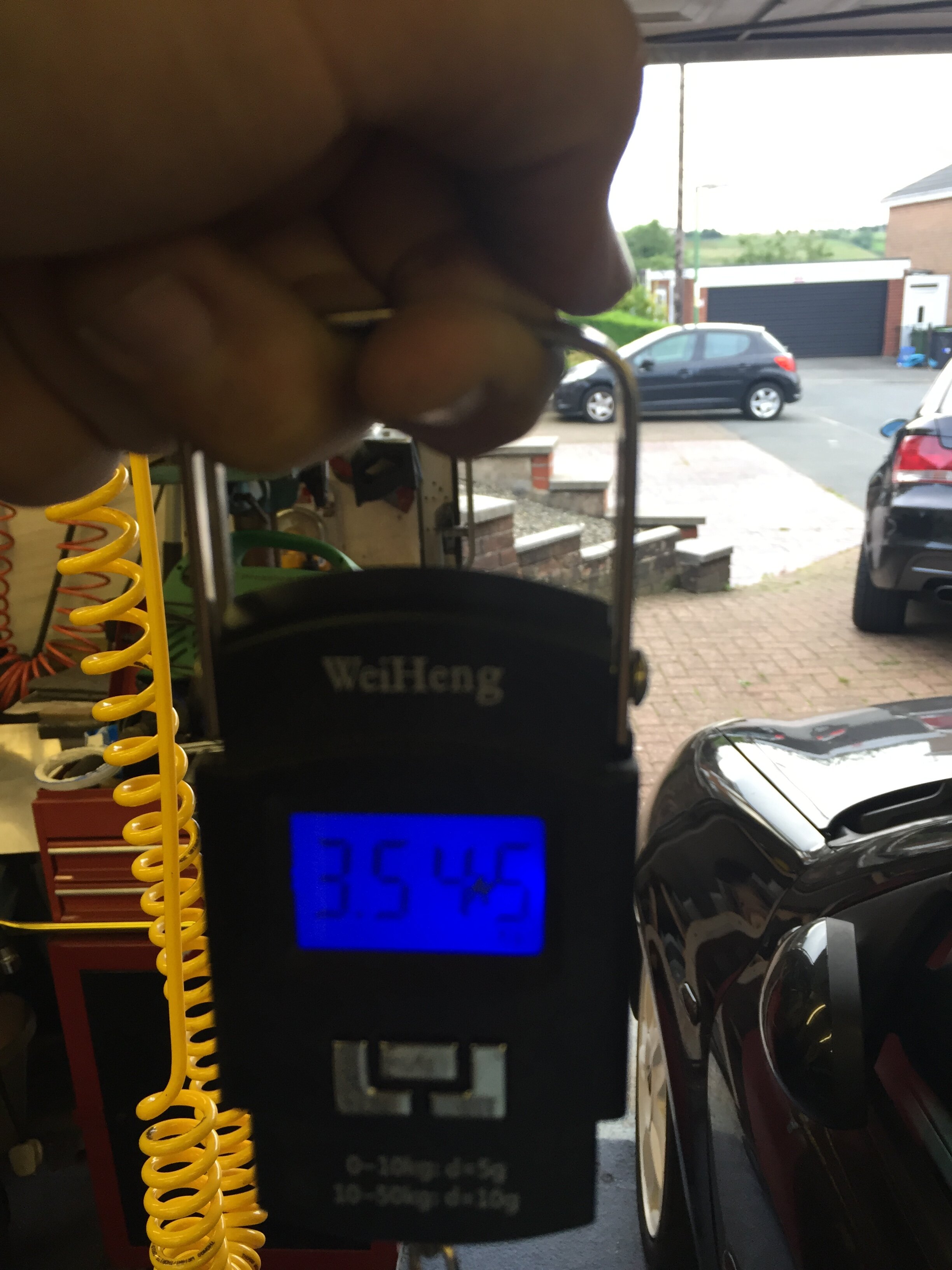

I then began the pointless task of weighing all the shite I'd taken out of it (as in interior trim, not just junk I was keeping in it)

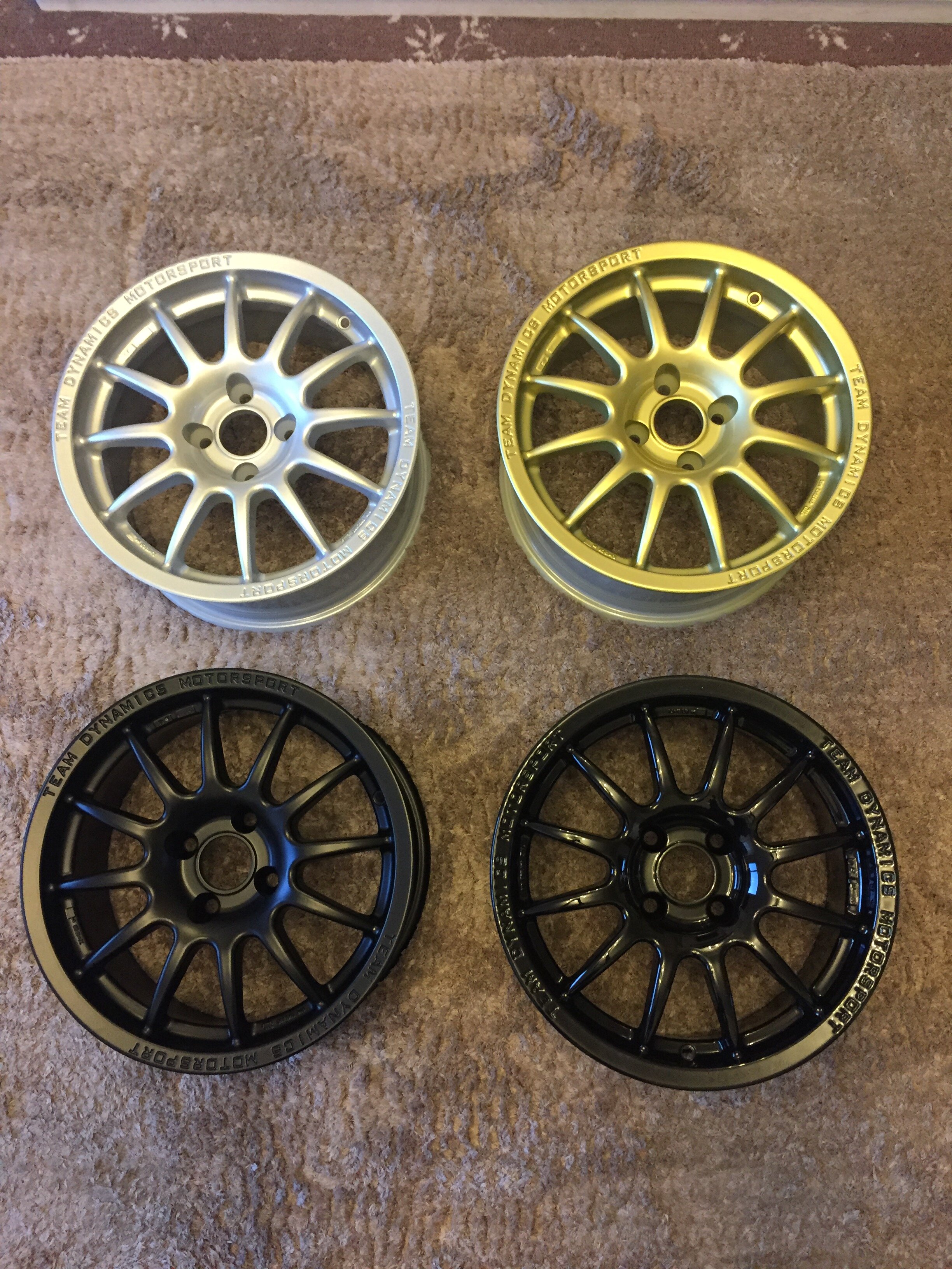

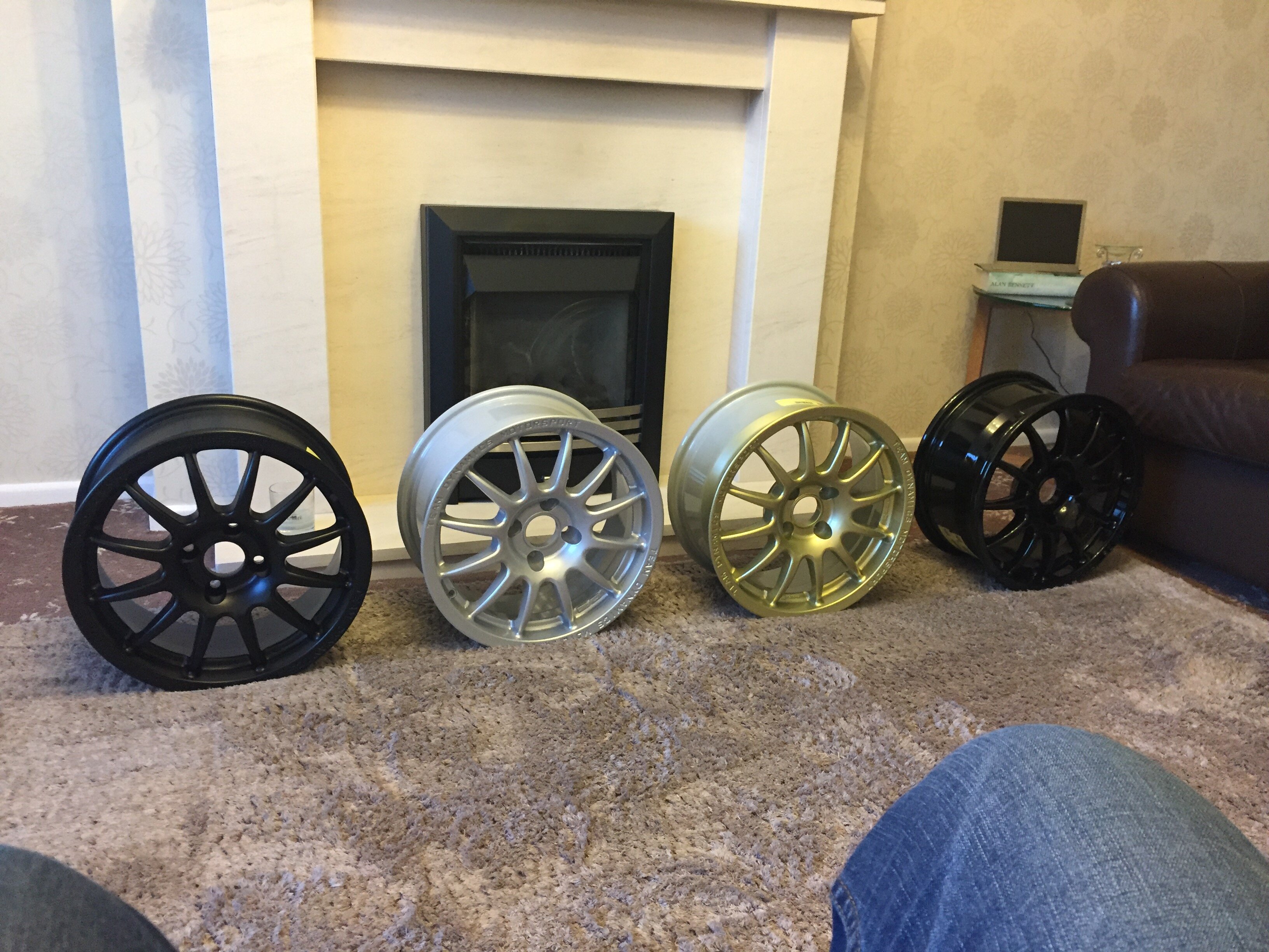

Then Car Parts Santa turned up and emptied his sack all over my front room:

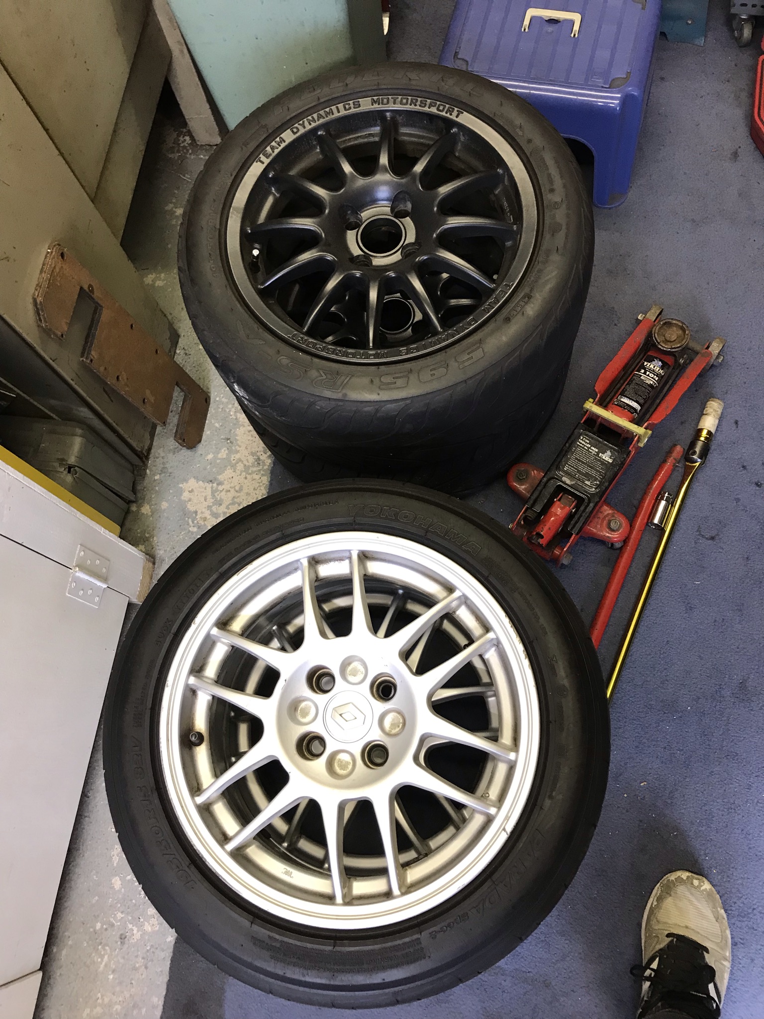

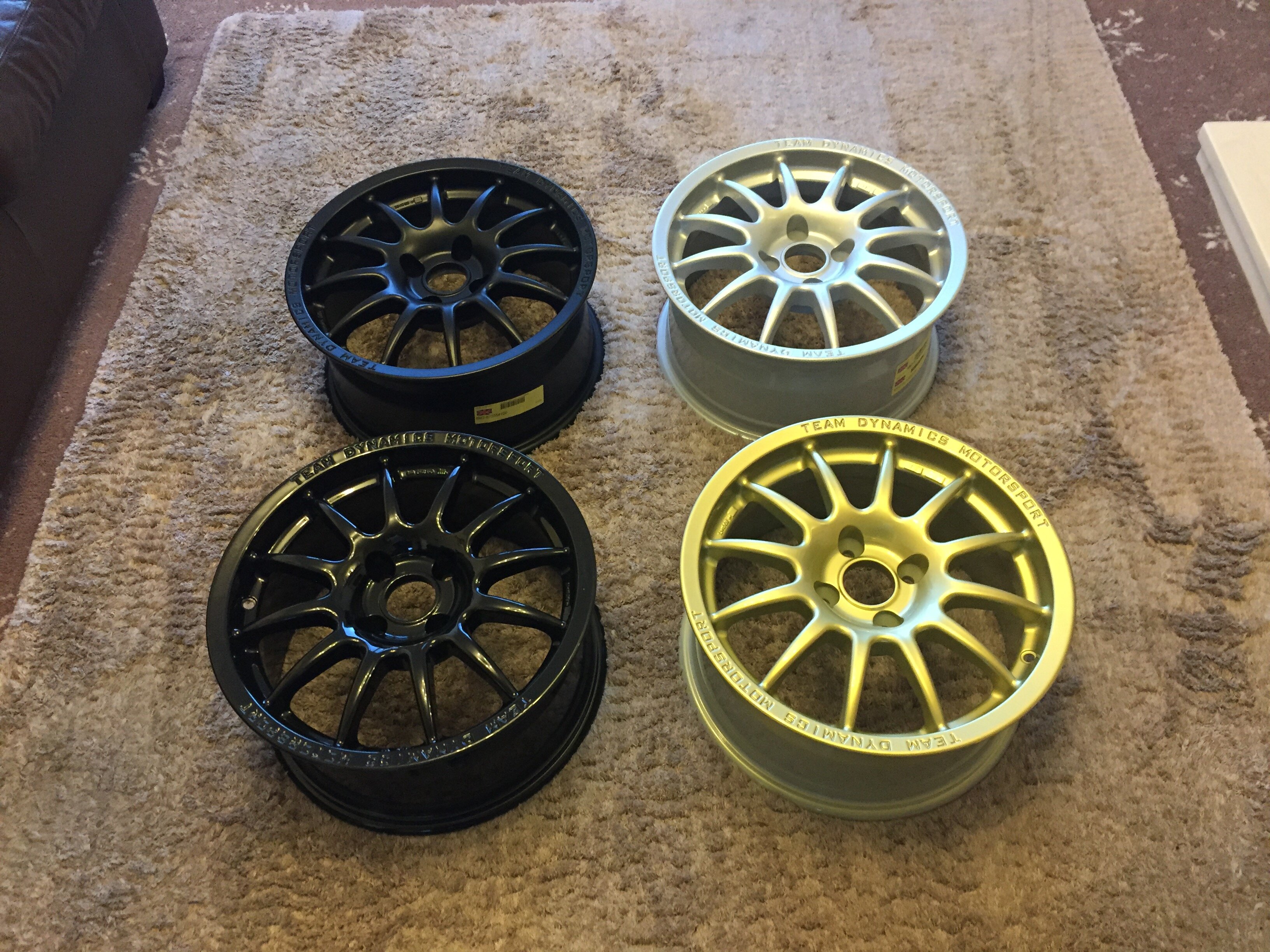

It was one of those glorious ex-display pallets that Rimstock used to do through their "It's not us honest" eBay store.
These then got sent off for powdercoating to CAS Coatings in Bradford. That old £1 per 1" pricing rate. All 4 done in satin black. Not perfect, but pretty damn close.

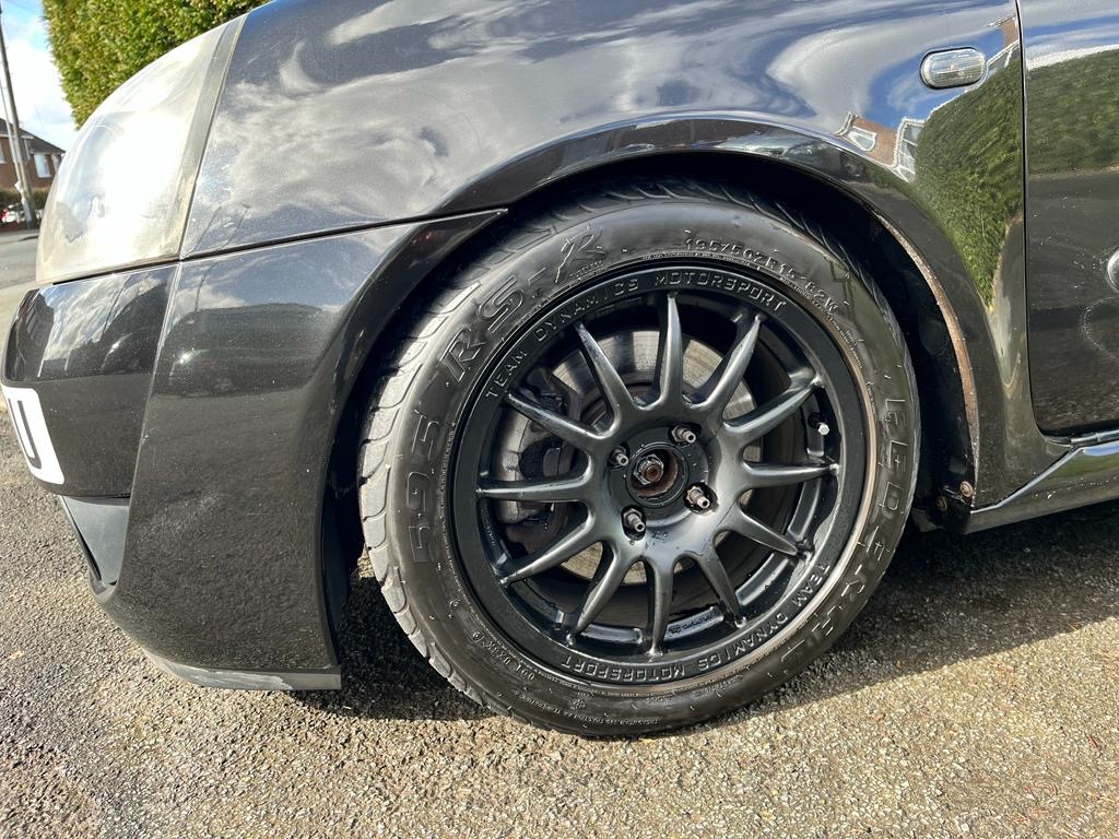

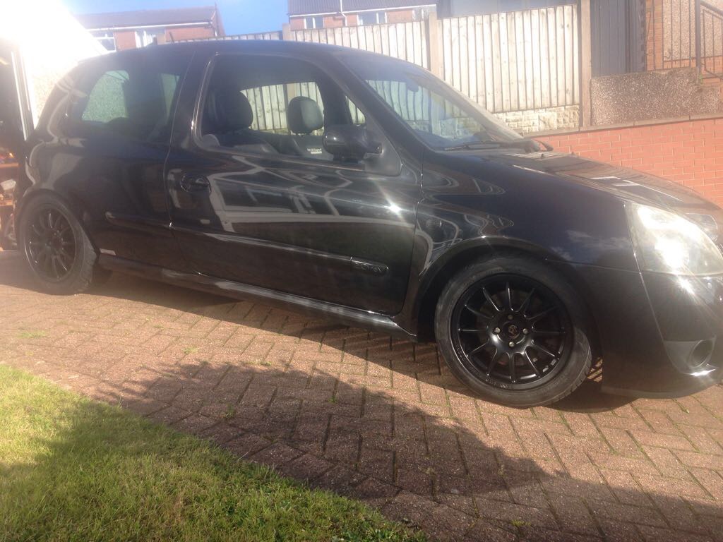

Got the tyres mounted up, went for Federal 595RSRs, quote impressed.
Artistic lens flare? Or greasy sausage fingers on the lens?...
I mean its still pretty pedestrian, its a tiny French hatchback, but I do look how aggressive it looks, without having bolted loads of tat on, like eBay canards or a plywood splitter.

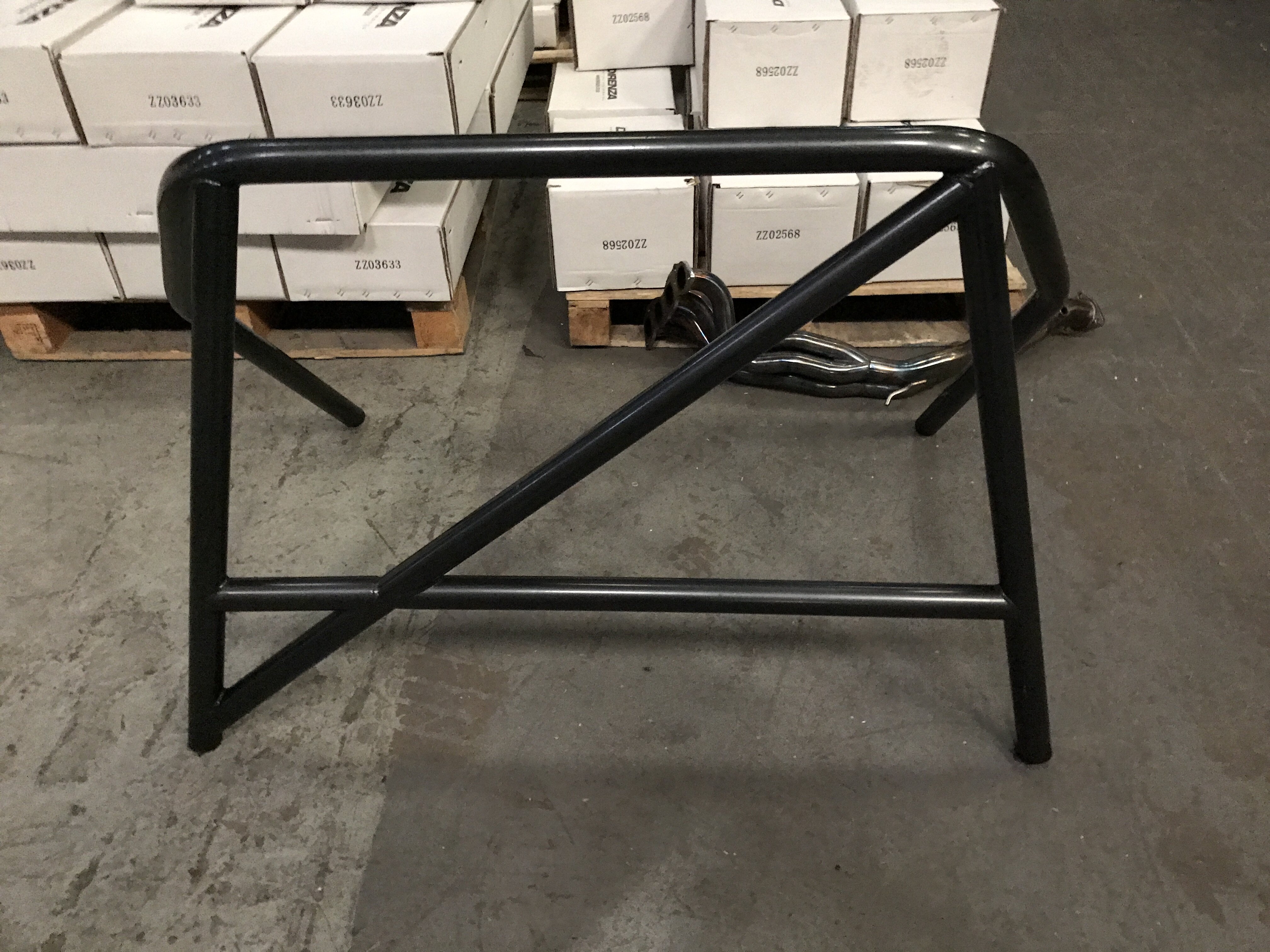

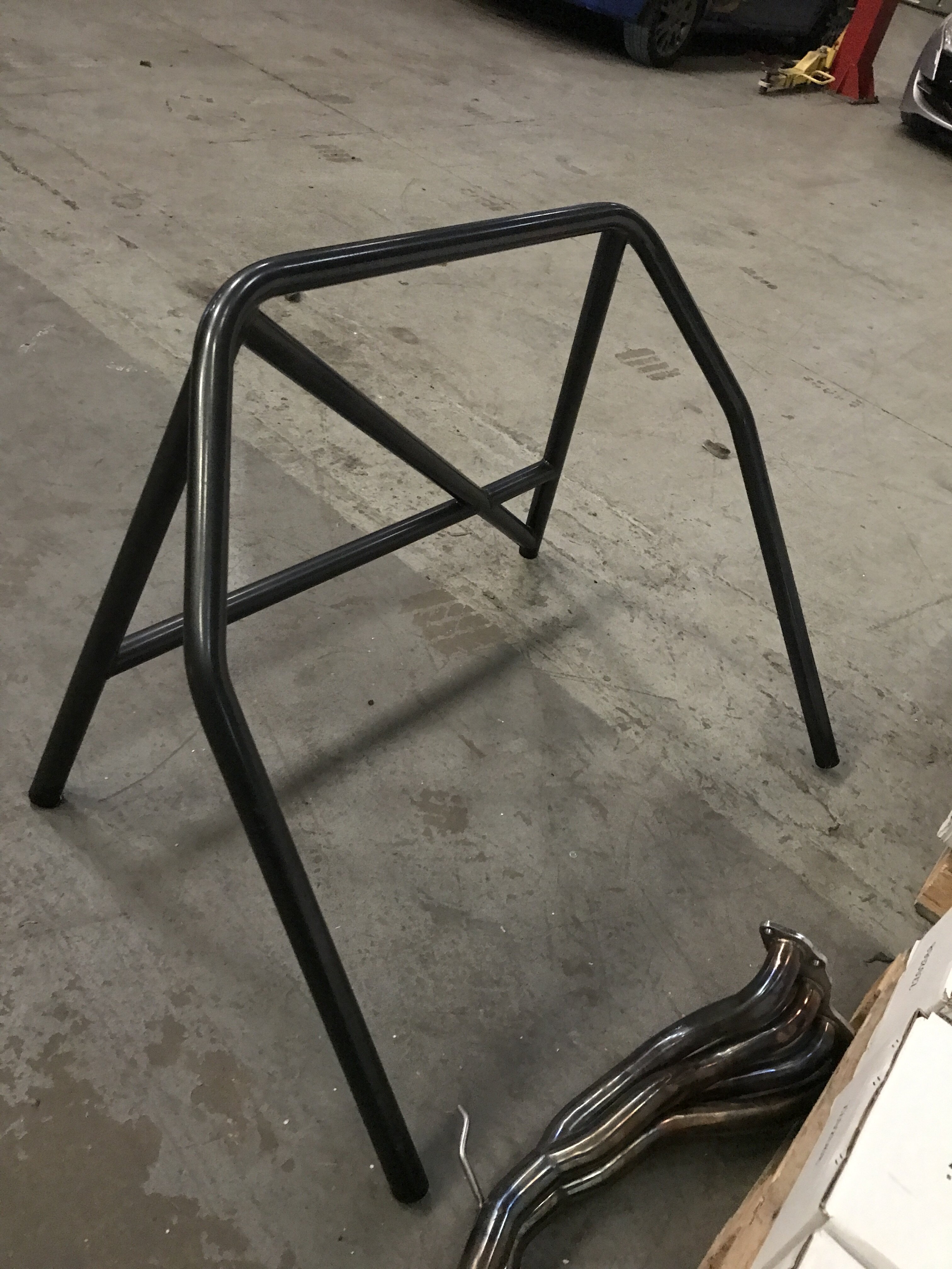

Managed to score an SW Motorsports half cage. Their customer was upgrading, and I was in the right place at the right time to benefit!

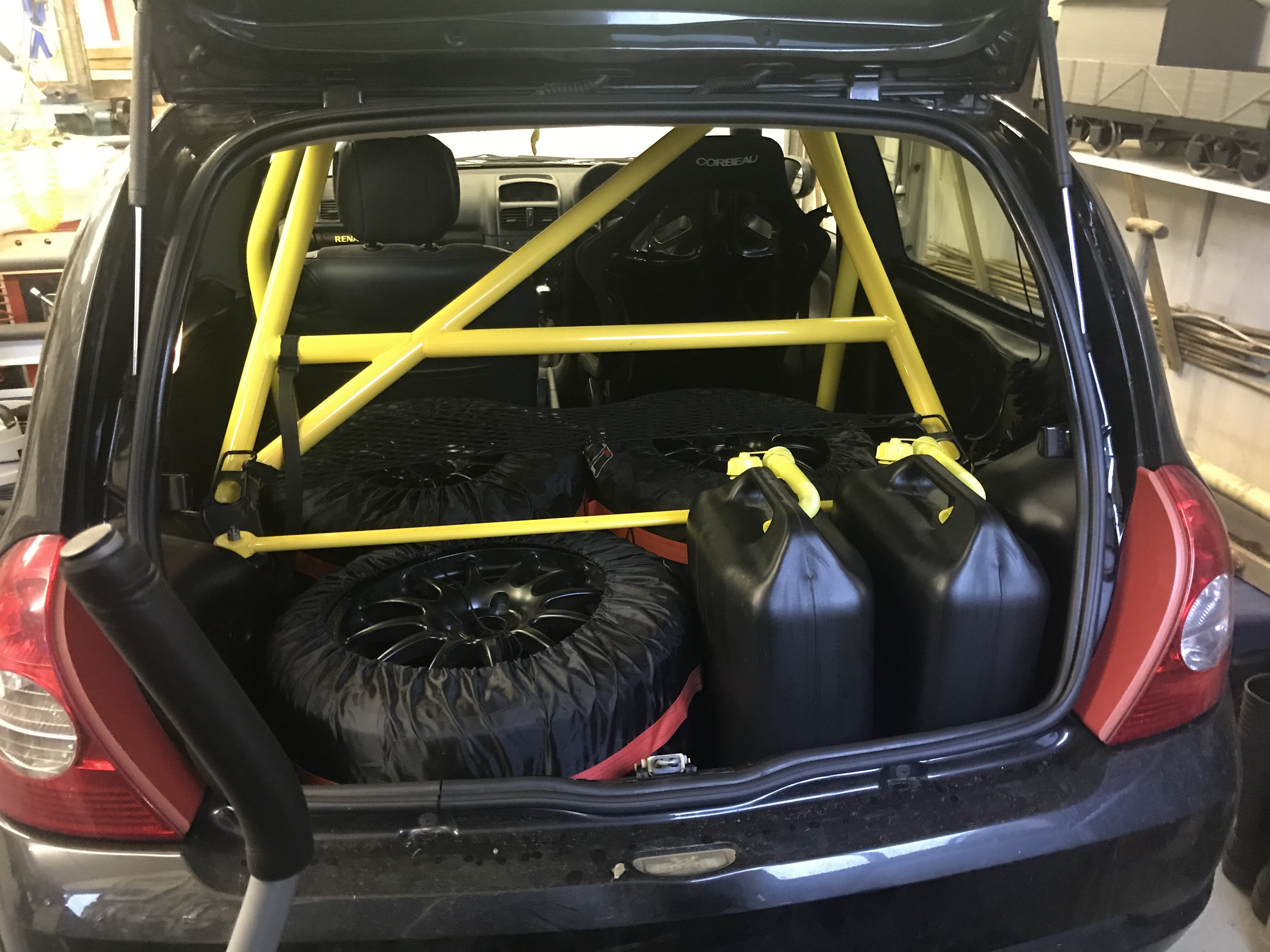

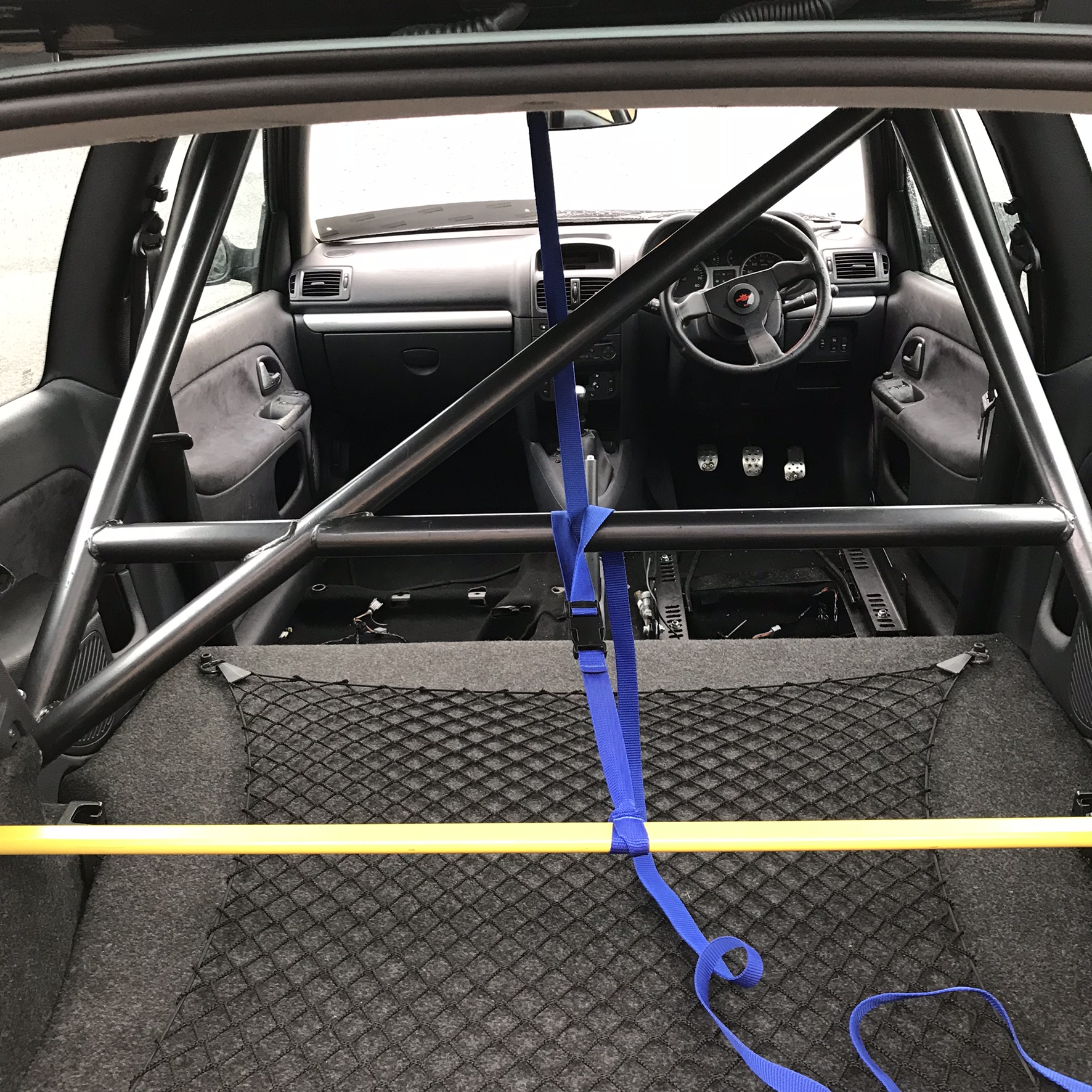

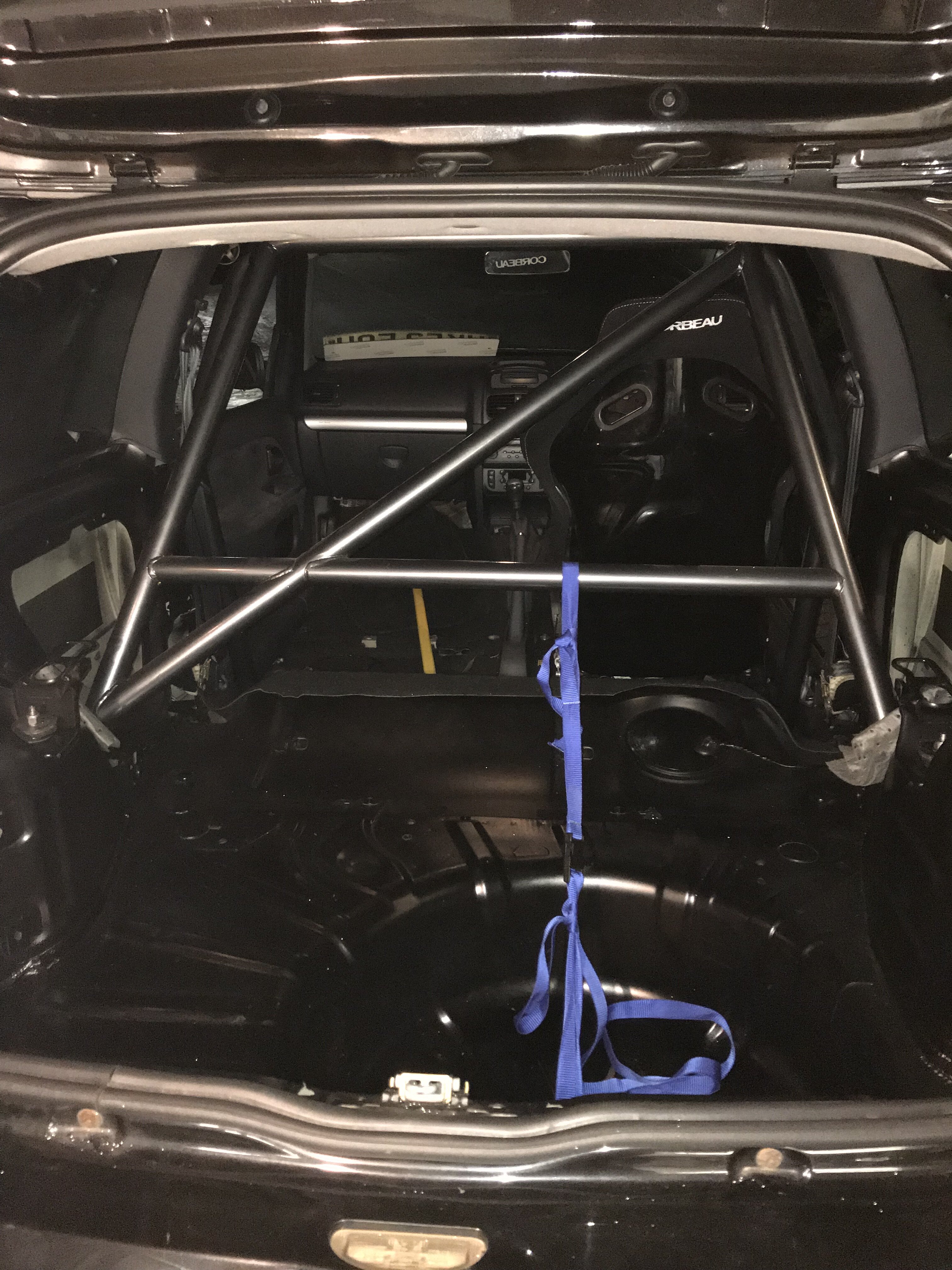

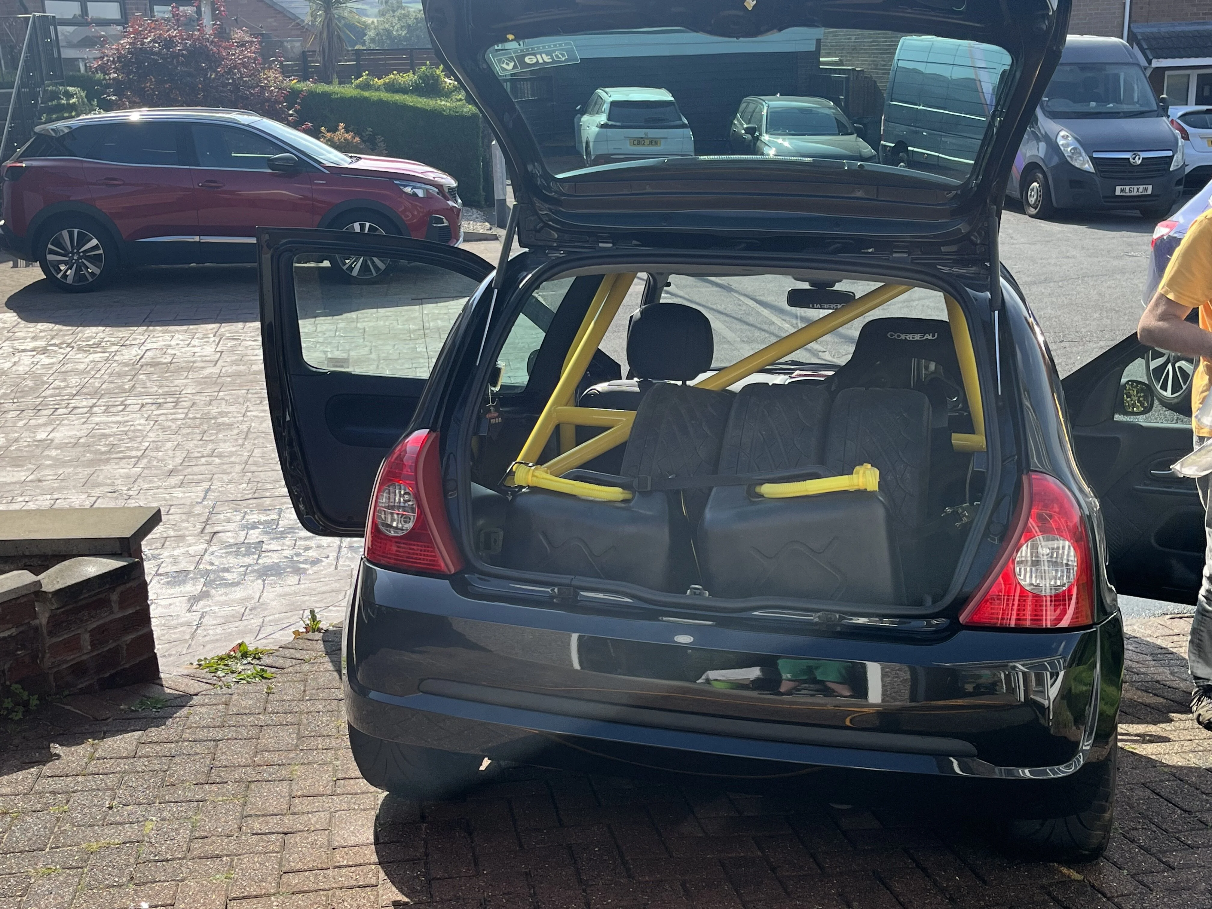

After being sick of having no room in the garage with the cage sat there, I realised I could just store it in the Clio. I was doing very little mileage in it so it just became storage on wheels.
At this point I was still running my sexy false floor I made from scrap wood and the amazingly well-matched speaker box carpet. I wasn't driving the car at this time so don't panic over the fact the cage is just lashed in.

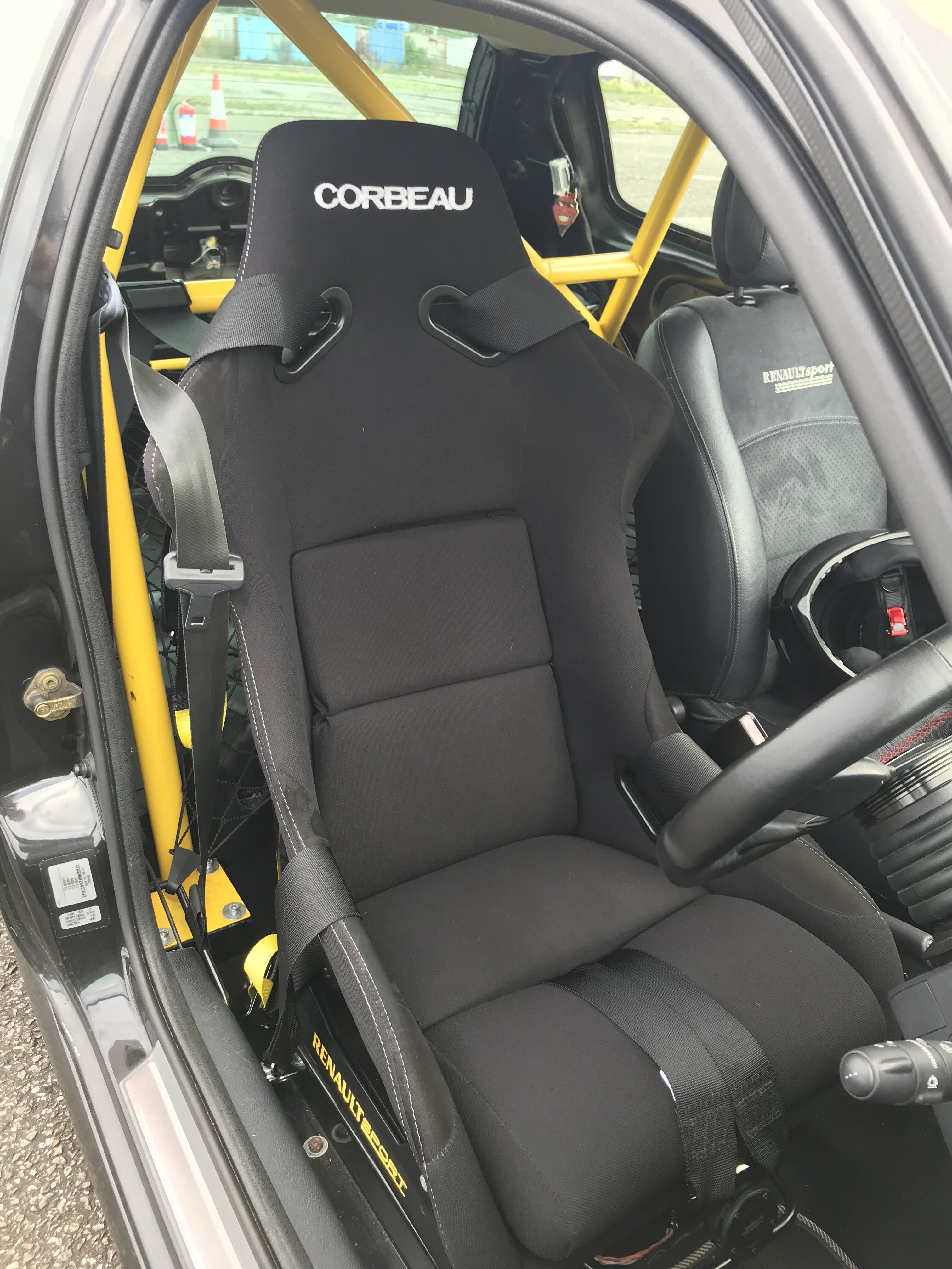

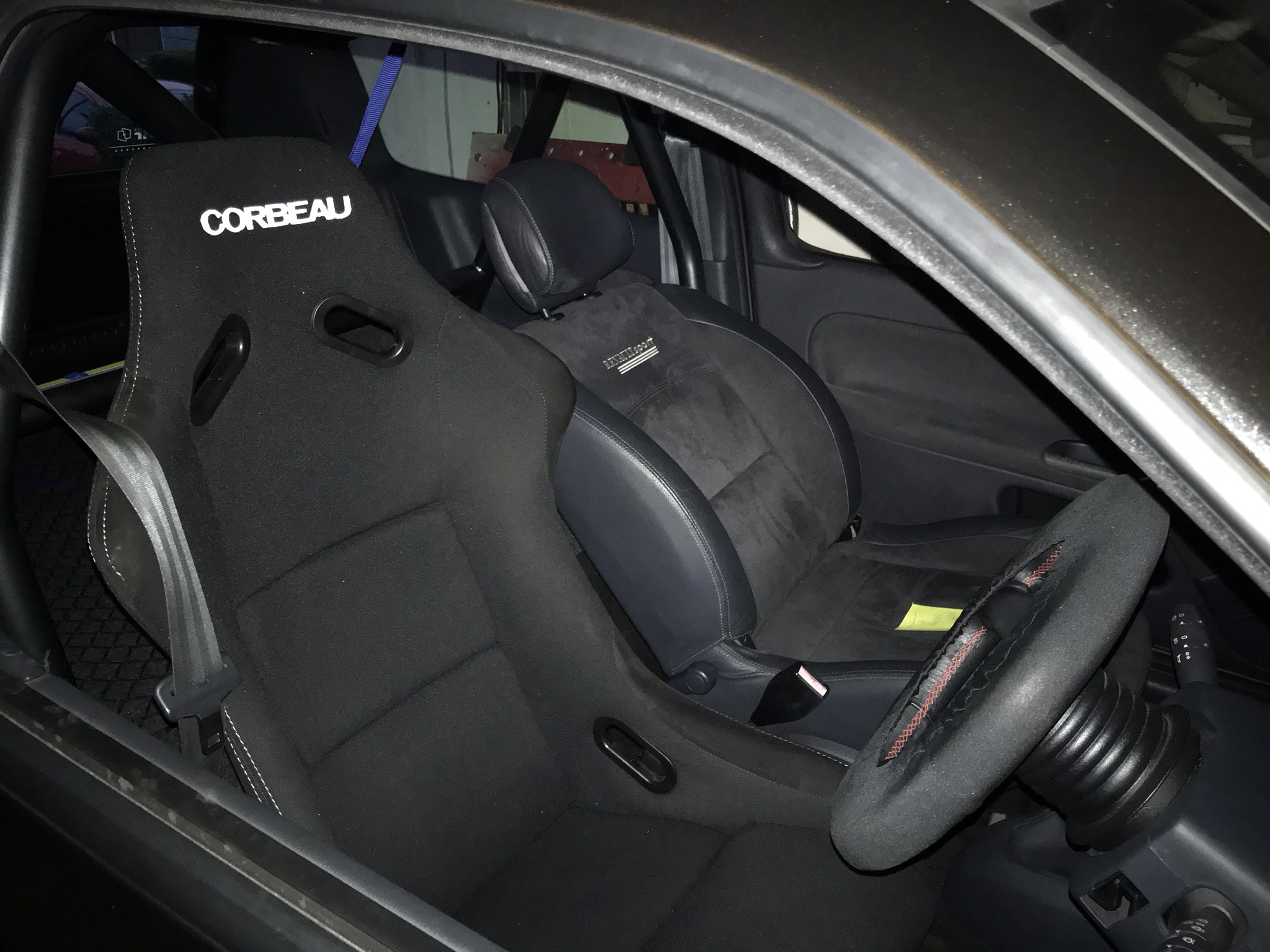

I then managed to score a Corbeau Clubsport XL back when everyone thought they would be around forever, and they were cheap.
NB - I wasn't giving roadmen passenger rides, the pass seat isn't fastened in there.

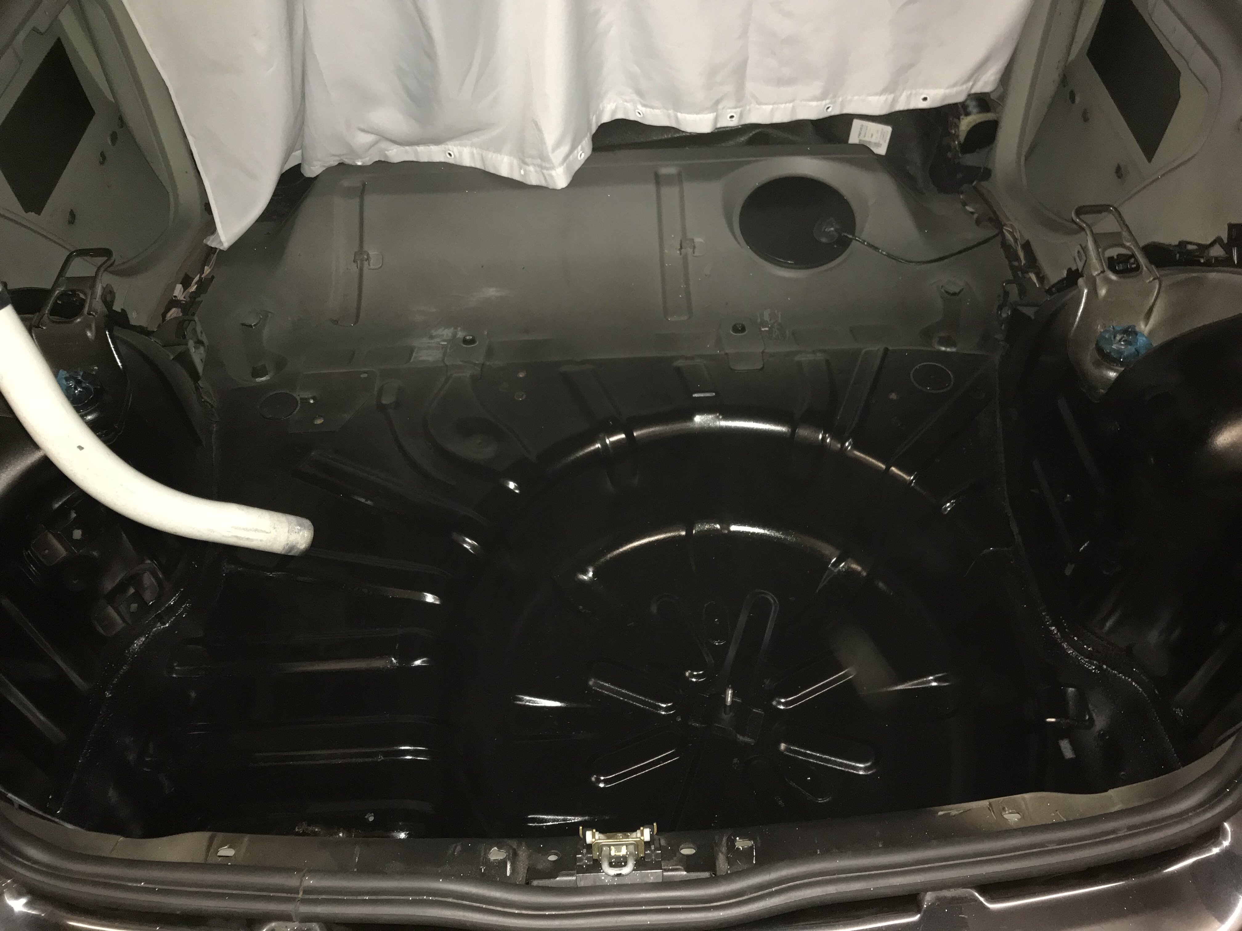

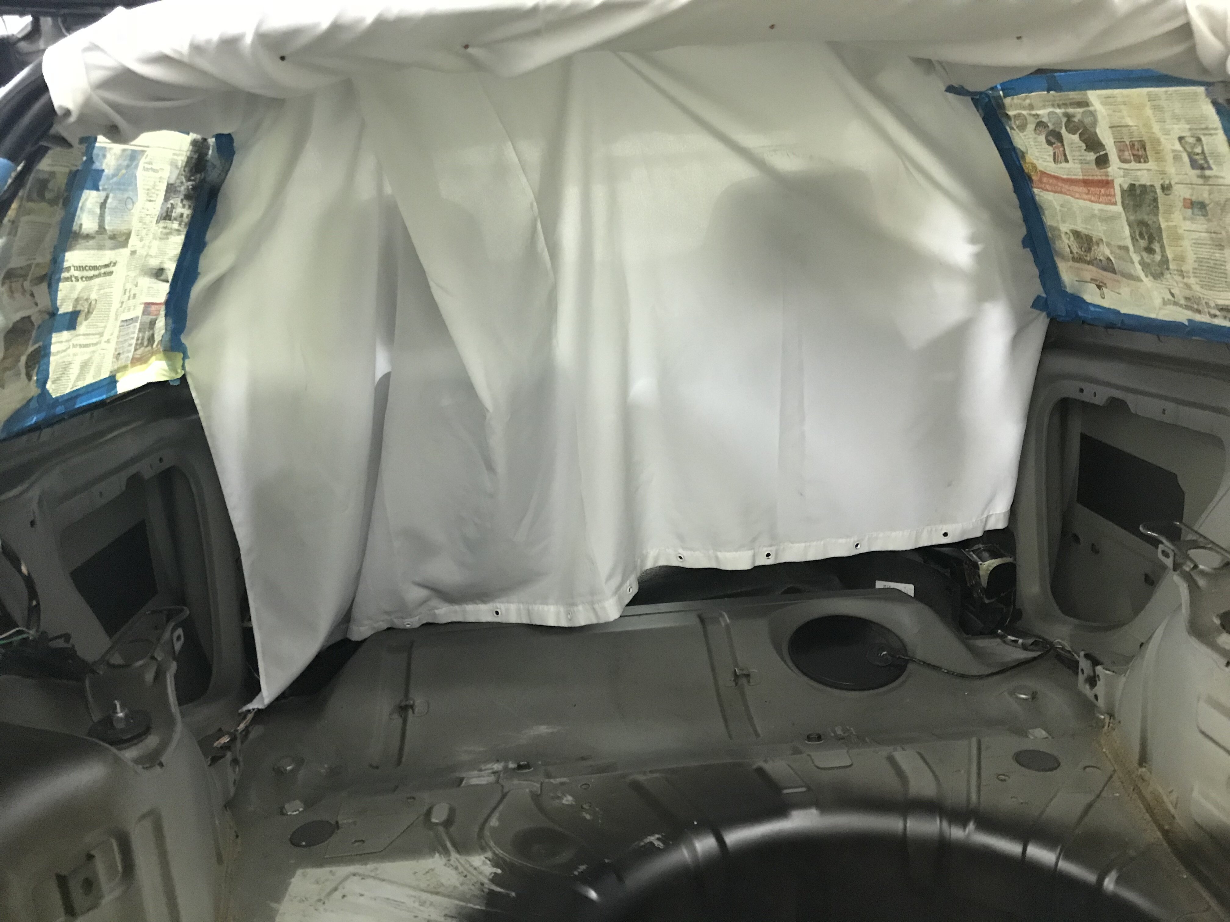

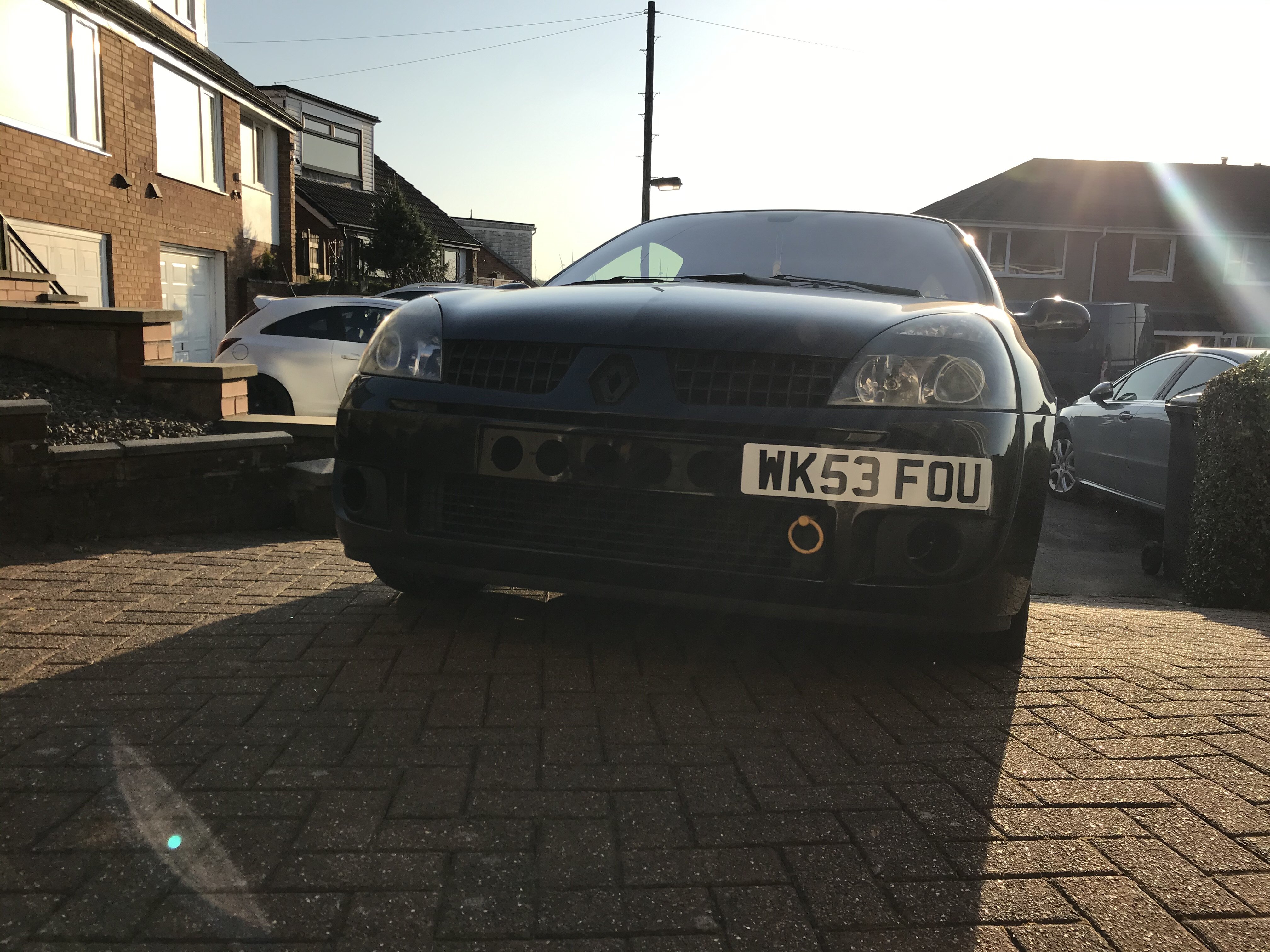

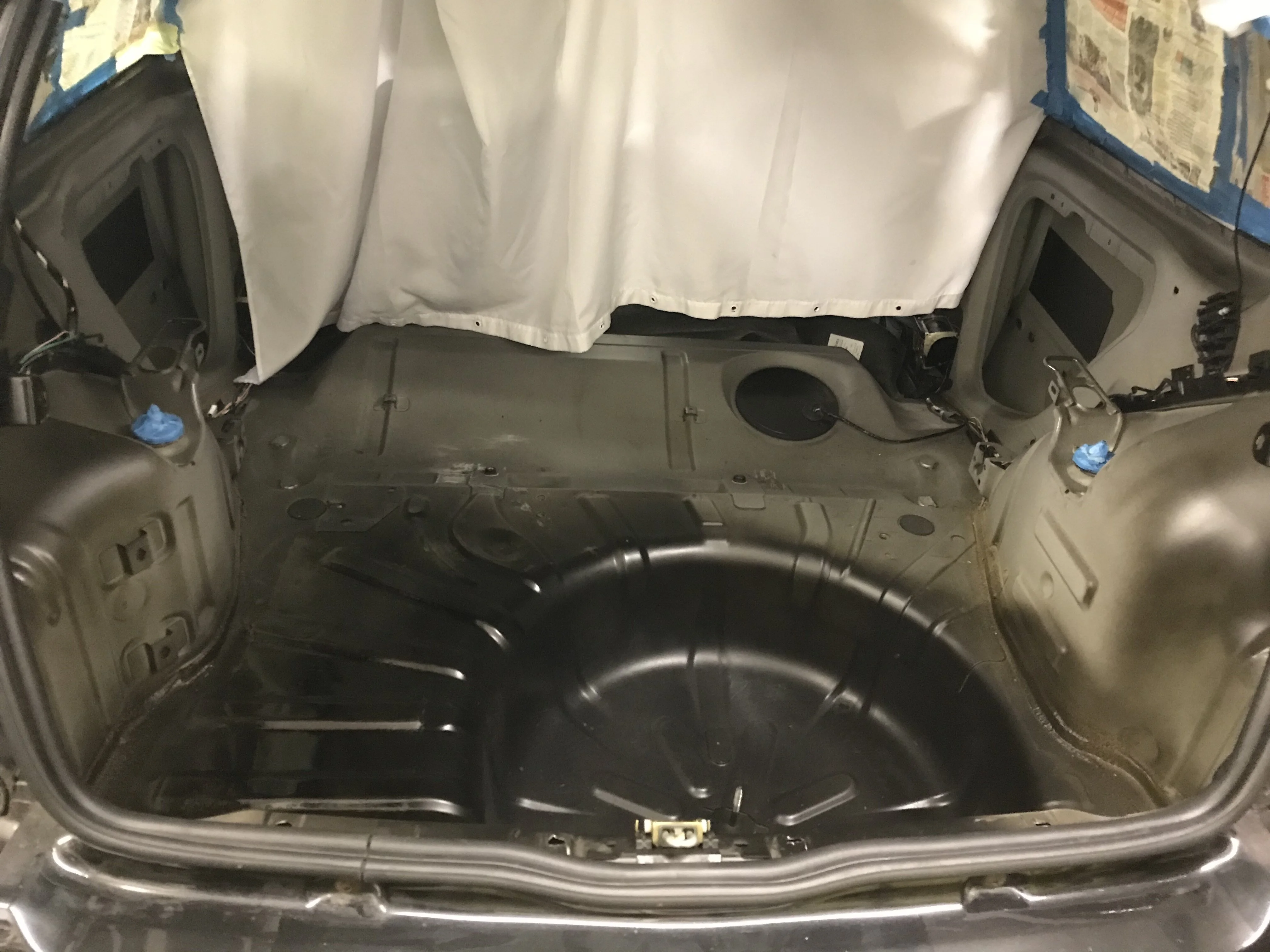

Into 2018 now, I went and bought satin black rattle cans, and a cheap shower curtain, and set to work!
Yes, I'm using a vacuum cleaner for overspray removal, Henry was off his tits.
Despite this, it actually stunk of paint for weeks afterwards. Ended up leaving it open with a heater in it in the garage to help it all gas off.
Then, when it had dried, I booked it in to get the cage fitted and powder coated.

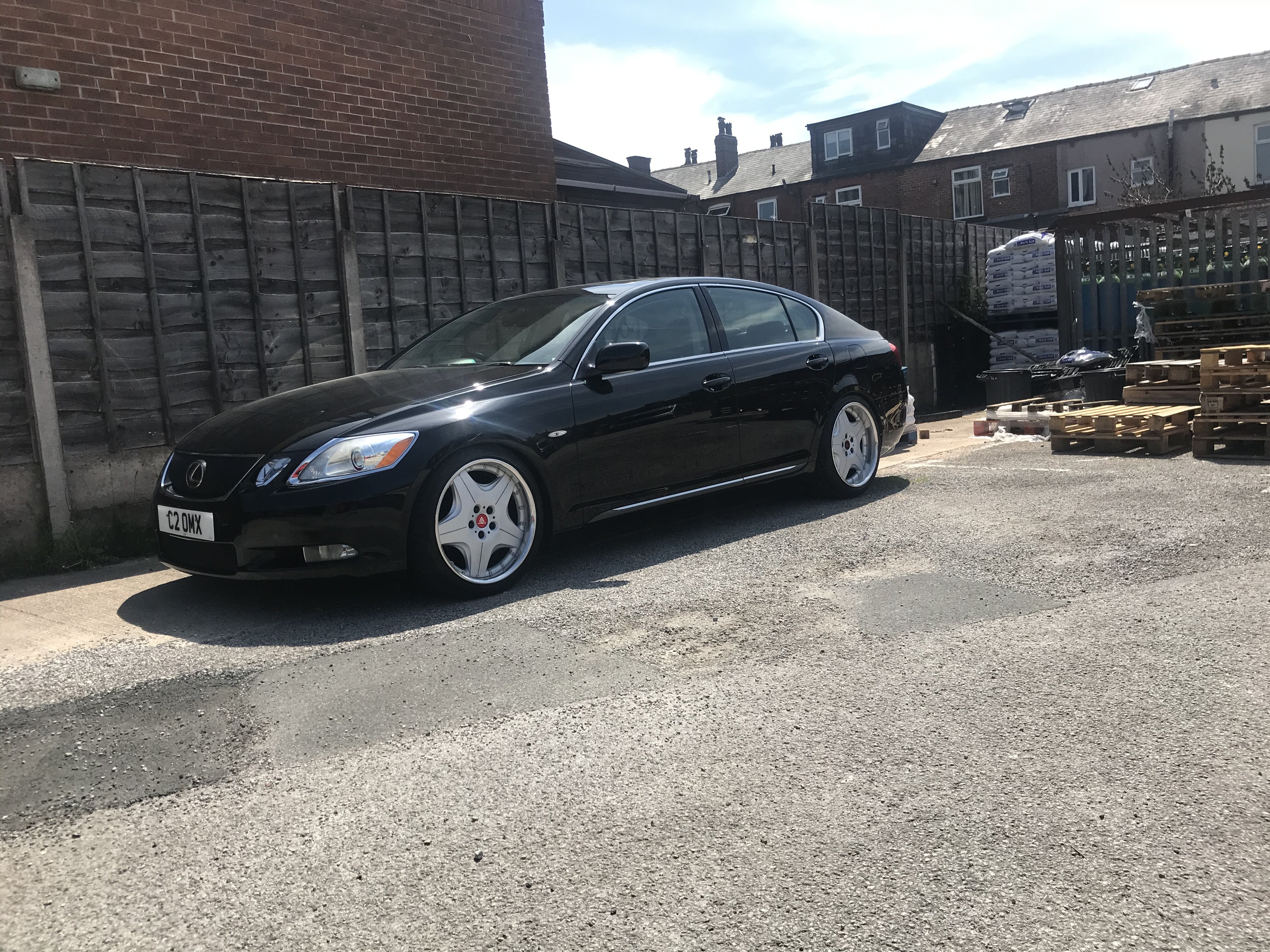

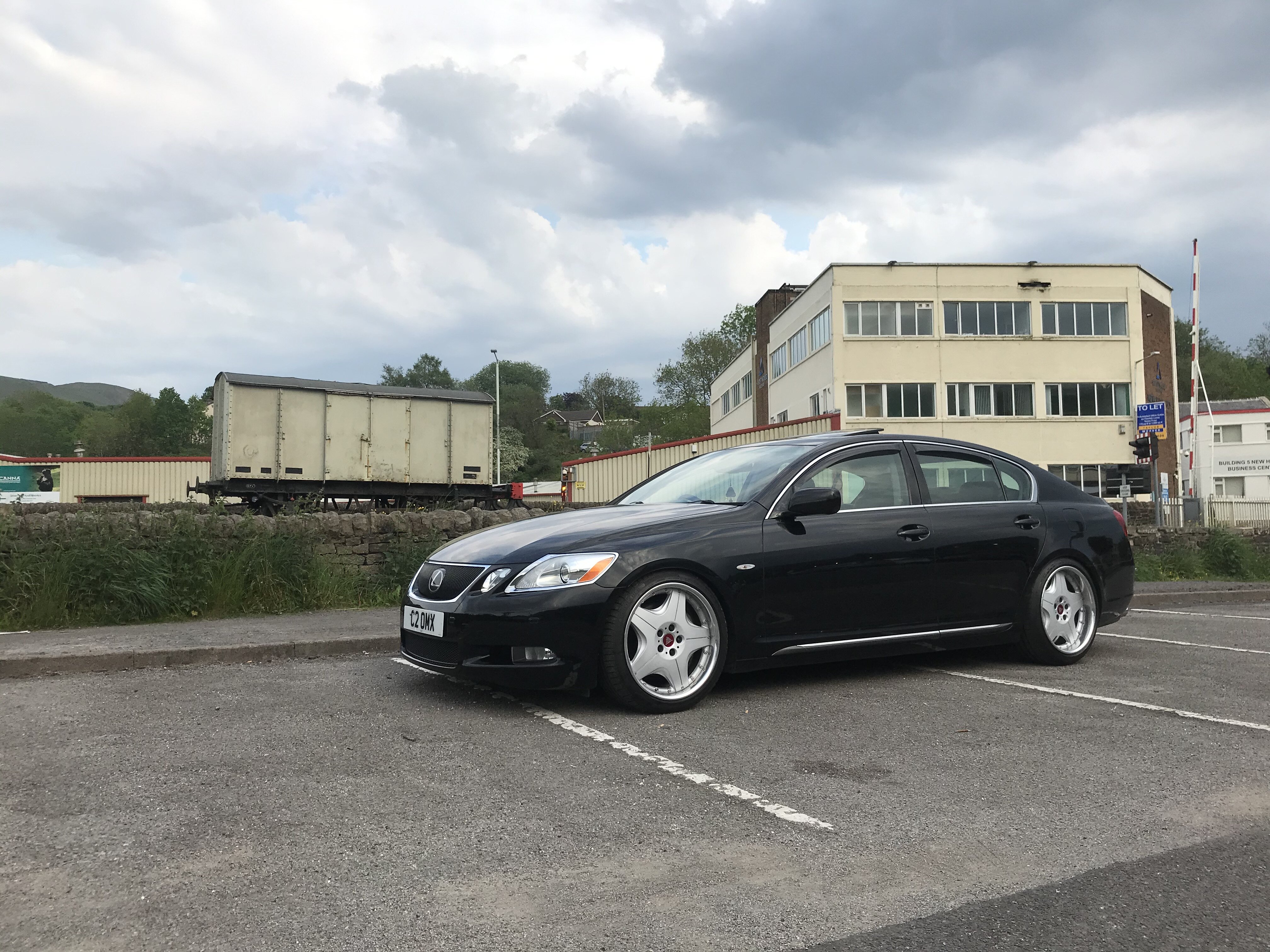

From approx 2019 I owned a Lexus GS430 as my daily. I was doing low miles and planning on buying a house closer to work, so I was loving the VIP life.
I bought it completely standard, and proceeded to ruin it with 19s, coilovers, a full stainless exhaust, induction kit imported from the US, and a paddle shift wheel from an IS350, wired in to work correctly. This should explain the gaps in the Clio timeline as I had another toy to modify. I spent most of the first lockdown hand polishing the wheels, referring the kerb marks and faces etc. Also drilling out all the fake rim bolts and tapping them to take capheads. they were genuine 2pc JDM wheels, but were welded, so would have been a b**ch to split, if that makes sense.
Ended up like this, and I wish I still had it. This was sold to a sound lad called Jack from Bury/Whitefield/Manchester way, and I believe its on air now.

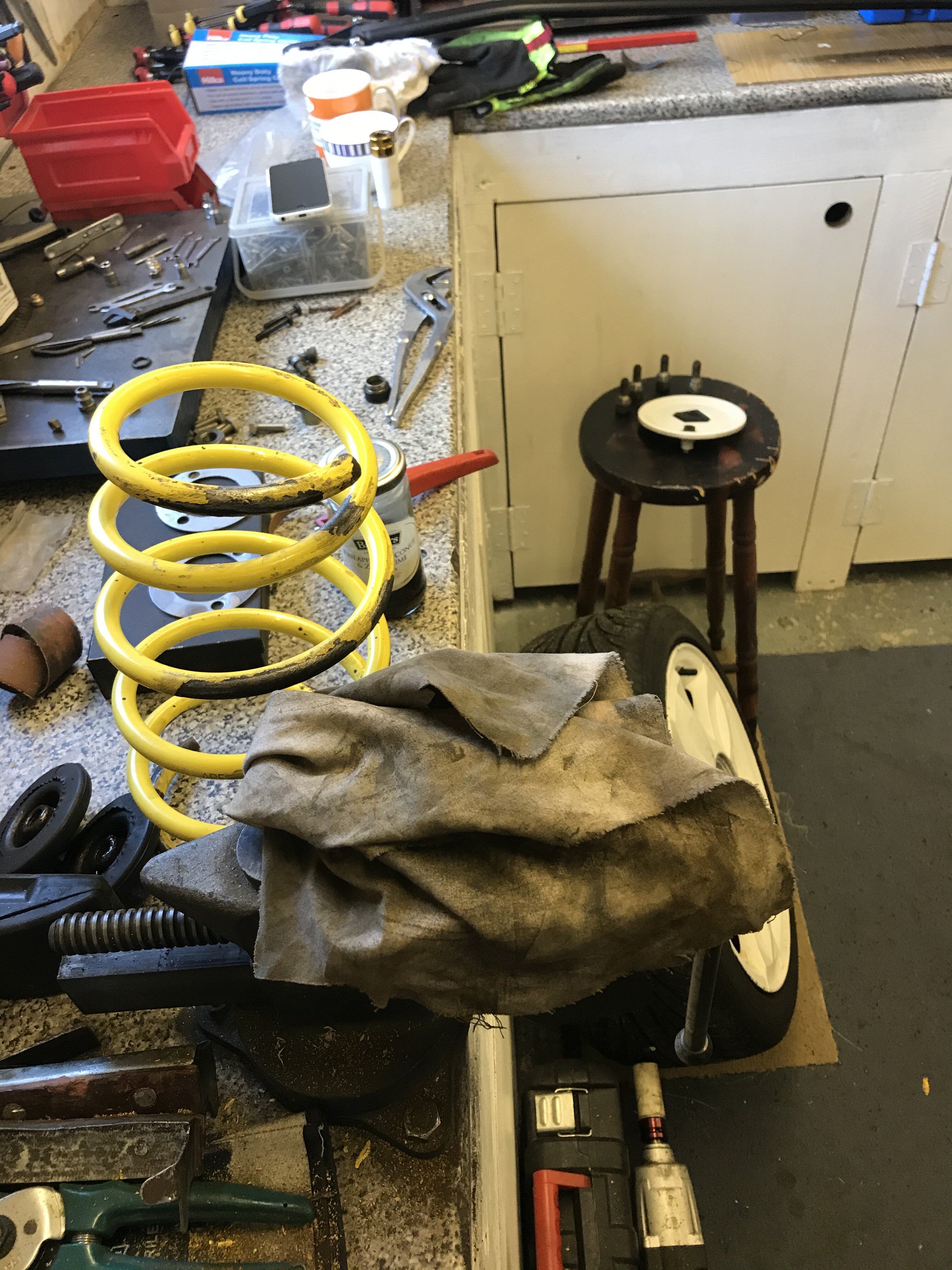

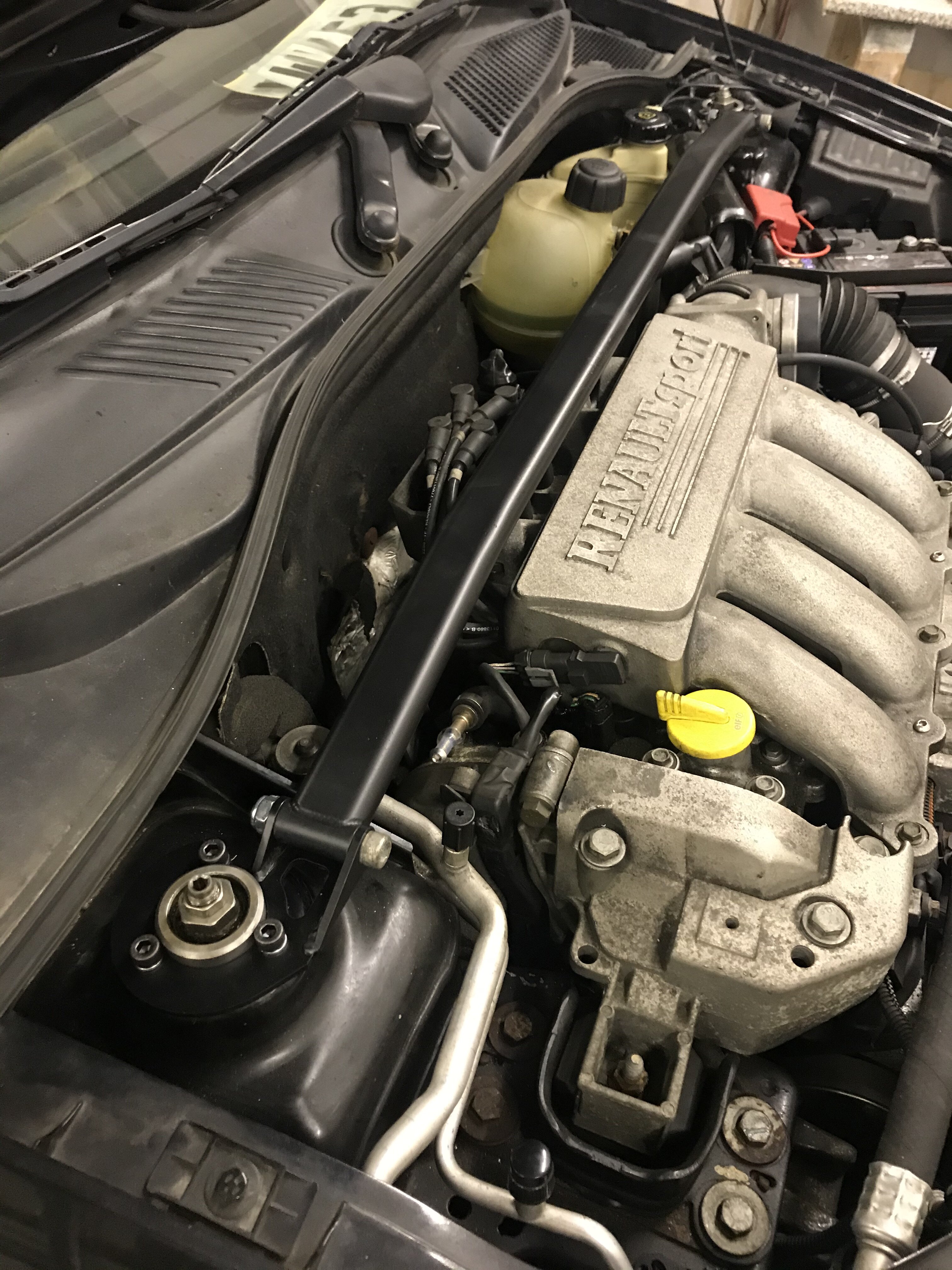

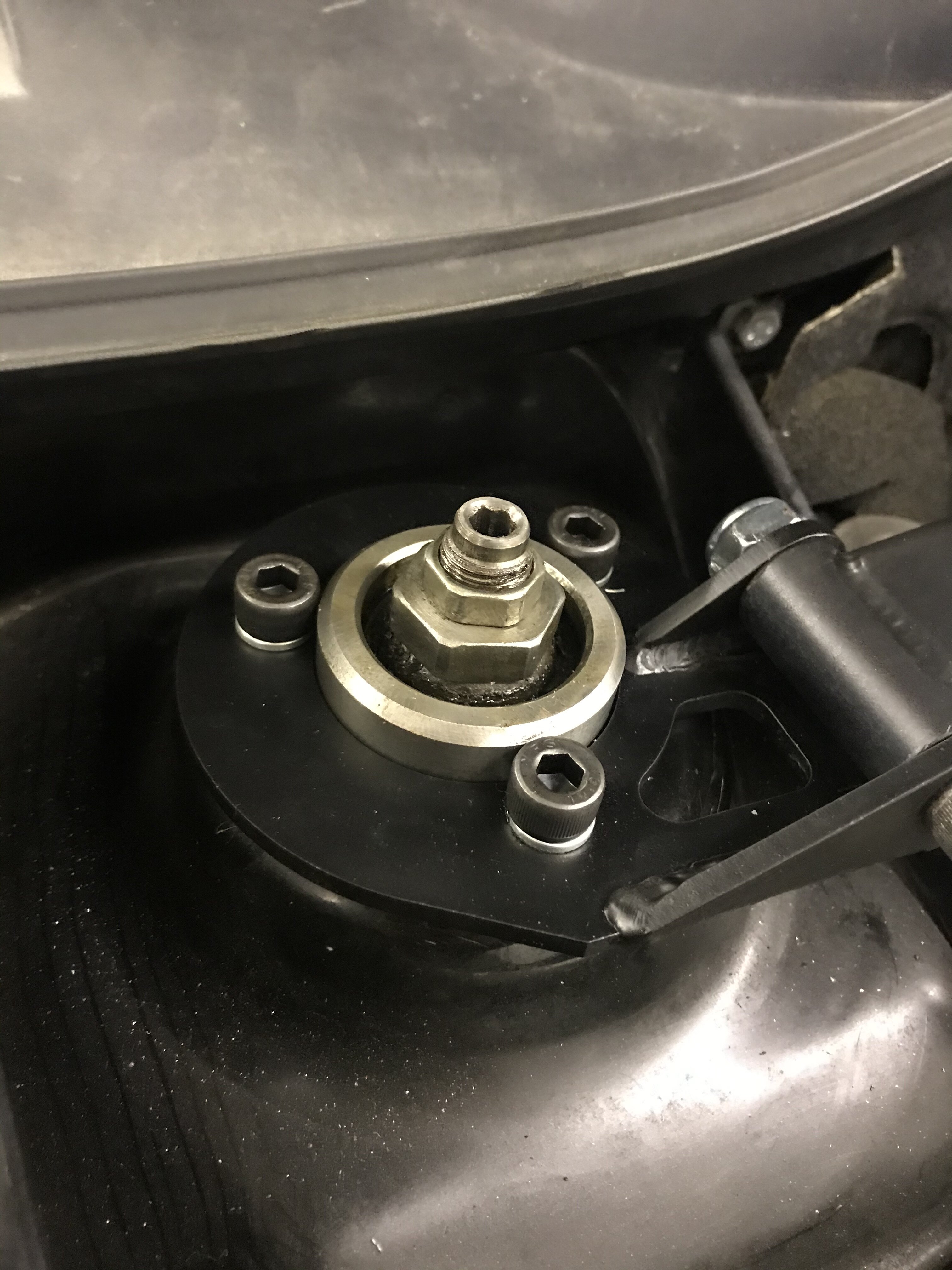

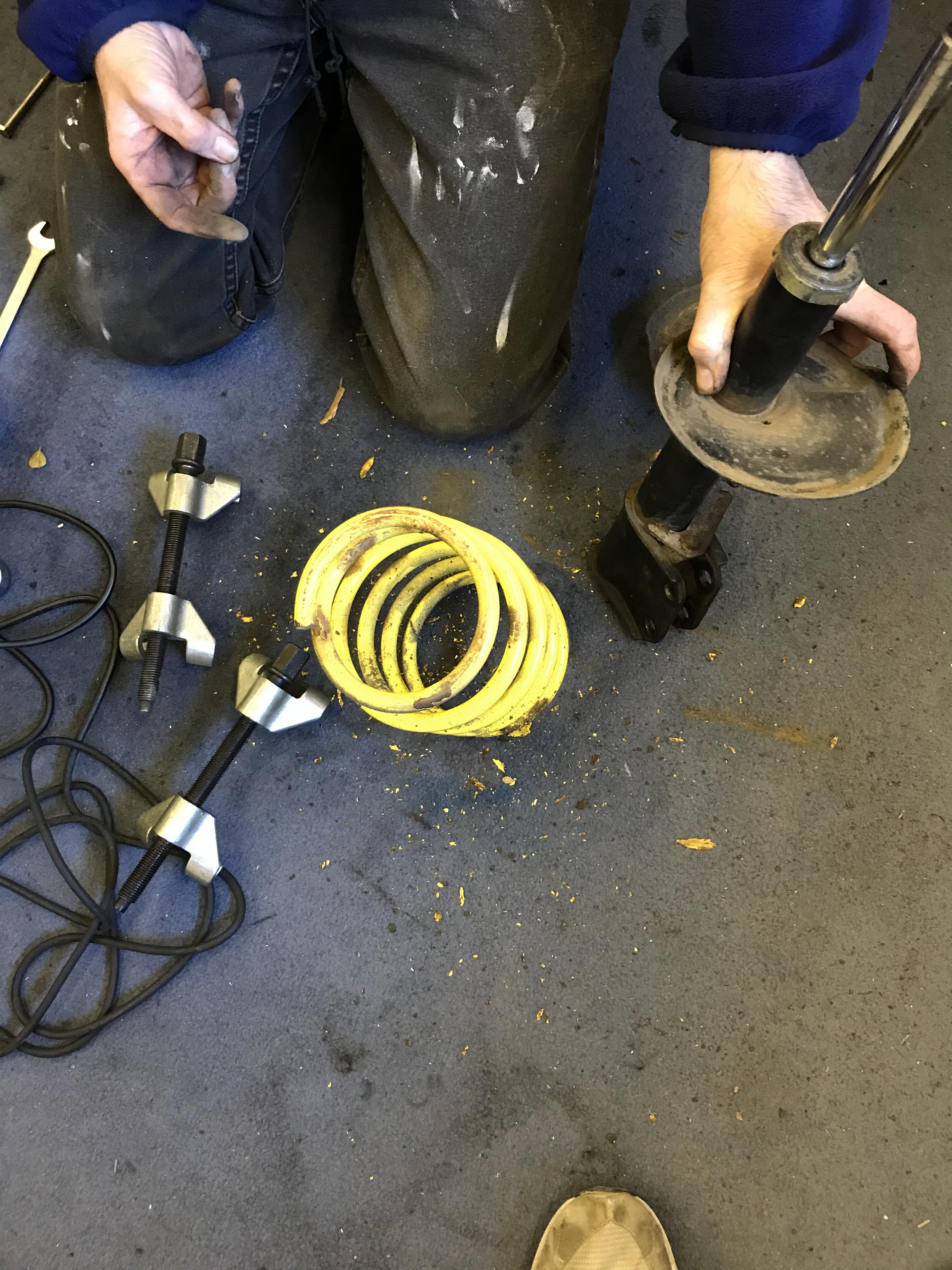

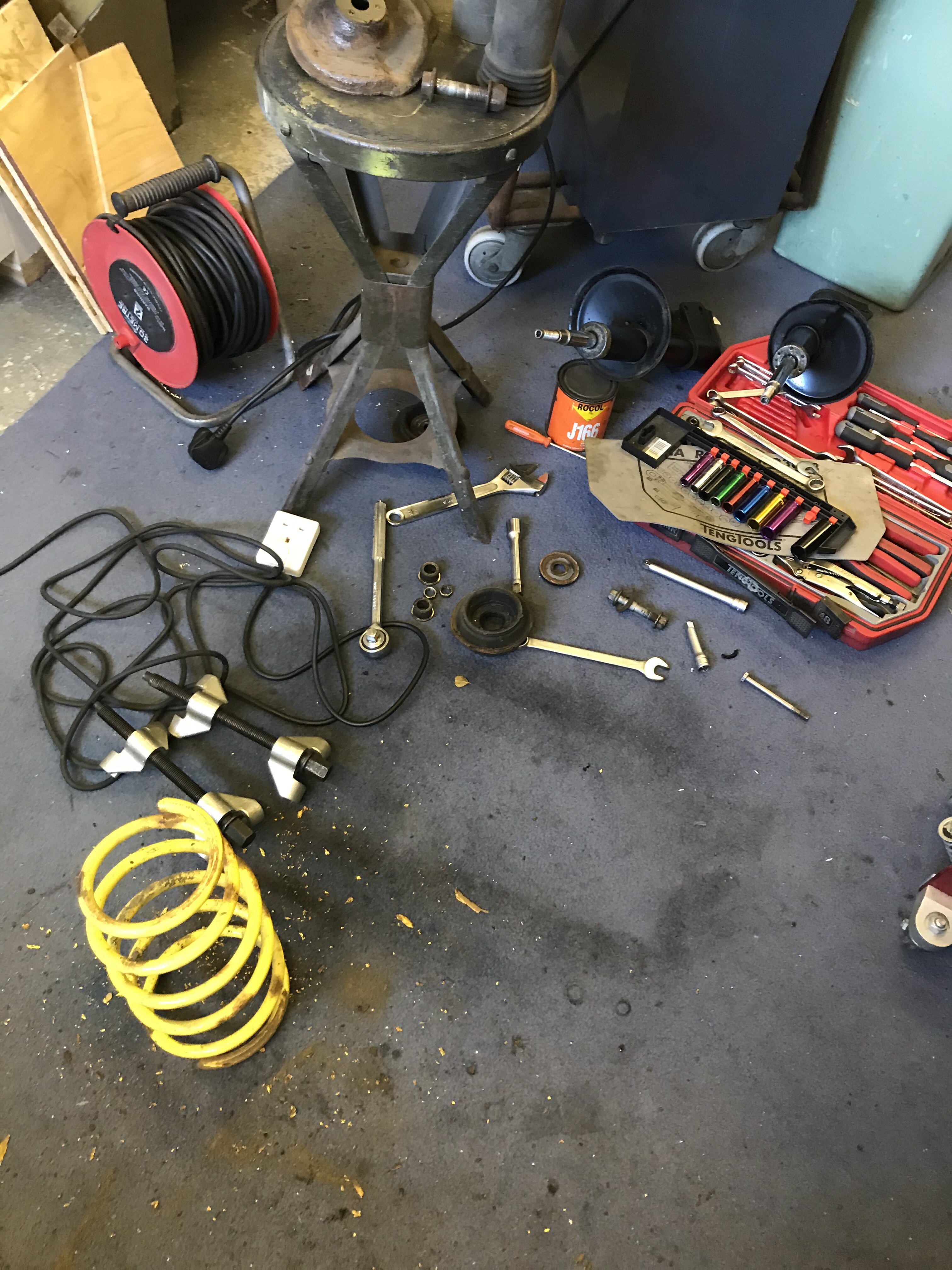

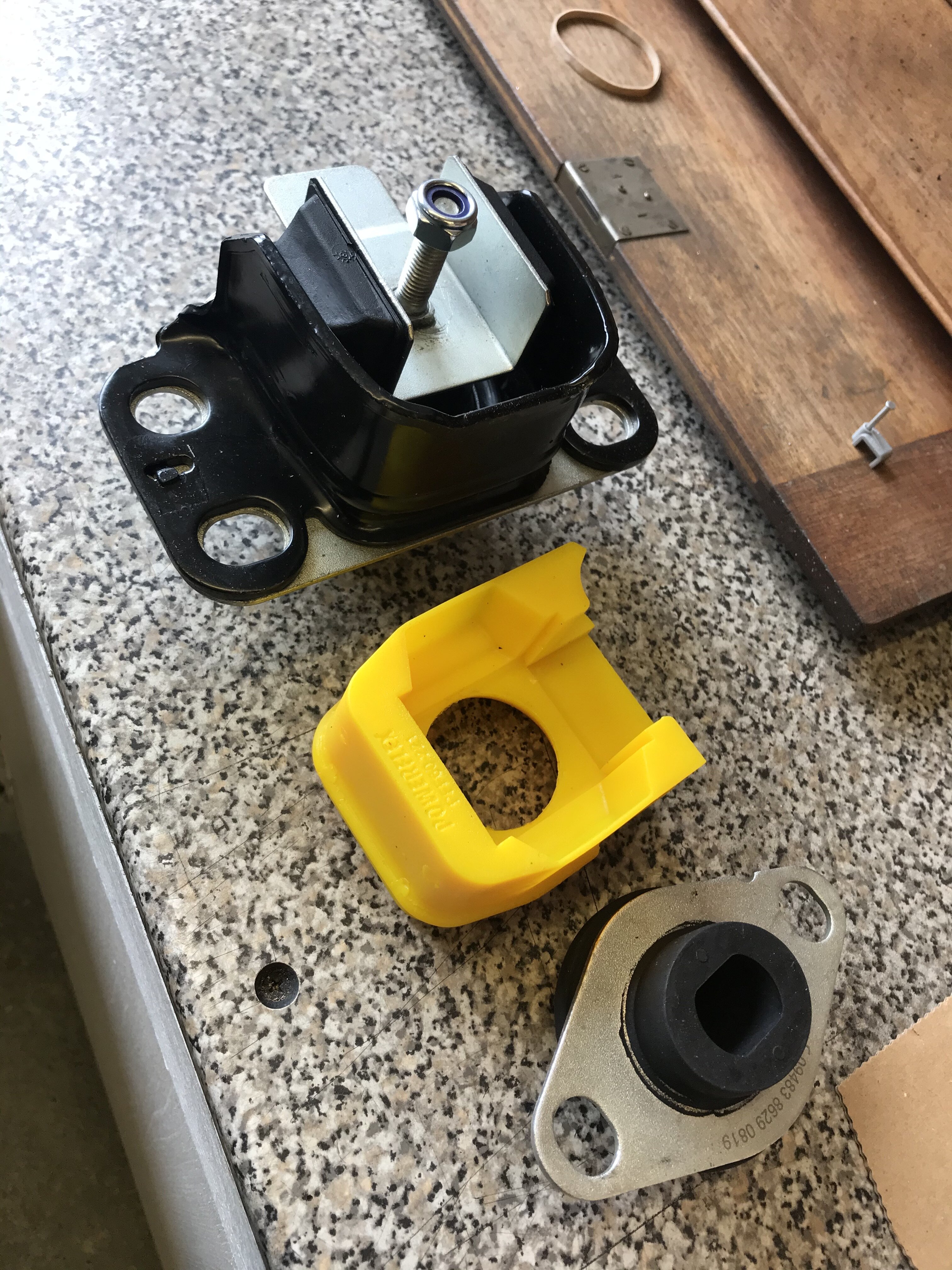

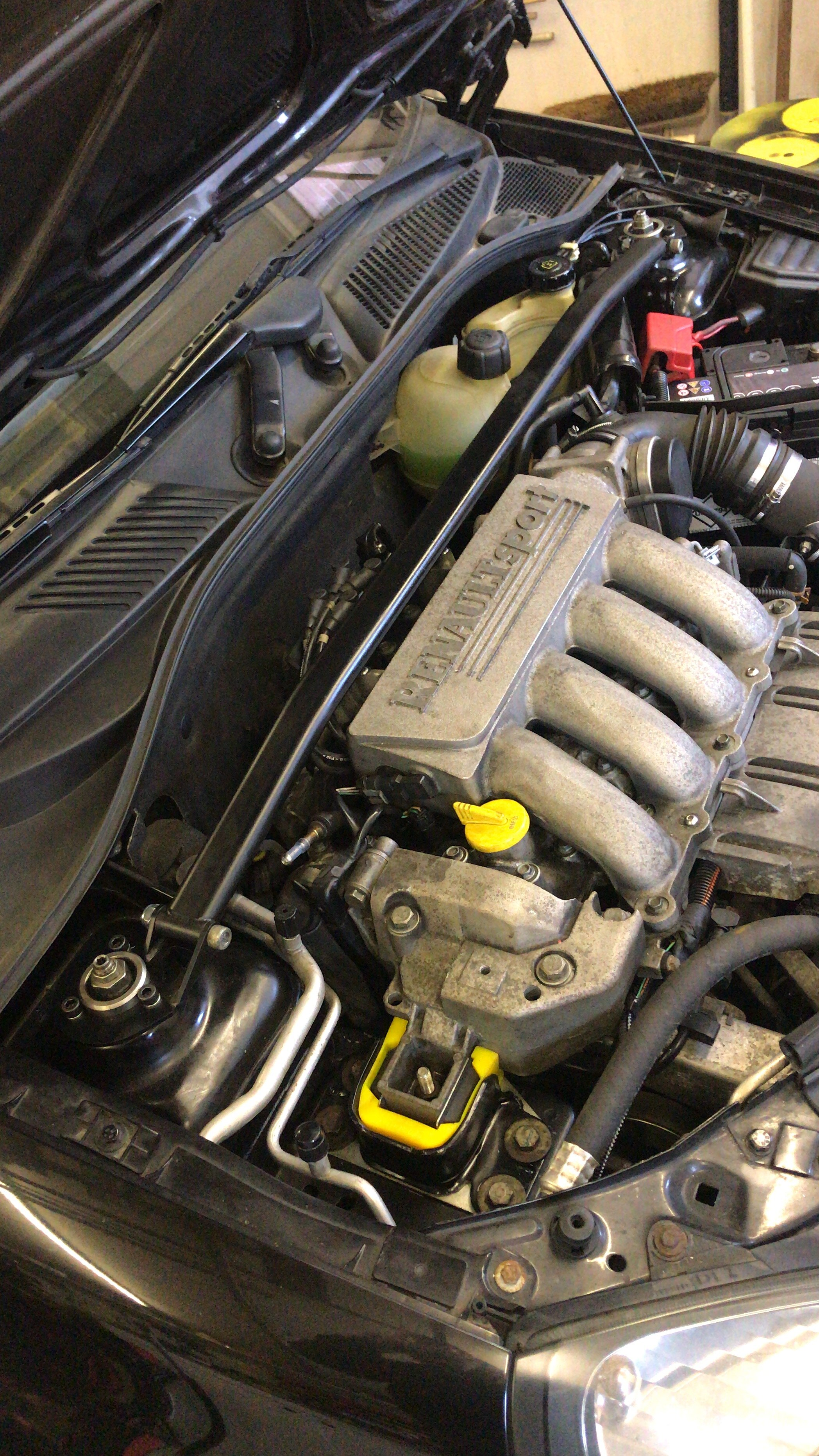

I then obtained a set of PMS solid top mounts and strut bar, and new engine mounts (standard gearbox mount, upper Kangoo mount, and Powerflex insert.
It's had new callipers since then, don't worry/
Something rings a bell about fitting new dust boots on the shocks too.

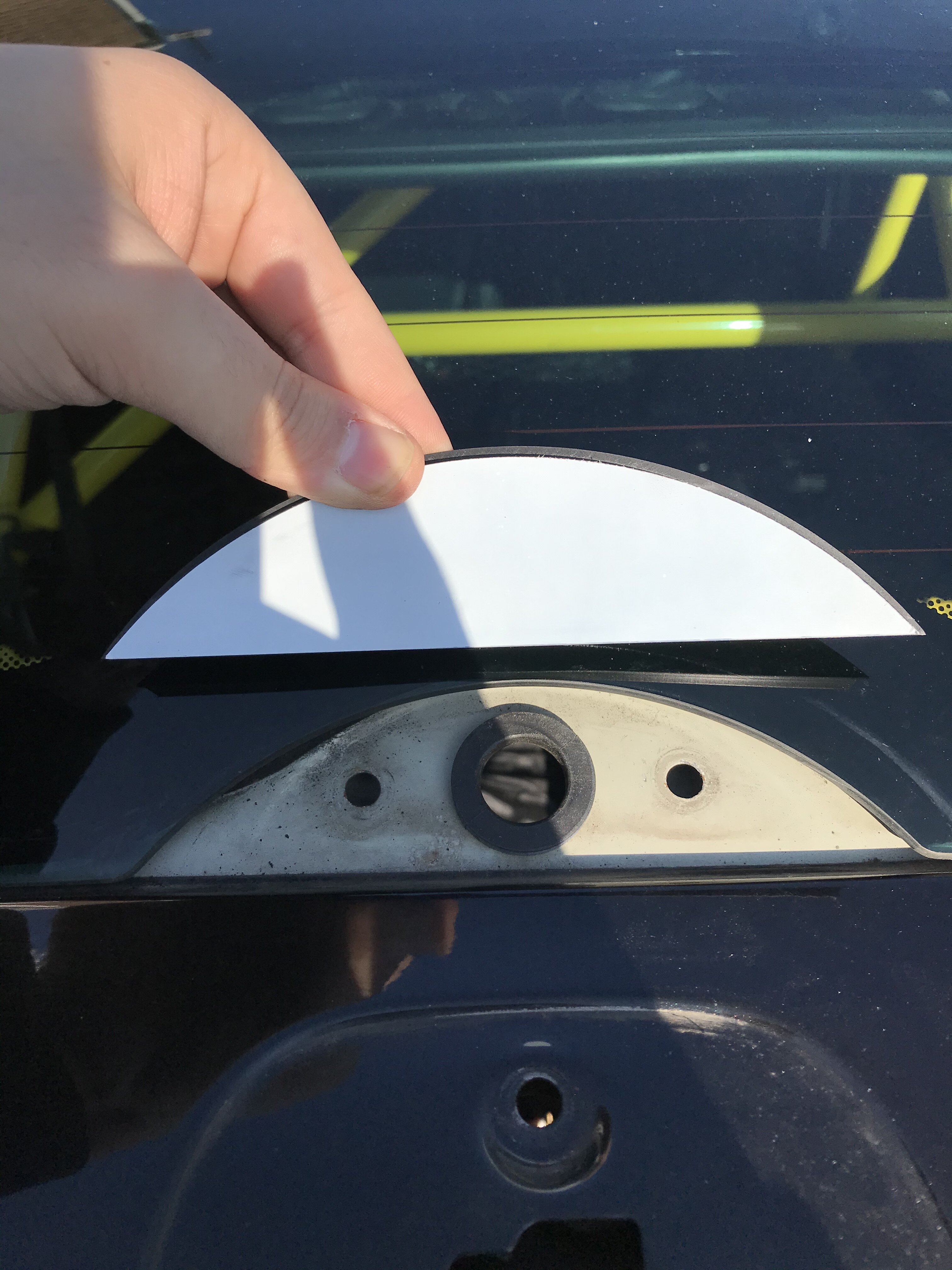

Also got a glass rear wiper blank too. It was an absolute ball ache to fit, but its done now.

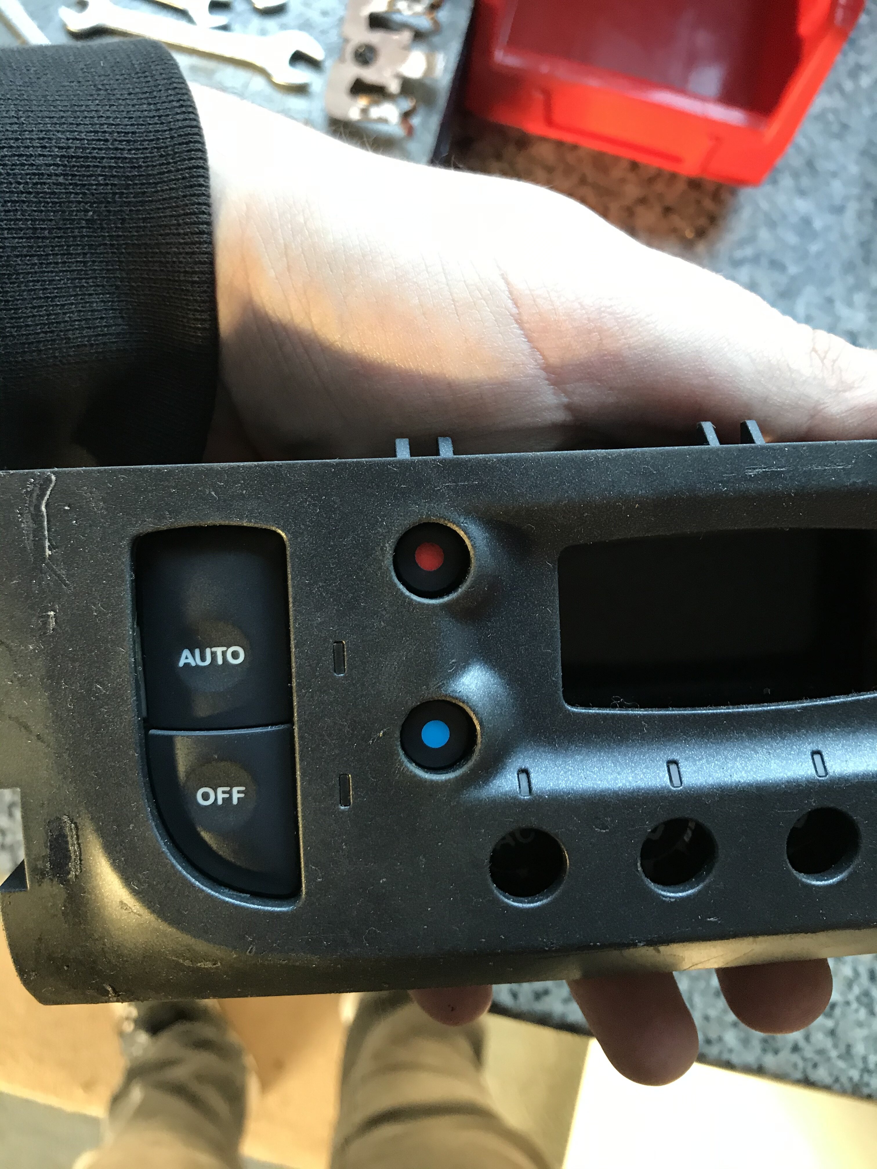

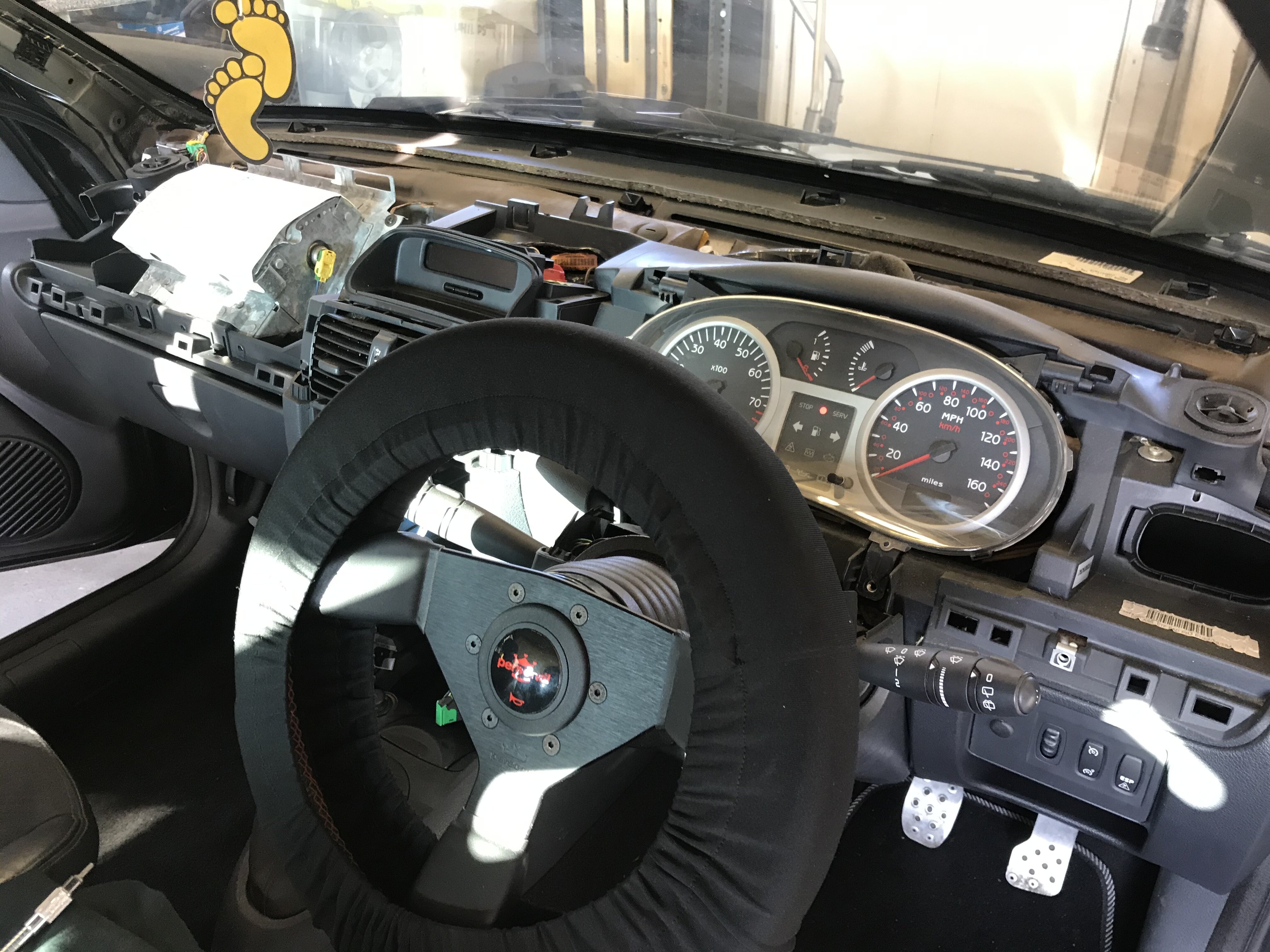

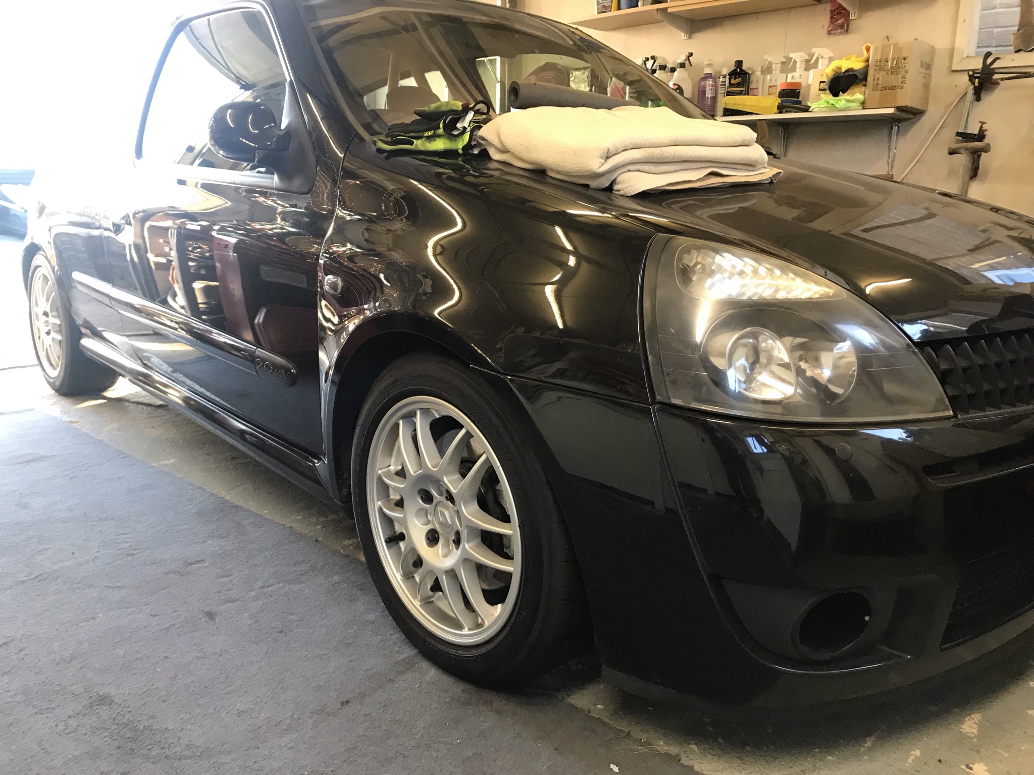

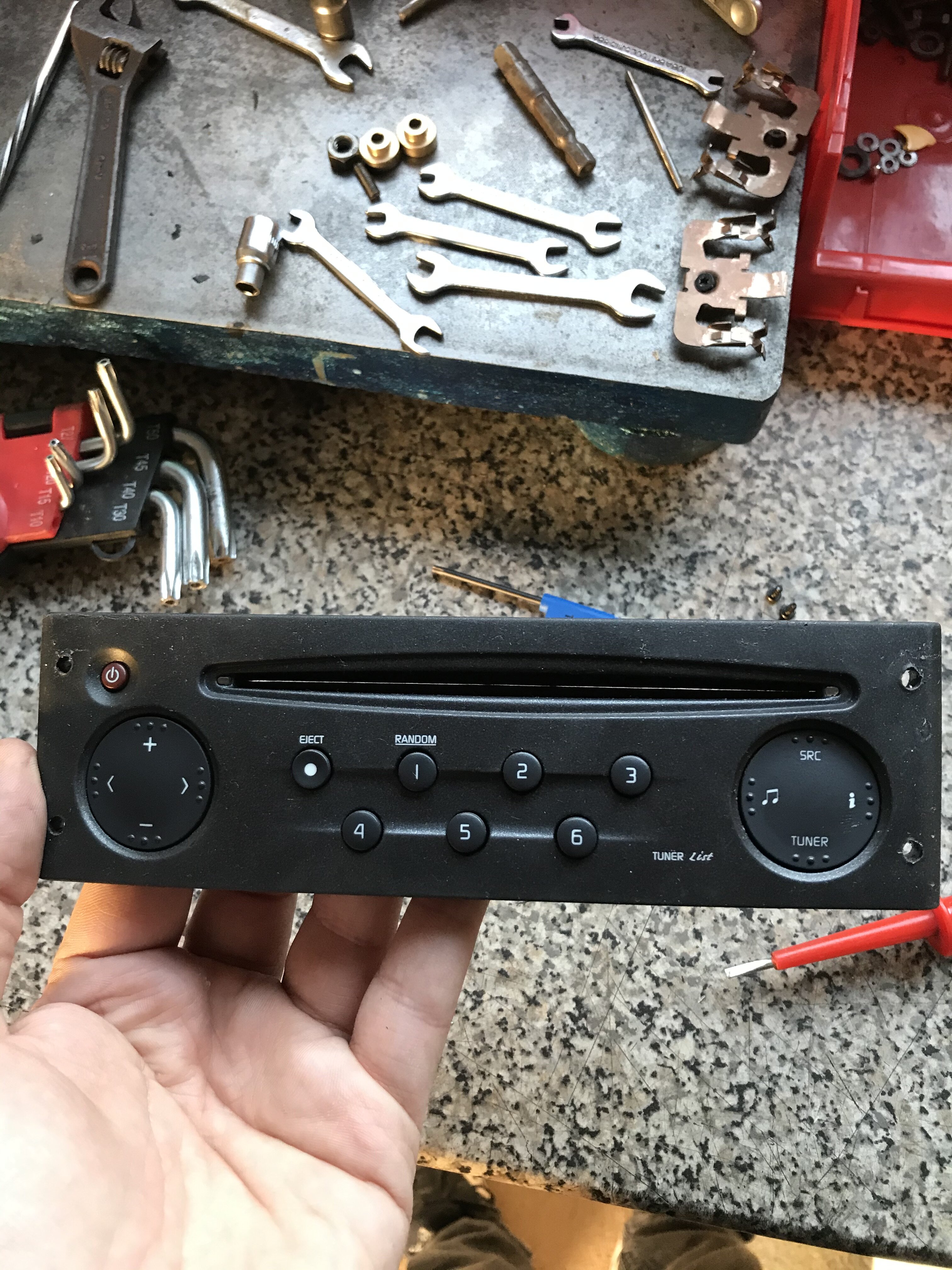

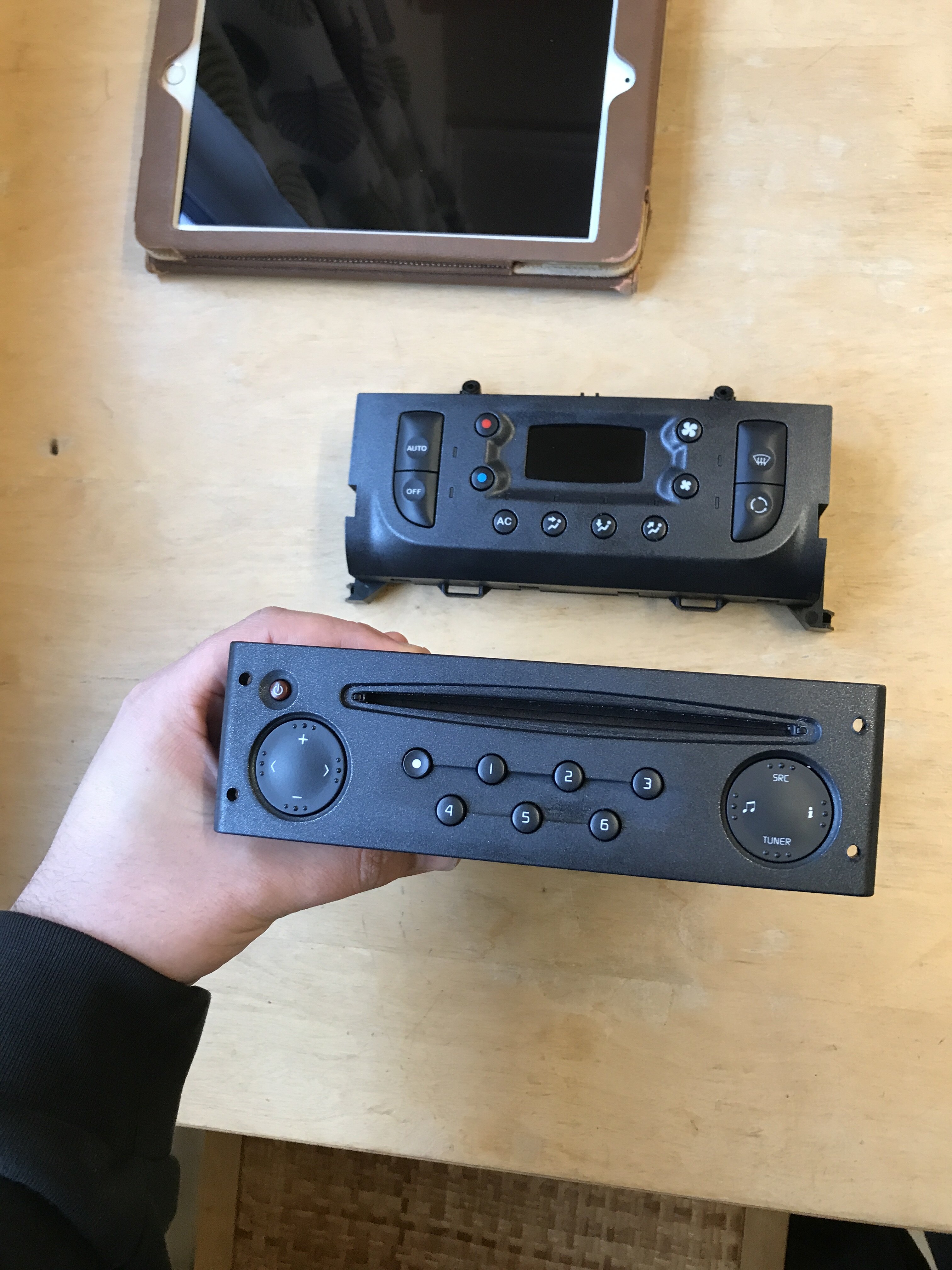

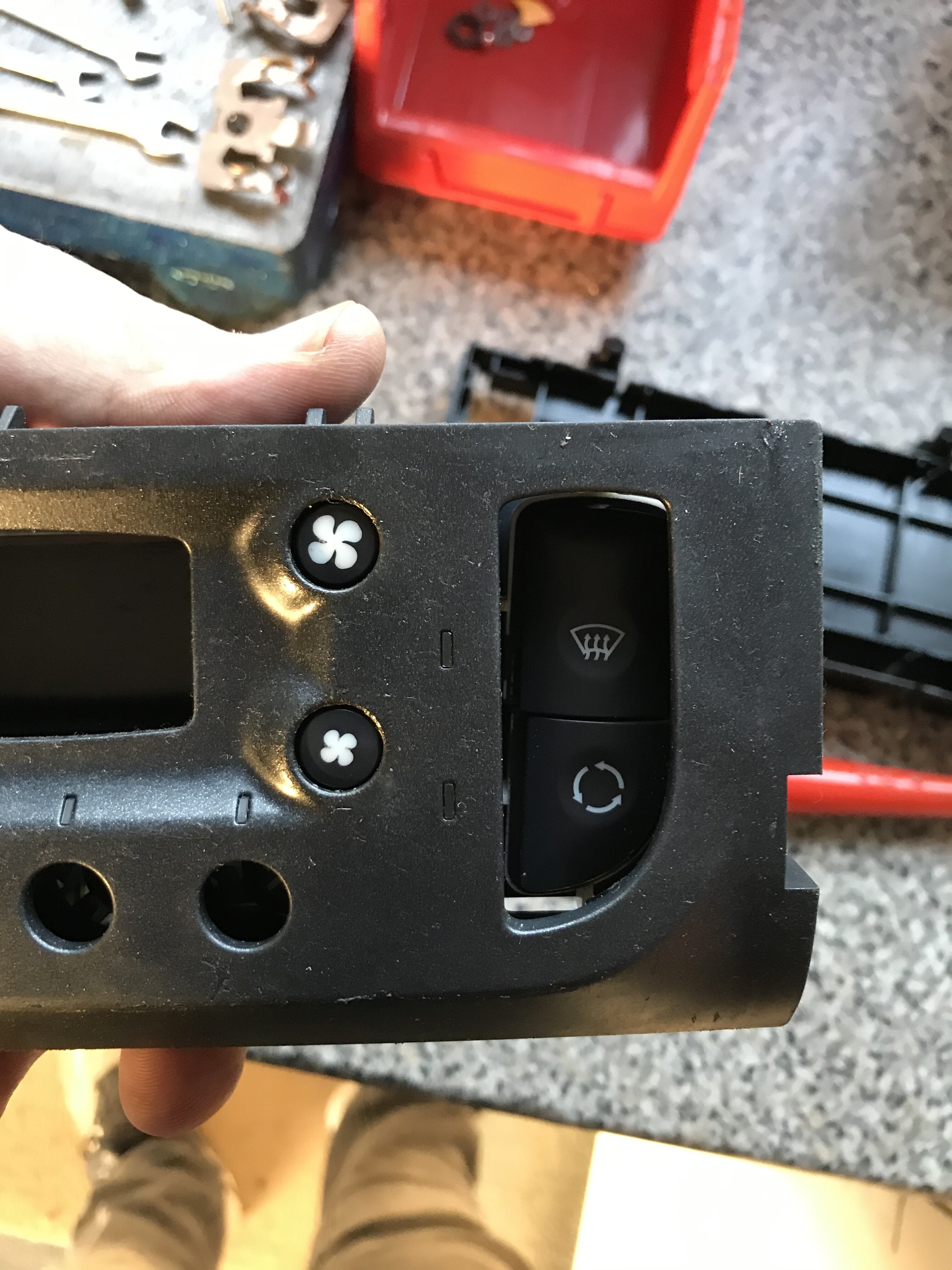

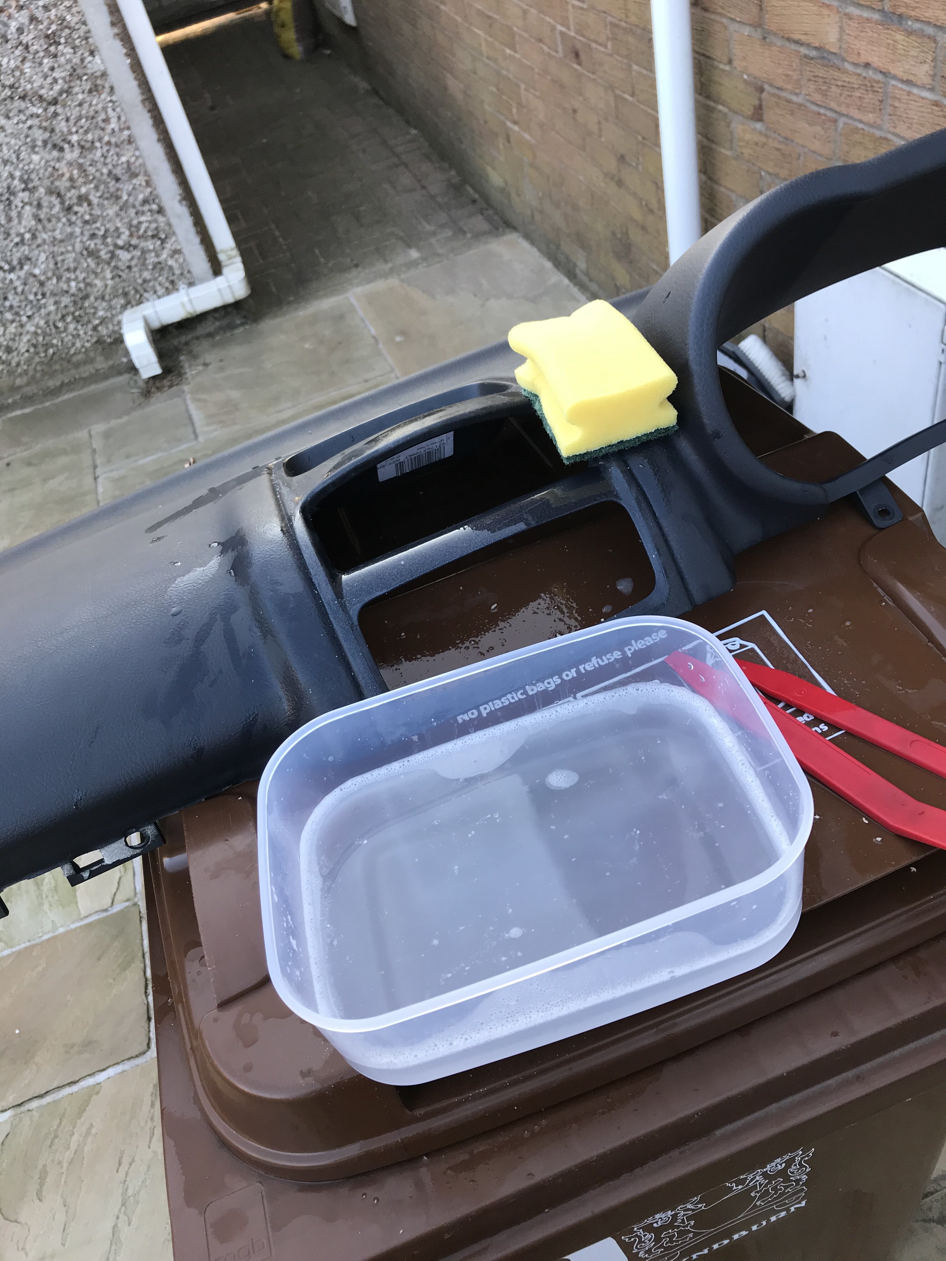

Then, determined to get rid of the sticky interior, I replaced what I could, and for the rest........
Pretty pleased with that! Then I felt like I'd completely lost my marbles and washed my dashboard :ROFLMAO:
Nowhere near as fazing as I thought it would be! Pretty easy! Out of the cocktail of chemicals I used, I think it was the Elbow Grease that worked the best, but also warm water and patience worked equally well.

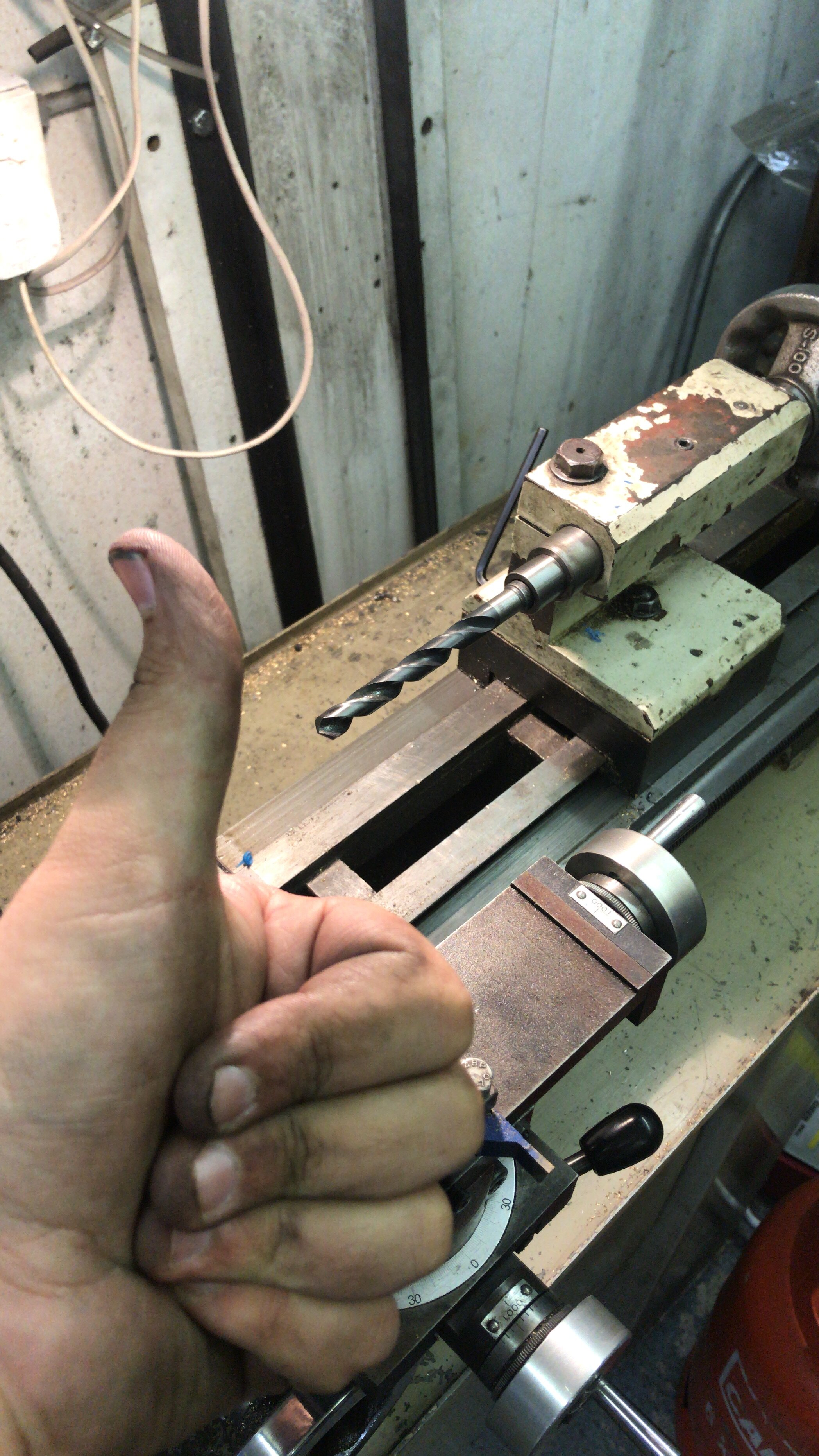

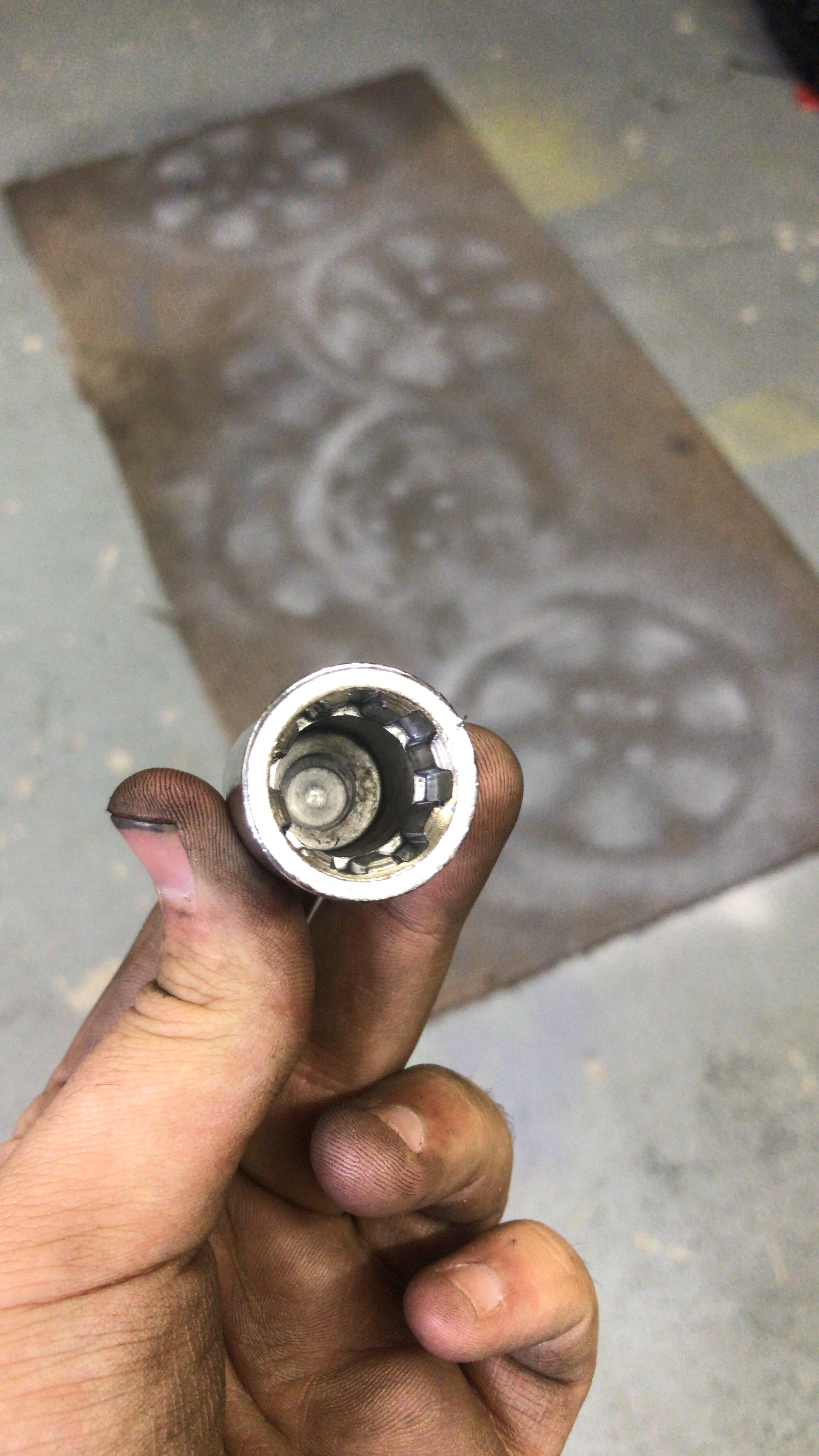

I was having trouble getting the locking wheel nut key on with the extended studs, so had an excuse to play on the big toys.
Literally the most pathetic bit of machining I could have just done on the pillar drill instead. But still.

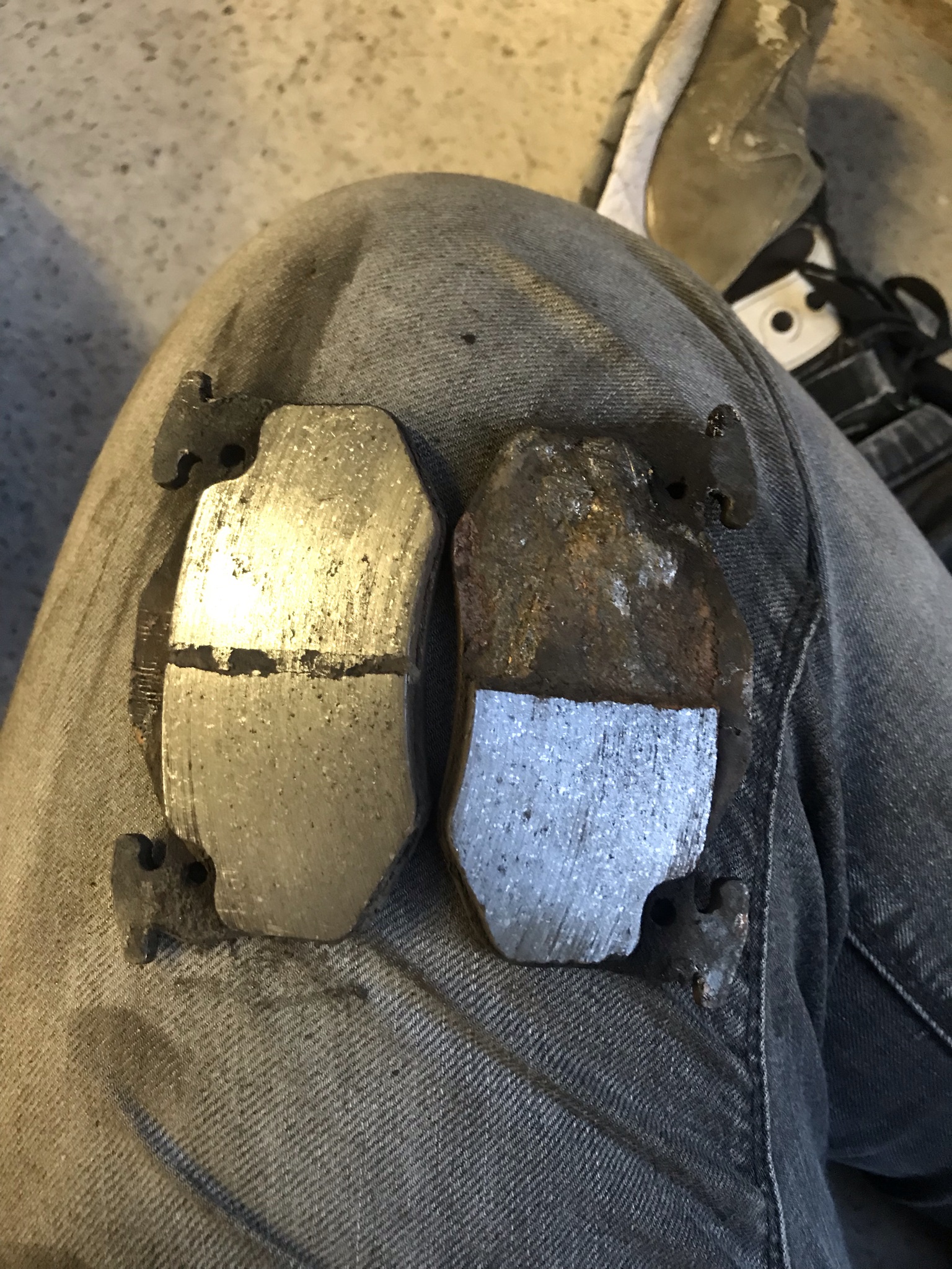

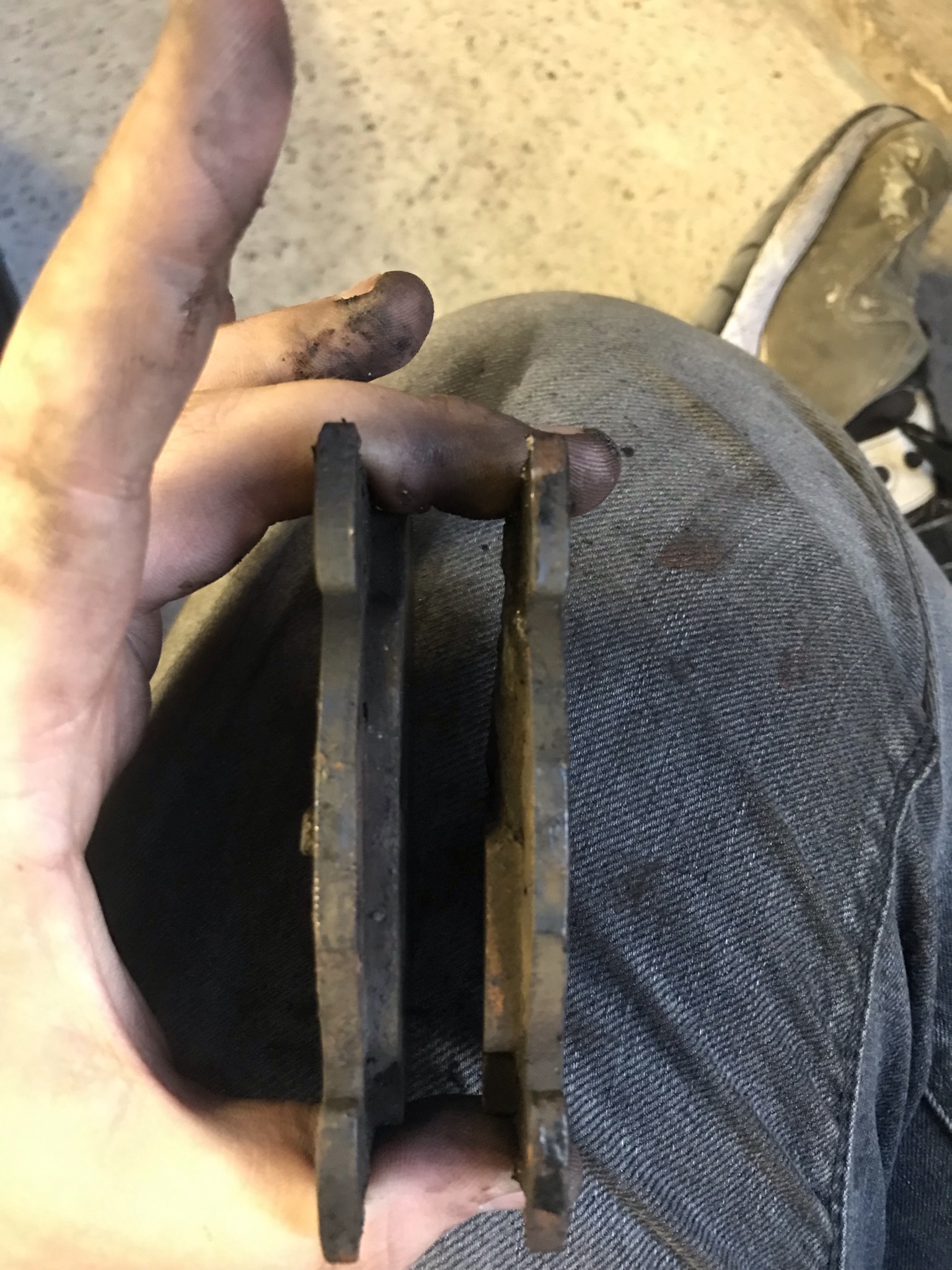

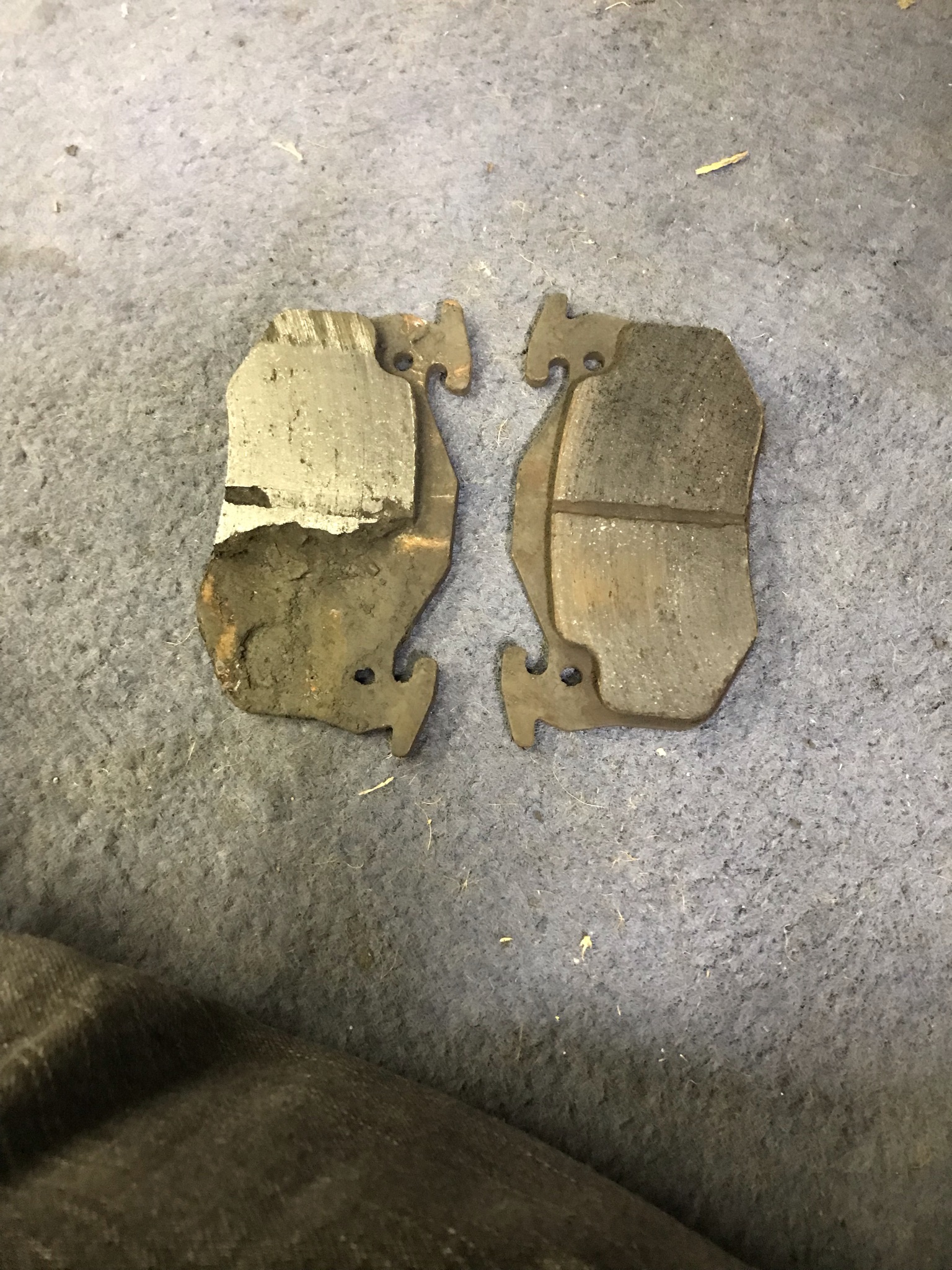

Prepping for the next track day, did the rear pads.
Strange how both sides have failed and delaminated... I did have issues with a seized calliper and wazzy handbrake cable so can only imagine they've got a little warm.

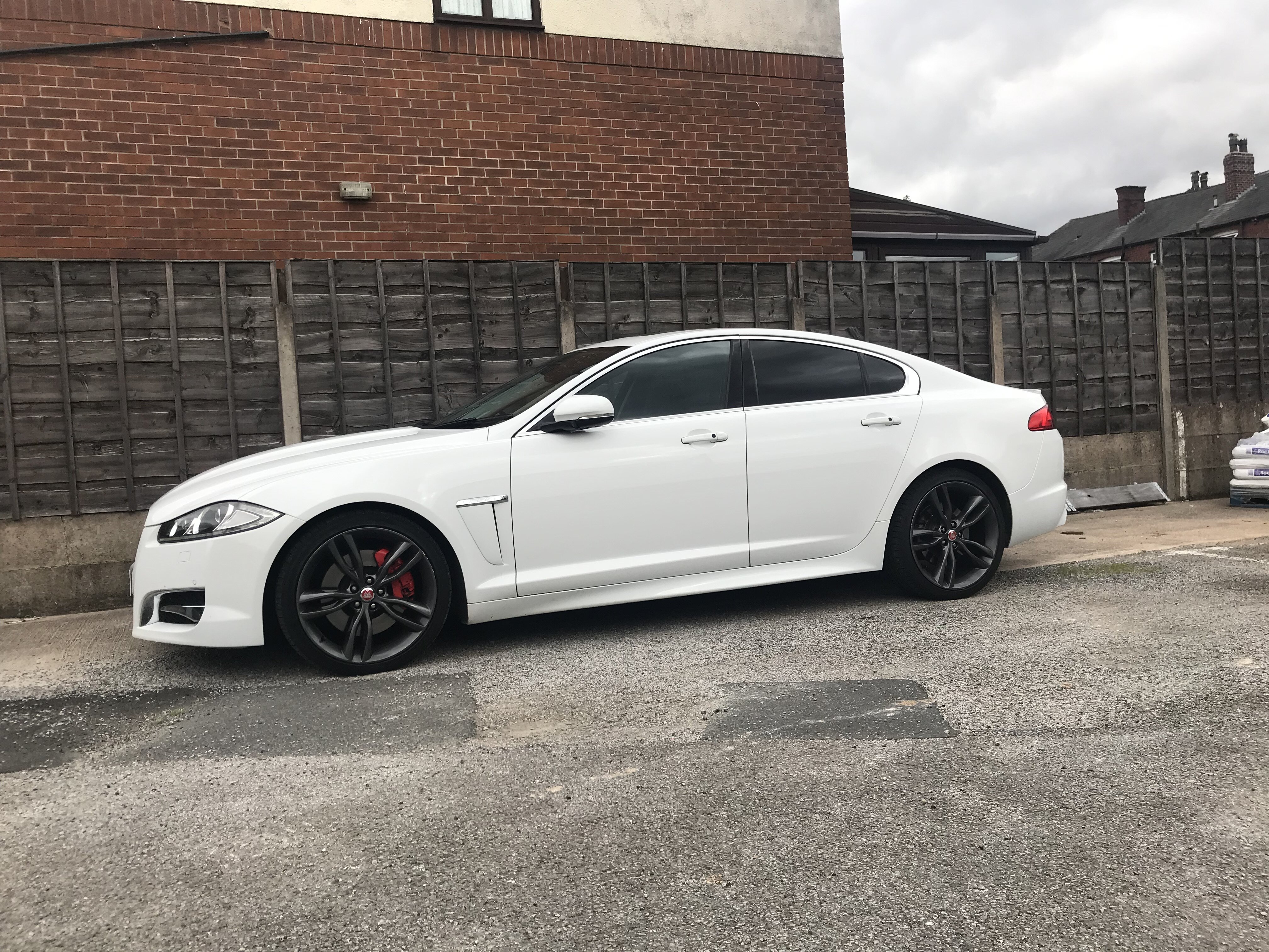

I bought a facelift Jaguar XF-S. 3.0 twin turbo diesel, 8 speed ZF autobox, 275bhp. Managed to get one with the carbon fibre interior trim as well.
Now despite being a lovely car to own, a great car to drive, genuinely quick and handling surprisingly well, it decided to break down at every opportunity and cost me an absolute fortune. I bought it for £8,000, spent probably close to £4,000 fixing various issues, and almost 2 years to the day of me buying it, the crank snapped with zero warning, and I sold it on eBay on a no reserve auction. A gamble that saw me get £1600 for it.
That said, I did get something from the Jag's ownership that and I won't forget anytime soon, and I'm sure will last quite some time...

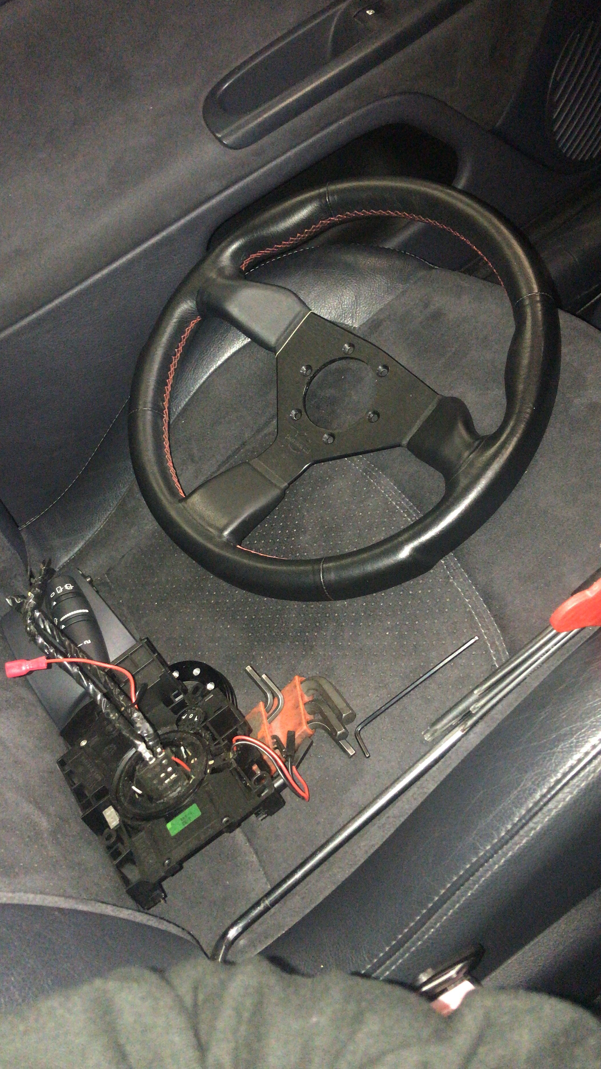

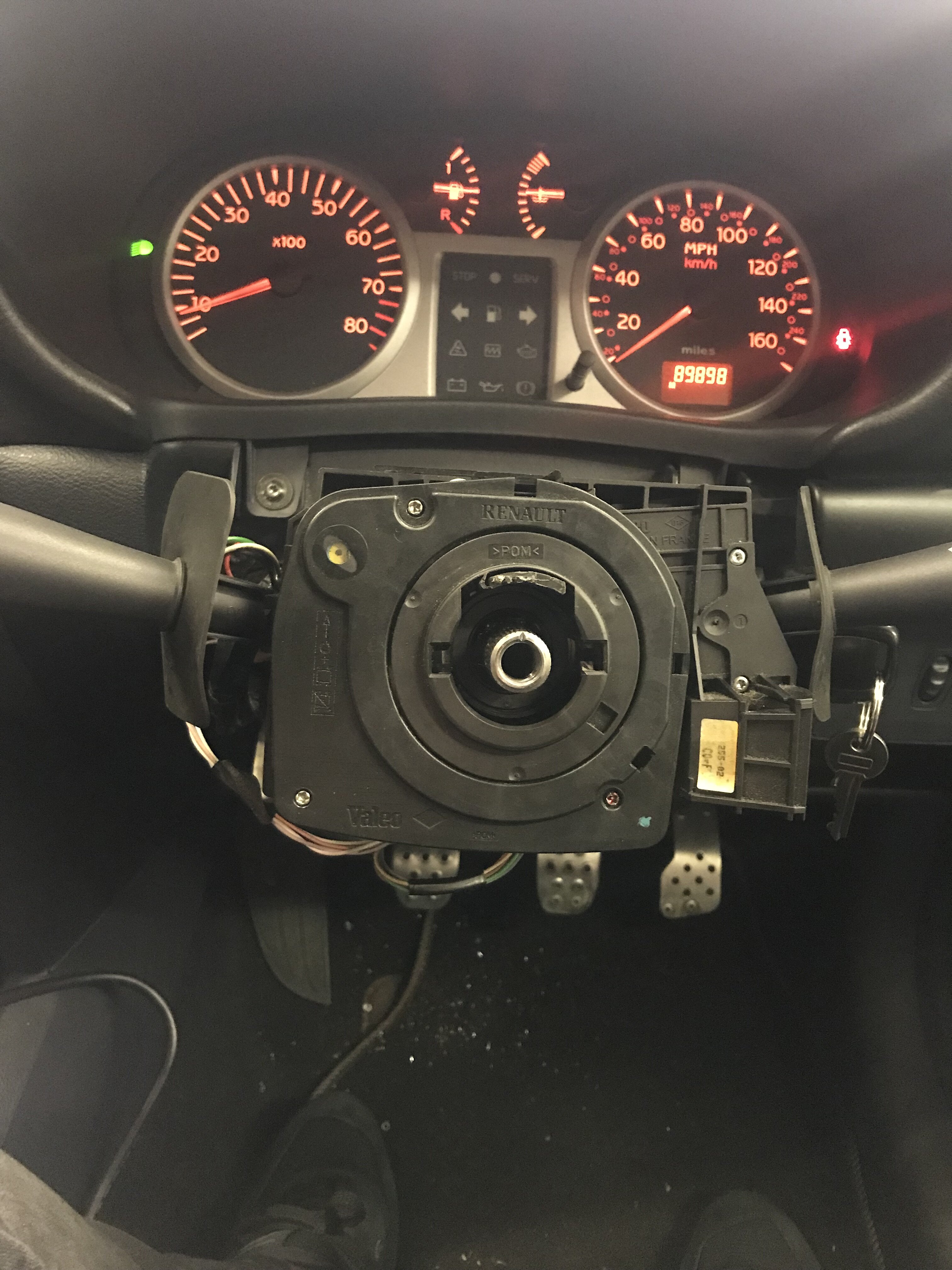

I decided I needed to get the steering angle sensor issue sorted, and began buying sensors and squibs etc to try and rectify it. My options were to either pay £120+ for a known good steering angle sensor, or keep buying second hand ones that are a gamble, but cheaper.
Naturally I bought the second hand ones!
I think I ended up with about 3 squibs, and 4 steering angle sensors, but after much swearing, I was optimistic.

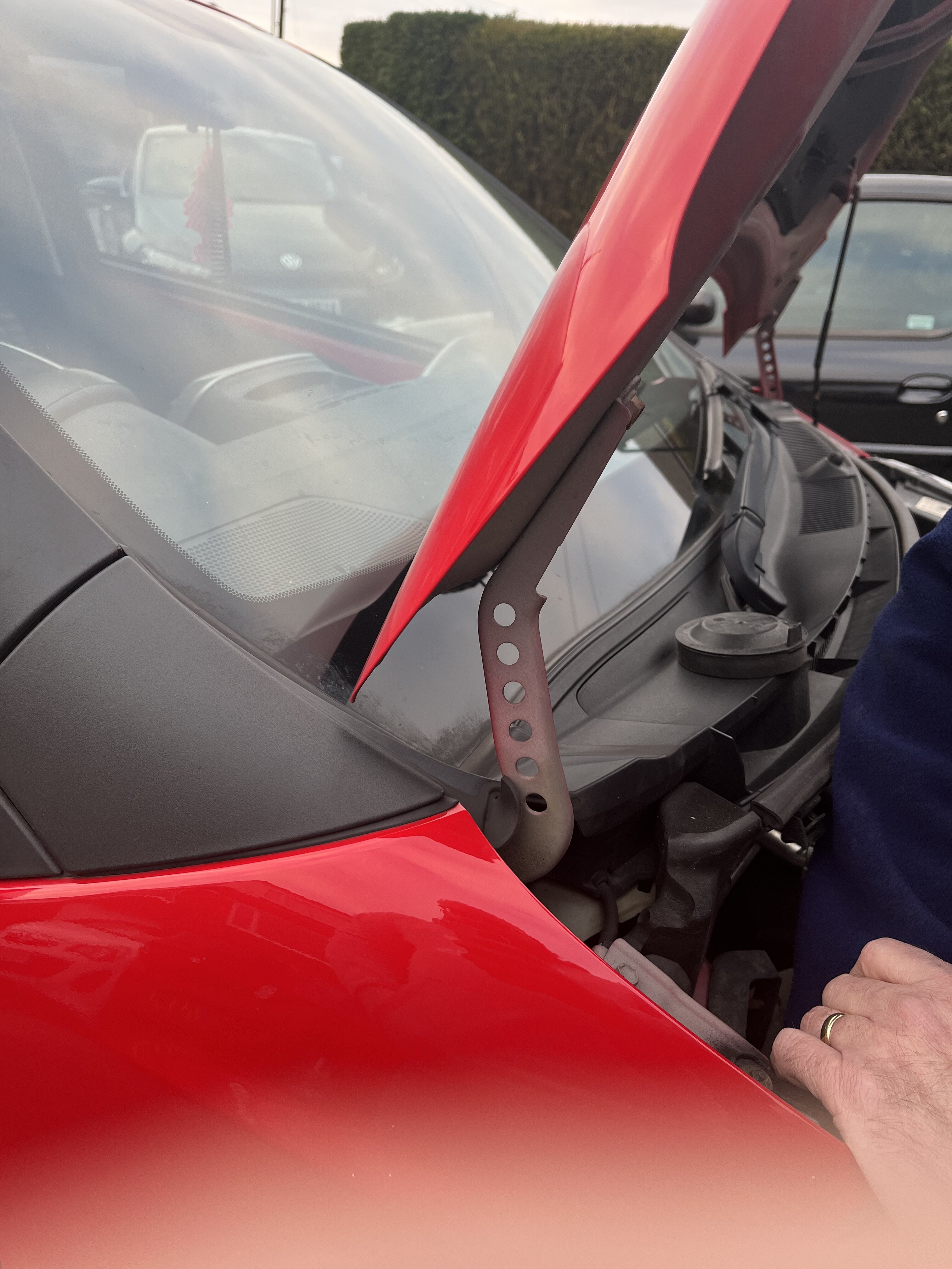

Which mad lad at Citroen designed the weight saving bonnet hinges on a C1?! Unless that's a bit of Aygo design, as it seems very Japanese.

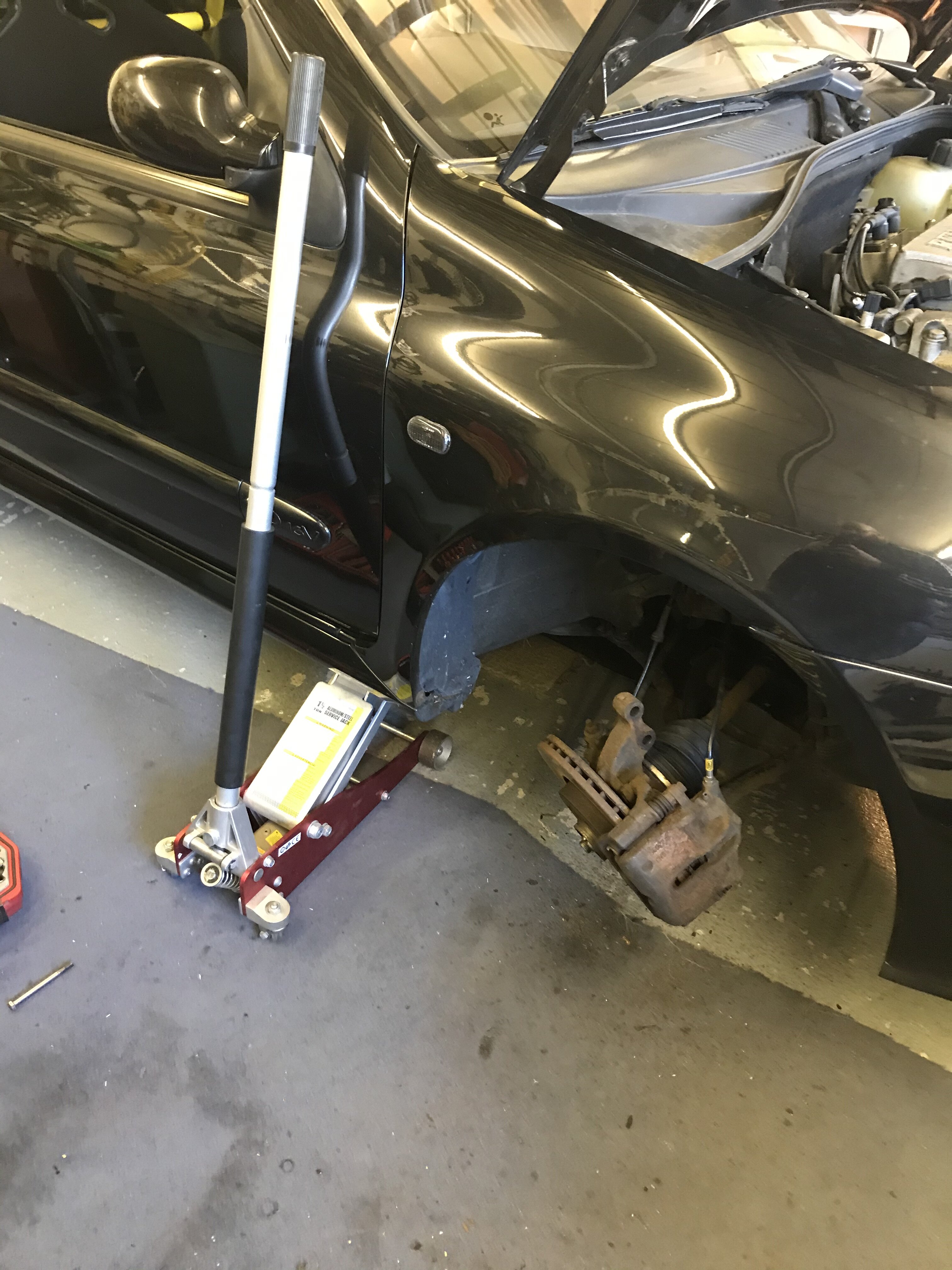

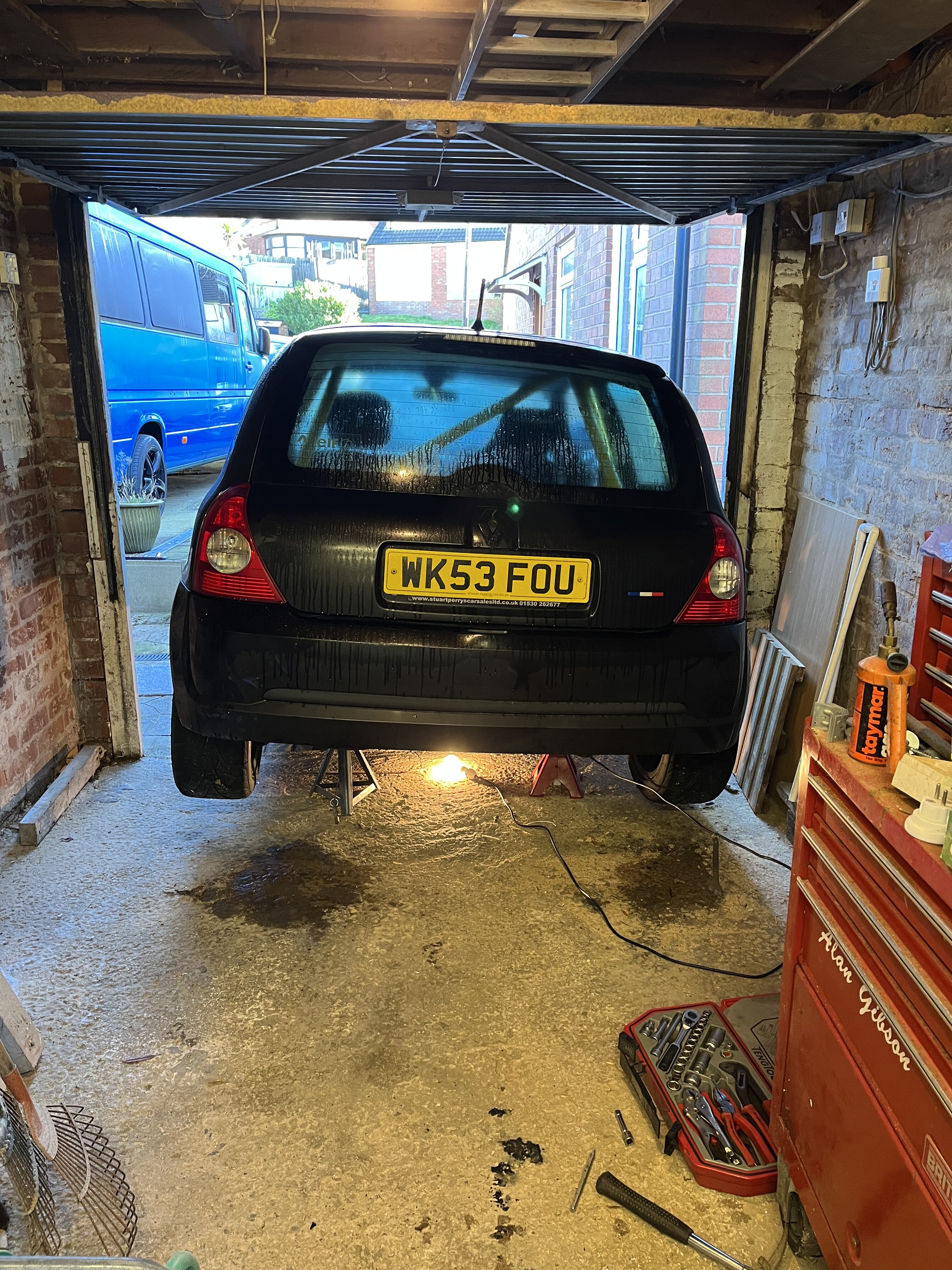

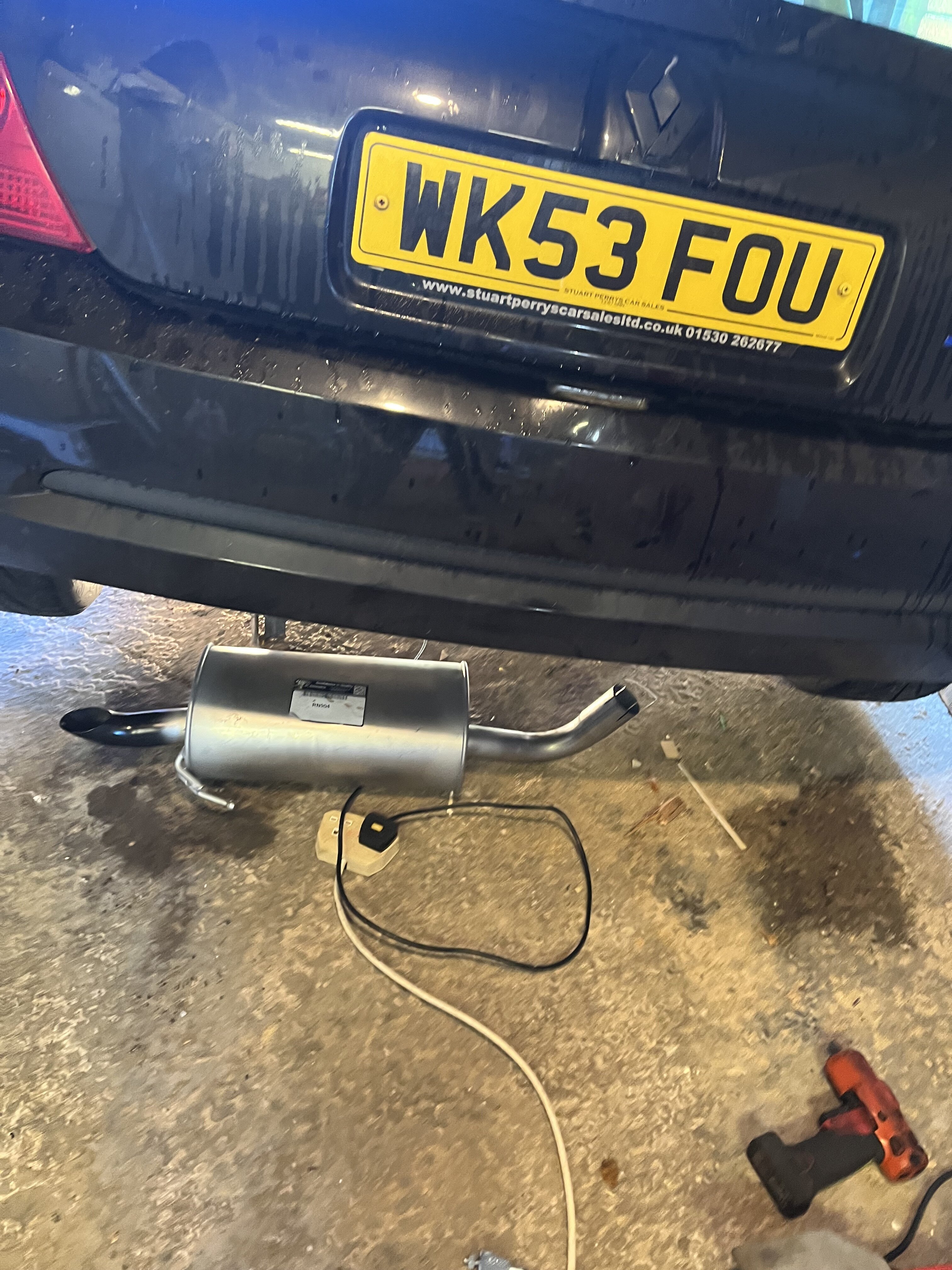

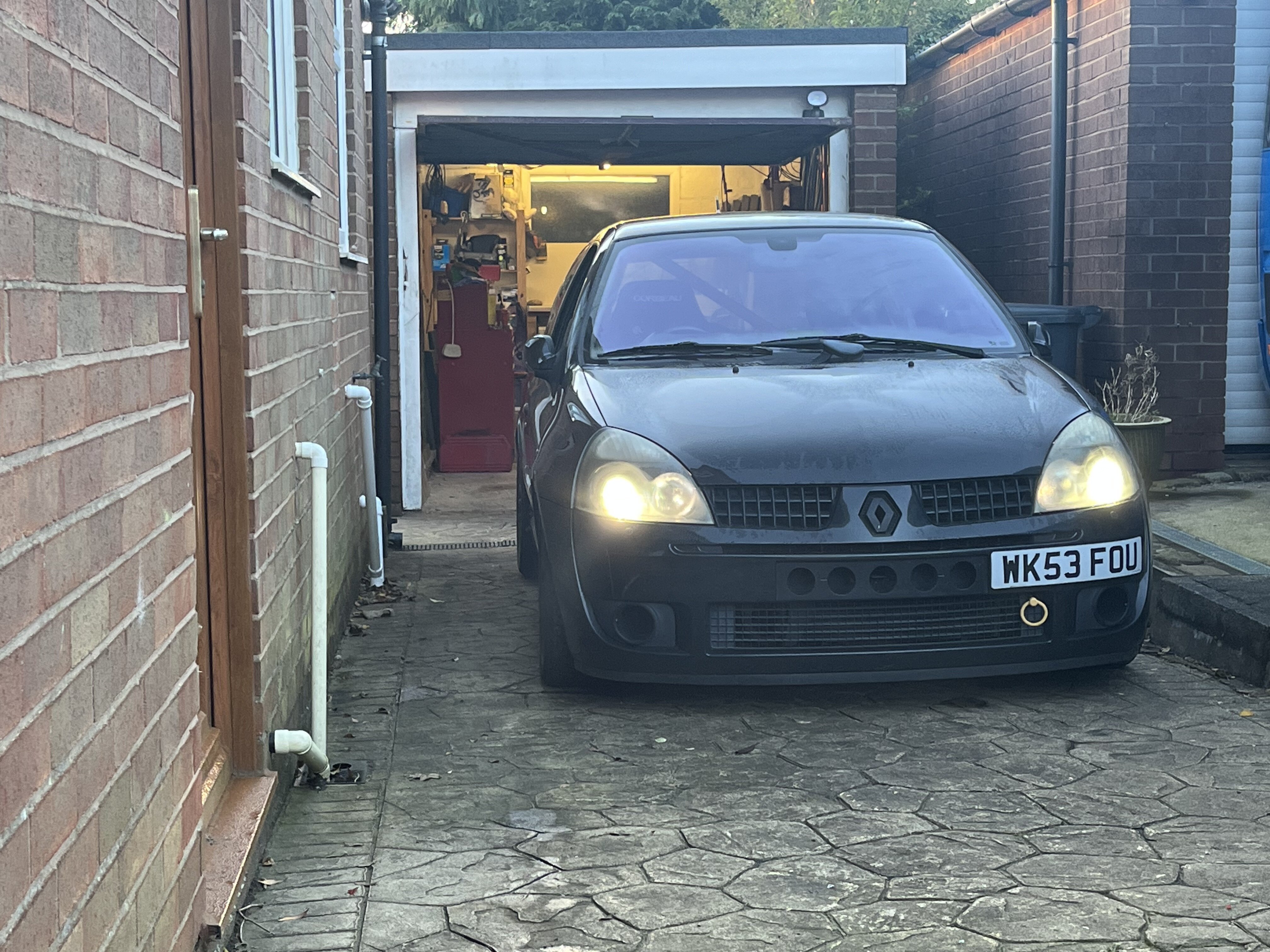

Productive Saturday!

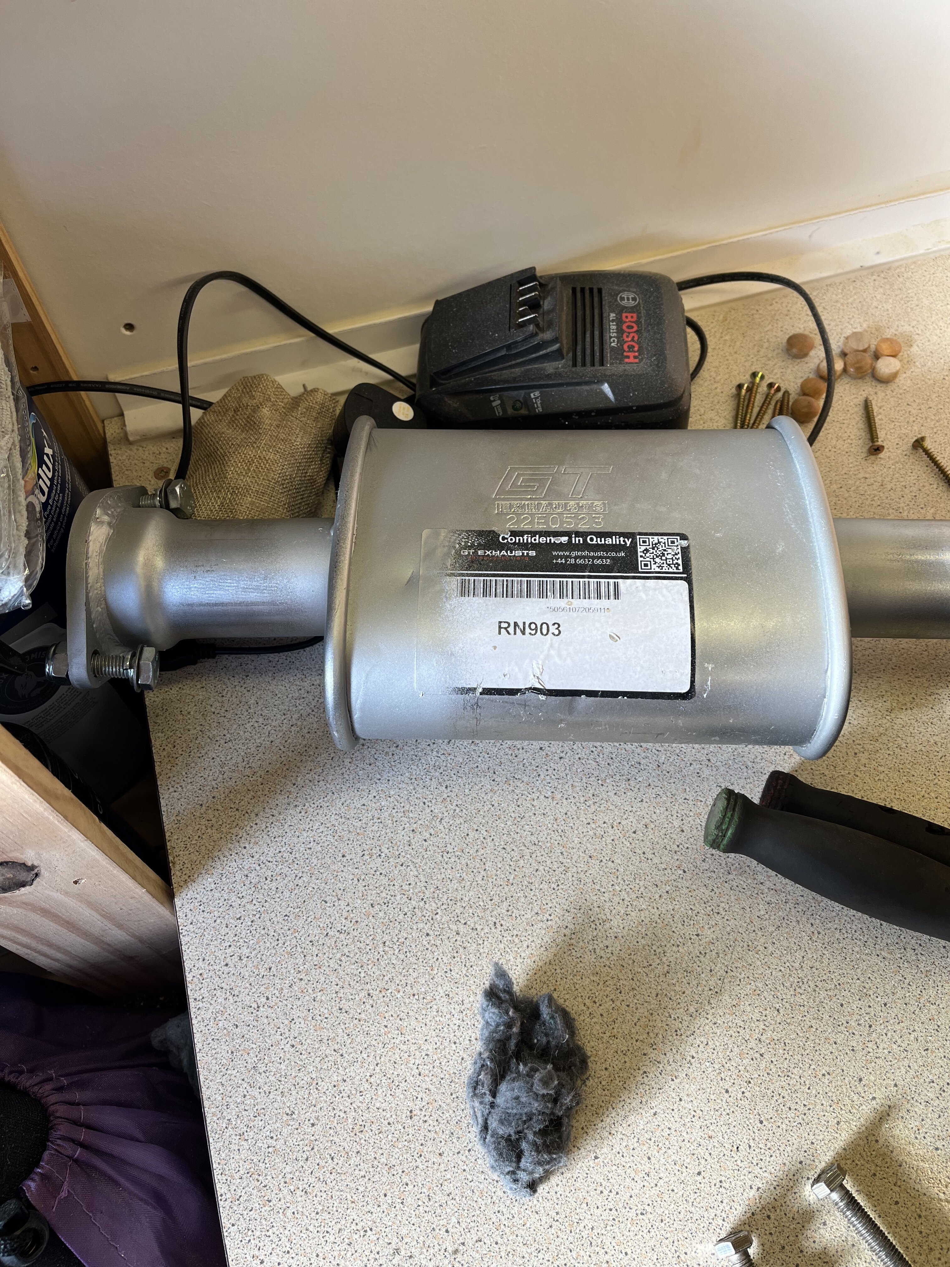

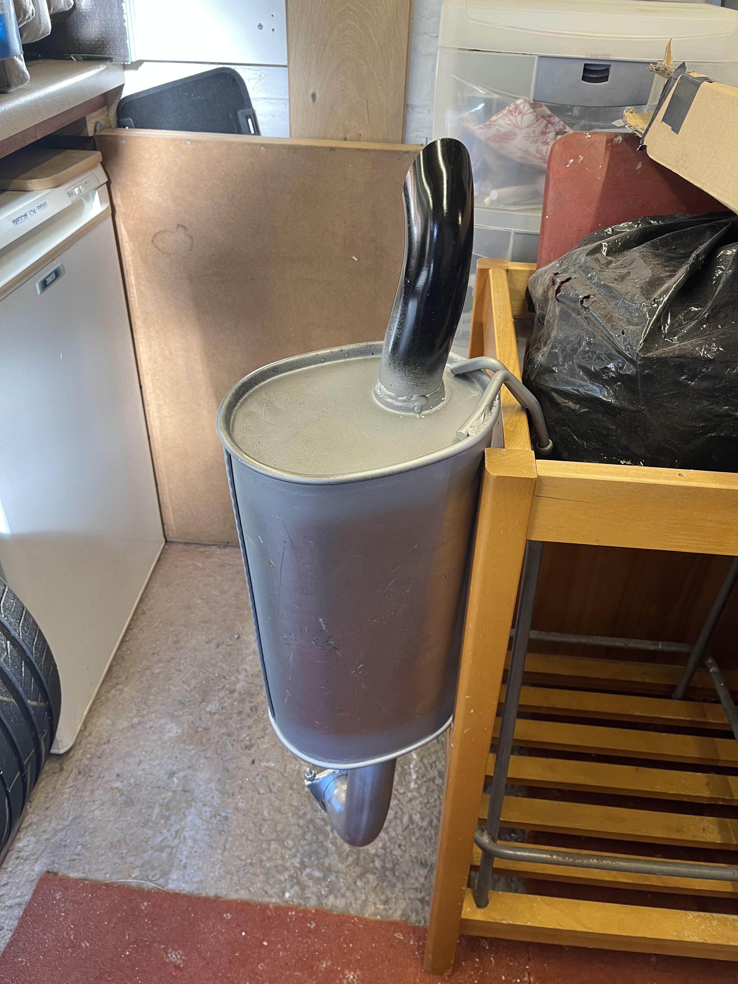

The car failed its MOT on the exhaust, and whilst I want to upgrade the exhaust at some point, at present I have other mods in mind.
I bought an OEM spec catback system which was delivered last week.
I then sprayed the welds and seams with galv spray and sprayed the tailpipe so it didn't stand out as much.
The jack is still under it at this point, I didn't leave it propped up on the piss.

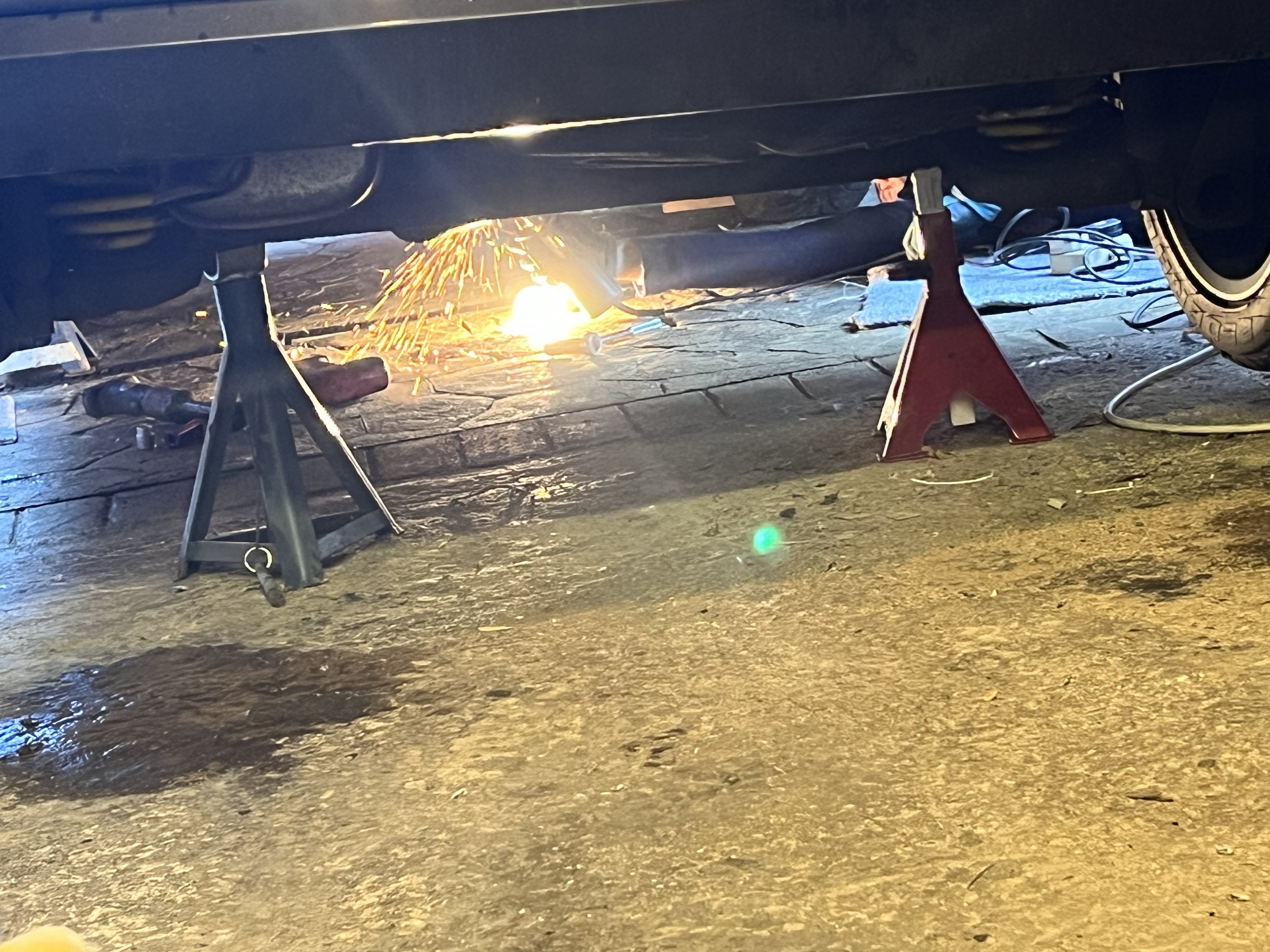

I went inside to make a brew, and when I came out my old man had the grinder going :LOL:
Offered the new system up. It went on fine. The only issue was the hanger on the centre section had the usual 'bulb' on the end, and the replacement centre hanger had a metal split ring inside the rubber hanger that needed persuading over and then squeezing back together afterwards.
Job done!
Pulled it out of the garage and let it idle a bit to hopefully cure the exhaust gum.
Then did some sick Max Power shots 🤣
Retest this week then winter strip down when the garage is clear!
Also managed to find the cause of a rattle over uneven ground - my drivers side topmount was loose! Nipped it back up and I've got some Loctite on order.

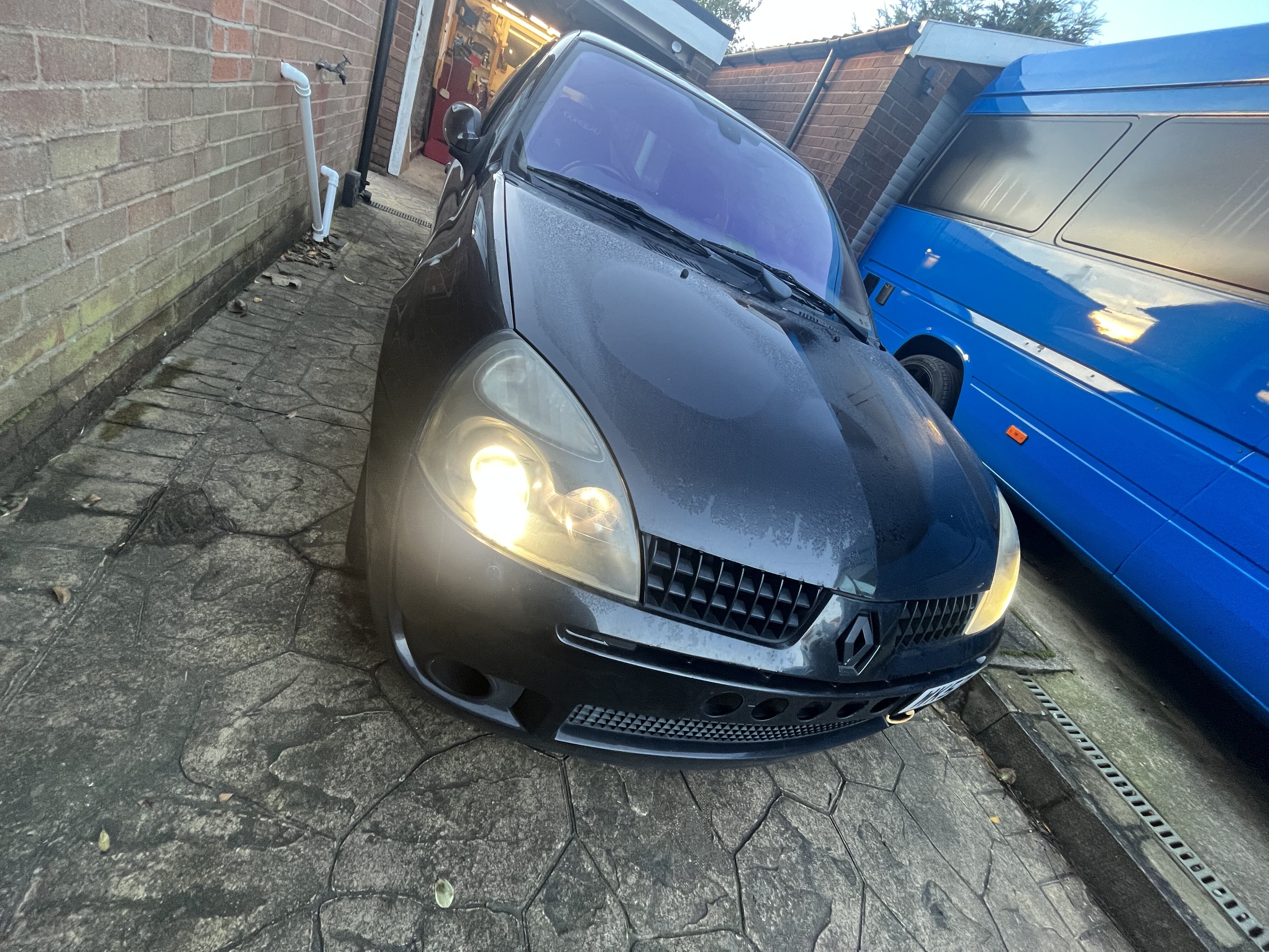

Test drove the other day and it was fine. Came to work in it today and found that above 5000rpm it vibrates like I've got my electric toothbrush in my back pocket!
I think the hanger is touching the mount. Will have a bit of a fiddle this weekend.
