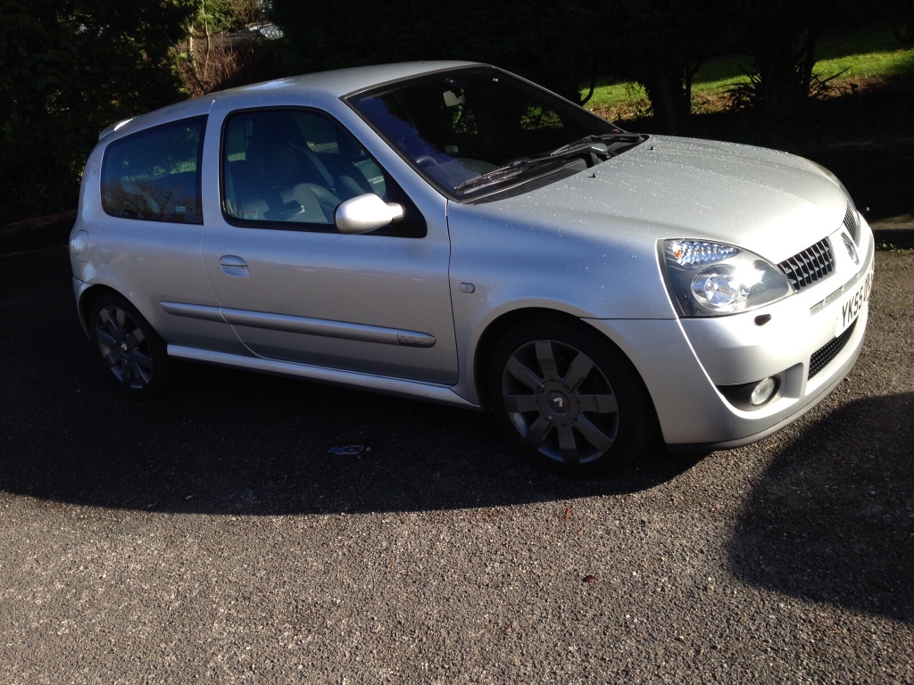

This is my project which has been a long time coming! Well the progress has! Bought the car Feb 2014 with the intention to modify it and get it set up to go fast on the road and the odd track day.
With only 57000 miles on the clock it really was in fantastic condition. Progress started pretty quickly when purchasing a scorpion 192 cat-back exhaust system as soon as I had it home. Then I just started to enjoy the car and didn't bother with any more mods. As I am fortunate enough to have access to a company car the clio is just a weekend car and as the year went on and the evenings got colder I decided to take it off the road in September (clock reading 59000 miles) .
Now the fun starts and the spending began
I have spent the last 2 months preparing the car for the summer (I am late I know) and here the car is now
16 inch renault Anthracite Turinis
Toyo proxies
Scorpion 192 exhaust
Ram air induction kit with home made Ktec elbow
Eibach sport line springs all around

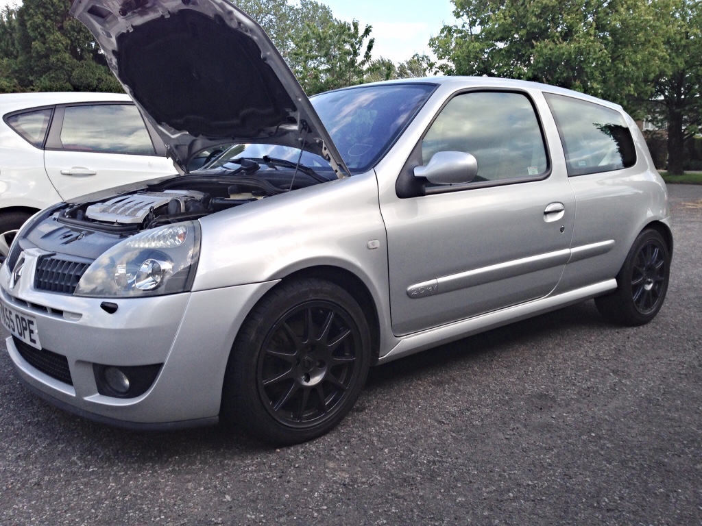

She lives ! The car has been off the road for 18 months , been saving for the dreaded deposit for a house , but pleased to say the Clio is staying and got some nice plans for her this year.
On order are
Front Brembo High Carbon brake discs along with OEM Brembo pads
Goodridge Braded Brake Lines
Wishbones complete with ball joints
Aluminium drivers footrest
Caliper paint (red) and also black hammerite to freshen up the hubs etc
The car has done 61000 miles now and remains to be my everlasting project. It's great having her as a second car.

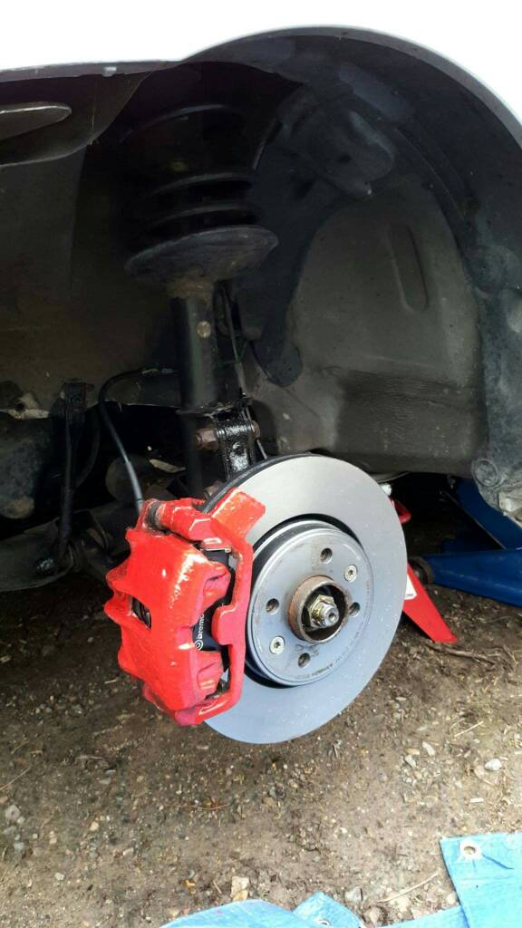

Been a busy day today . Replaced the front brake discs for Brembo High Carbons and replaced the front Pads for Brembo OEM'S. Treated the calipers to a touch of paint too. Got its MOT on Monday.
Sent from my SM-G928F using Tapatalk
Unsure if it matters a great deal, but you have the carriers around the wrong way mate.
Need to swap them from one side to another so they will be the other way up
Rest is all looking good though :up:
  Clio182
Your joking me ?? Sh*t ! Was a right ass to get the carrier on without popping the Pads off. OMG !
just undo the 13mm bolts on the caliper and secure it out the way, then undo the carrier bolts and swap them and then whack the pads in the carriers and push the caliper over them and refit the 13mm nuts pal
Unsure how you did it before lol?
  Clio182
Iv done it now but cheers. I just removed the full calliper then removed the carrier after. It was a mission installing the new pads due to brake dust build up and the carrier was slightly pitted so had to sand them down. Was much easier this morning thanks.
