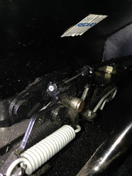

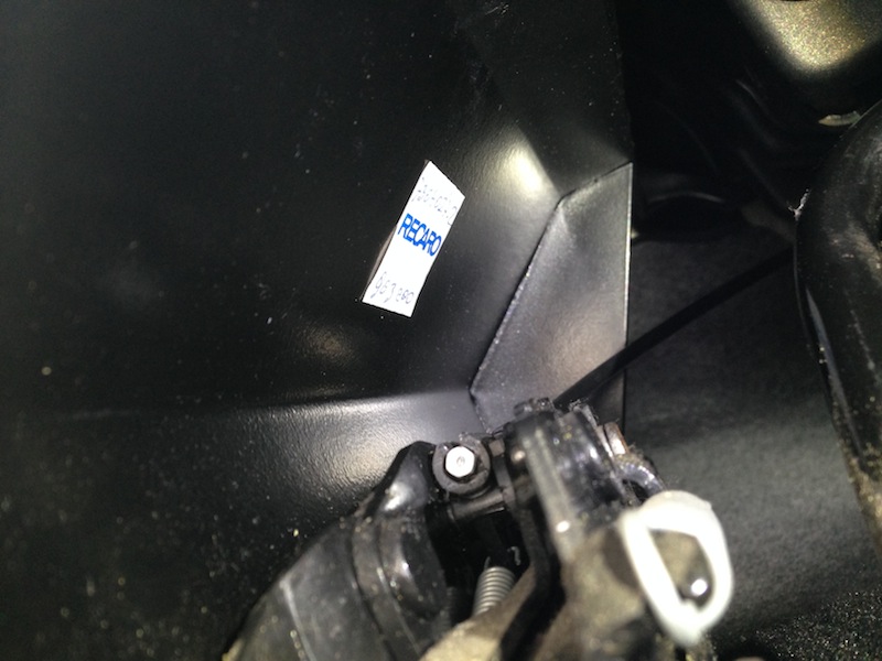

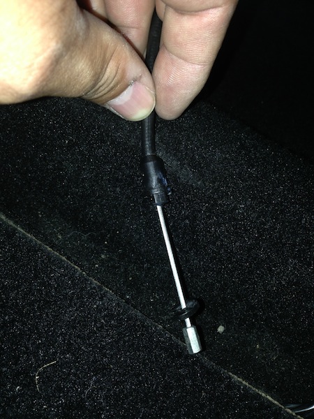

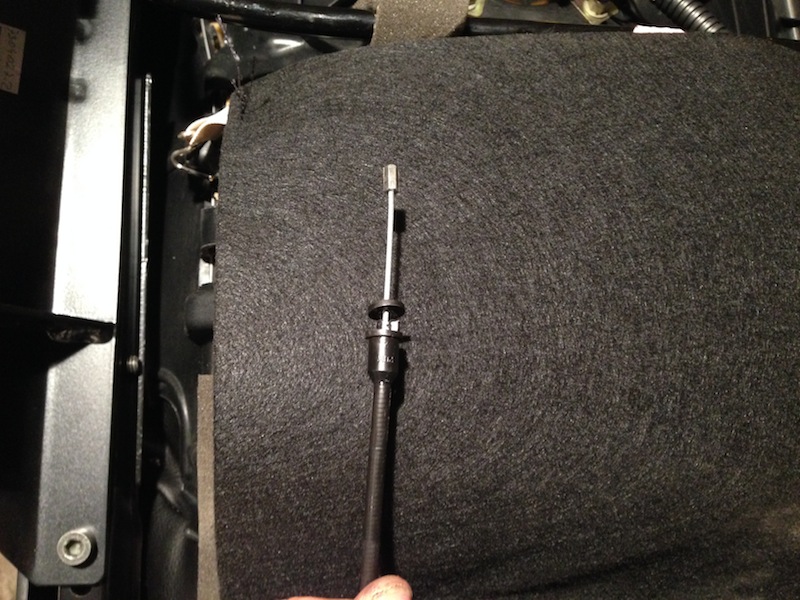

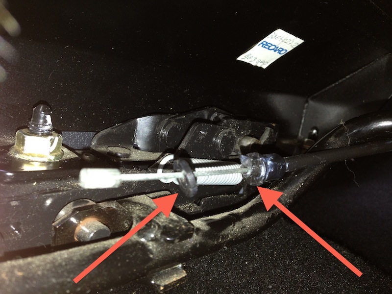

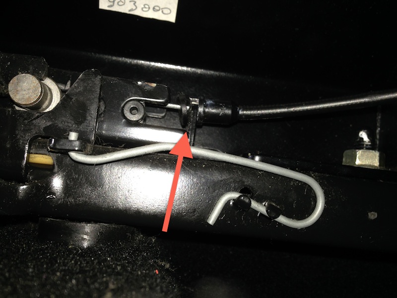

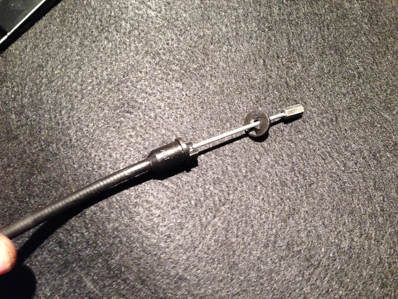

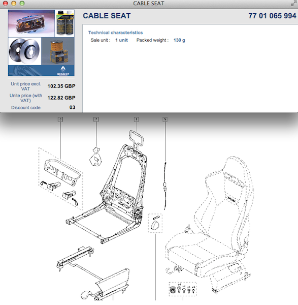

Had this issue and it turned out to be a cable, Its not cheap and at either end its plastic so it snaps.
I had to take my seat out and this is what i found
