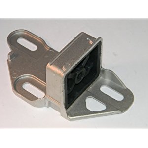

Looks to be partly correct, seems someone has bodged a rubber mount into the old hanger.
Standard should look like this -
Thanks J, I couldn't figure out how it connects to the back box though, it has 2 hangers one goes into the original mount but this one has no where to go ?

So, seeing as your the only one replying can you tell me if that bracket is facing the roght direction or if its been bent?

Another bodged example but shows how it should look -
Thanks mate appreciate it but thats not the bit confusing me lol, its the longer arm in the pic below

Ah got you, my guess (and it is a guess as I'm not familiar with this system) is that the metal bar needs a bit of adjusting.
and this is the exhaust the bracket came with, its the after market one im confused about not the factory one
The hanger ive highlighted above in red doesnt line up to the inboard one on the back box

The longer arm is a separate bracket that came with Magnex systems. That one is fitted wrong though, needs to point to the rear.
Danny, just the answer ive been looking for, the seller promises it came off his 172 but I cant see how. Any ideas, or do you know which part of it is wrong?
If I undo it and flip it over it sticks out, the cars on the ramp waiting for a downpipe anyway so I will look first thing, does it look right though just needs flipping?

Yea just needs flipping.
Was it pushed all the way back as your hanger in that photo isn't. If not just cut it an inch shorter!
