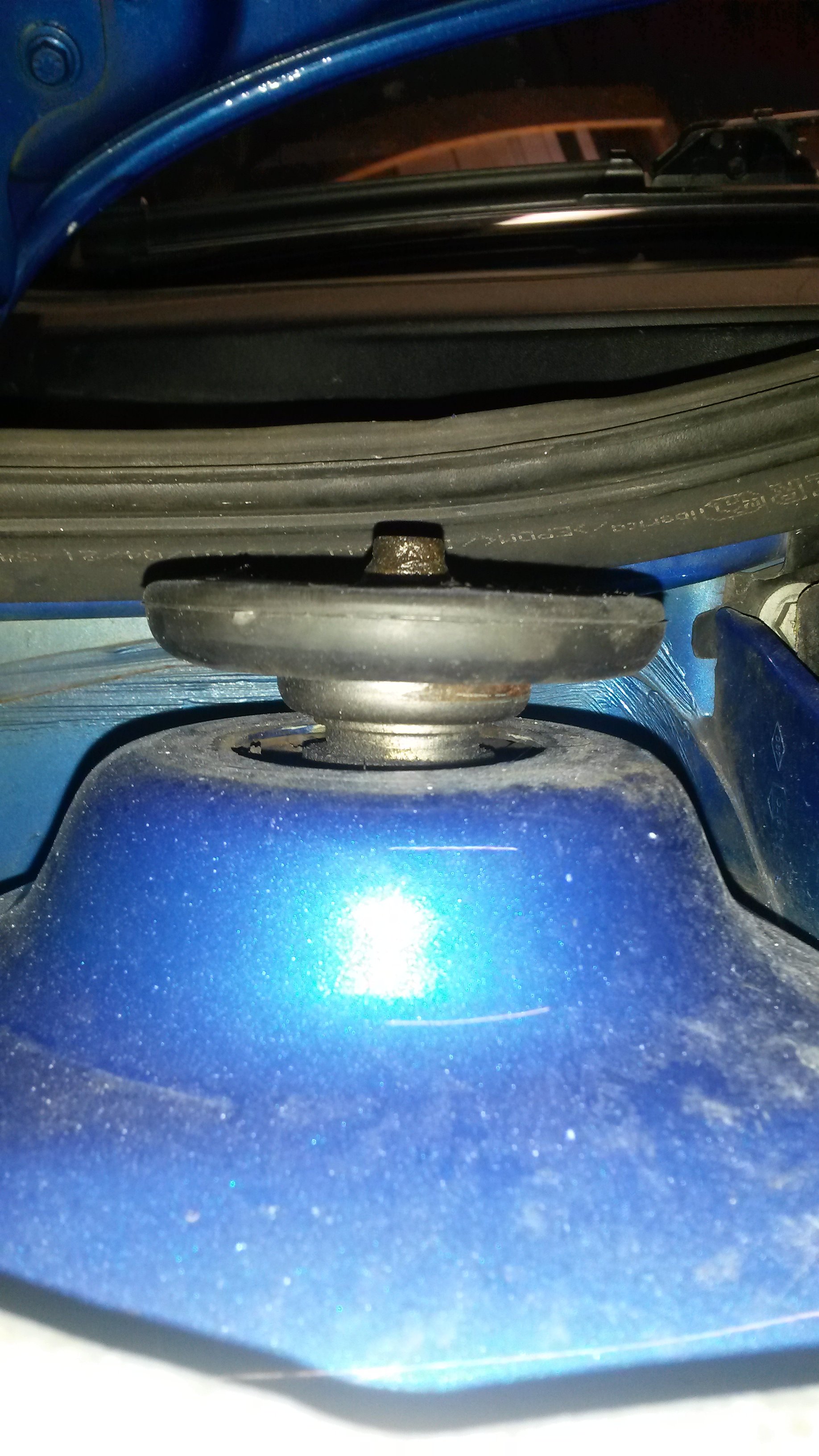

is this normal?
  182
Having a wee look round the clio ive notice that the top mounts sit up off the turret like the below pic. Is this normal? I haven't done anything to the suspension yet but have all the parts for a refresh so need to know if this is normal.
Daniel
  Whichever has fuel
Perfectly normal to sit off the turret but yours look exceptionally high!
Daniel
  Whichever has fuel
I'd imagine that the components at the top of the strut have been put back in the wrong order.
Has it had a spring change lately?
  SQ5
Looks like the top mount is straight onto the rubber too, which is also sitting to high so means it's worn.
