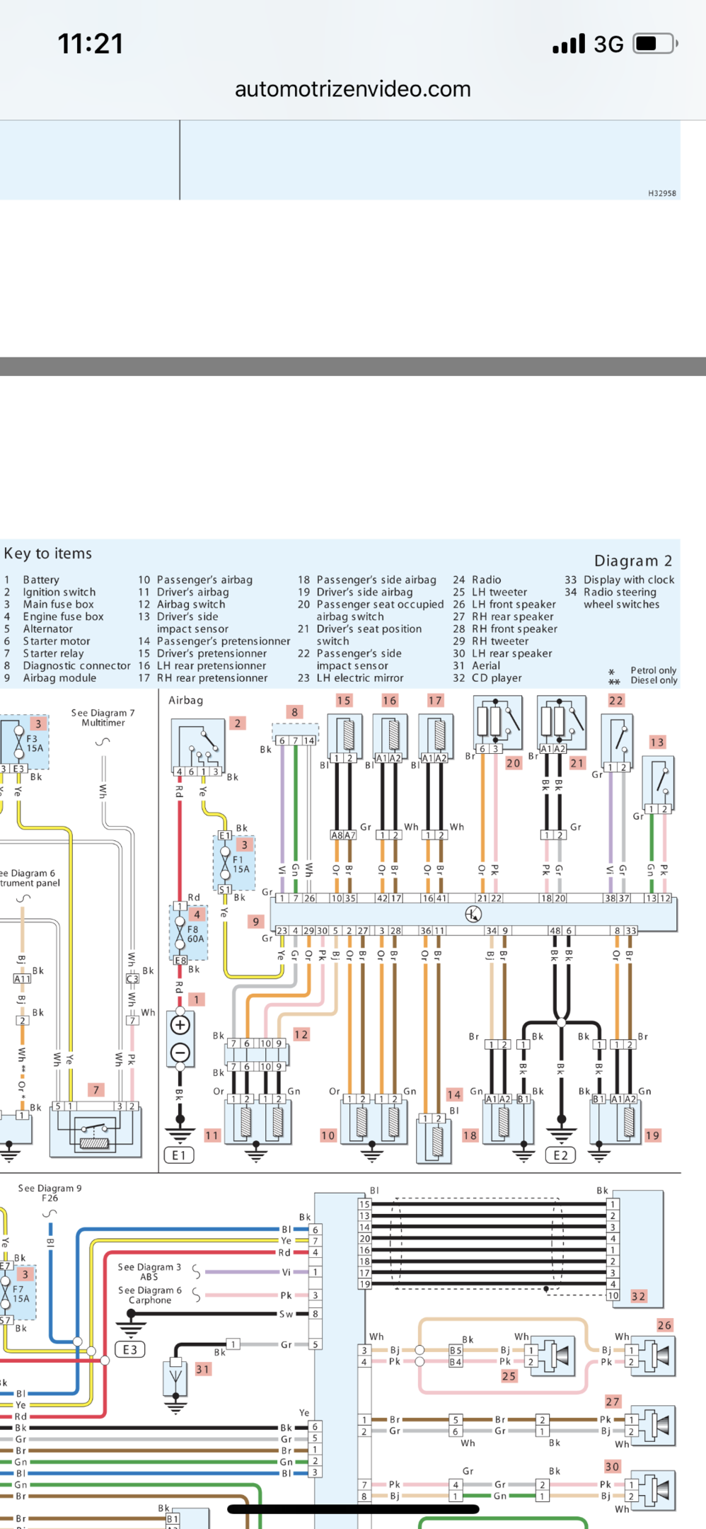

I used this diagram and cut pin 7 for the warning light. Both airbag and service light went out.

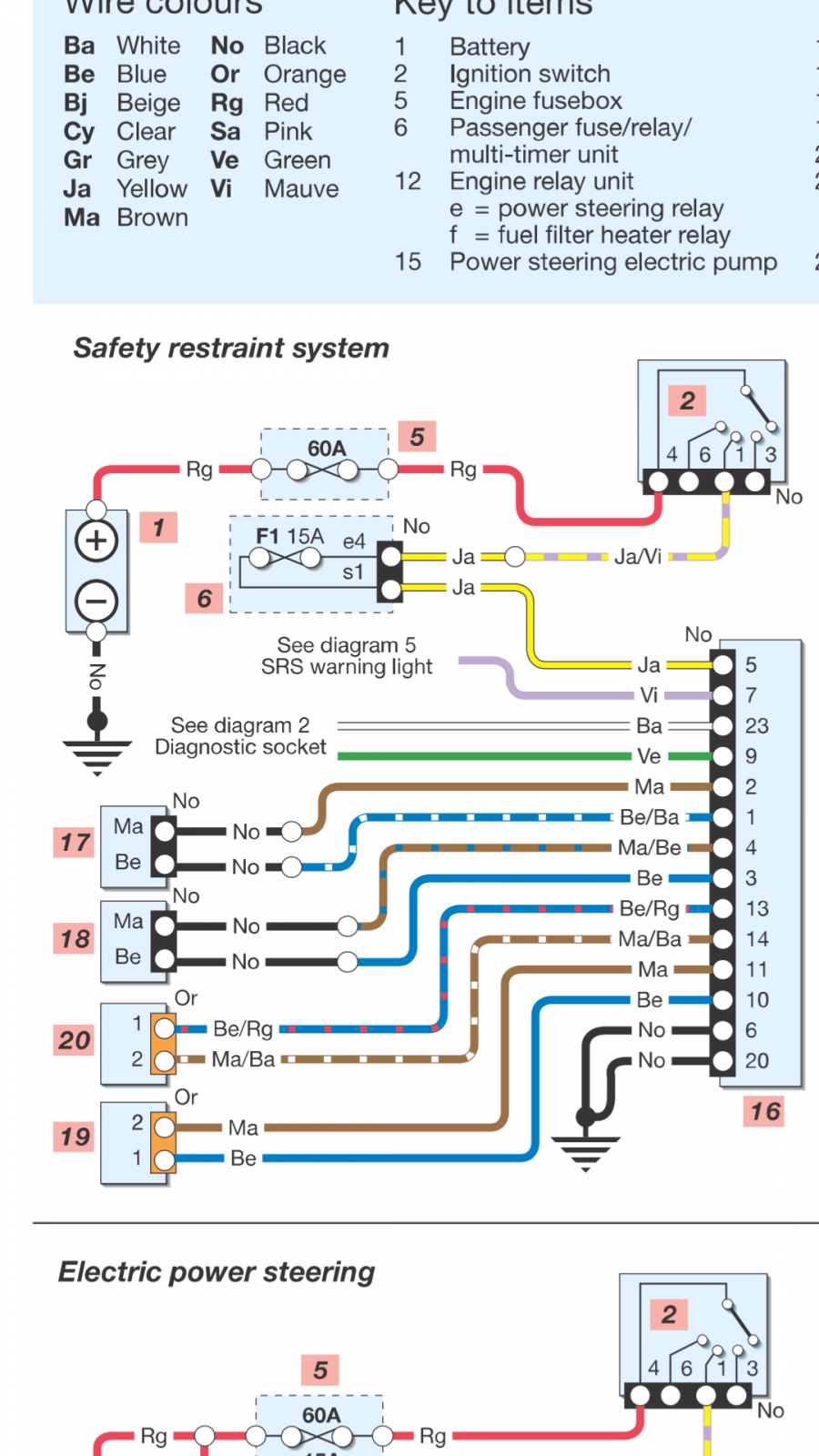

I should check my old Haynes manual and see if their diagrams include the system too.
It threw me a little as it has diagram for electric steering underneath? The diagrams I have don’t have any of that on..

Here’s the diagram I have.. do you think it’s the violet wire running from airbag ecu to diagnostic connector?
Djw John
Scotland - South
I reckon it is. BUT, do what I did. Cut it in such a way it's very easy to reconnect if it's the wrong one rather than flush with the plug.
Or just remove the pin without damaging it.
EVO 4LEX
  Golf R and a 172 Cup
Ok, so, just doing this to a 182 and it's not like my ph1. As in it's not worked! f**k.
Must have something to do with the three wires on the diagram I posted..( going from airbag module to diagnostic connector) any chance you can test voltage on those three with and without airbag module plugged in? Maybe needs foolin to think module is still plugged in when it’s not..
