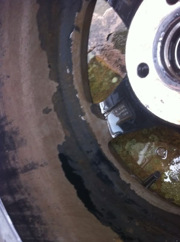

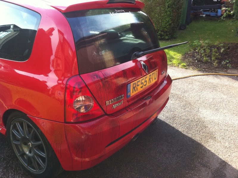

Iron-X is awesome!!
This is the 3rd application (in a row) on the Trophy on Saturday - got dirt yo.
