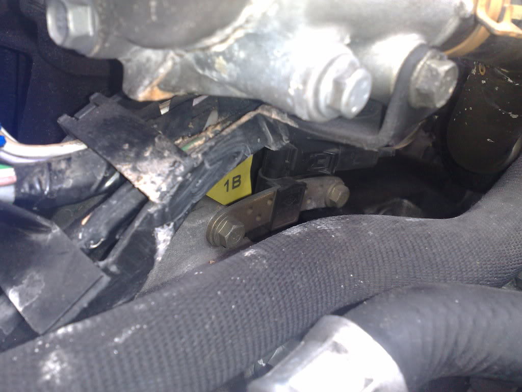

Mine does this every now and again - has anyone a pic of the crank sensor?
Thanks
