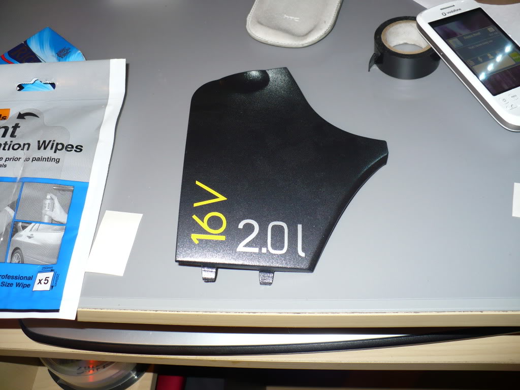

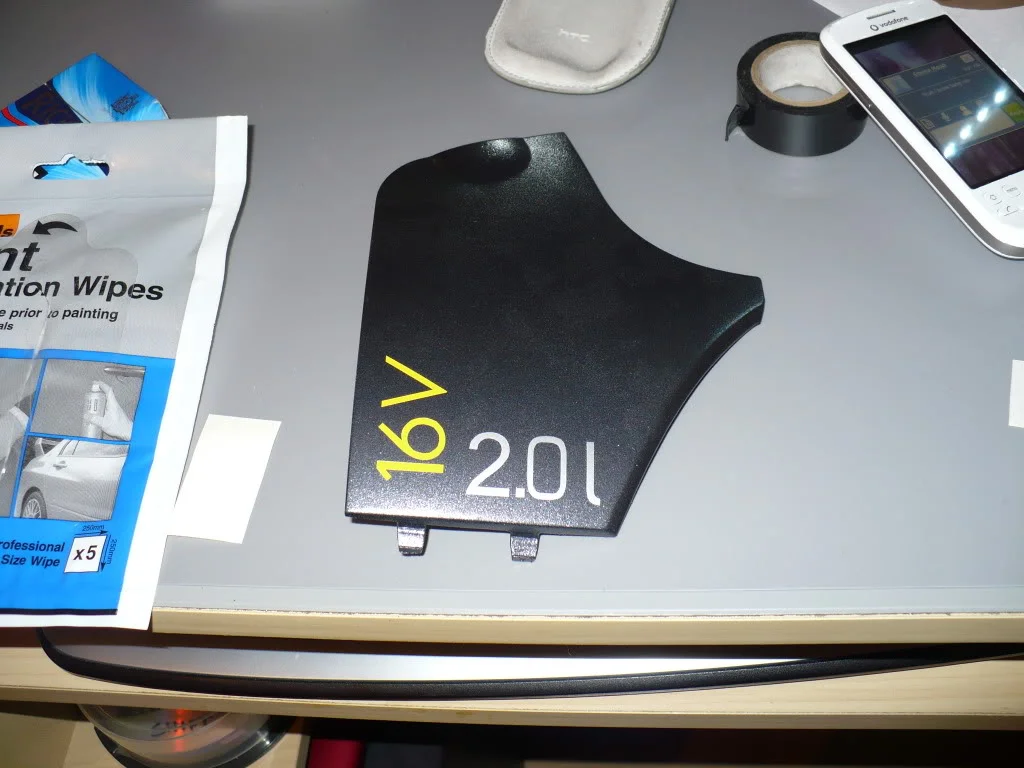

Now.. I'm no pro myself but I have got some pretty good DIY bits done myself, one of which being my Engine Cover with the 2L 16V Logo.. After I had primed and sprayed my piece I aloud it to dry (over night), and then stuck the decal onto the paint and basically lacquered over the entire cover, gave a pretty decent finish.. You shouldn't need to sand down the top coat of paint if the primer was flattened (sanded smooth) beforehand and I don't recommend you do because it can dull the colour.. This worked for me and I know many others do the same.. Hope it turns out well and post up some pics of when its done.. ;)
Darren
Edit: The oil cap cover I did the same way I explained above...
