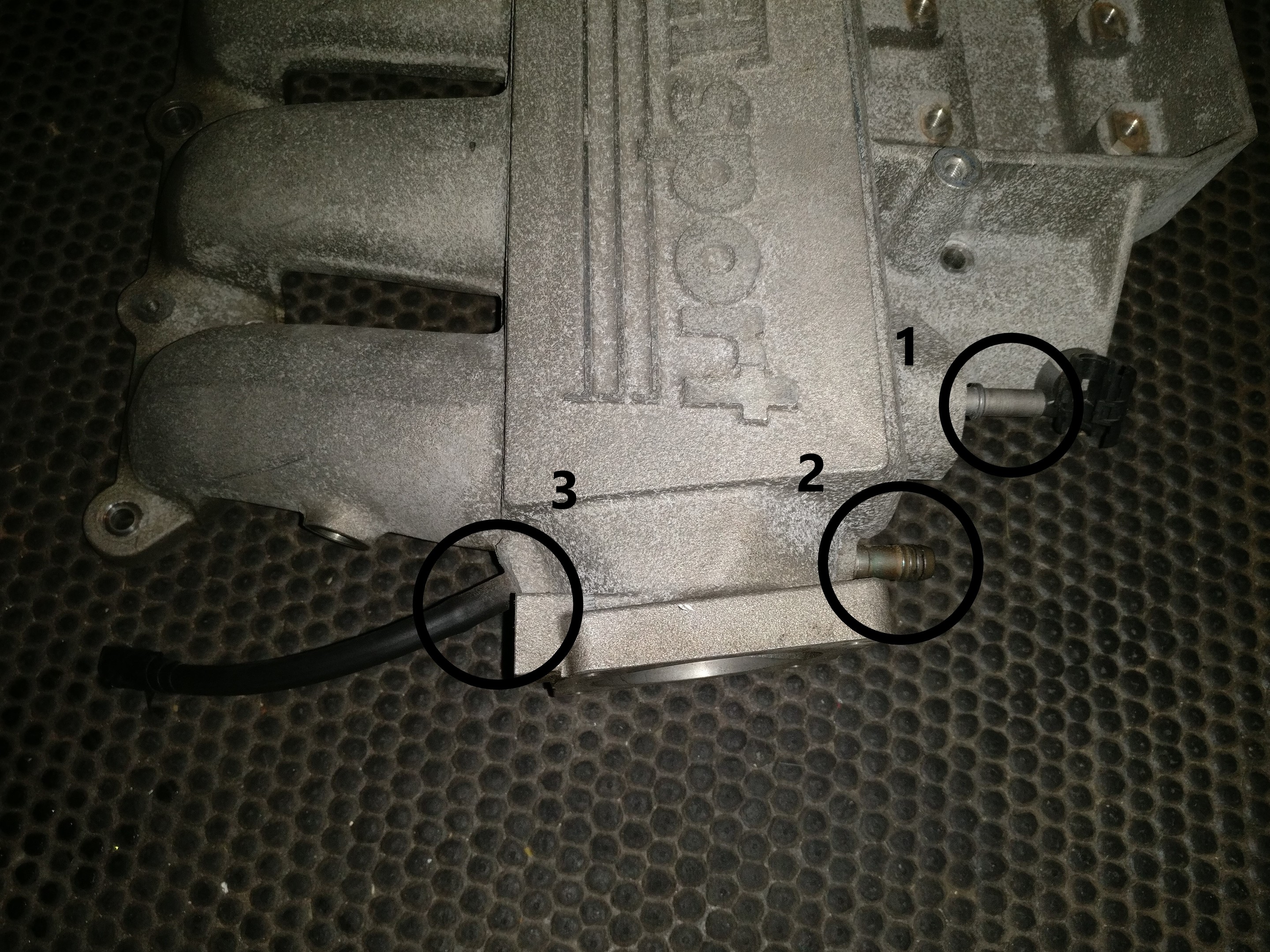

I've pulled off the RS2 today, but didn't manage to get finished due to the rain.
Anyway, the RS2 only had the two sensors attached, and a single breather from the underside. This runs back to the rear of the engine and into the bulkhead.
Looking at the original 182 inlet, i've got three breather pipe. A little searching suggest one is the carbon canister, another is the acoustic valve. These aren't required, and it looks like these have been removed from my car. I guess i just need to blank these off and then plug the remaining pipe from the bulkhead into the correct point.
Could someone label the three I've highlighted in this pic please.
avstar1
  172 cup
I think number 2 is a oil breather which normally goes back to the inlet bend which leads to the airbox
