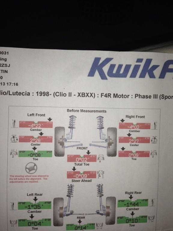

Interestingly, I have managed to magically gain some camber. I've just got the Eibach bolts, yet they have set it to just over 2 degrees either side, which is well above the 1-1.5 usually seen with the Eibachs.
Although do lower springs introduce a bit of camber too?

I can get 4.5 degrees camber on my cup so its a myth that you can only get 1.5 deg, you just have to push the wheels in while doing the geo and not rely on the bolt doing everything.
edit: lowering a Clio will have a very small effect on the camber or caster due to it being a Single wishbone Macpherson strut arrangement. When I say small I mean minutes not degrees.

Iirc yes they do and i think you will also have a little negative as standard.

Yeah cups do have more camber standard it was just a comparison, the 1.5 degrees that some people say is all they can get is almost nothing over a standard 172.
Like I say, just twisting the camber bolt will not give you max achievable camber with Eibach bolts, you literally have to adjust them to max and then push the wheel in while on the hunter and you'll see the figures jump.
We got 2.5 on my mrs old one with camber bolts IIRC
And I agree, its well worth giving the wheel a nudge so all the bits of play work in your favour as you do it up!

Hers a screen shot of one of the times I went to get the geo done, had nearer 5deg another time on one side before setting. Standard cup shocks and wishbones which were brand new and so was everything else.

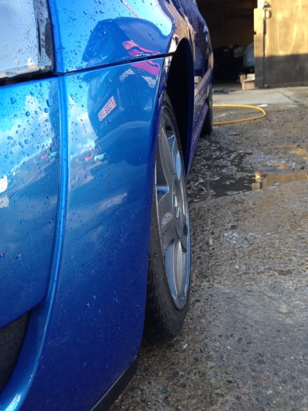

And what 4 deg looks like > broken.
