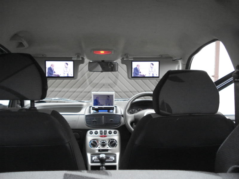

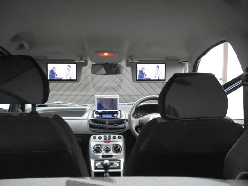

I had some in a punto when I was younger - pre-recession so i was all yolo, much better buying the complete sunvisors rather than trying to mount screens in existing - if you decide to go down this route imo
  Clio 182
Theyre made out of plastic, and due to the screen considerably heavier than standard visor. But the complete units have different mounting rods (porbs wrong name for them), but means that cables are fed through the rods into roof liner so no mess - they also 'click' into place when up to prevent them from falling down, think if you simply fit screens into existing visors then they will not be strong enough to stay up without velco - which would look rubbish.
Theyre good if you can get them at a good price - easy to wire too, just plug and play
