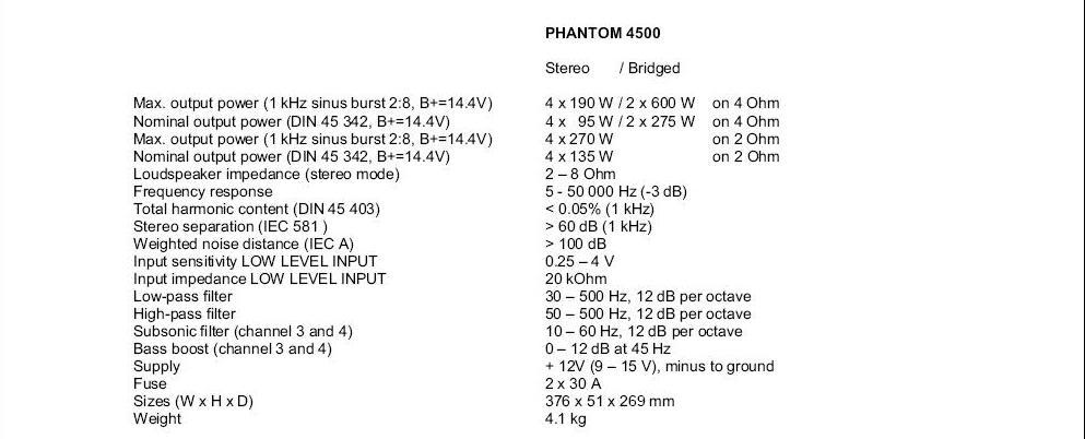

Cool, looks like this seems the better option then. I'm planning on getting a set of rainbows, namely the Rainbow SLC230 Kick's. These are listed as max 150W. These will be amped by a Magnat 4500, spec's are here

RMS detail's are as follows....
RMS power output into 4 ohms
for channels - 1-4
Stereo - 4x135 Watt
Bridge boat - 2x275 Watt
RMS power output into 2 ohms
for channels - 1-4
Stereo - 4x95 Watt
Am I right in thinking the max I can go is about a 300RMS sub bridged at 4 ohms with components on the other two channels?
