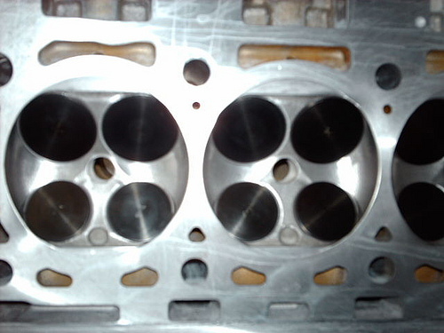

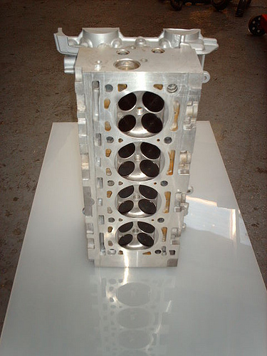

CNC port flow machined cylinder head

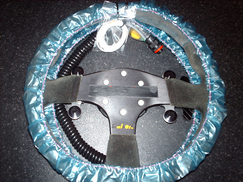

Firstly at last the flappy paddle converted steering wheel
Steering wheel by nodded, on Flickr

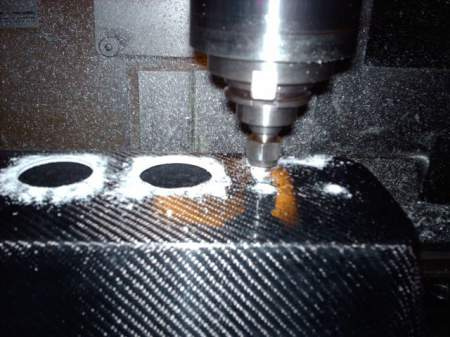

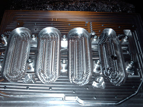

Next up My custom made Carbon Air box rear section being machined for throttle bodies
Carbon air box by nodded, on Flickr

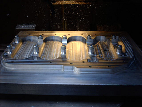

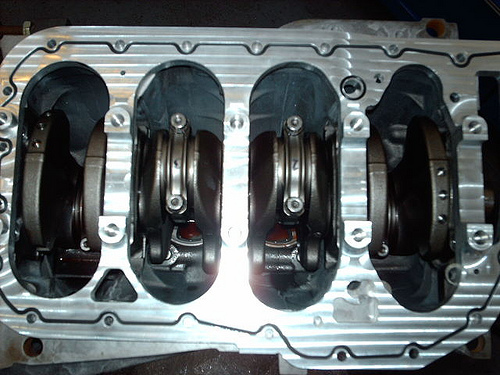

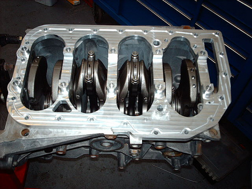

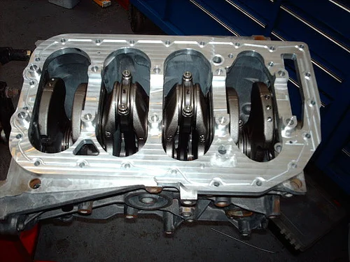

Next up some pics of the alloy block brace being made
Block brace1 by nodded, on Flickr
Block brace 2 by nodded, on Flickr
Block brace with O ring groove cut by nodded, on Flickr
Block brace with O ring by nodded, on Flickr
