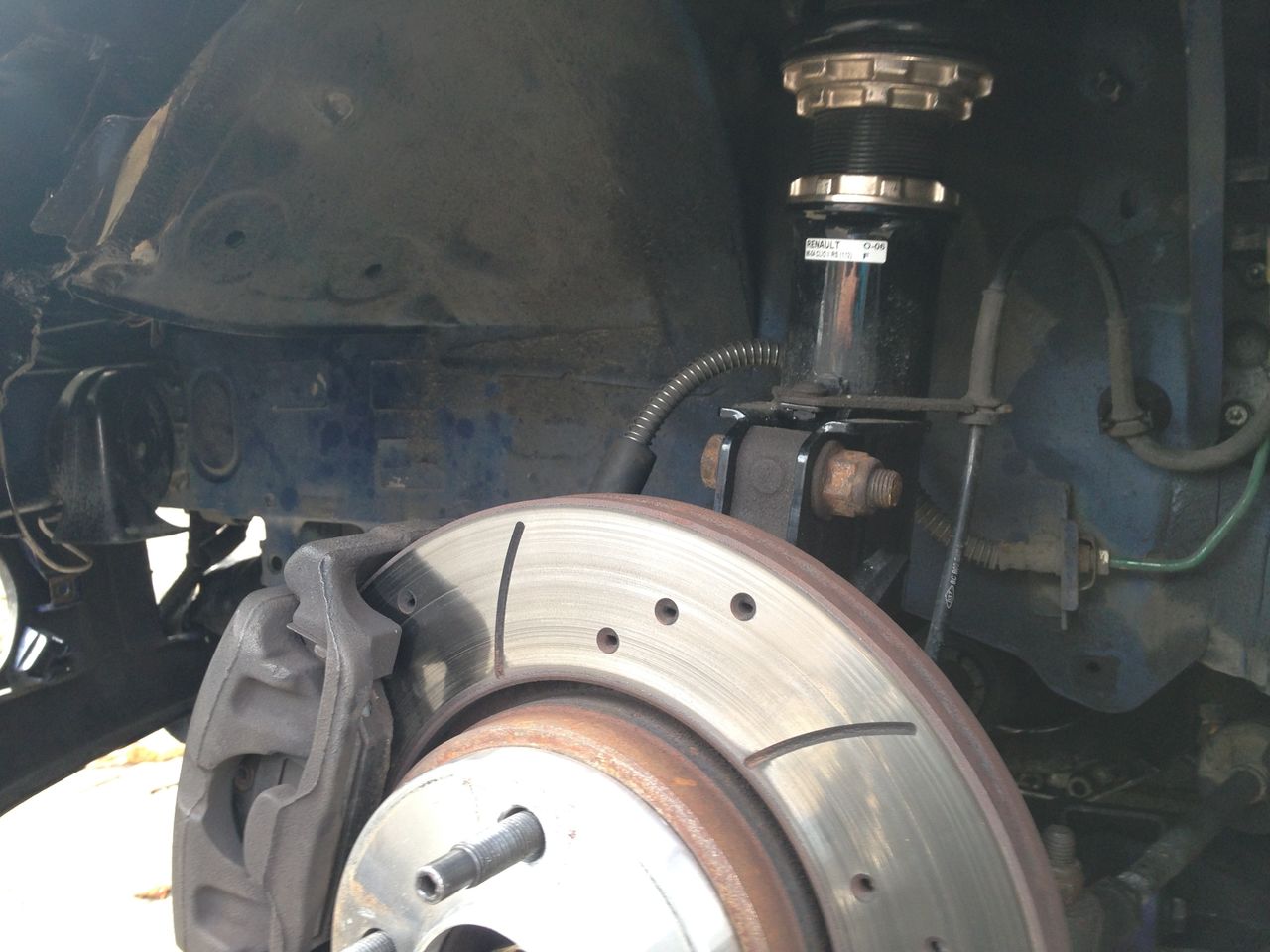

After fitting BC coilovers and poly bushes all round, the caster of the front wheels has increased by a noticeable amount. Normally this would be a good thing, but not in my case. The car is a track car and unless I raise the suspension up much higher then I would like the wheels rub near the front of the arches under heavy cornering. see pic below
I was going to cut out the metal that it was rubbing on (as I have with all the other problem bits of metal) however the arch looked quite important, so I think I will leave it in.
Can anyone recommend a way to reduce the caster again so the wheels sit closer to the center of the arch?

Is it just catching the bumper brackets?
It was after I lowered it, but I have now cut the bumper brackets out and tried to lower it more but the wheel rubs under heavy cornering. You can see where its rubbing in the first pic, its the smooth whiteish mark at the front of the arch

Oh, I thought you meant wing! Most of them do that, just beat/trim it
Haha, you had me worried there. I have done that with most things that have got in the way. Can I grind out this part of the arch? its not very thick metal and behind it is the engine bay, am I not at risk of weakening the structure?

Not atall, you can take about 20mm off it in depth and it'll be fine
Cheers, Ill have a go tomorrow as long as the weather holds out.
Am I right in thinking that caster adjustable top mounts would have little effect on my issue? As I want the bottom of the strut to move back, not the top of the strut to move forward

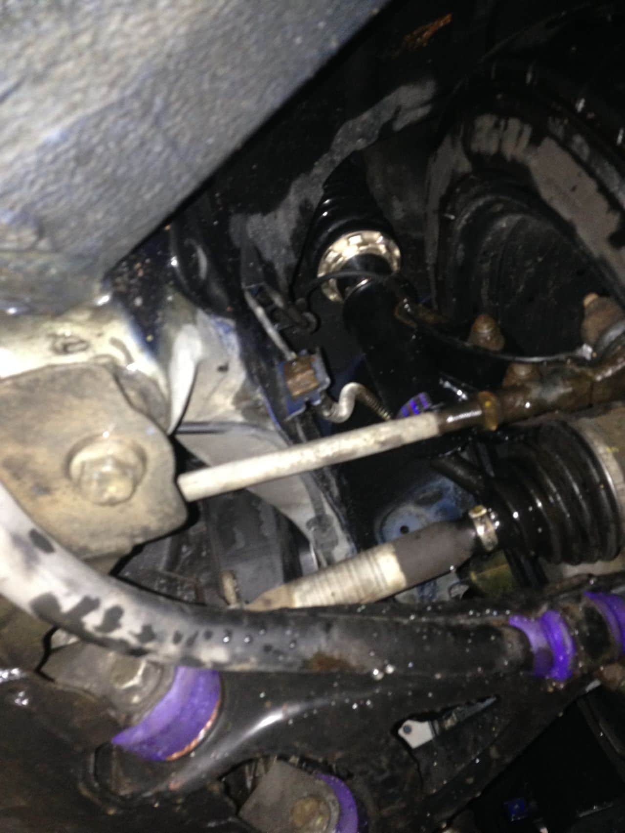

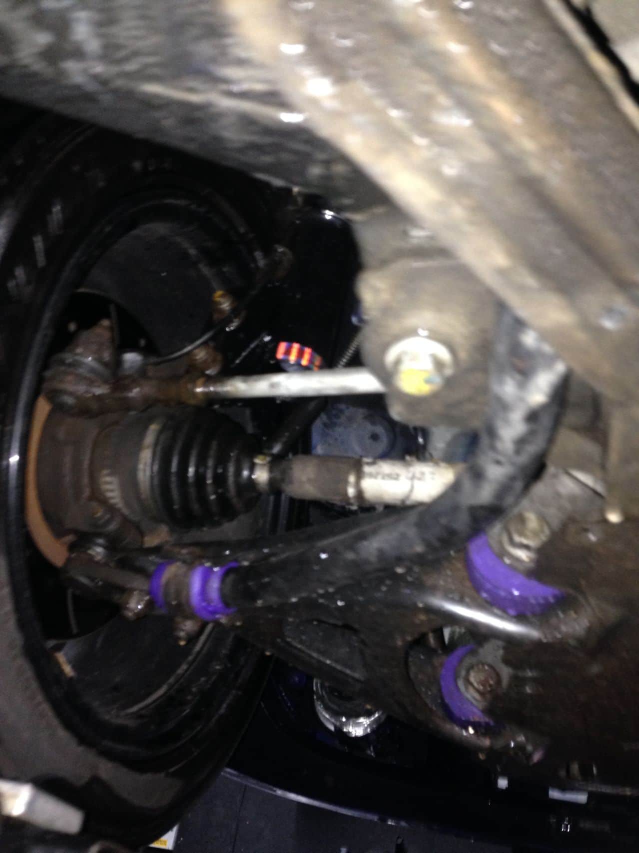

The second picture looks as if the fat part of the bush is on the outside of the wishbone?
Ans where is the metal sleeve in that pic?
+1 to this man. After i read the comment it got me thinking, so i have now had a chance to check the fitting of the poly bushes and he is right. The rear polybush on each wishbone is fotted the wrong way round, which has increased the caster.. I will update the thread when i have swapped it.

Yes mate, it's all fixed and it was the polybushes the wrong way round as bozo said.
Even once it was fixed it still rubbed a bit so i cut out more metal until it stopped rubbing.
