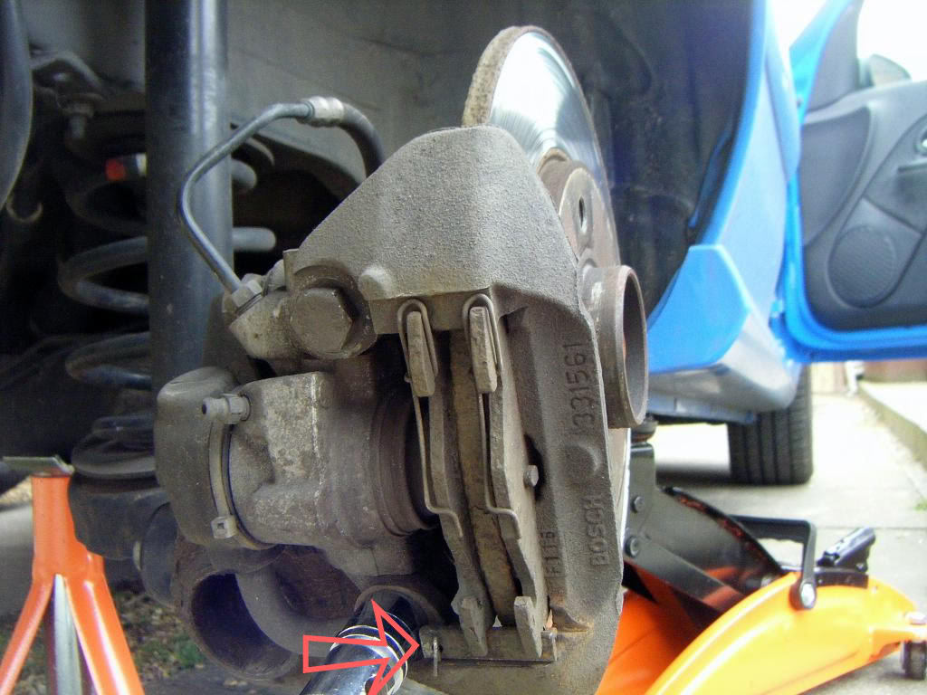

Here is what the brakes look like behind:
Here is how i fitted the spacer ring behind the disc
Does anything look obviously wrong? I can't work out why its so fucked?
Sticking callipers? How do I fix this as i don't want to fork out another £150 quid for discs and pads for it to happen again :(

Sticking caliper making the disc get so hot it cracks is a common fault.
  ITB'd MK1
need to make sure the claiper is moving and operating correctly. the caliper sliders on the rear are one big failing which is fixable, and the other issue which will mean caliper replacement is a faulty ratcheting mechanism on the handbrake (inside the caliper)

You caught that just in time! What brand are the discs? With the pads wearing down that fast, it has surely has to be a caliper issue. Is your MPG suffering?
  Golf GTD Mk7
Fook :eek: good job you noticed that mate. Could have caused more issues. Surely if the pads were catching that bad you'd have heard it?

Cracking like that is more than likely, as said above, heat related failure.
Been driving about with your handbrake left on ? :rasp:
For peace of mind, a fresh pair of calipers on there IMO. (Not necessarily new/refurb'd ones) Get them both off, strip them down, make sure everything is kosher, and keep an eye on it once it's all back together.

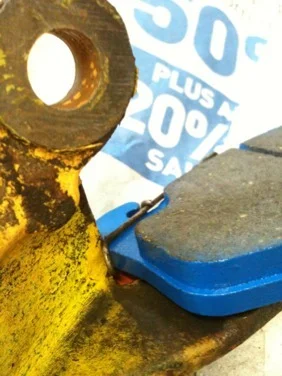

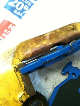

Have I put this together right. Can't work out what you do with that metal stick that goes on the pad

I had to bend the metal clips slighty when I did mine as the pads that Fred supplied had a metal backing plate which meant the clip wouldn't reach round the side of the pad initially.
I had the top part of the clip between the carrier and the 'ear' on the pad

Thanks all i've worked out where i was going wrong with the metal pin things :eek:
HUH?! sounds like you really didn't do it right
