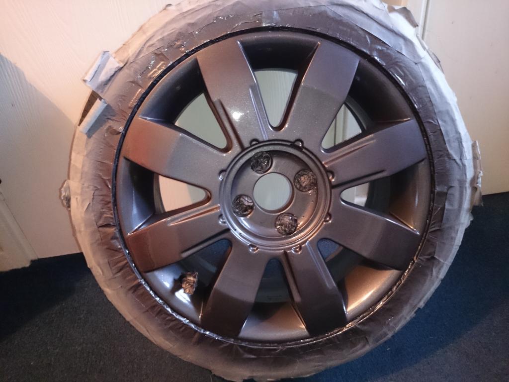

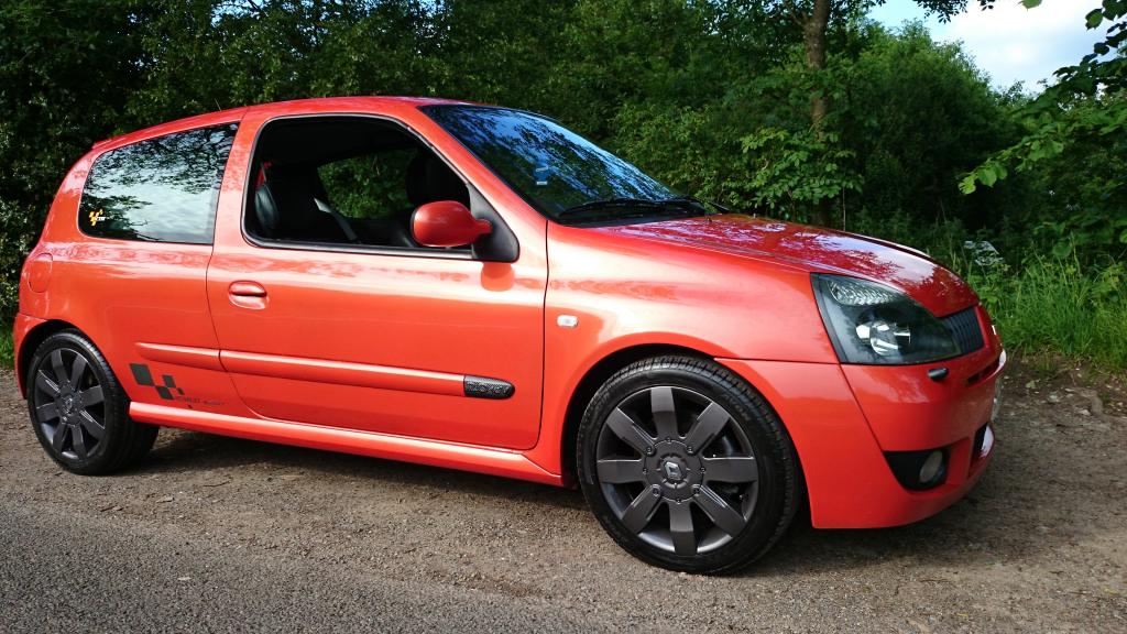

I had this issue, I Just decided to refurb them myself in a slightly darker colour and im very happy with the results :) Ive put 2 pics of mine in to give you some ideas to think about.
