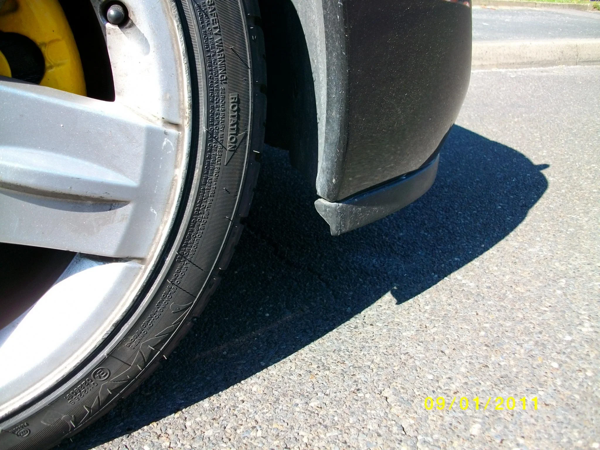

Not the best few pics but, i found it easiest to take off the bumper, line the splitter up (start in the middle) tape it into place, i didn't bother with pilot holes the plastic seems very soft and used about 20 self tappers to hold it in place
You should have a little overlap at each end like this
then i just used a stanley to cut the ends off
