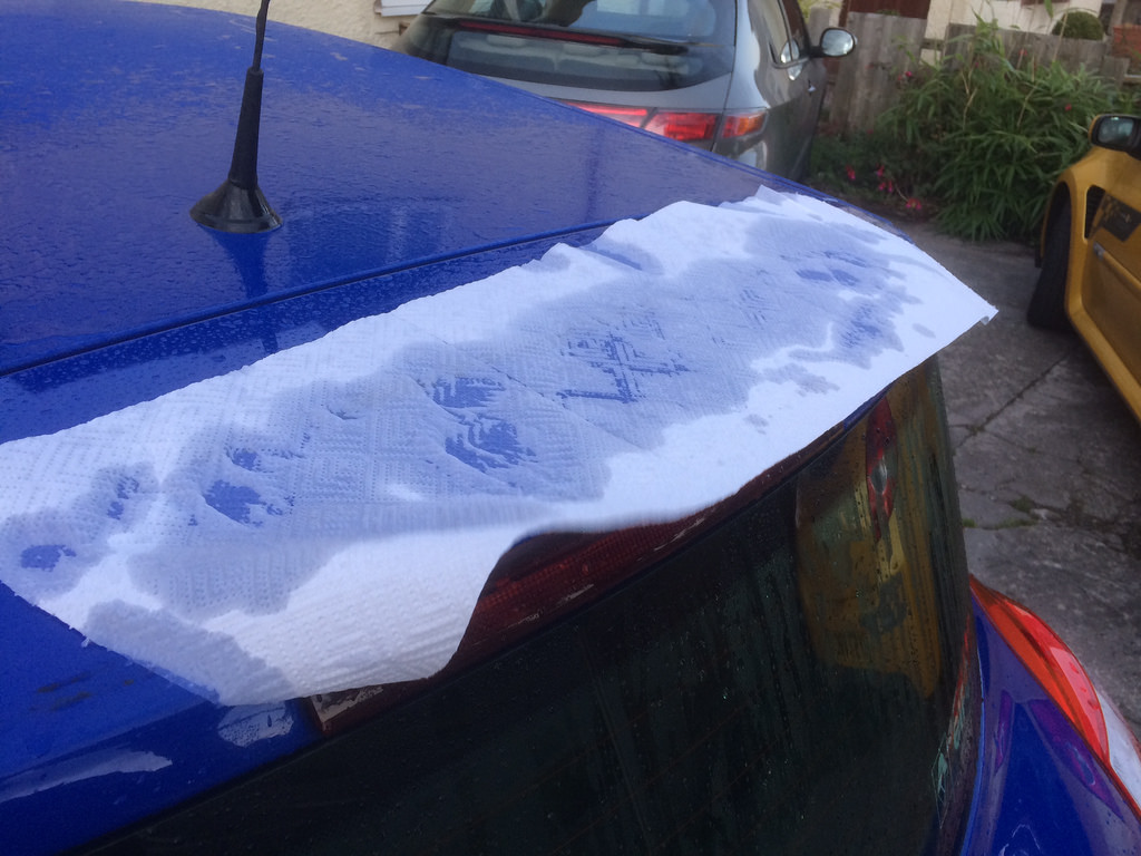

Autosmart tardis or carpro tar X
Spray on, let it dwell, wipe off
Or if its stubborn, saturate some paper towels in whichever you buy and press it on until the glue is soft enough to wipe off
