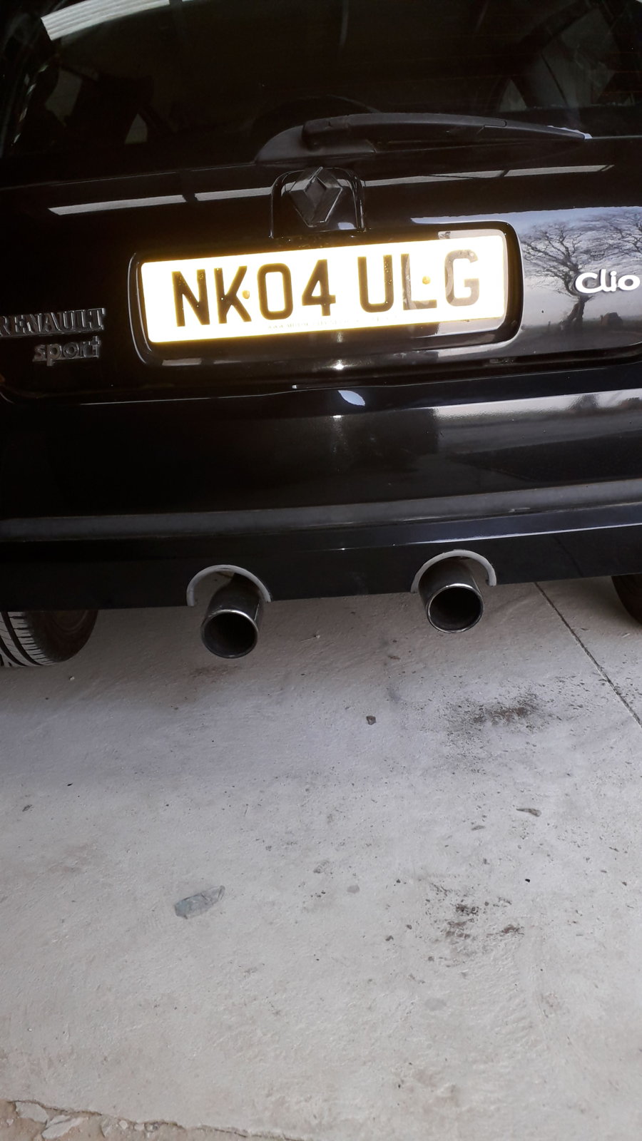

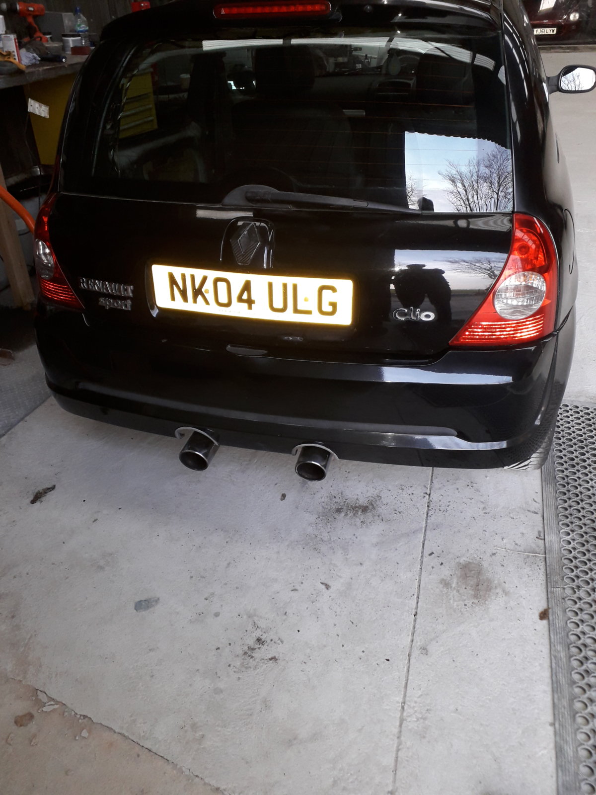

What colour is it? Post a picture as that will give clues too.

If it's black make sure you get a picture of it in the light close up so you can see the metallic in the paint! If the metallic is gold it's BG in colour which only came on the 182.

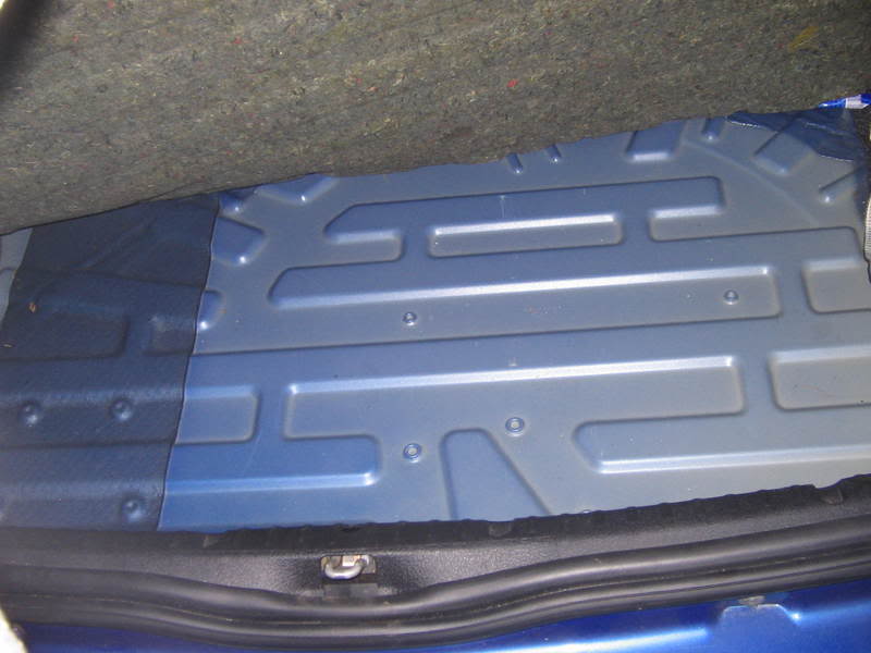

Show a pic of the boot ? I'm sure someone with a later one can put a pic up to show you that's equally as shite looking.
  Clio 182
I will get a pic at lunch time but the welding of the conversion is like manufacturer quality. The exhaust wasn't hanging right until I attacked it.

I don’t see why your average punter would bodge up the boot floor when there are work around exhausts that make it look like a 182. Just seems a bit strange
Crybert
  Cup 172
I wouldn’t say the boot floor looked ‘factory’ from the factory lol
