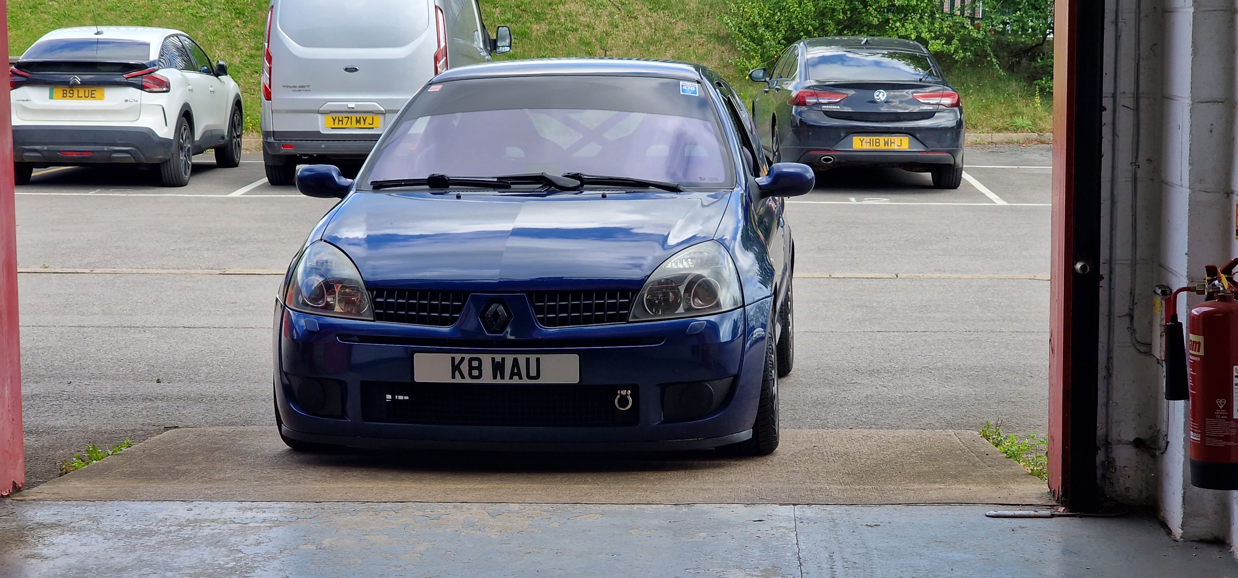

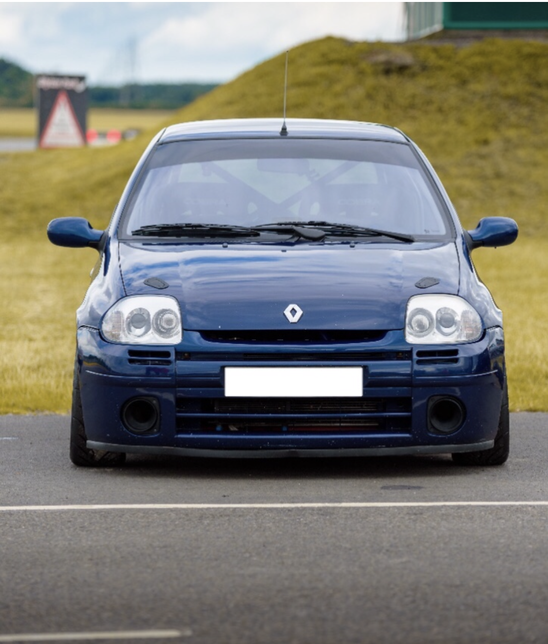

Or how do i get so much Camber like on the pictures i send with? maybe someone know the owner so i could talk to him(i got the picture from here but i cant remember the guy who uploaded it)?

That looks a lot, maybe ok for track with 15" wheels and tall sidewalls.
You need lower adjuster bolts and top camber plates. Each will give you around 2 - 2.5degs.

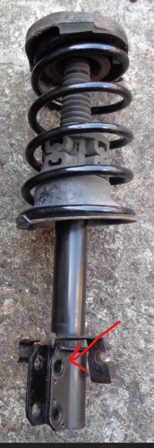

There are various styles of top mount available for 172 and 182. Some from memory require cutting the top of the strut which seems a bit much.
A few posts down.
Yes the lower bolts are often called camber bolts - again some are better than others. I have Eibach and they have been fine (not moved).

Thats the one @Touring_Rob i used a carbide burr and die grinder.
