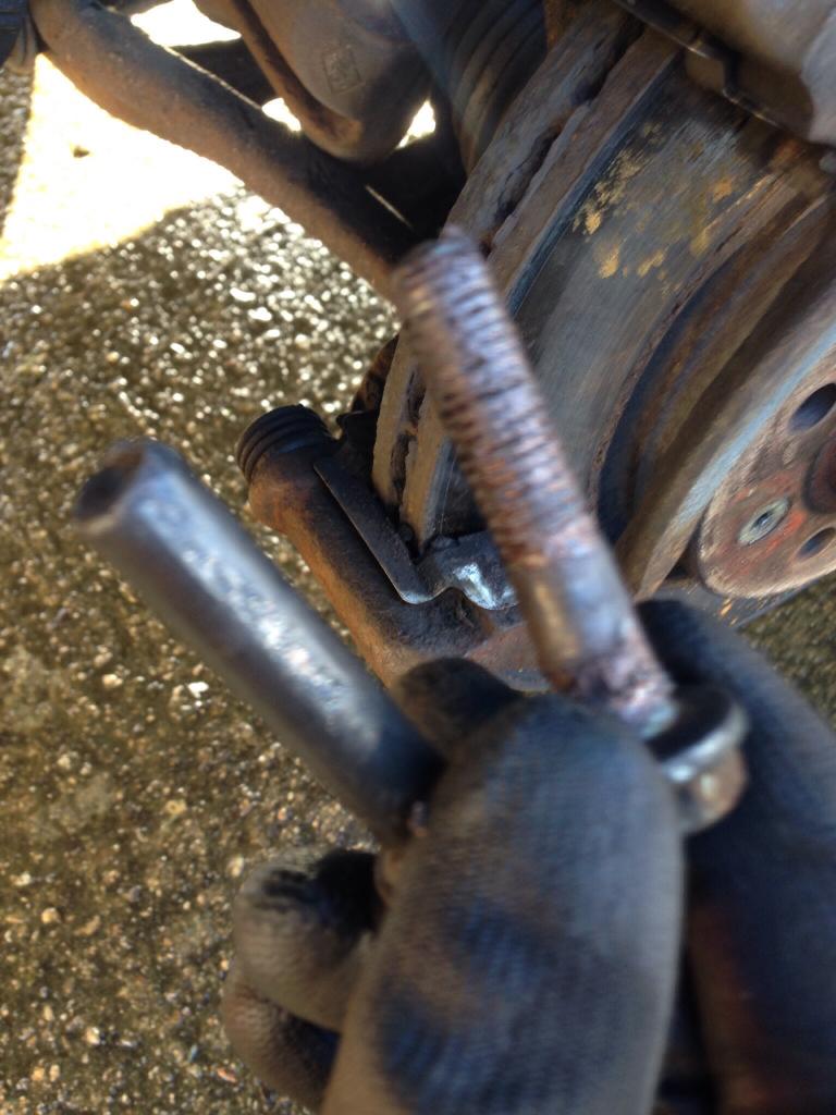

But today I worked on the brakes as they were being a bit funny, was going to change the pads and found that the muppet who mot'd it last year had put a bolt in the place of a slider pin that had broke!

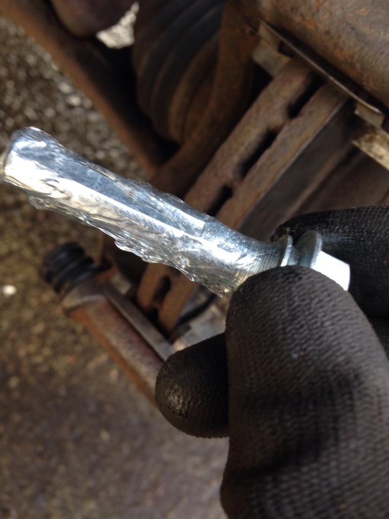

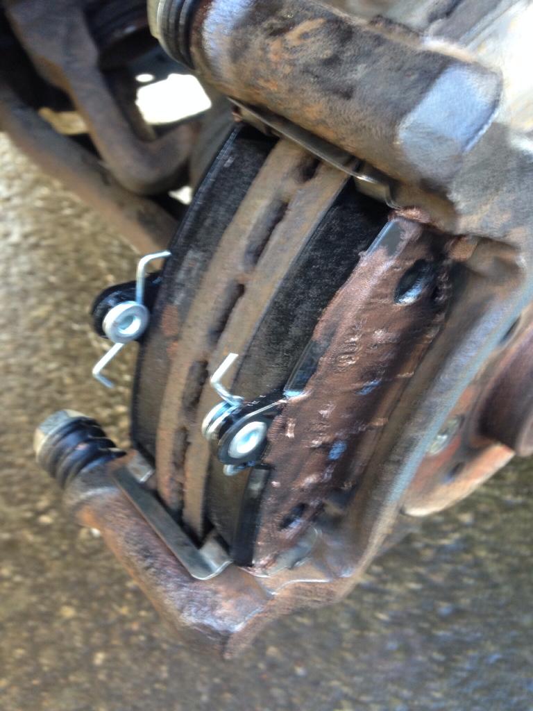

No wonder my brakes were being funny. Anyway so I got some need slider pins, then cleaned the brakes best I could, and lubed my pins up with some silicone as I heard copper grease was baaad.

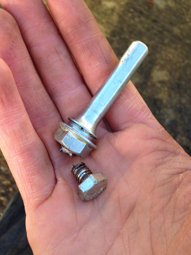

so got it all back together and put my new pads in with some copper grease on the corners, Larry dar... I did manage to tighten up one of the slider pin bolts too hard and it may have broke haha. Luckily I had a spare set of slider pins!
I don't think ill use a torque wrench to tighten that bolt again (don't know why it didn't click only set to 30 lbft), think I'll go with the 'tight enough' rule hehe :).
So yea this was my second proper job since I normally just mess around with stereos and stuff, so I'm quite proud of it. Just one thing, the brakes feel a bit spongey still, I guess the lines need bleeding? Don't get me wrong though they're a huge improvement!
