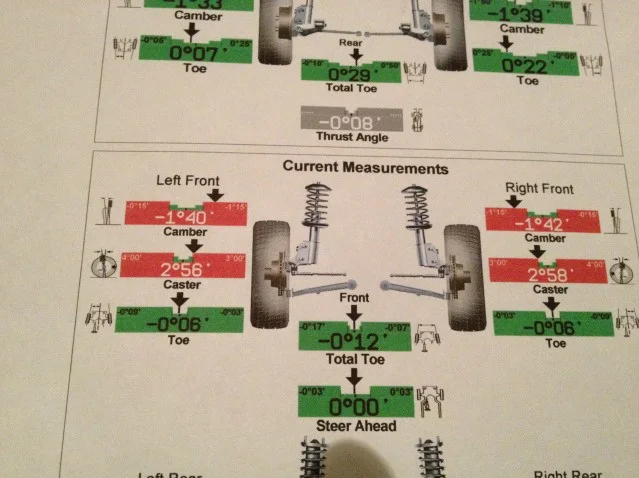

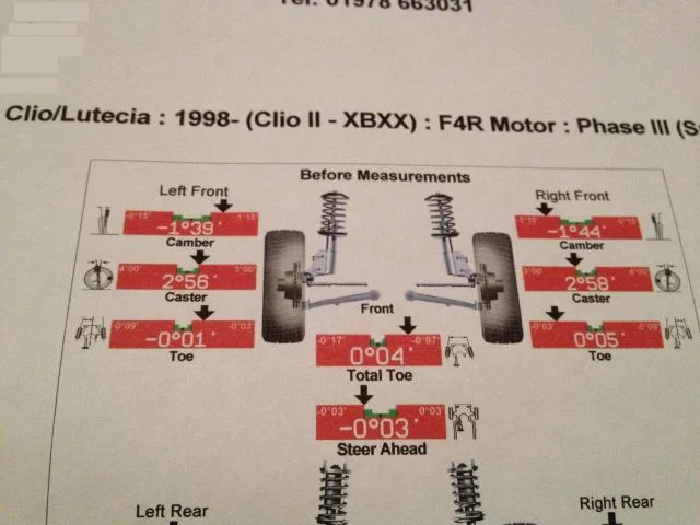

Before Last allignment
After and how it is now

Have you checked tie rods? Also those print out are showing 2.5 degrees of positive camber, or are they just missing he - sign?

  182
It looks from one of your pics that the rear "thrust angle" is out, admittedly not by much. Could the rear have hit the pothole also, taking a bit of a heavy jolt one side? (Clutching at straws here!!!)
I would investigate the possibility of trying to get the rear axle mounted a bit straighter. I've not touched mine so I'm not sure its even possible, but there may be a tiny bit of scope to alter its alignment where it is mounted to the chassis? Maybe wrong there though.

Hadn't noticed the thrust angle and toe on the rear, too focused on the front. Driver side a lot more than pasanger, regardless of if that's issue i've got that needs to be sorted. Thanks
