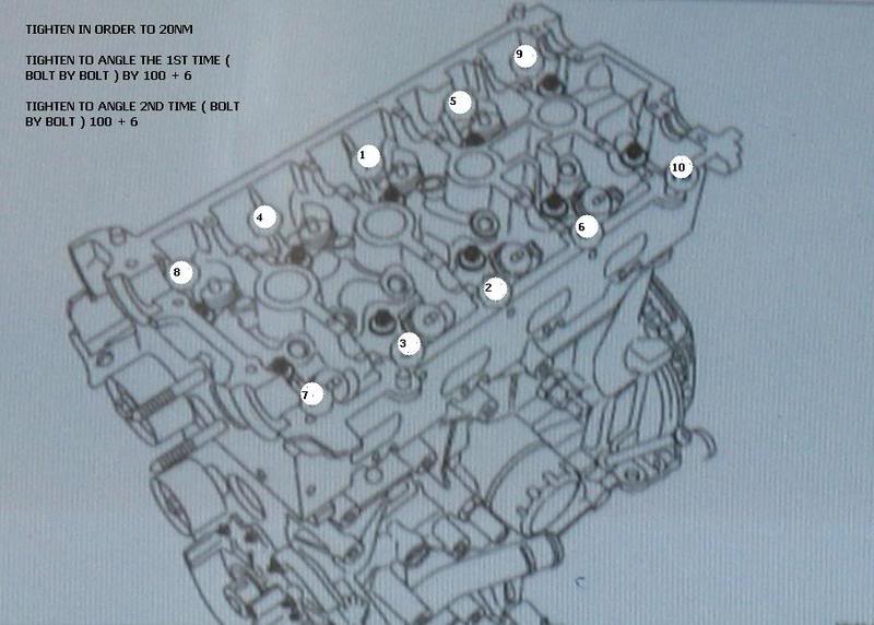

are the head bolts stretch bolts ?
what do you torque the 172 head down to ?

the bolts are stretch i believe
you should use the cam alignment thing to do it proper. makes it spot on.

1 - YES
2
3 - YES
http://cgi.ebay.co.uk/RENAULT-16V-D...yZ122162QQssPageNameZWDVWQQrdZ1QQcmdZViewItem
4 - ON THE BELT - PART NUMBER 7701476675 ( KIT )
5 - PIC OF HYD TAPPET WONT HELP - CHECK FOR VISUAL DAMAGE AND THEN COMPRESS IT AND RELEASE TO TEST IT
