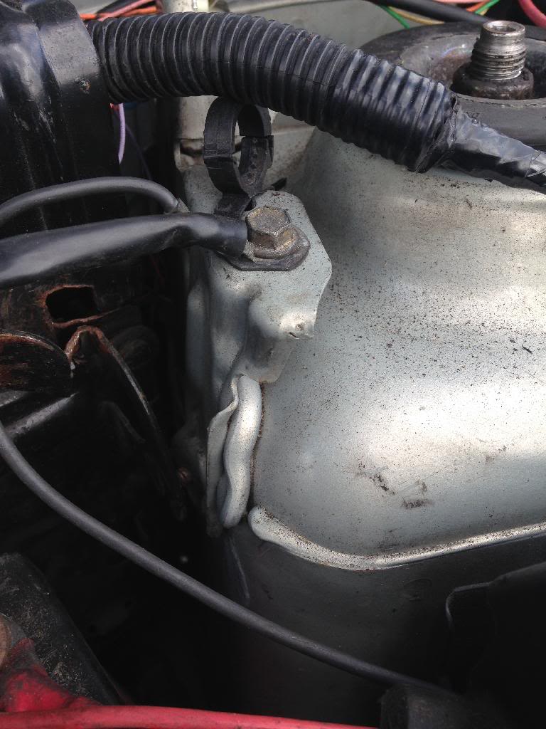

  RenaultSport 172
Grazo that earth doesn't appear to exist on my car. And I certainly didn't take it off. I removed the original battery earth but left it connected to the chassis. Just checked the impact switch thingy and it looks untouched. So annoying but it must be something. I can't have damaged he ecu can I? All I did was lay it on its side

May be ph2 cars which have the earth then :)
