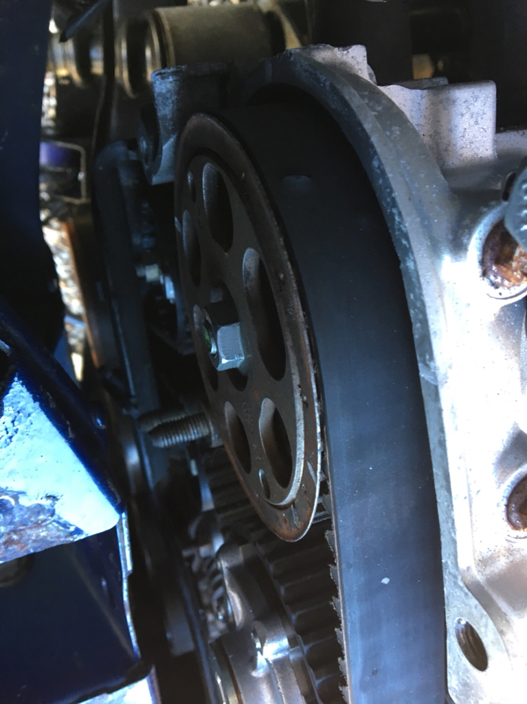

Checked tipex marks out by three teeth, looked round belt and found stone embedded in belt! Took rocker cover off all the valves sittinglevel and they all push down and spring up so think I might have been lucky!

Yeah I was just checking before I ripped it all apart put the crankshaft pin in the stone must have made it jump teeth until it stopped gutted

I was wondering if I could do a leak test here’s a picture of how far out it was, what do you think?

I done leak down test and as air was rushing out the inlet manifold with no cams in I would have a guess they are bent. Now what to do, engine, head or bin the lot!
  Clio 182 FF
Take the head off and replace any valve that's hit a piston. You'll see the witness marks. Even if they look straight always replace a valve that's hit. Check the guides carefully to see if any are cracked or worn. Should be the best solution.
Buying the correct timing tools would be a start. You can NOT use tipex on these engines.
But you are better off buying a good engine.
  clio sport
I used the proper Renault timing tools, I did the timing with the engine out to the Renault workshop manual and in the manual it’s says put tipex on turn it over make sure they are in the same place. The only reason the timing jumped is a stone was embedded in the belt.

Yeah I had driven it I had just put all the bumper, plastic trim headlamps etc must have fallen off something. I’m on a gravel drive and it gets everywhere must have fallen off something I had picked up, if you look in pic you can just see where it came through the belt
