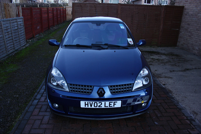

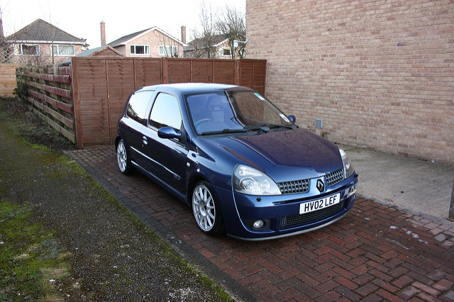

well after messing about all day mostly on the headlighs, I thought I would show you how it turned out after all your help.
They are not the best but I managed to get them alittle clear, once I get some more wet and dry I'll try again, but not bad for my very first go with the G220.
thanks again for every ones help.
As already stated, you have gone it a bit heavy with 600grit, but hey ho, its done, so now you need to try and fix it.
GEt your self some more grades of paper id suggest 1000, 1500 and 2000, go over the light again, stepping down in grade, then polish with an abrasive (your going to also need something a bit better the SRP, get something like 3M extra fine compound. Are you polishing by hand or machine? by hand is going to be a painful task :dapprove:
Lens restoration, is really something for the more advanced, and as you have already found out, forum guides can some times be missleading.

I know, that will make me think again about form guides, I tryed looking for it again to make sure I read it right but can not find the thread anymore? I have bought some menzerna Intensive polish, Power gloss and some Final finish, so I am going to give ago with one of those.

I did ask to have unlocked to edit it/and to it but can't it myself chap. At least you've sorted it. And echo Steves comments about how good the car looks! Thumbs up from this end lad!
