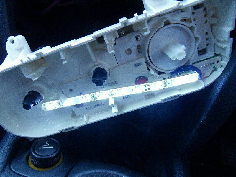

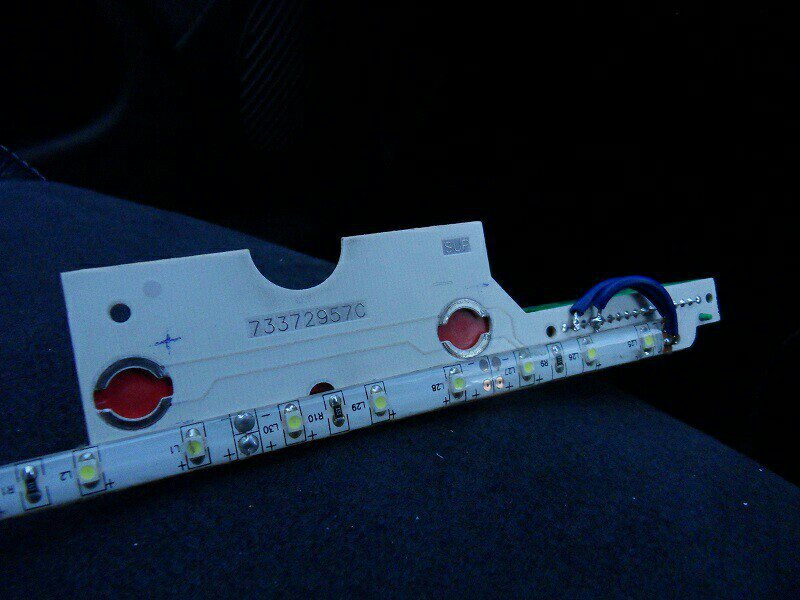

After trying the above I approached it differently. I wired in a SMD strip, it came out ok.
There is an orange filter inside the unit which also needs removing.
How did you go about wiring in the led strip in place? I'm struggling for a decent amount of white light to come through the panel.
How do you mean pal? What more information you want, the first pic shows the pins I used for the LED strip.
Once you remove the heater panel from the car you'll need to remove the orange filter this may stop the white light coming through. But then be careful not to change or move any of the dials especially the fan speed, as they are held in place by a ball bearing and spring - this gives the dials the clicky feel.

Forgot about it this. Just want to confirm is it the 2nd and 4th you have soldered the led strip too? I may add 2 to get more of a light white through.
