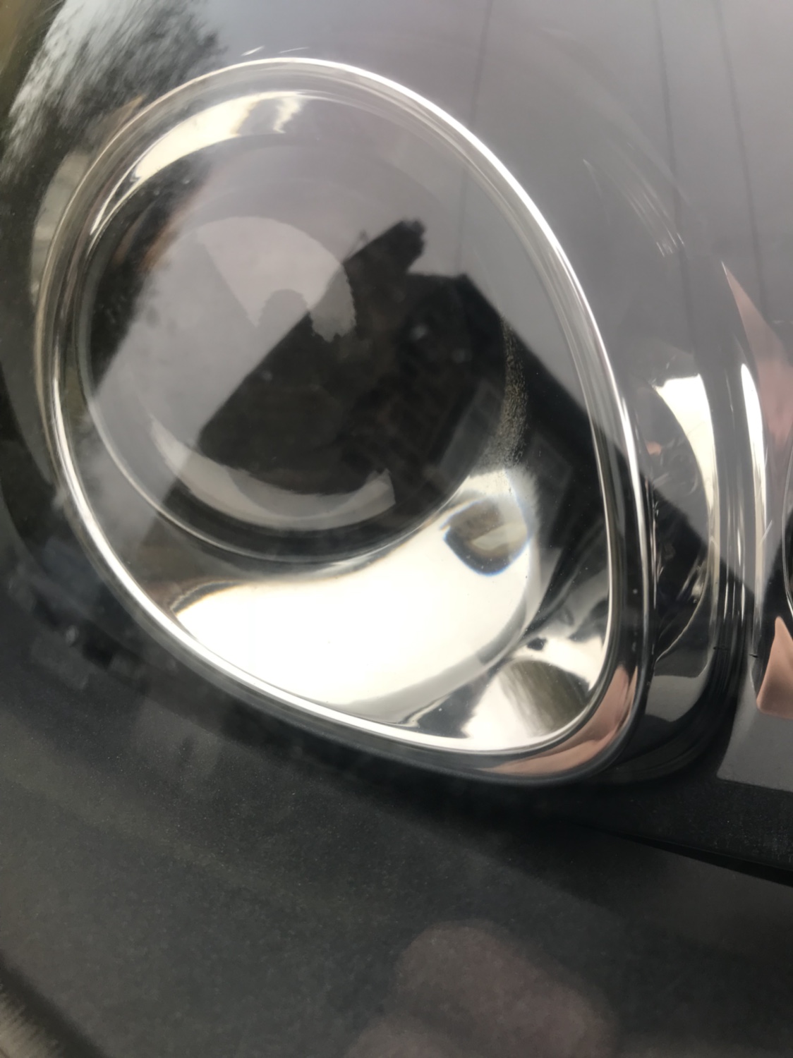

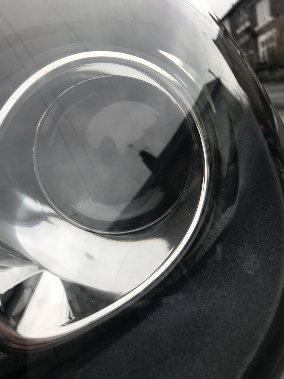

You can tell from looking at the front. Is the xenon part resting down on the chrome? Take a photo of the front of both
Sj1782
  Audi s3 8p
Drivers
Passengers

May have to dismantle them and have a good luck
