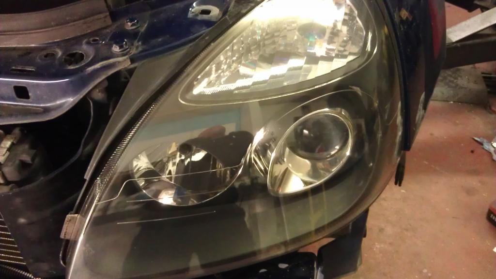

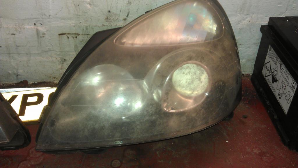

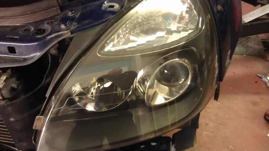

I just flat them back with wet and dry then polish them. No need for a kit
Contrary to what that article says, the above took me 15 minutes if that

What grades of wet and dry did you use and what polish to finish?
1200-2500, I finished with a very worn 2500 but you can go higher if you want.
Then I polished with g3 scratch remover.
I I use the same combination on paint touch ups to great effect

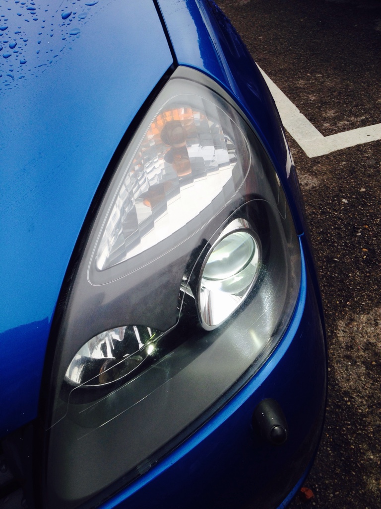

Buy the 3m kit ,for the money you can't go wrong ,did my last week on my ep3,my headlights were awfull worse than the clio above and they come up like brand new ,the kit costs 16 pound from ebay and I've enough pads left to do a few more cars if I like.
