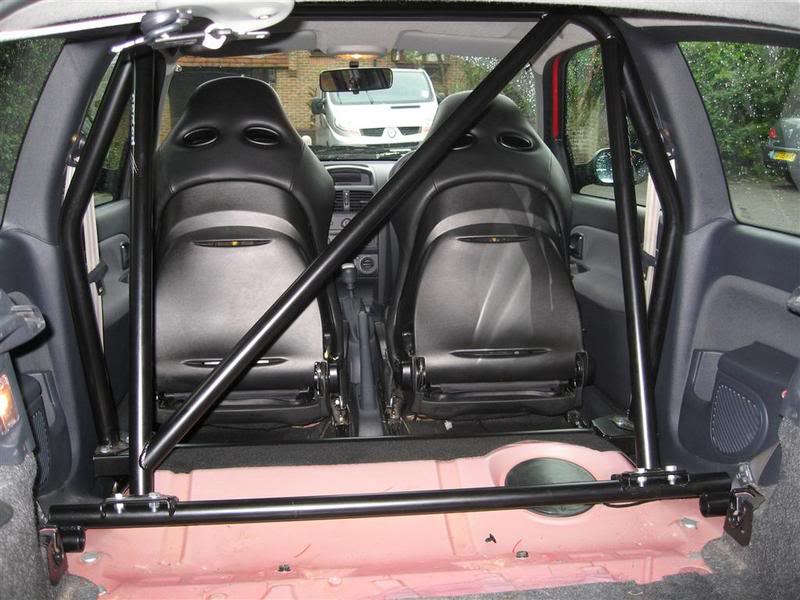

Looking at a 4 point harness on ebay but the rear strap length from buckle to eyelet clip is only 5ft, does anyone know the minimum length from buckle, over shoulder, through seat to the rear seat belt fixing points on the 1*2? Surely it's longer than 5ft?
He says it's a saloon type but seems to short...

Don't bother with harnesses if you're fixing them to seat belt points.
It's much safer to just use the seatbelt unless you have a cage with a proper harness bar.

Got the below MSV rear cage to fit and will probably wrap the harness around the bottom bar of the cage but need to know what length it should be as the bar is right above the seat belt points so will be of similar length.
