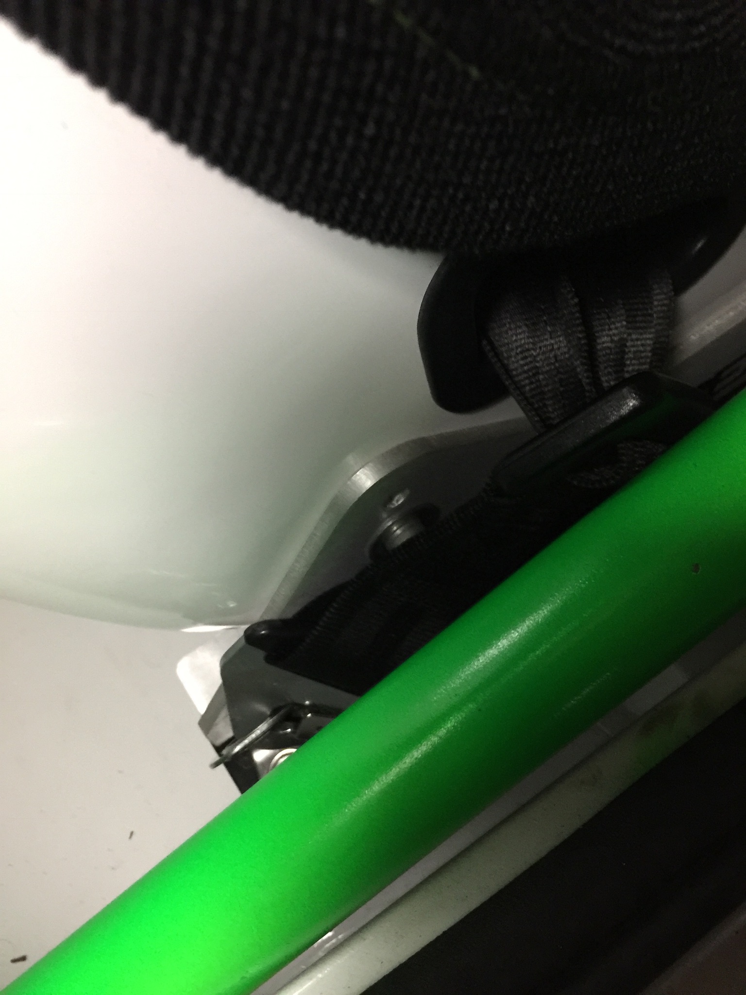

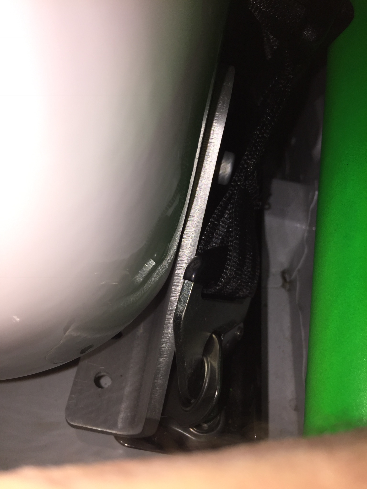

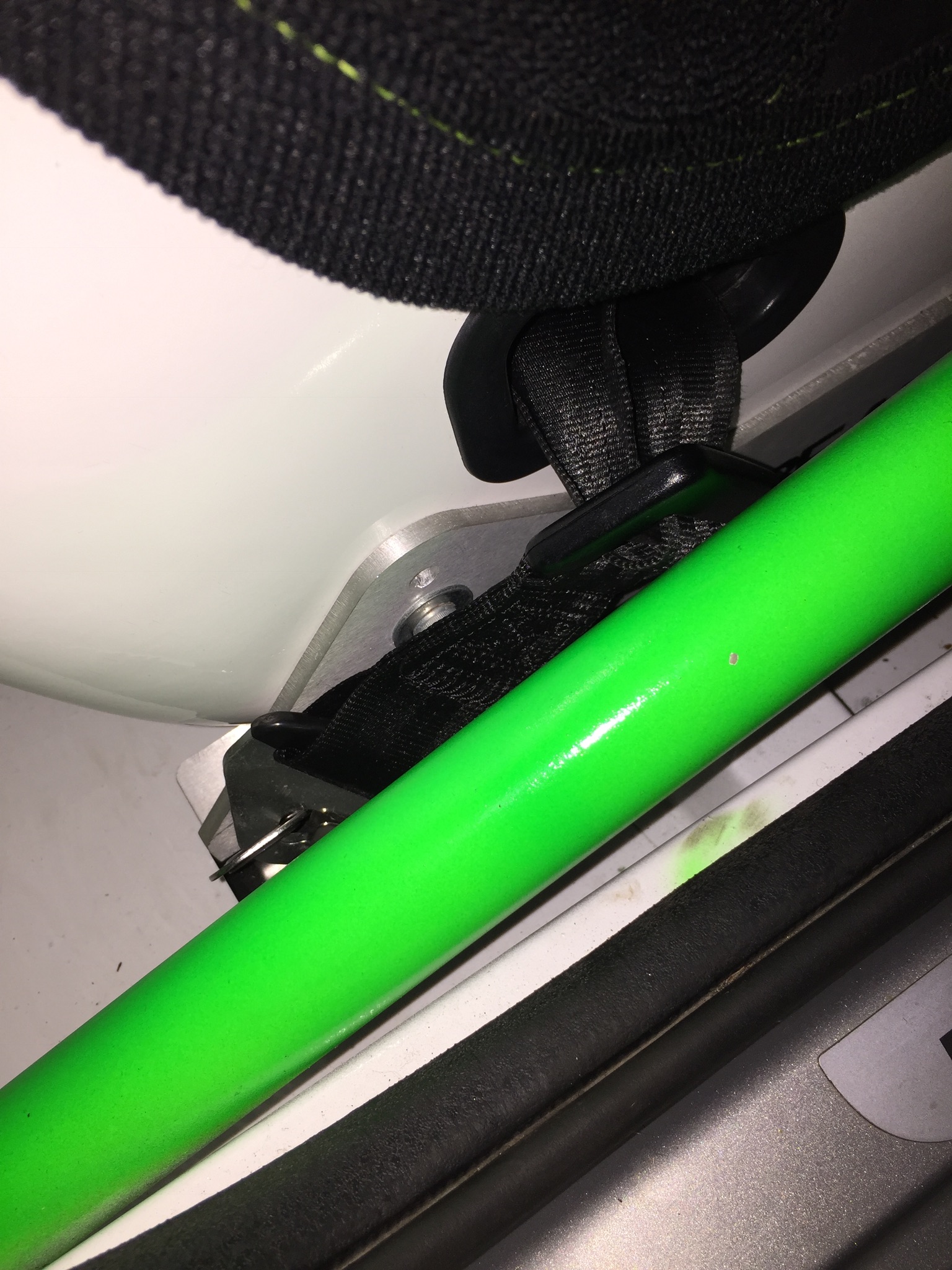

  Hi comp phase 1

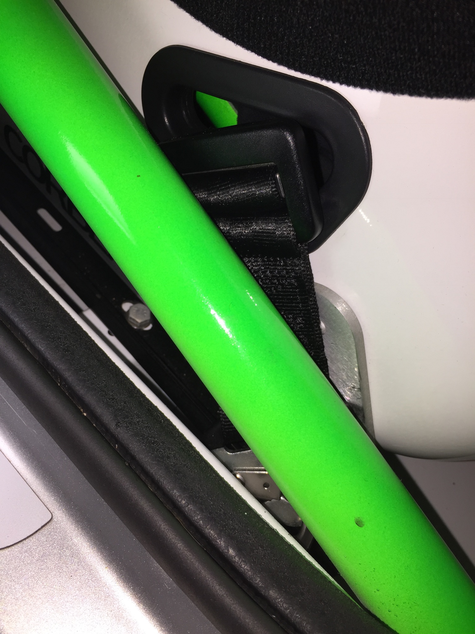

You can just about see how my adjuster sits Harnesses are TRS 4 point club man.
Just thought I’d show you...hope it helps

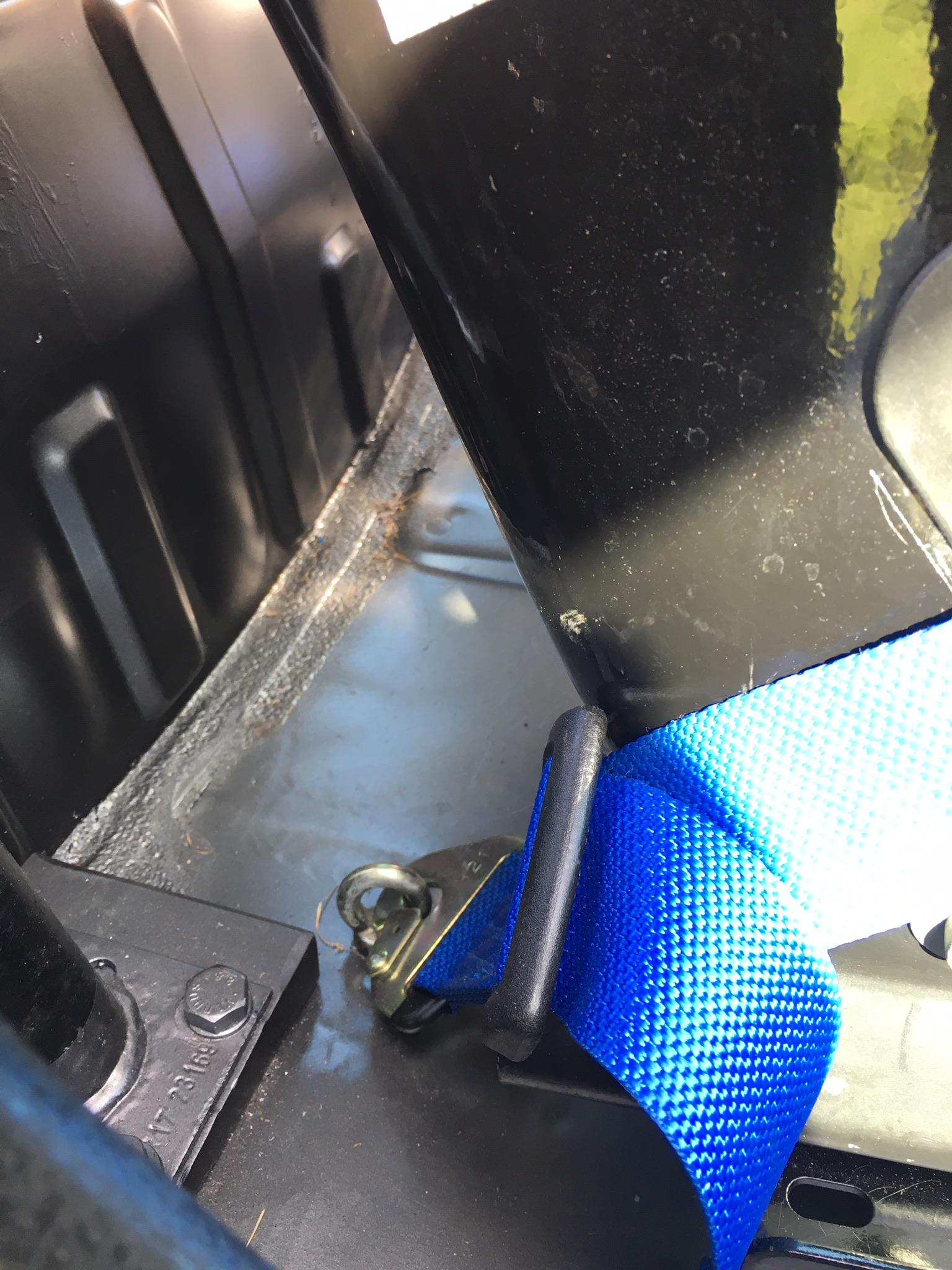

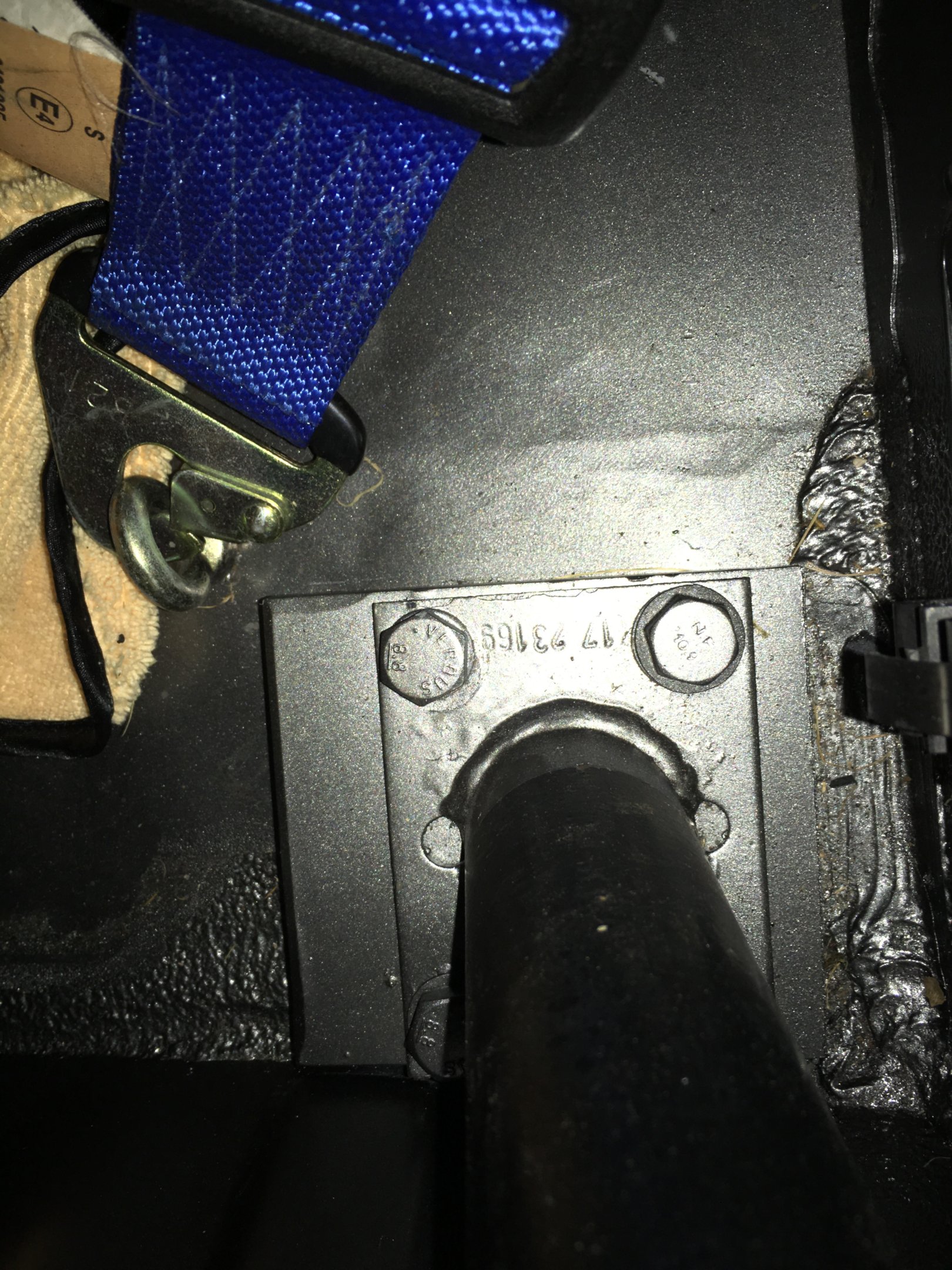

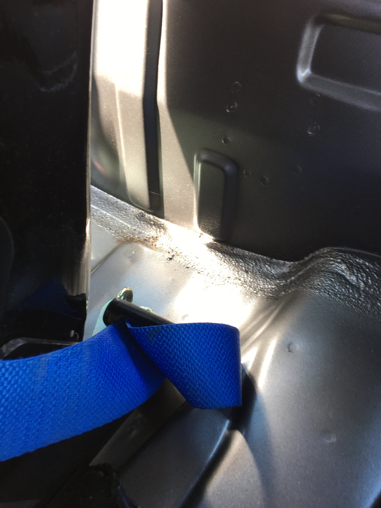

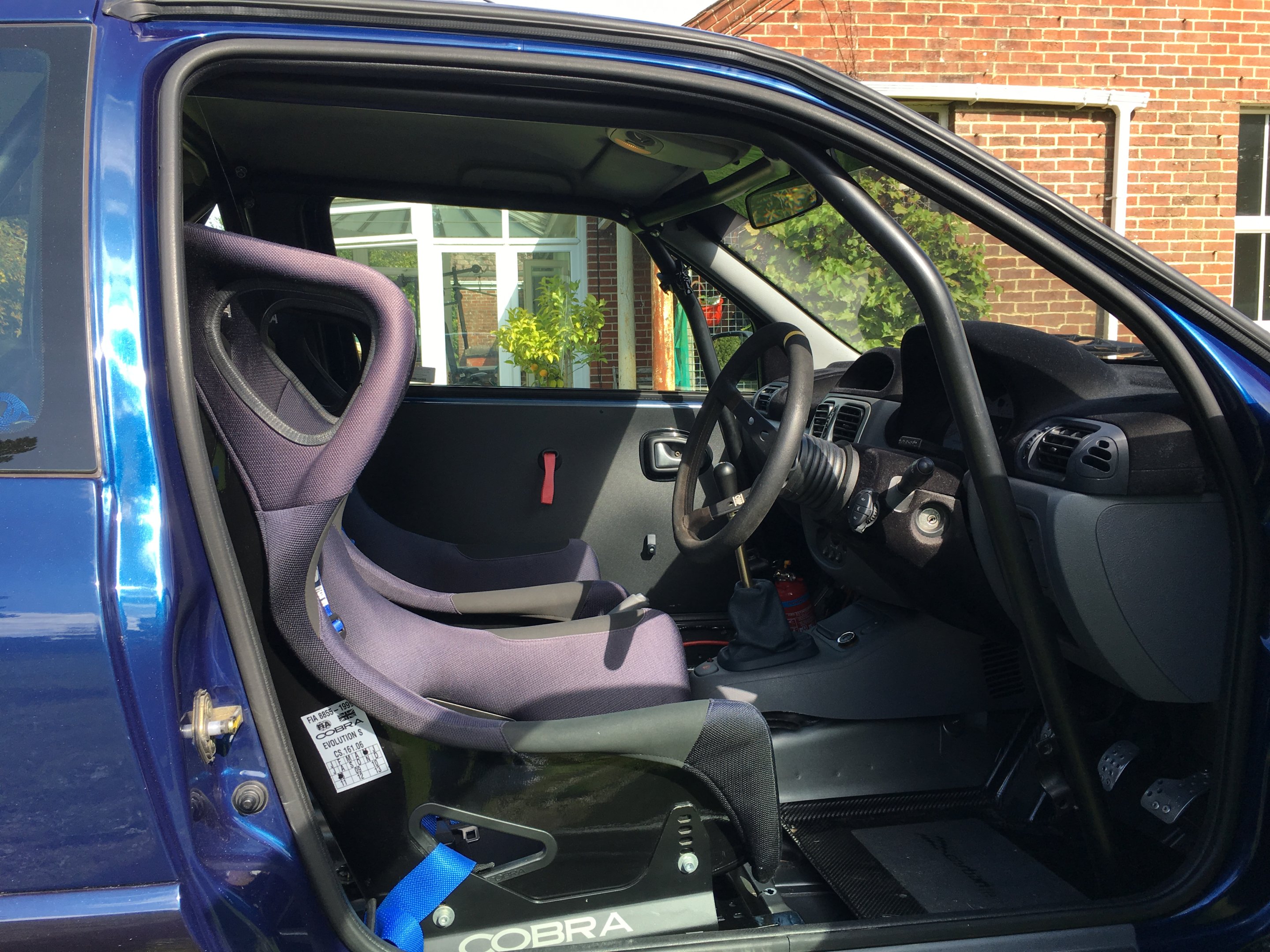

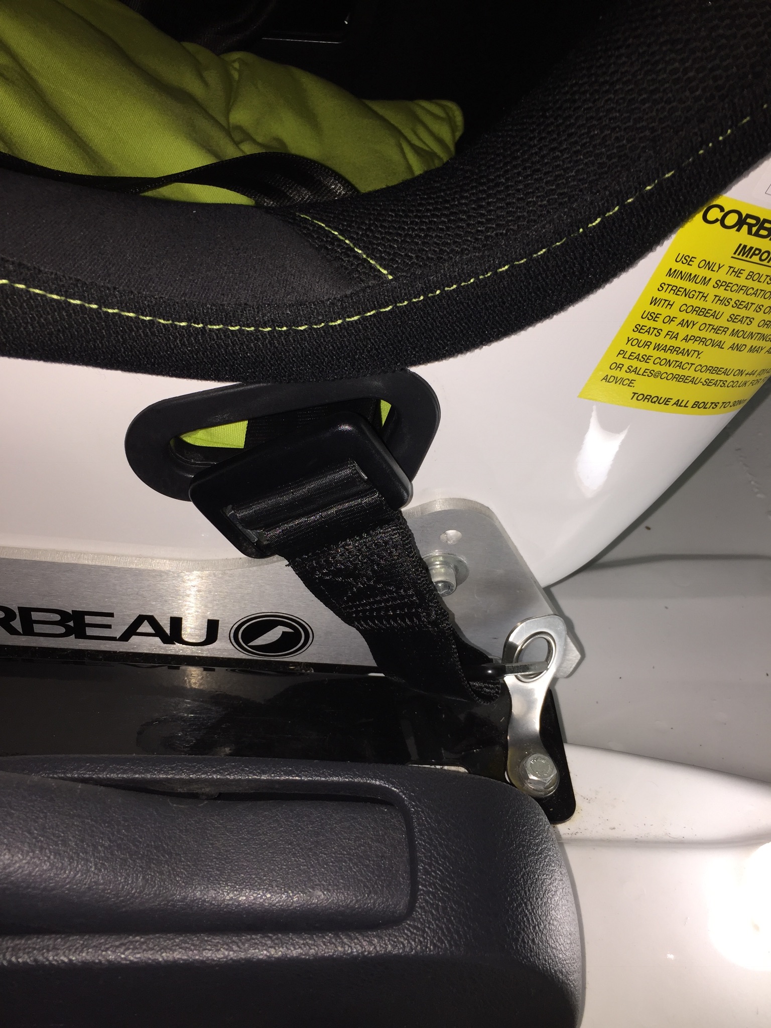

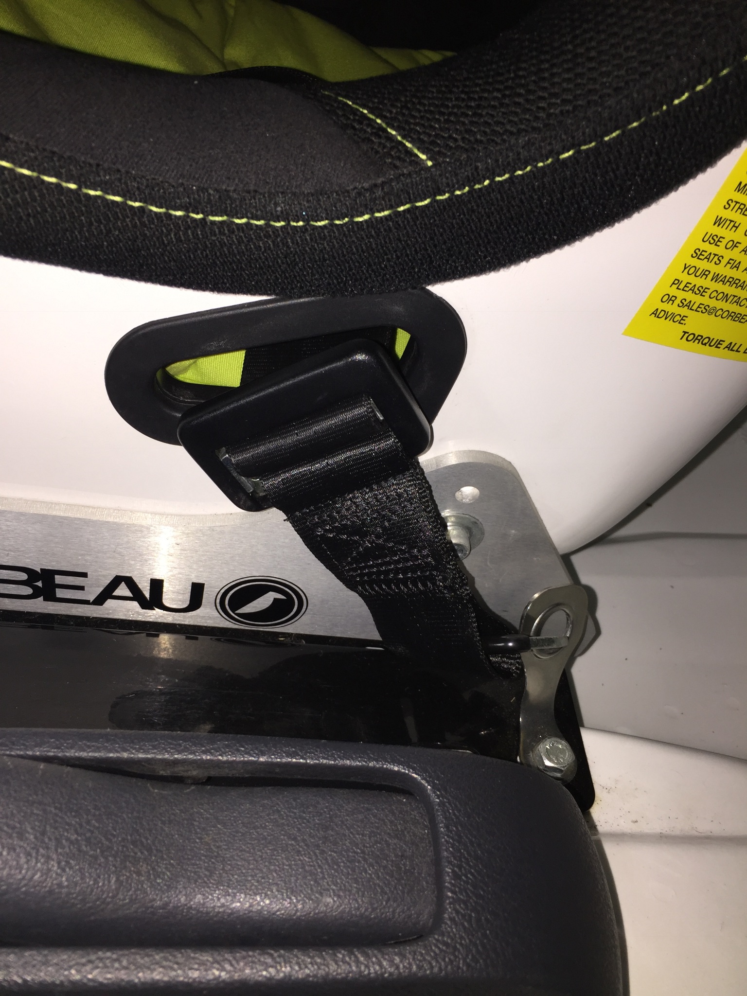

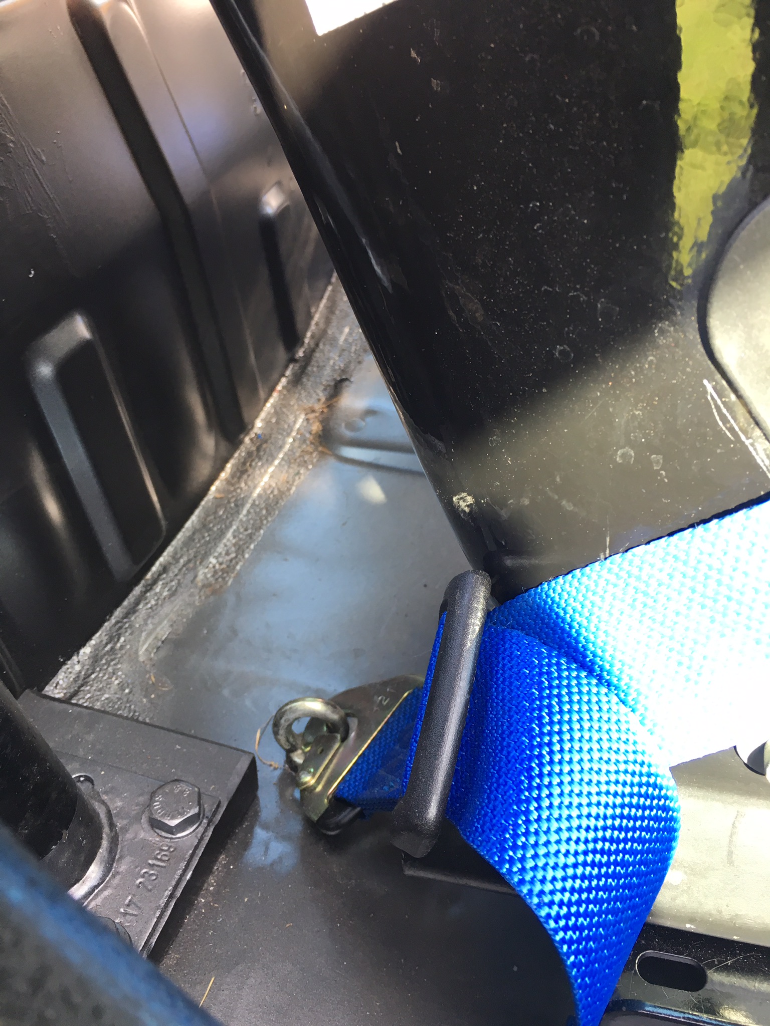

Thank you both @green and @JB21 here are a few pictures of how they are set up.
@JamesBryan here are some pictures of my harness set up
This is drivers side, as you can see it’s not long enough for the adjuster to sit inside the seat but too long to sit outside. I am not too sure what to do because if I go too far back with the fixing point the angle will be incorrect.

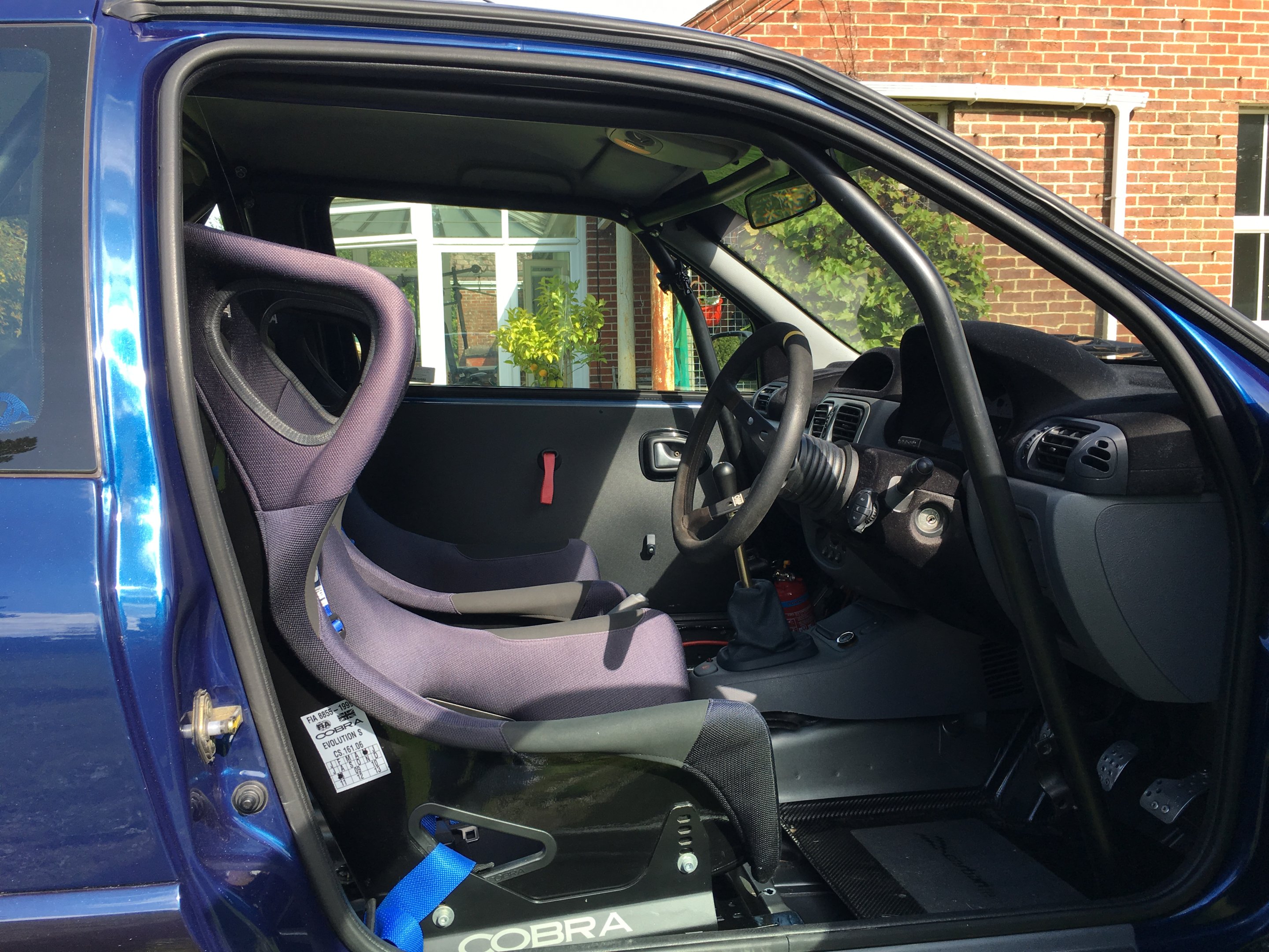

This is door side

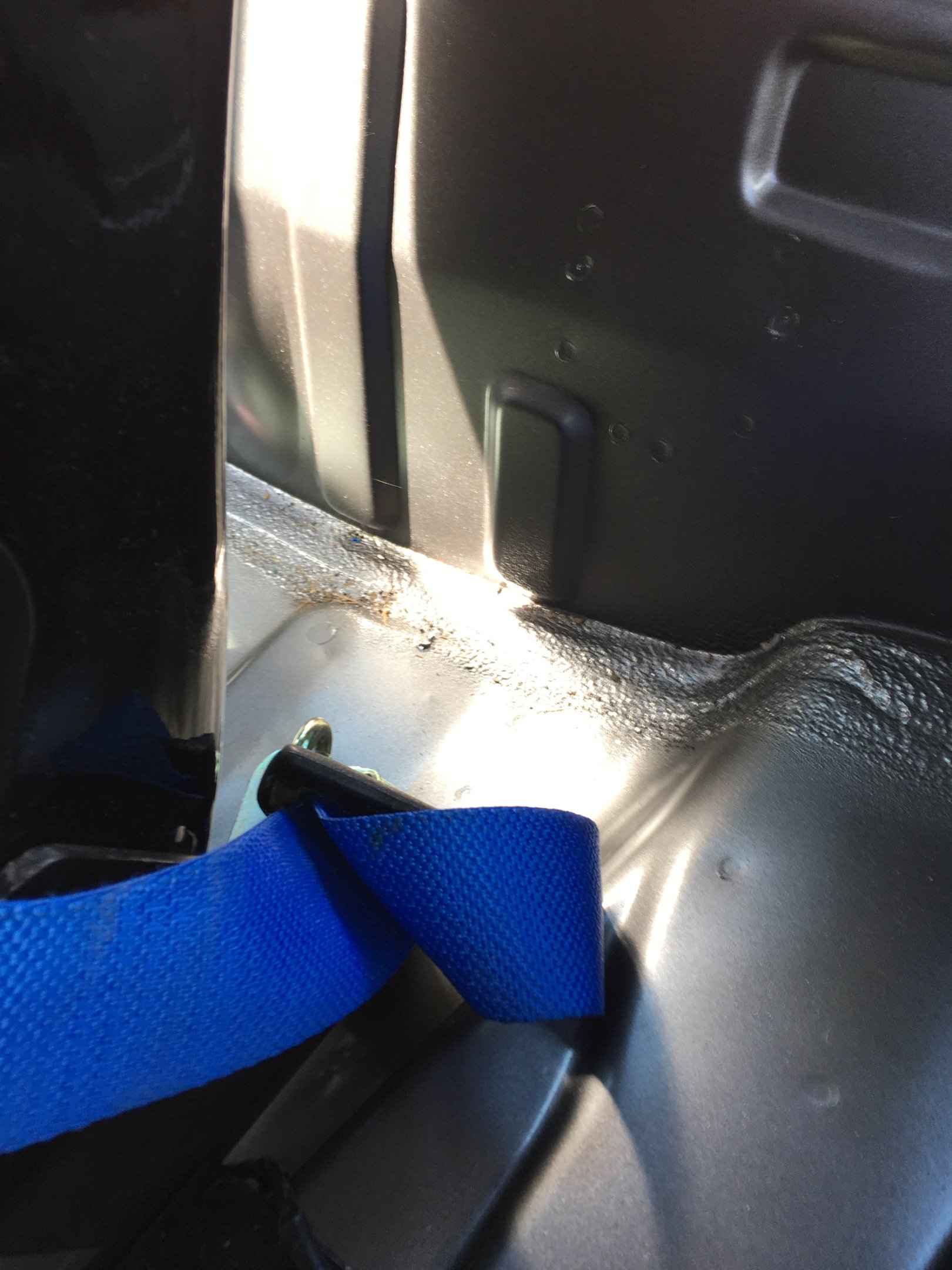

As you can see it’s extremely close to the roll cage so I can not use the original seat belt anchor points
I will be changing to eye bolts and spreader plates if I need to drill into the floor
Any help/ pictures would be great
  Clio 220 PH2
Bit of a pain how the buckle is fixed in place.
I'd mount them further back really with eyebolts and spreader plates.
I know bit of a bad design by schroth there
How much further back would you put them because will I compromise the angle and safety ?

Here’s the only photos I have left of my eyelets and lap straps.
Eyelets and plates will solve your problem

No mate, a few inches back will be fine. The angle recommended by Schroth is just recommended, not the be all and end all.
Just keep them inline with the sides of the seat, so not coming round the back of the seat.

Thank you very much I will have a little play and hopefully it will stop them coming loose while going round the track.
  Clio 220 PH2
Yeah the extra angle should help keep them tighter mate as the adjustment buckle will be pulled taut and parallel.
Fingers crossed thank you very much for the help it’s greatly appreciated.
The spreader plates under the car does it need welding or can I get away with bonding it and bolting the eye bolt through ?

Spreader plate will be held in with the eyebolt.
Try and get the eyebolts to be parallel too, like this
I I
And not running side to side like this
_ _
If that makes sense.

Ok perfect thank you I thought that would be the case
No that makes sense thank you very much I am just ordering the spreader plates now
