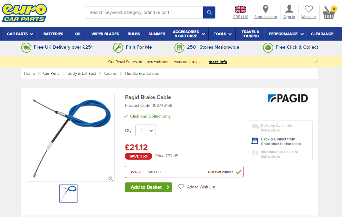

Anyone had any luck with this handbrake cable from Euros? (drivers side). I've heard stories of them being the wrong length. MOT Saturday morning and mine just snapped.
