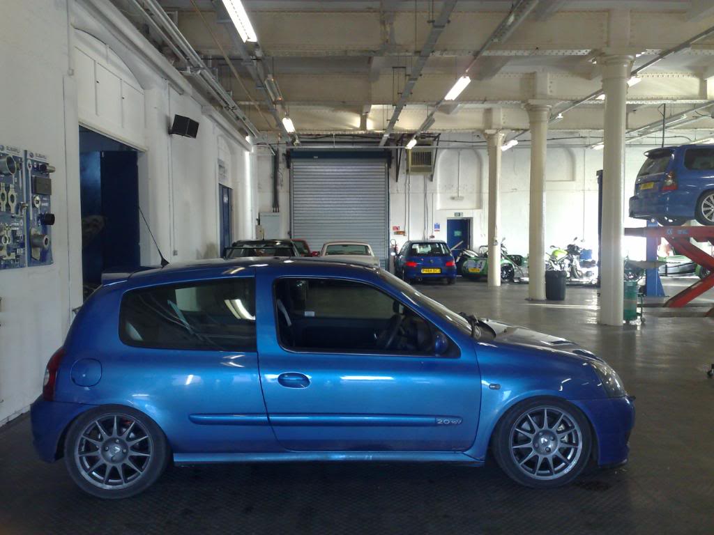

The suspension its self is amazing, i cant get over how good the turn in is and how progressive the oversteer is, aswell as the fact of there being NO understeer at all, its totally transformed my car. Had a full Geo setup too and slight toe out to improve turn in. As you can see its very low now but due to the coilover units this in no way affects performance and i still have 20mm rake even with the back as low as it is, quite scary it has another 40mm of adjustment left and my car is stripped of quite a bit of weight.

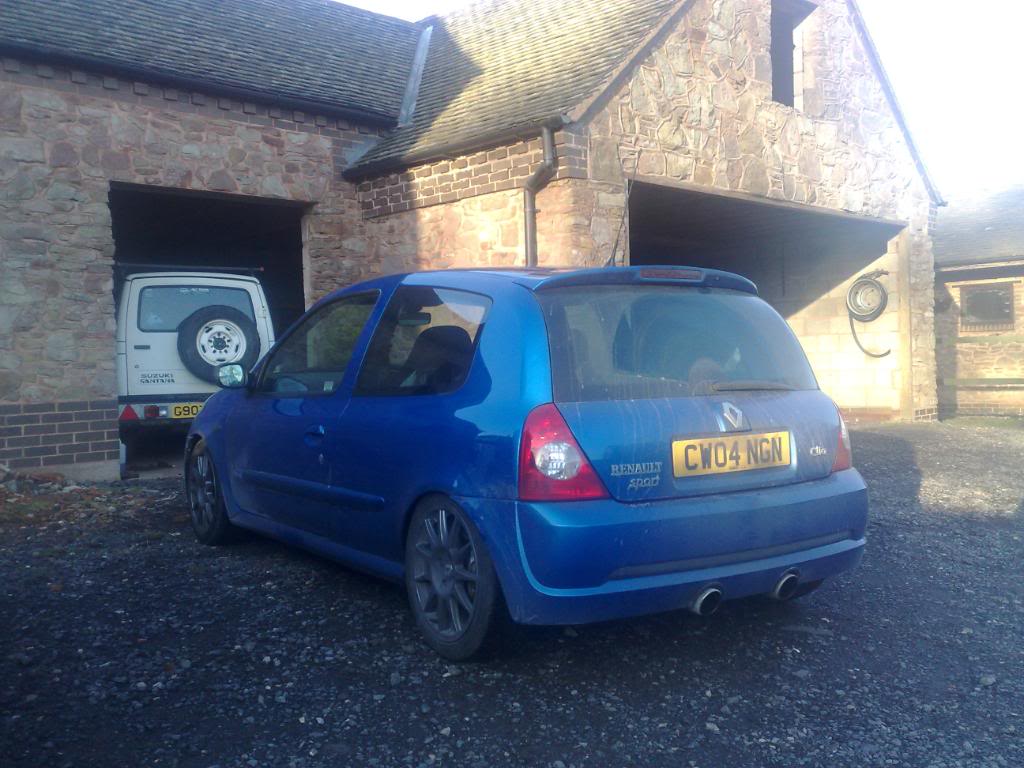

Anyway a few pictures as ive changed my bootlid today so didnt get any of it clean but will post some up shortly.

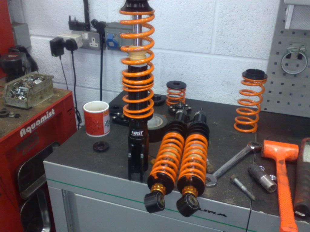

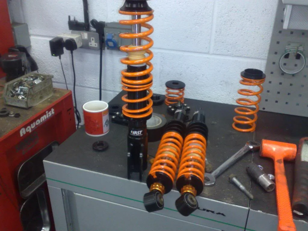

Only pictures i have until tomorrow! :cool:
280lb front 250lb rear, currently set to 5 clicks front and 3 rear, pretty happy as it is feels awesome on the road but ill no doubt have a play :D

really low though, what happens when you hit a pothole or something ; not really clearance left to absorb..
i would raise it a little. althoughthis does look the nuts

ill take some better pictures today but there is alot of length left for damping.remember they arnt setup like the usual clio suspension..
About 70mm rear 70mm front from standard setup, roughly.
Going to go wash it in a minute and ill wack up some better pictures
