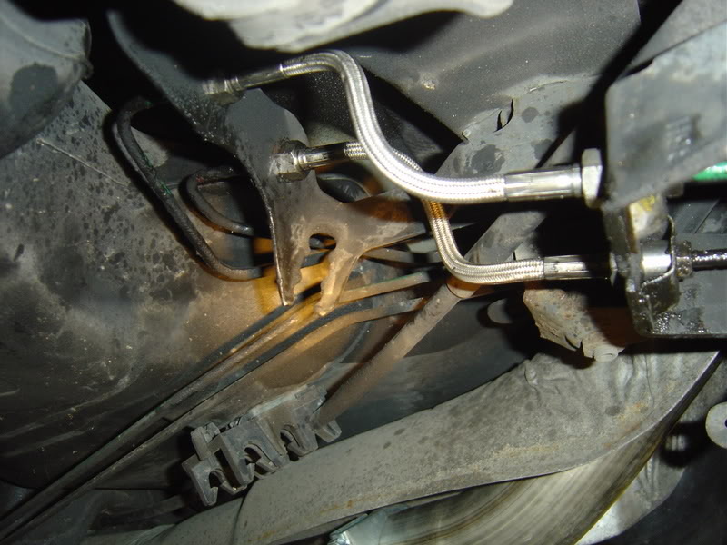

Stay Puft
  Clio 172
Here..
oreA
  BMW M135i; Clio 172
So, what about the short flexi hoses at the rear wheels, why don't they get changed? Are they less flexible than the other four and so no benefit in swapping for braided?
