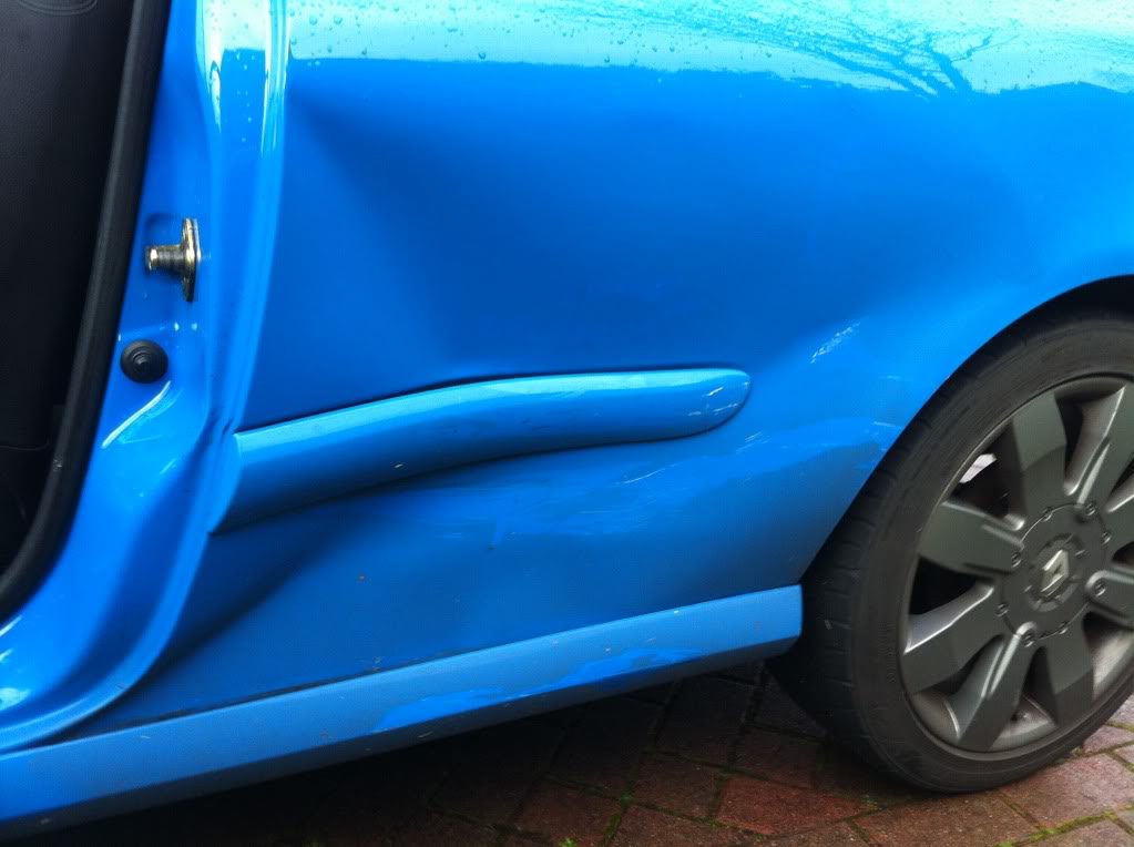

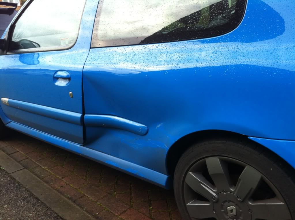

Well, last night my beloved RB was shunted by a BMW driver not watching what he was doing! #
Cutting a long story short, he has accepted full liability and its all going through his insurance. Someone is coming to assess the damage and decide the way forward..
Any ideas as to what they will do? i.e fill it, change the panel, right the car off?

Sad to say with the current market and the value of these cars it will prob end up being a right off as the hole rear quarter will be replaced.

Sorry to hear this Andy, your car was lovely. I hope you can get it sorted, most likely thing will be to replace the panel I think.

I would of thought that couldn't be pushed out as the crease's are to close to the door line edge especially the bottom left crease.

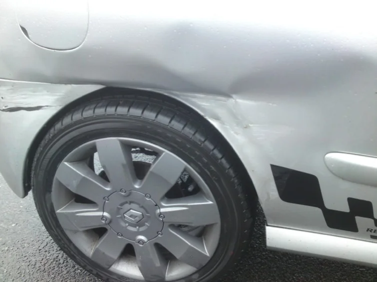

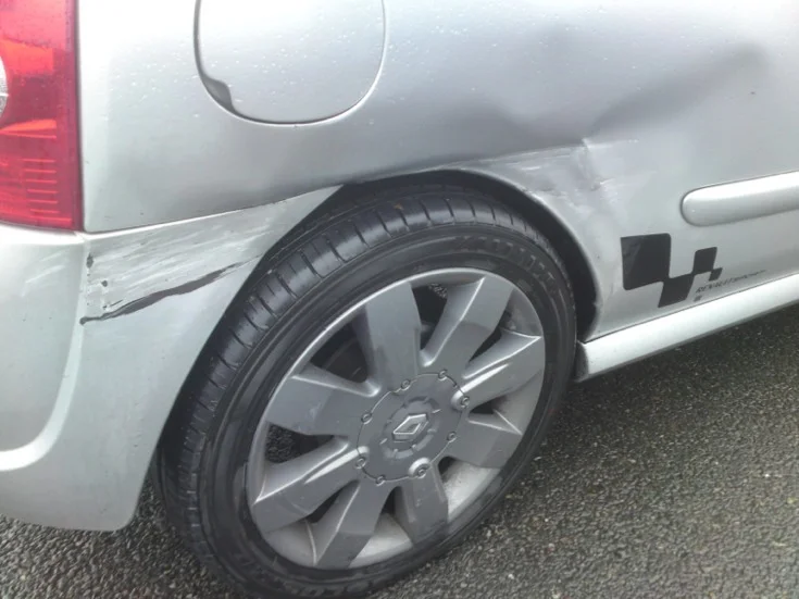

This was a cat d only a shunt from a rav 4 but the man who fixed it only pulled the dent out and t cut,

I'd want that written off TBH. Not sure if it can be pulled out properly. Probably, as the sill looks to be mostly untouched. It would defo require some filling though. You don't want it cutting out and replacing. People who say it's no big deal, have no idea how cars are put together.

I would say that will be written off! if so then buy it back get it repaired then a put a few quid in you're pocket.

Well a new back wing (while quite labour intensive) is not a difficult job and the panel can't be all that expensive. From memory they are (list price) about £360+vat. If you said £1200 for paint and labour, thats still not going to write it off.
Failing that, knocking it back out and a dab of filler will no way on earth write it off.
I'd be very suprised.

Yeah that's the only damage, made a nasty crease just inside the door though..
Seems like the general consensus is write off!
Just looked on the lap top and not only has it damaged the rear quarter the sill has been pushed in, although the sill can be repaired by pulling it out, the insurance prob want it replaced just as well as the quarter itself.
By it back after being paid out and get it repaired by a garage by getting it pulled out to the best they can and some filler and use it, or strip it.

I've been away in France for the week so not updates this, I got a phone call from the garage to confirm they are going to repair the car and fit a new panel. I'll update with pictures :) :) I'm very happy!

Knowing the Clio insides like I do the last thing you want is a new panel.
Seriously the Clio is one of those cars you do not want a quarter panel fitted to. Not only is it so easy to tell it's had one, the after problems of water getting in behind the basecoat round the wheel arch are very common.
Just in my professional opinion i'd ask for it to be repaired. There is so much access behind the 1/4 trim it can be dressed to perfection so require minimal filler... if the guy on the job is good enough that is.
It's not a great job for a panel beater to do but neither is a quarter panel to fit.

That will repair. Labour intensive for sure but as Gally has said, its better than putting a new quarter on it. We've just repaired one on an Impreza STi which I thought would never repair nicely and it was way worse than yours.
Came out really well.....then again the panel beater we have is pretty much a Rembrandt when it comes to panel beating.
