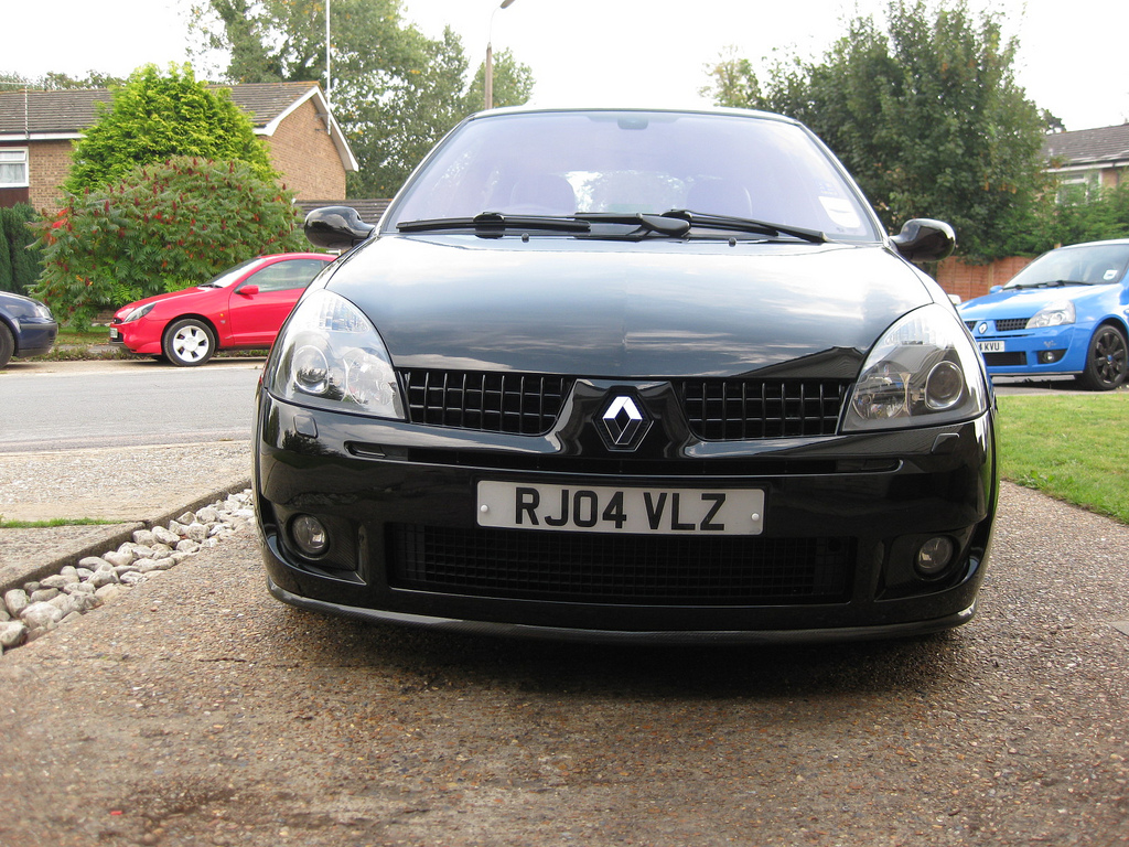

  Black Gold Trophy
Did my upper grille gloss black and never looked back, they look such a horrible bluey colour as standard and painting it really brings the car up to date.
Definitely pay bodyshop to do the grille unless you have spray guns and air compressor (like me :) ) and the best way to prevent it flaking off is to ensure parts are fully degreased and primer. So many bodyshops dont primer these days (lazyness) and paint just flakes off even if the surface is nicely keyed.
that painted grille looks really good, suits it well, agree that the standardx renault plastics look cheap and tacky
