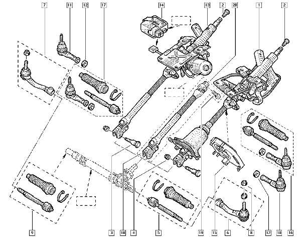

Find a donor clio with an elec PAS pump built onto the column ( no 13 )
I take it you have changed your rack when you removed the PAS system. If not it will be very hard to steer. I fitted a standard 1.2 Steering rack on my conversion and it was very easy to steer.
Cheers Matt - Yeh changed the rack to a manual one, cant remember which tho (Flans the man in the know) - dont know if its a 1.2 / dci rack with the electric pump built in it. Did you have your Electric pump working on your rack or leave it off?... Mine certainly isnt on! ha
  ClioSport 172 Cup
Hutchie I like the sound of electric rack, can you tell me your secret to make it work with standard ECU?
