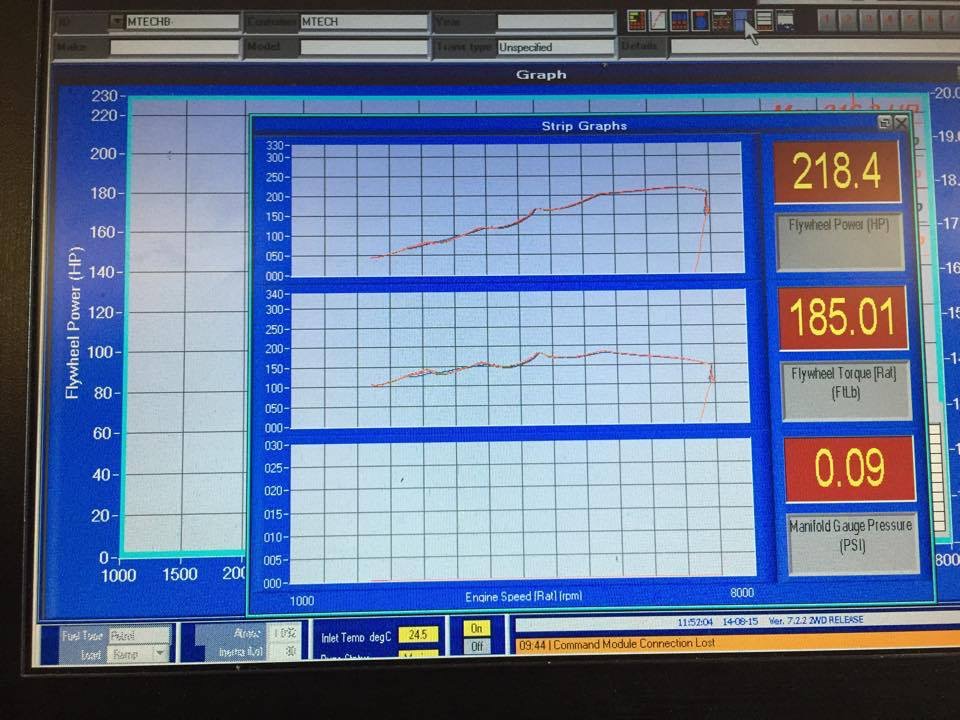

Genuine N/A 218bhp/185lb-ft on a stock bottom end.

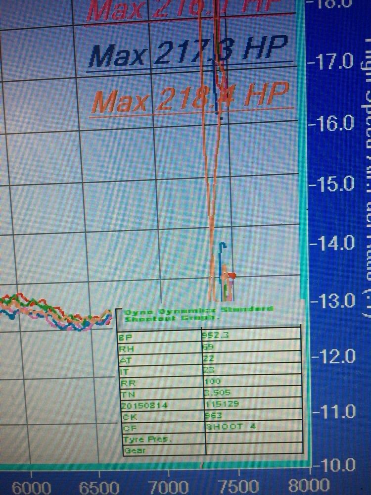

Cracking result for this customer, vehicle was brought to me to fit a bottom end he had rebuilt. Head came from ALD, with supertech's, bottom end was just new rings and a hone with ARP rod bolts. Has non-VVT 421's, ITB's with ludicrous long trumpets (silicone hose extensions) and mapped by myself on mtech's dynodynamics rolling road.

I was expecting doubt, hence posting the picture of the temp readings to show they weren't fiddled with.

You could see on the graph where they worked and where they hindered (where the graph would climb, then drop, then climb and drop, at regular intervals) but over 4.5k it's got over 160lb-ft. But there's no way it would've made the peak torque figure it did without them.

what are standard cars making on those rollers Dan?
These are usually heart breakers, standard cars rarely break the 165 mark on there. Generally speaking, they'll read 10-15bhp lower than most other dyno's. If you crack 200 on these you're doing well. Marc1330's for instance only made 190 on ITB's and 421's. (But that's not been mapped by me)
