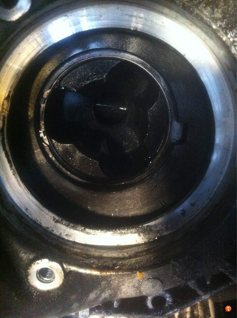

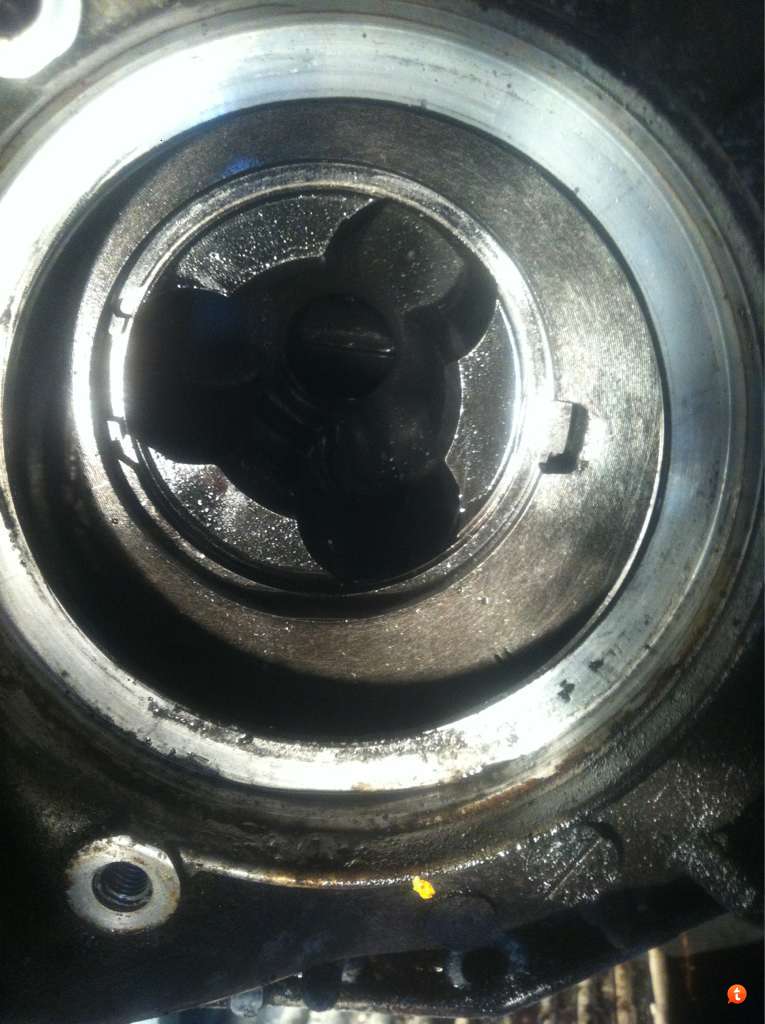

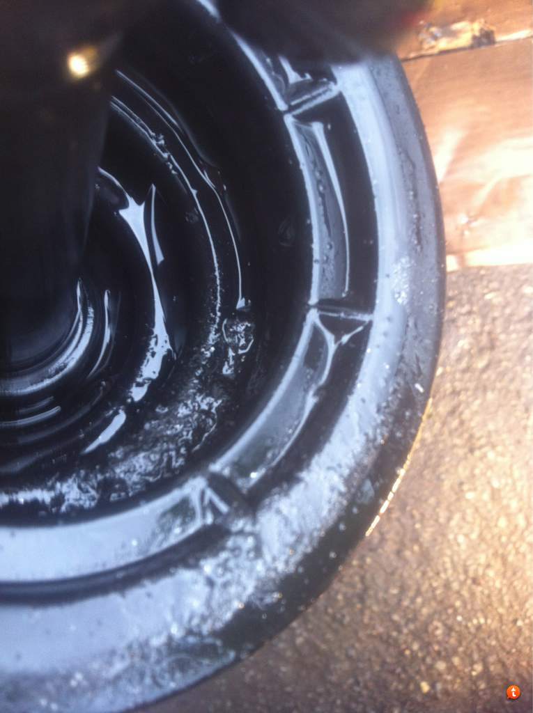

Ok so manage to get driveshaft out and took photo of where circlip is. Not really sure what I'm looking at but from other pictures it seems to be all intact. However on the driveshaft there was allot of metallic bits mixed with oil (see photos) :( something has gone and been grinding away I think. Any more thoughts personally looking like new box time.
  ph2 clio sport 172
Thought as much :( Recommended places? I believe you have had one rebuilt by Agency transmission? How was turn around time and cost?

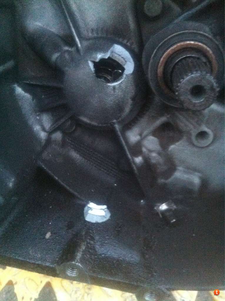

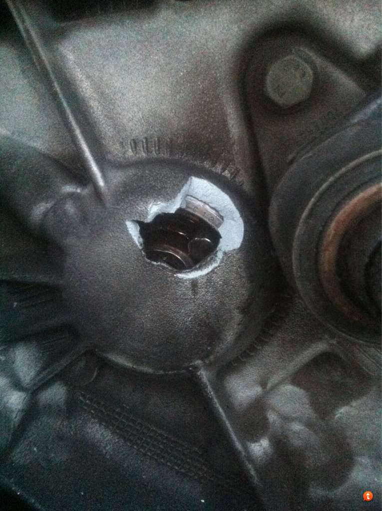

Finally got box off and think its obvious why it kept stalling and get stuck in gear. :(
That's dead then. I've got a box that works fine when I drove it, but I didn't drive it hard so couldn't say if it crunched up high in the rev range. If you want to send it for a rebuild that's up to you. £75

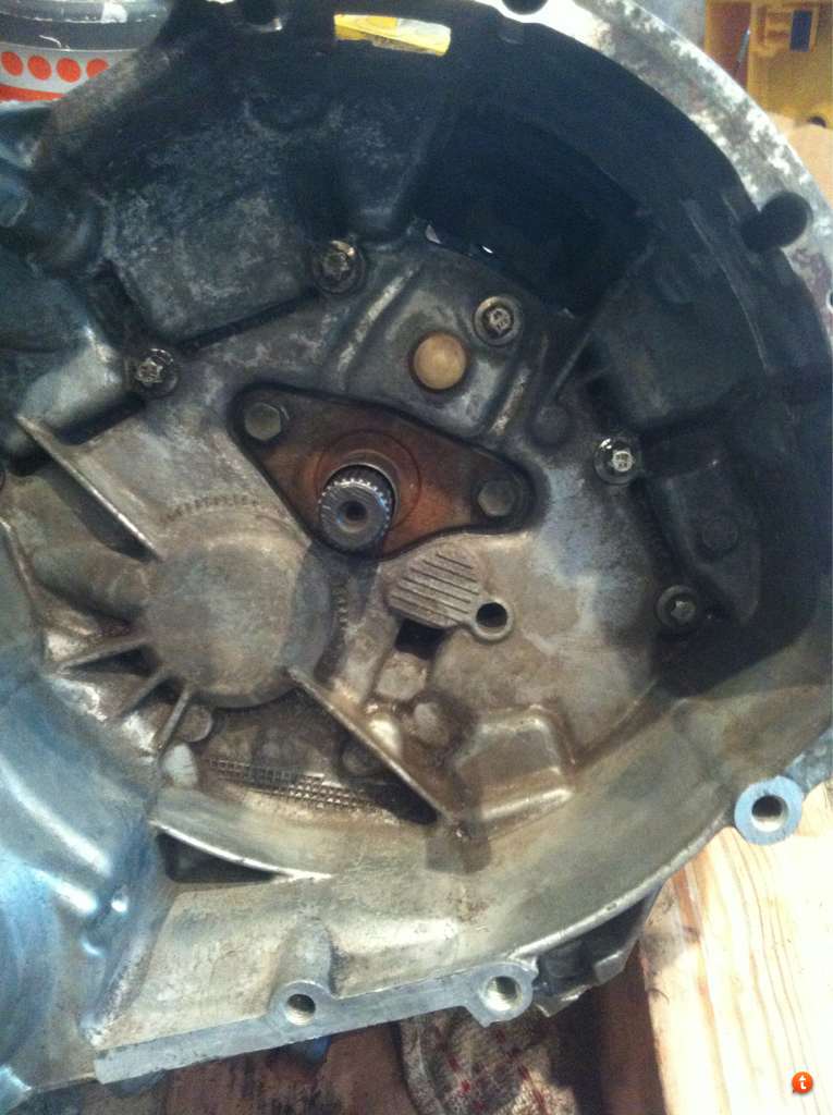

Ok so got my gearbox back from agency and got a new release bearing for clutch and ready to bolt back on. Had a quick read am
I right in thinking you grease the splined shaft on gearbox and inside of the bearing (plastic part) and the pivot point on the clutch fork?
  182
Tiny amount of grease on the splines , pivot point cap and sheeve thing that the rease bearing slides up n down on (thing with two bolts in picture just do the shaft)
