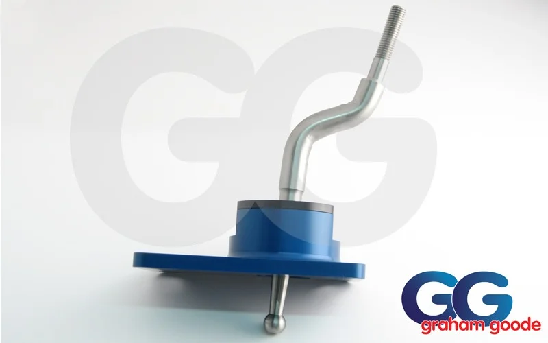

Something like the below with two bends to keep the knob straight. Hopefully this would allow the use of the original gaiter and still look standard.
