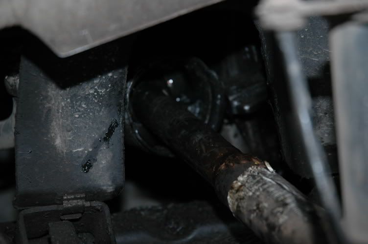

I went to my local trade shop today and got hold of a new gaitor which included a bearing?!?! anyway got home got the car up in the iar wheel off and had a butchers at it and they have given me the wrong gaitor. So i decide to remove the knackered one to take with me to get the right one. Got the large section off easy but where it seals against the housing of the in cv joint it appears to be attached to a metal ring that has been pressed into the housing. is it still possible to fit a new gaitor as i couldnt get it out and i cant see how you can squeeze a new gaitor over nything esp if it has a metal ring round it. Oh i took a pic of it to try and help abit
http://img.photobucket.com/albums/v188/jonesy172/DSC_0249.jpg
You need to remove the metal ring, why do you think people say its a pain in the ass job, i chose to get a new shaft for mine, £45 part ex, or £30 for a gatair kit from reno, driveshaft - 1 hour gatair - god knows how long, and plenty of swearing

think im just going to get a new shaft i can really be arsed sweating over a sh*tty bit of rubber, plus the cv joint is prob full of crap now anyway.
