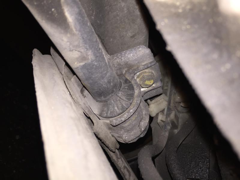

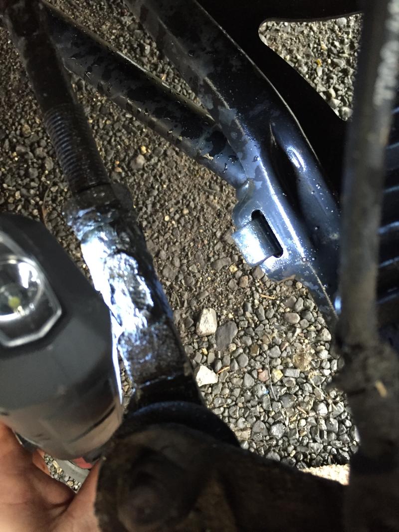

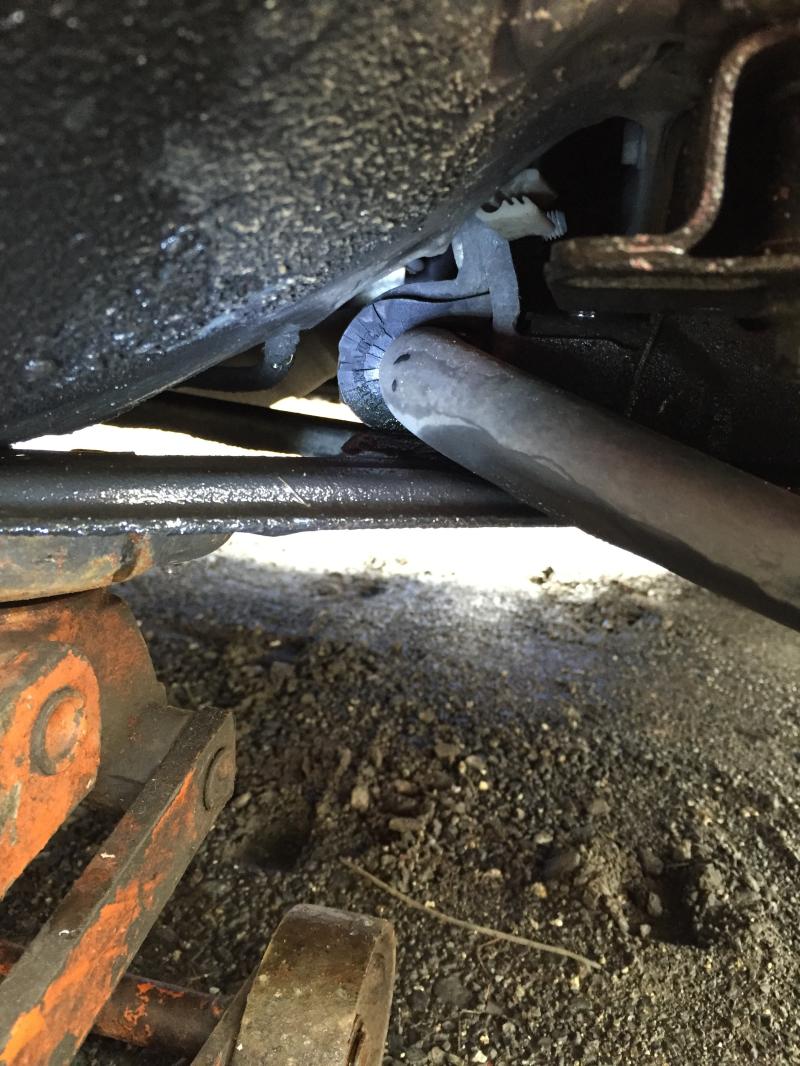

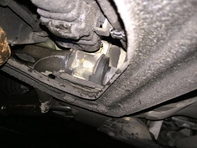

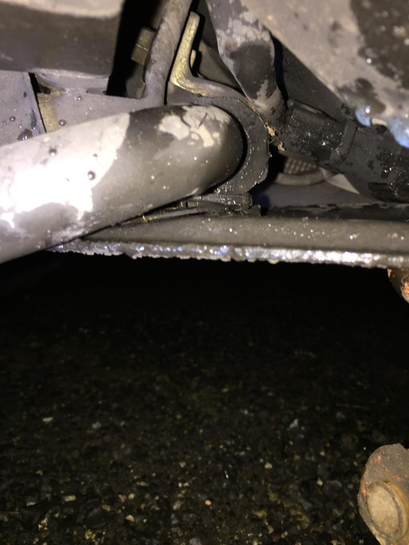

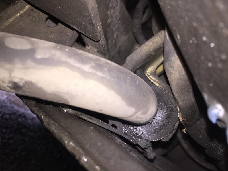

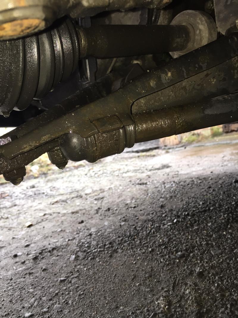

Im a bit lost on this one, my brother took his 182 for tracking to ATS yesterday (limited for garages here)
Put his car on the ramp and called him into the workshop, guy there said he cant touch the tracking as there was something wrong with the anti roll bar.
Now my brother doesnt know anything about mechanics etc so he didnt understand what the guy said, he said something about it being bent and it probably it had hit something in its previous life,
So he took it off the ramp and told my brother to go back,
I told him if have a look, ive got some pics
Any ideas as it looks pretty fine to me? And i wouldnt have thought the ARB would effect tracking?

think it's just the angle of the pic? also can't picture it at the mo but isn't there a bit of plastic trunking running up there? wiring for the rear lambda and abs run in it?

Where it looks like its touching the chassis is as @bloke said, its touching a bit of loom and looks pretty straight to me?

I see no problem there. My outer arb bracket snapped and it effected tracking but everything is intact on yours. Inner bushes look a little worn but they are a PITA to replace so only do them if they're giving you grief.

Thanks guys,
I really cant see anything wrong apart from as stated bushed are a little worn.
He was looking for a quick job on the tracking until he got coilovers etc and set it up properly
