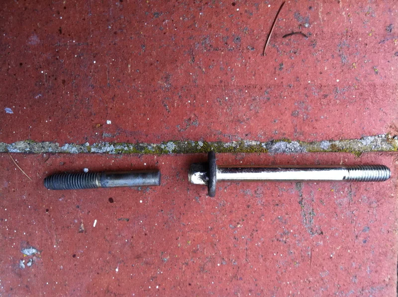

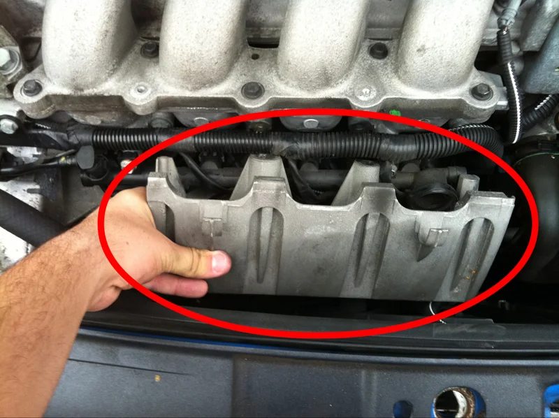

Two days ago i noticed a slight rattling coming from the engine bay at very low speeds, I opened my bonnet today to find that the front most part of the engine has come off.
Picture of snapped bolt (i have replaced the engine side of this bolt just in case)
Shiney side was the end that came out of the engine.

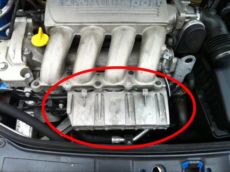

Am i still save to drive my car? as far as I can see it doesn't seem to be a critical part of the engine..
Does anyone know where I can get two replacement bolts from, and how much they will set me back?
Its the fuel rail guard and while good to have on its not the end of the world if you don't. I'm sure someone on here will have some of the bolts or if not renault and I doubt they will be expensive. I have some but still on the engine until it gets stripped down in the coming weeks.

I agree with Hutchie, leave it off, I take mine off everytime I change the oil, not sure how the hell you would change the filter otherwise lol
  Lionel Richie
"leave it off" you'll regret saying that if you have some form of impact and you end up burning to death, just a thought
  DON'T SEND ME PM'S!!
now I'm a massive advocate of shedding pointless extra bits and bobs, but that's not one that I'd leave off
