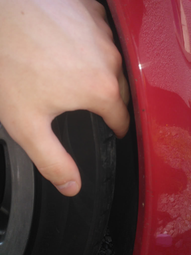

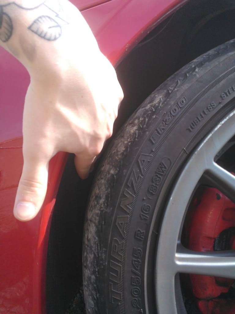

Ok so for a while now on full lock i've noticed an annoying catching sound, now i checked the front wheel arches for clearance and was somewhat shocked by the two differences, can easy fit the width of my two hands flat in the passengers arch, here's the comparison :
Passengers side
​^^ drivers side, hardly fit a finger in there, any idea's as to why? Cant think myself, cheers!

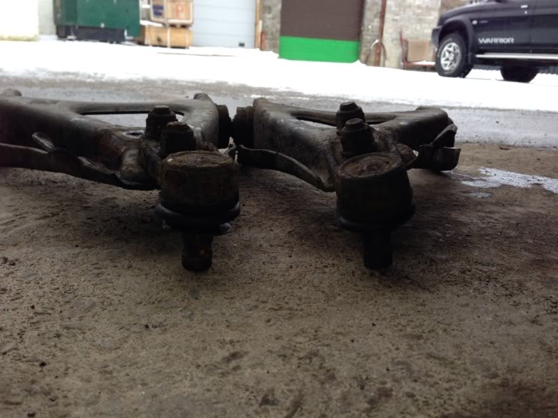

this or completely shafted bushes moving around.
Yeah check wishbones over

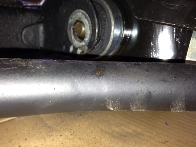

My current Cup came with these fitted, it was hard to spot on the car when on stands too.
Also on the same car it had been left with a slack wishbone bolt which had eaten away at the subframe, the car was scary to drive above 50mph when I got it.

Quite easily done by someone not knowing what they're doing to fit cup wishbone one side when the car should have standard ones! Would do exactly what you're experiencing

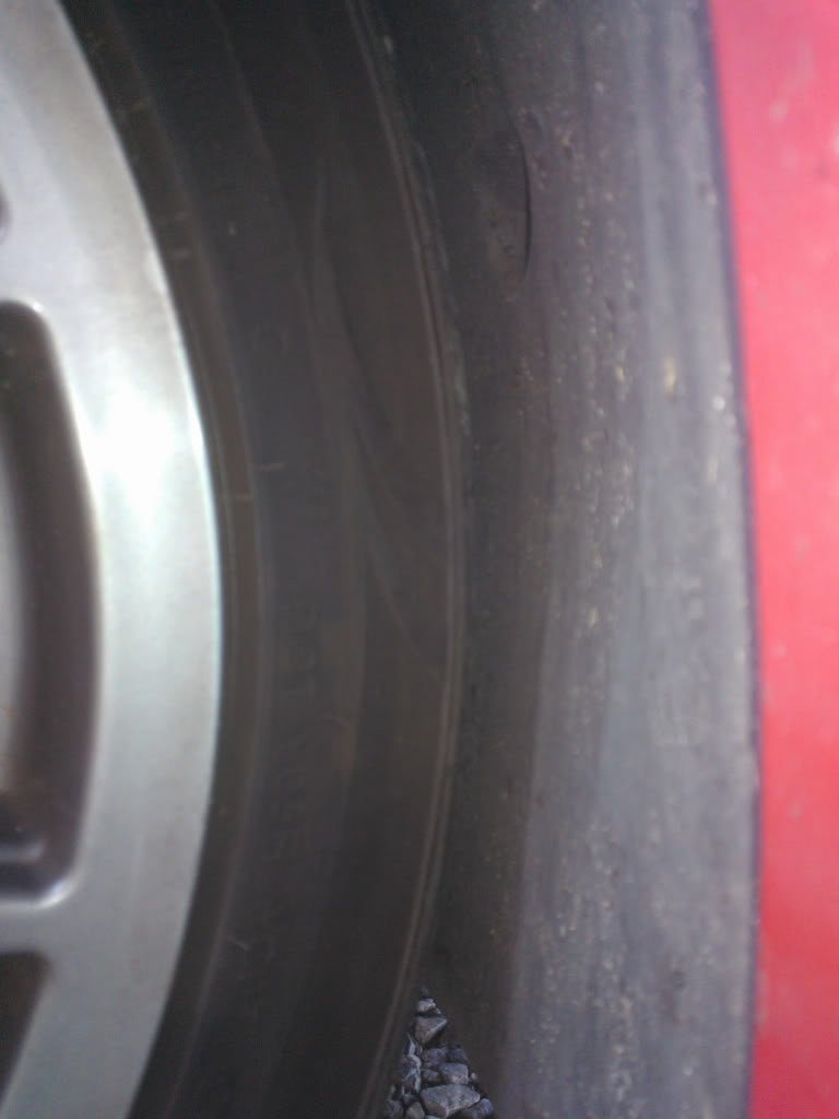

I trimmed the drivers arch liner last night, like i said i've no idea, will get pics when i take the wheels off! :)
