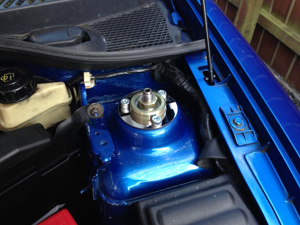

I have shot top mounts on a 172 Cup that need replacing. What with the cost ending up being nearer £100 for bothe side because if additional spacers on the new design, or I take a chance on non-OEM parts on eBay, plus the reports of badly seating parts when it's all together (poor desig ), I'd rather go straight to a PMS mount and strut brace solution.
Problem: will this still comply with the msa blue book for a road going series production class car....?
" Suspension 80.The suspension configuration must remain standard."
...of the attached doc.
Any hillclimb/sprint guys in the know that can help here...?
Cheers

It used to be that if you didn't change the design of the suspension or move pick up points you were ok. If the top mounts are adjustable (i know nothing about the PMS ones.) that may cause problems as you are moving a suspension point.
  Clio 172 (CUP)
Sounds promising, I don't believe the PMS ones are adjustable, just spherical bearing bolted to body work
  Pug 206 SW, 172 CUP
Maybe fine then. I'd still get clarification if you are planning on winning awards or competing in a championship. Just in case! Most events organisers don't have the time to check. It's other competitors you have to watch out for.
Definitely not adjustable,
  Clio 172 (CUP)
Fair point, BTW your interpretation of suspension config is the same as mine
Thanks for confirming.
