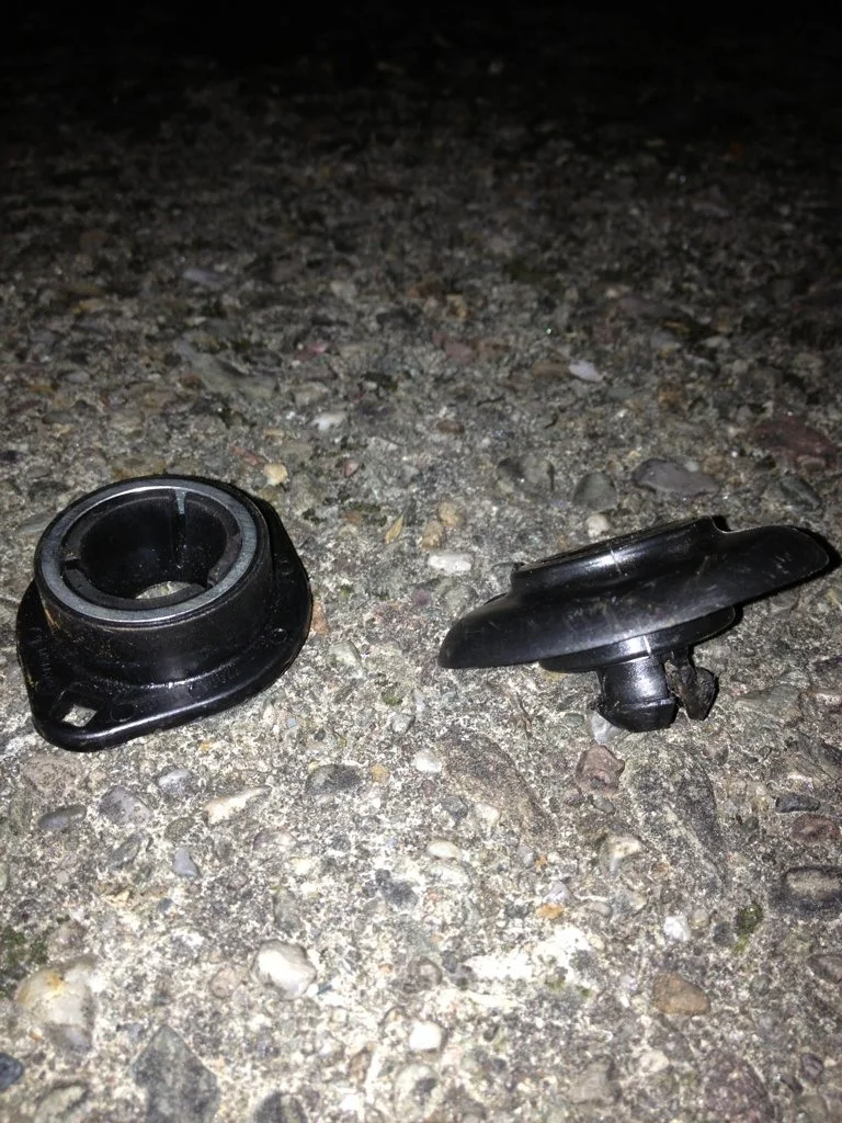

I removed the spacers on my driver's seat to lower it recently.
The spacers by the door were deeper than the spacers closest to the centre of the car.
This now means my seat lists slightly and is now lower on the door side than the side near the centre of the car. You can't notice it when sitting in the seat, but to look at, it's definitely not as level as the passenger seat.
Any thoughts from those that have completed this mod? Normal or knackered?
Thanks in advance
John
  RB 182 Cup
Left - outer spacer (near door)
Right - inner spacer (near handbrake)
  RB 182 Cup
Yes, I left front in to tilt seat slightly backwards, but I have removed the two photographed spacers from the rear of the subframe.
Mine was the same, I used a few metal washers on the transmission side to bring the level up. I was speaking to Mark Fish about this, he said its a good thing as it leans you slightly away from the door, reducing any possible side impact injuries if tracking the car.
