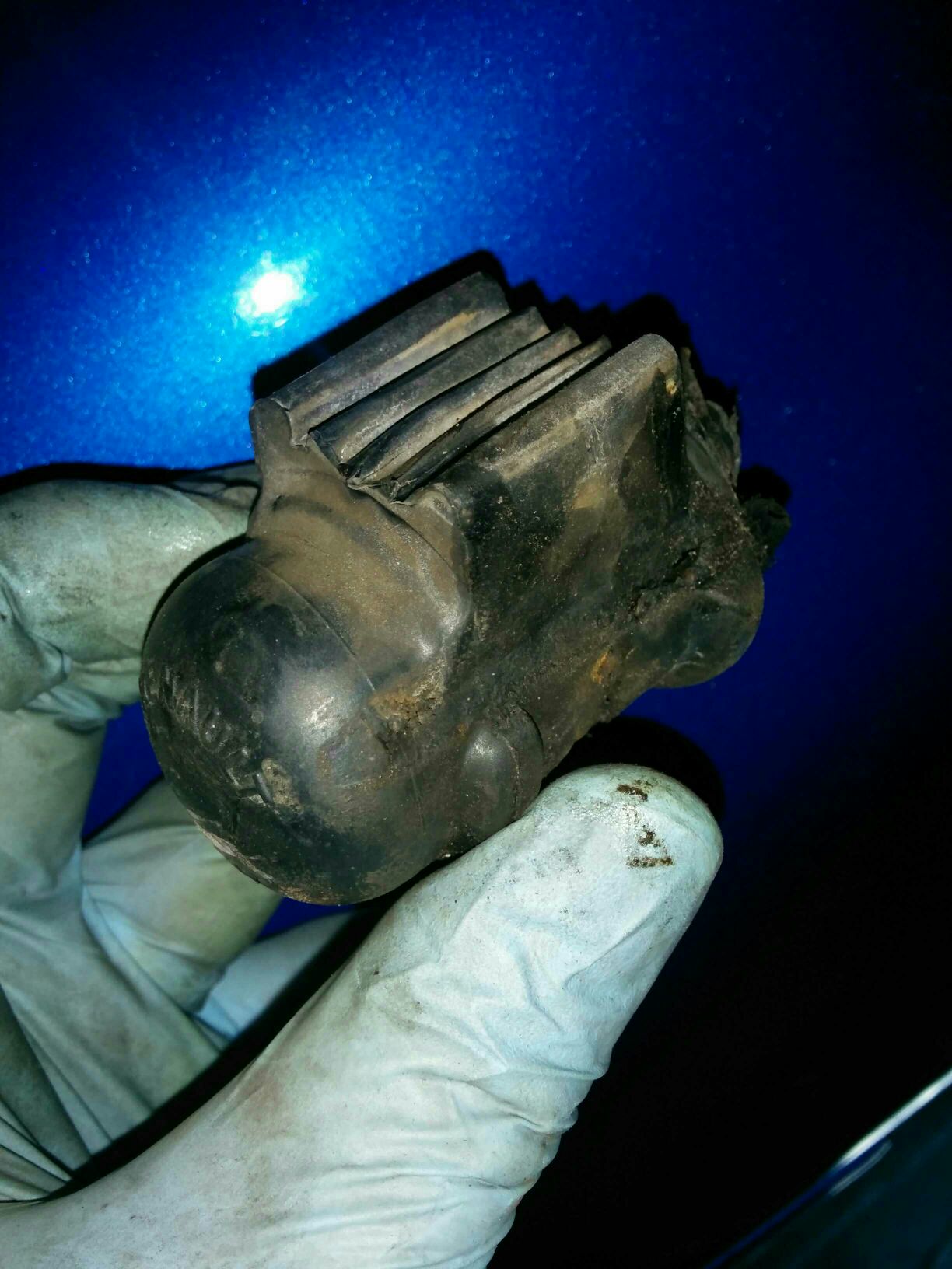

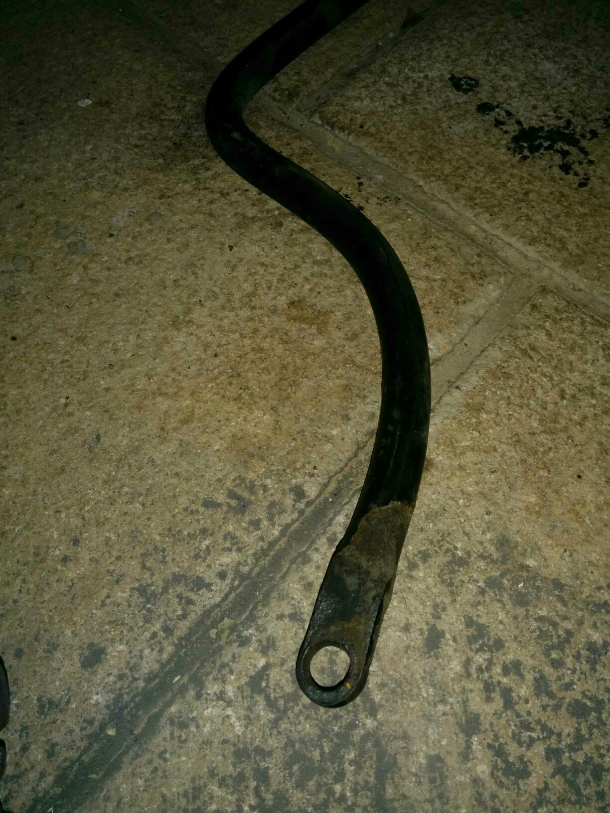

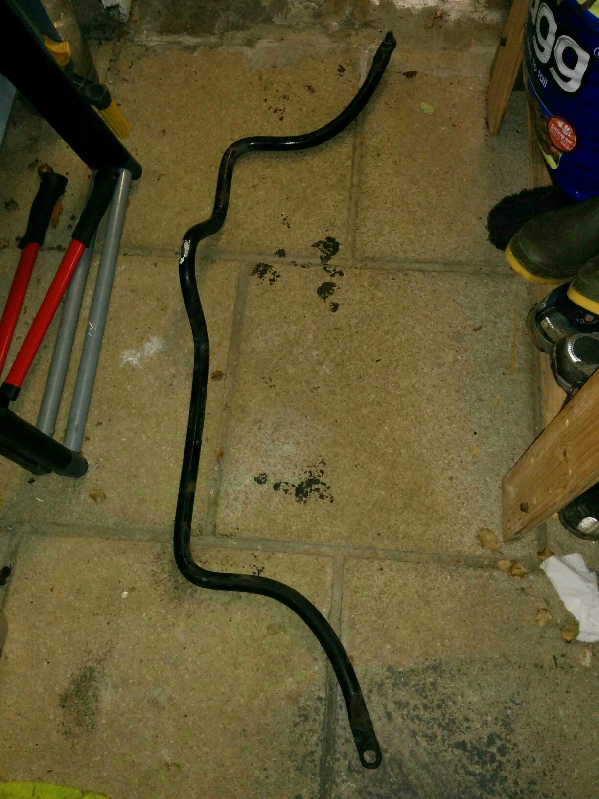

Can't for the life of me find a comparison pic on the forums or the net. Just striping the front corners down for a refresh, detached the ARB, pulled the mullered bush off the end of the ARB to find an old rusted nut and bolt, and the ends of the ARB being flat.
I'm now suspicious, is a flat end like this correct for a 172 cup? wondering if this has been swapped in the cars history. Anyone got comparison pics available?

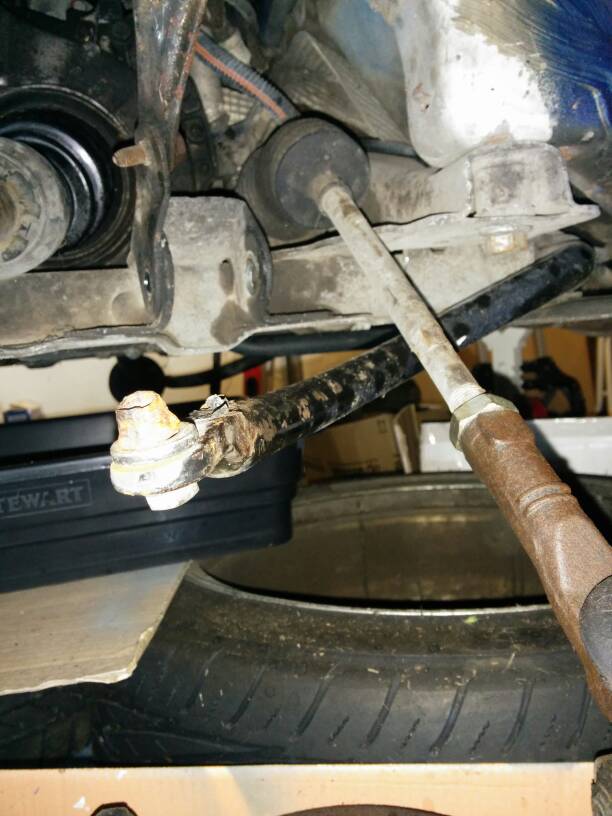

Looks rose jointed mate.

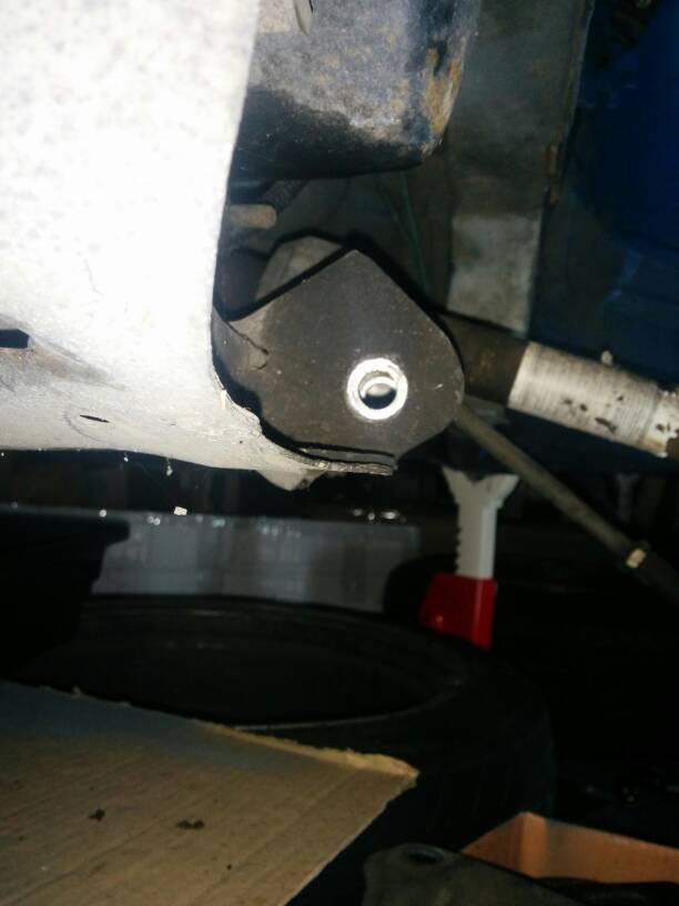

Had the correct bush (sleeve) over it and braced via the strap to the wishbone as per any other RS. The other side didn't have any bolt left in. (Pics below).
Just wanna check it's still the correct ARB before reconditioning it, otherwise I'll have to source the correct one.

That's nothing like the arb I've got on my cup. What's the diameter of the bar? It should be 25mm for the majority of the length and 23mm on the ends iirc.
It it looks like it's had one from a non sport fitted tbh.

Yeah that's what I fear, bloody cowboy previous owner. With verniers it's ~23mm along the body and ~25.5mm across the width if the flat piece. If you ends are different then that's enough for me. To be honest, they didn't look a snug fit at the ends before I took it off.

Yeah that's not a cup item I'm afraid mate. The ends on any sport bar don't have those flat pieces either.

Therr the correct bushes. But weird why its a non sport ARB
How did it handle ? Cant imagine the ends sitting to well in the actual bushes lol

Never really drove it much between buying it and starting work on it in the garage so can't say really. You're right, they didn't look right, actually it looked to short.

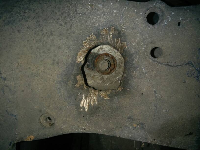

The wishbone mounting points are drilled further out, the hole centres should be about level with the edge of the flat part of the frame when looking up from underneath. Also the lower gearbox mount needs the hole drilled out on a non sport frame.

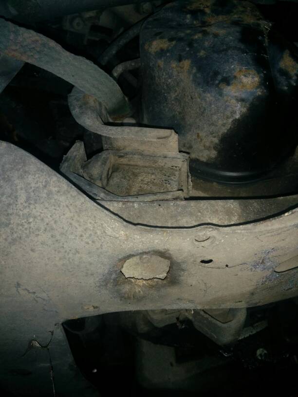

I was looking at the wishbone mounting holes last night after reading something on here, but I couldn't determine if the holes were in the correction location or not. The information/pictures to hand weren't clear enough.
I'll have another look tonight. Cheers.

I'm hoping your right, but those wishbone hole spacings are worrying me, and I'll need to measure the lengths of the drive shafts etc. The hubs are correct, and the castor on the wishbones look correct to.
Well I guess this is conclusive then....
....so what does that mean for my set up, only a narrower track at the front or more draw backs?
  172 cup
That's bad news, guessed that though because I wouldn't think someone would just fit a 1.2 antiroll bar. Get yourself a subframe and roll bar from a breaker, cup or sport they're both the same.

Incorrect track will be the main thing.
I'd get a proper subframe on there tbh.

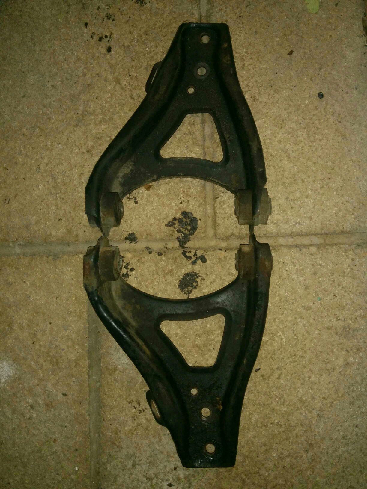

That's what I'm thinking, I'd rather get it back to standard. Although I thought the cup has the wishbone holes in a different position, so not quite the same as the std 172?

Another myth, I thought they were the same but asked Adam to check part numbers earlier and they are the same. What wishbones have you got?

talk about a cow boy jesus!! unlucky with your problems mate, and as for the 'cup wishbones' dont thing there just on 172 cups as i bought a set of here last week got them start of the week only to find that i had a set fitted and my car was total standard when a bought it

They are the right wishbones deffo.
