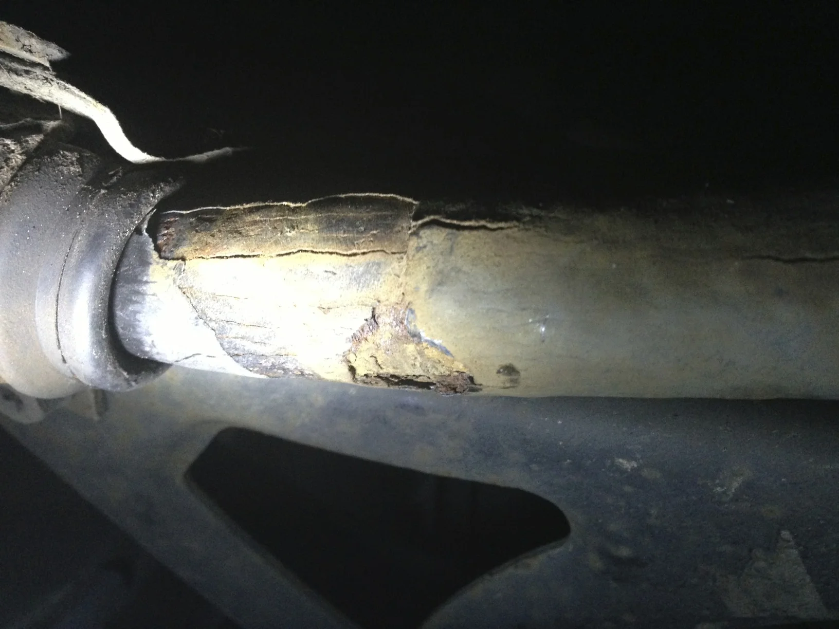

Was under the car today and noticed on the N/S just before the bushing on my Front ARB has a 2cm long crack and what I can only describe as a chuck missing. The bit that is missing is about 20% deep of the overall diameter. Would it need to be replaced and would it be something picked up on the MOT? I know you can pick up reconditioned ones pretty cheap, are they easy to fit or if a garage did it how much would they charge? If it needs replacing I would buy updated bushes as the originals have to come off anyways to get the ARB out.
I will try to get a picture soon.

Looking at the picture it doesn't actually look that bad in person lol

That's fine, it's where they get a lot of road grit hitting off them then rust and blister. Hit it with a hammer a few times, wire brush and paint....sorted.
Thanks mate appreciate it. I was a little worried. It was a little flaky so I waked it and that is what you see now :)
